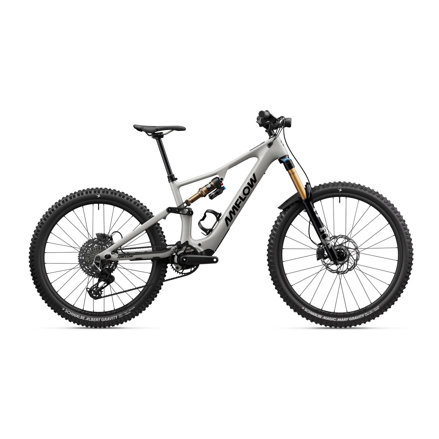

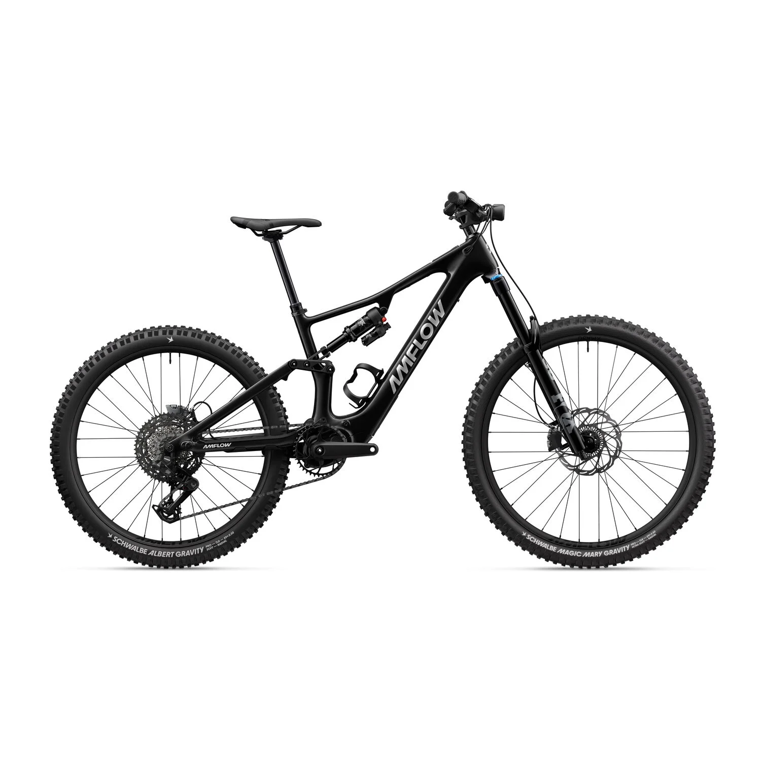

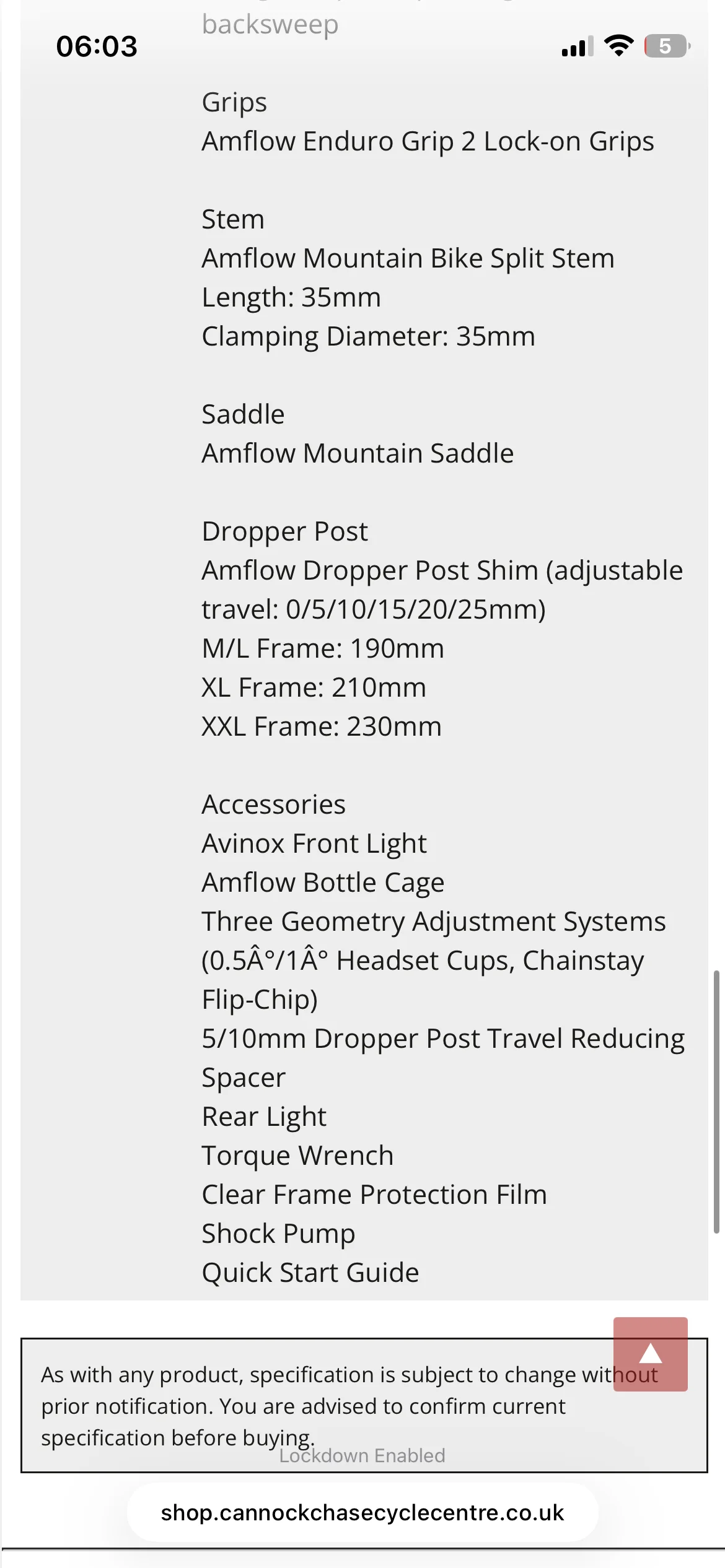

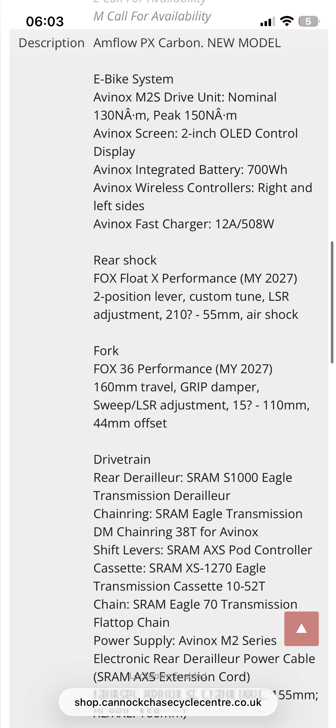

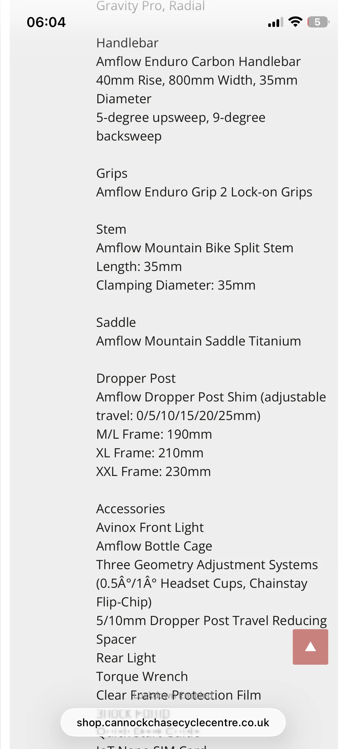

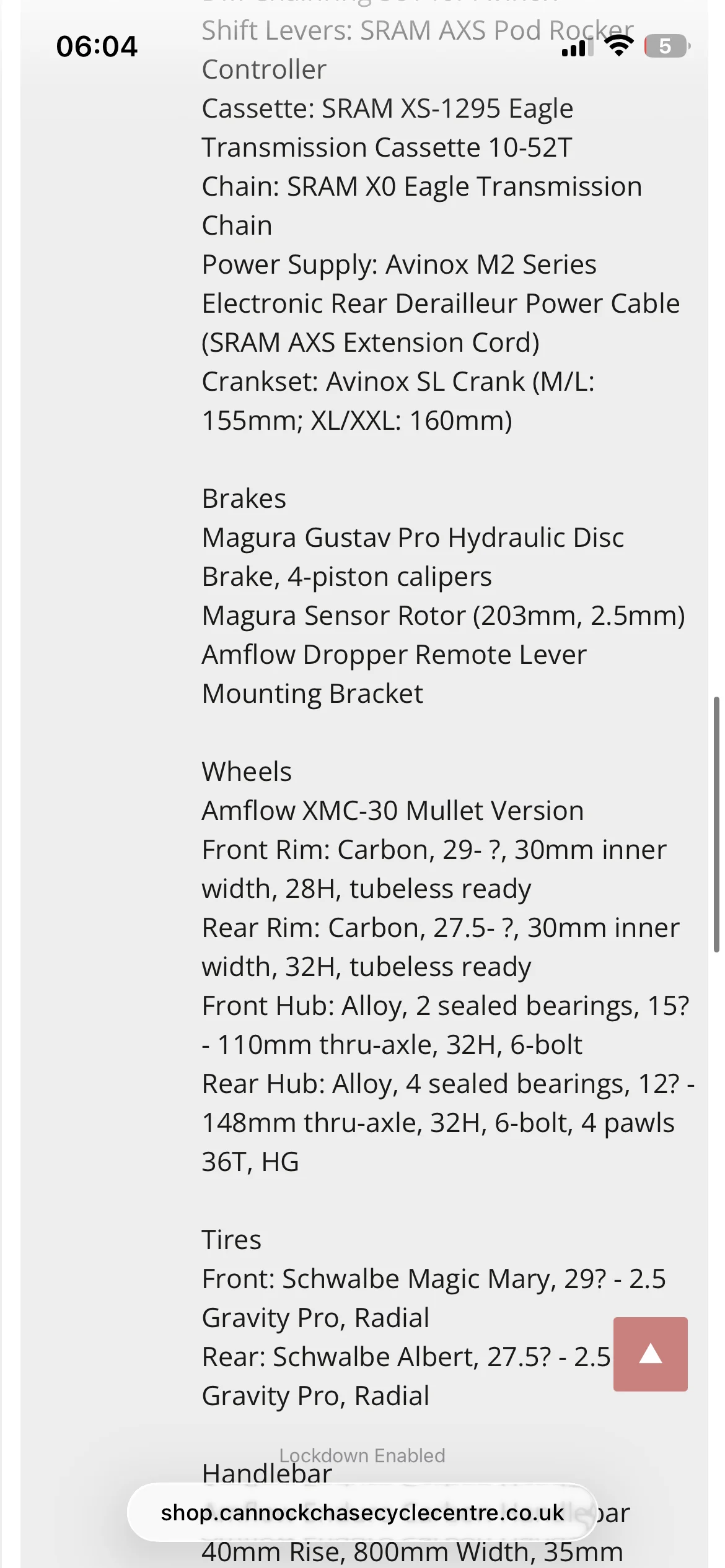

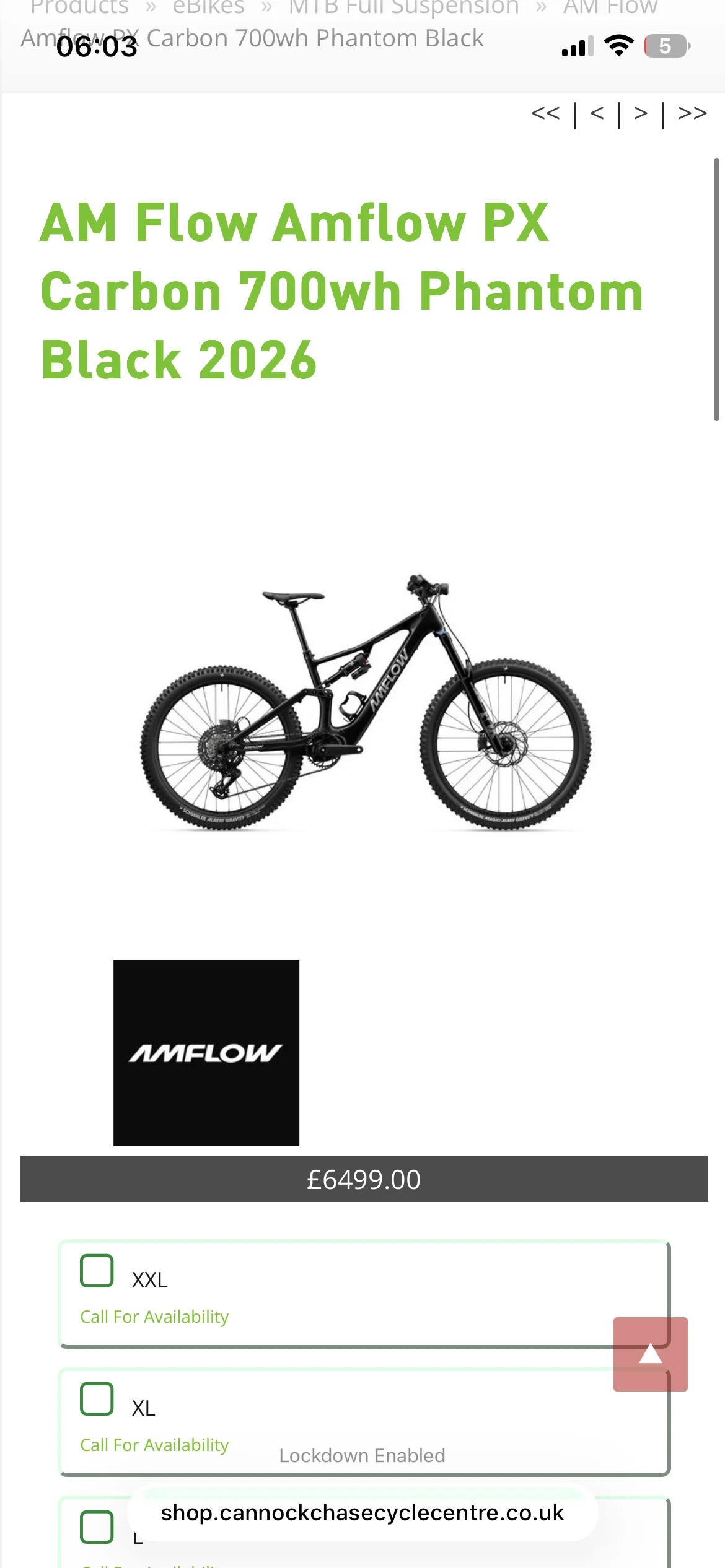

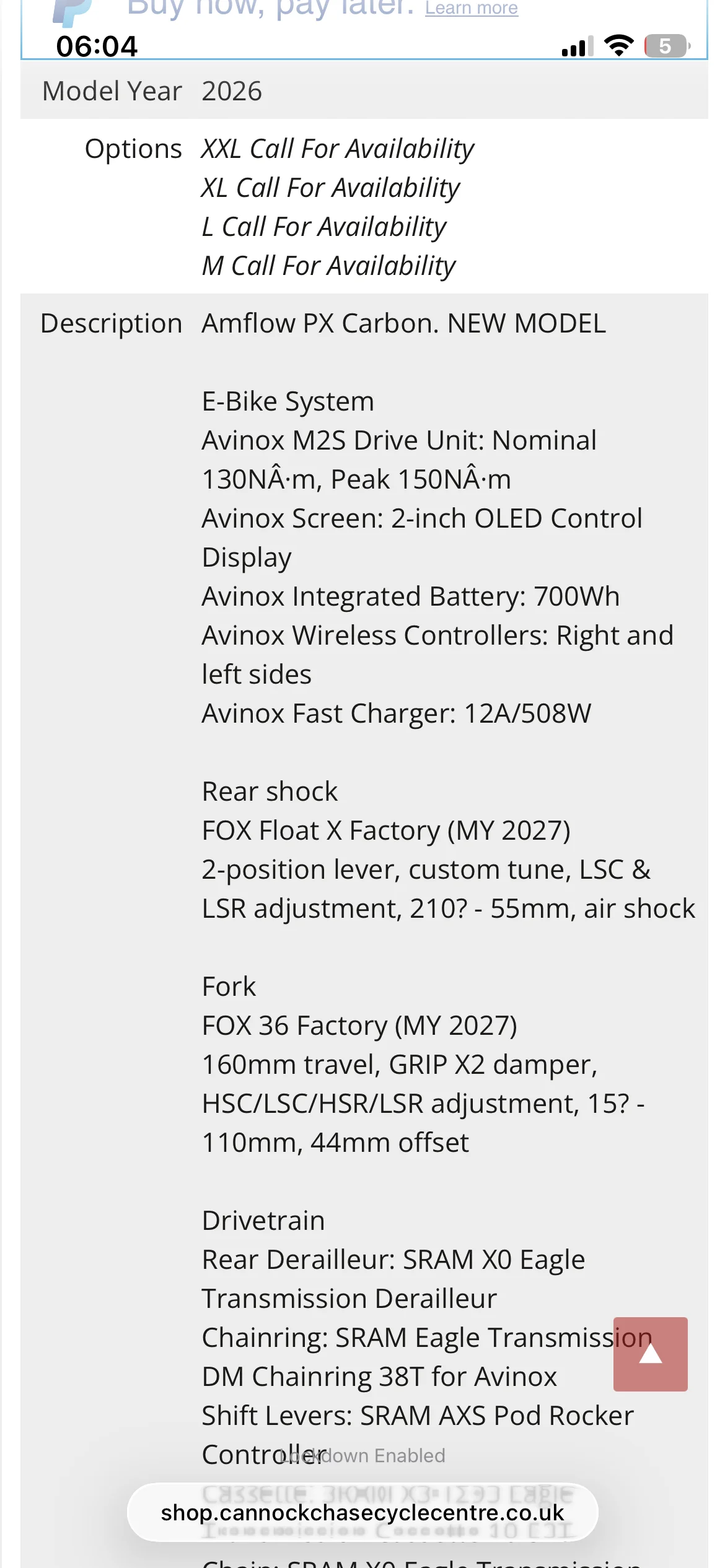

Some full-res pics care of Jonny's LBS above.

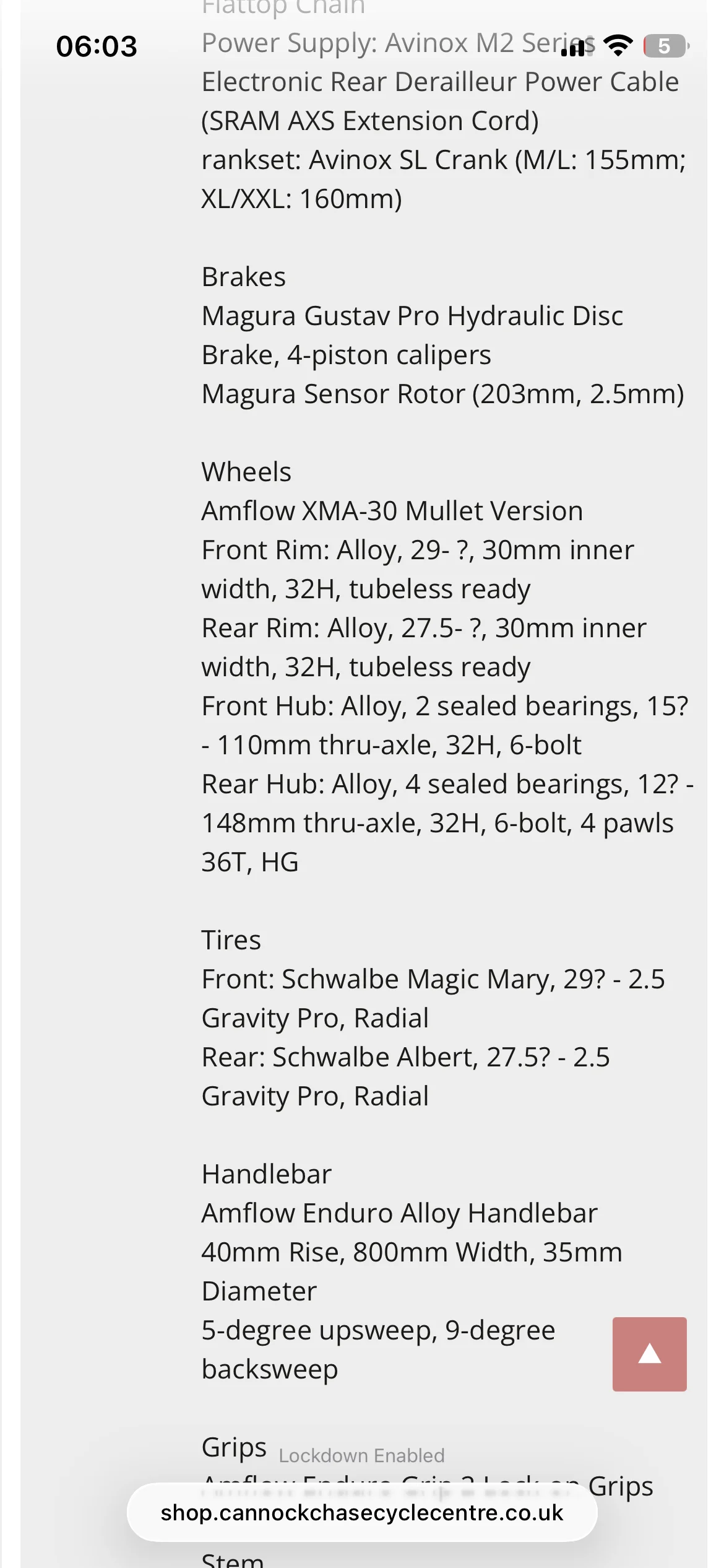

Oh WOW, that 38T chainring is huge, and sticks out way beyond the engine; bushguard will be useful.
Downtube on PR is as big as on my Cube Stereo Hybrid 800. Ability to remove battery doubles the downtube?
Standover is also much higher than on my Cube. They've run top tube very high.

Yeah, I missed it before it was taken down.:( On page 1 of this thread there were low-res pics of both PX and PR models. The white PX model looked like it had a very thin downtube, but I think that was just because of the sort of hazy line between the tube and the background, as the black PX model downtube looked nearly as thick as the PR models. Certainly not the 2x difference I see mentioned above. I saw some other genuine pics of them and it looked like the PR has a more square cross section downtube (vs. rounded on the PX), and a full length black protector on the underside (vs. a short protector down by the BB on the PX), so depending on how the light hits it, it may appear differently.
Back on page 1, someone also said the PR is supposed to weigh 2kg more than the PX. A downtube cutout typically only adds about 0.5kg. Does anyone more familar with battery weights know roughly how much more an 800wh battery would weigh than the 700? Does an extra 100wh likely account for the full additional 1.5kg, or does that weight increase indicate there is still hope for the 900wh+ battery?

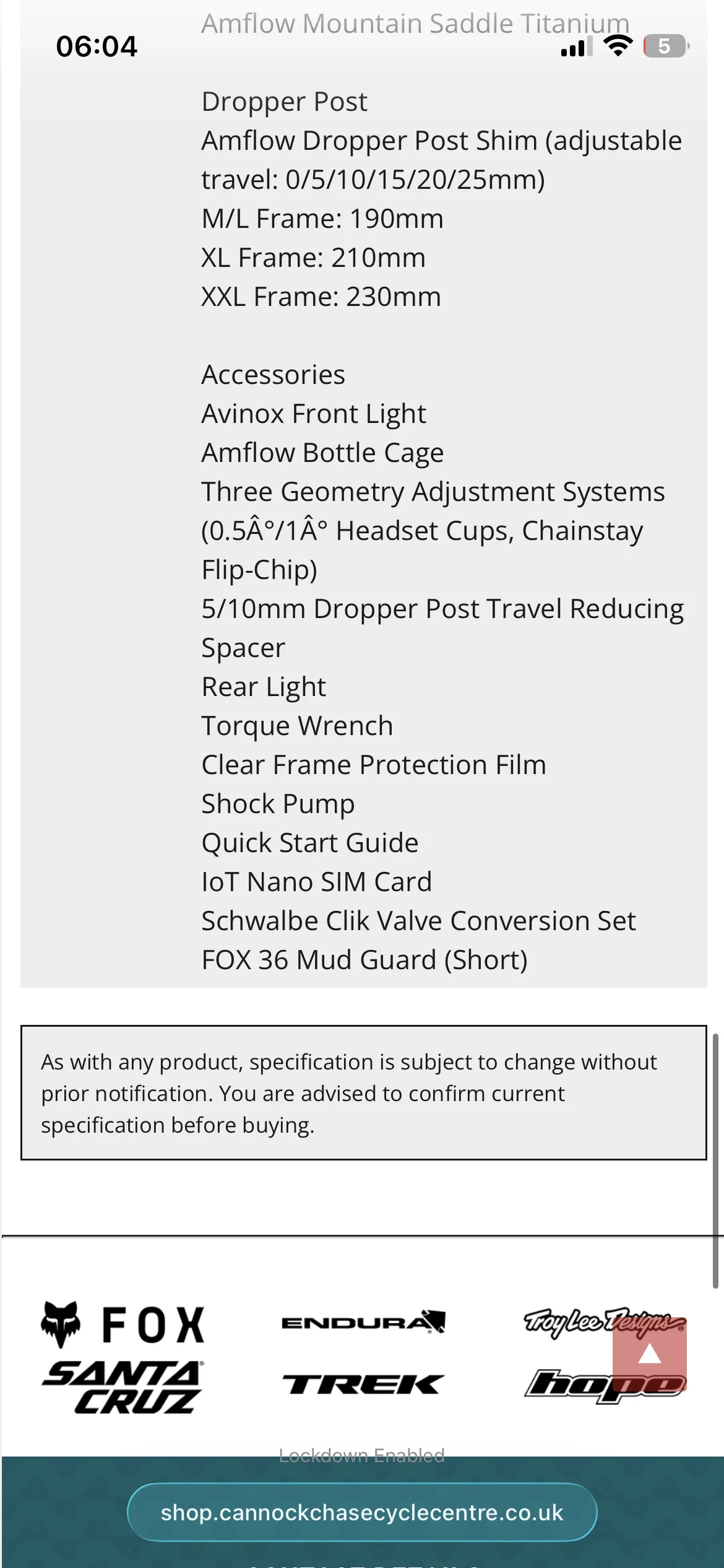

On the plus side, I do like the adjustable headset cups and chainstay flip chips. I'd also ideally like to see a flip chip at the swing link but , since they don't seem to have incorporated one, I guess offset shock bushings are always a DIY option to tweak the ride height a bit more.
That chainring size is perfect for riding derestricted "NZ mode" or "class 3"! They know what the people want :D

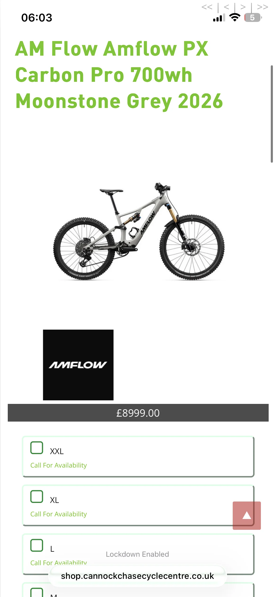

The downtube of the PX in the photo looks even slimmer than the shop listing.
I might just go for the pro for the fox factory.

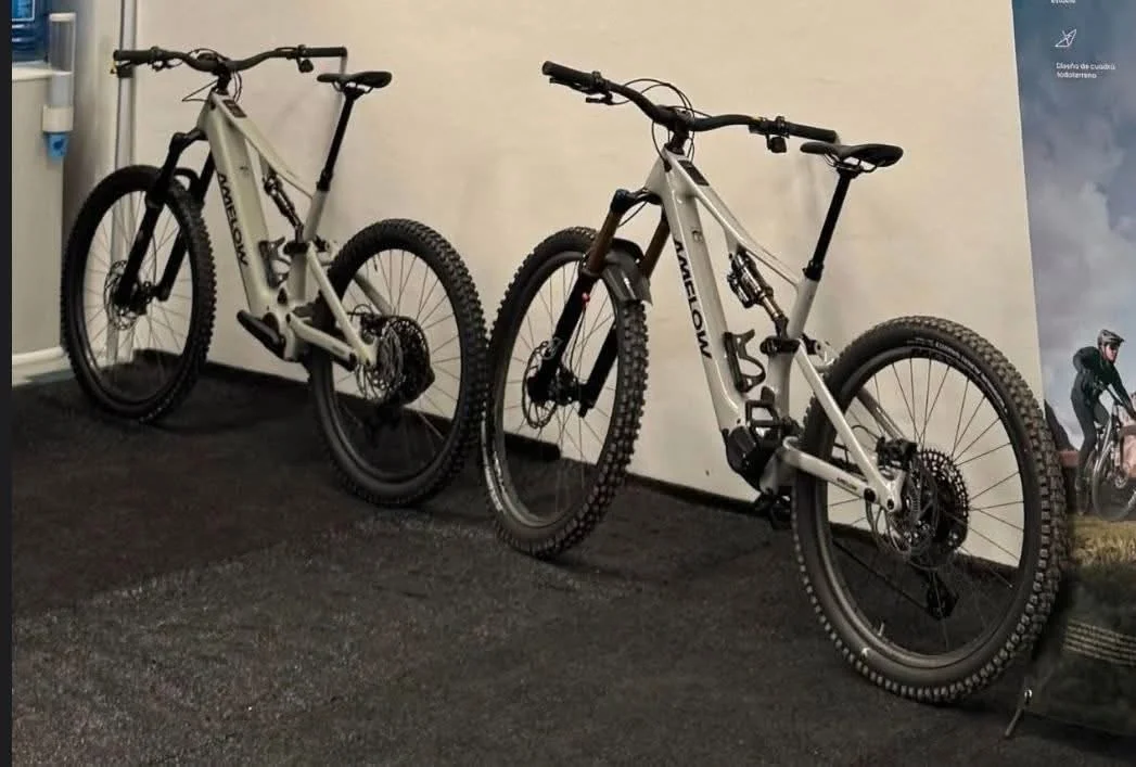

Downtube looks skinnier than the old amfloow model for the pictured bike on the right, i guess they've gone with 800w length but even thinner, visually could pass as an SL.

The photo in post #77, with the 2 white bikes leaning against the wall, is the new PX (integrated battery) and PR (removable battery). Without measuring it is tough to tell, but it seems like, when compared to the 1st gen Amflow bikes, the PX may have a slightly smaller downtube, and the PR looks like it has a considerably bigger downtube. The PX seems to be 700wh, and the PR I think is 800wh, but I don't think that the PR battery capacity is 100% confirmed yet.
