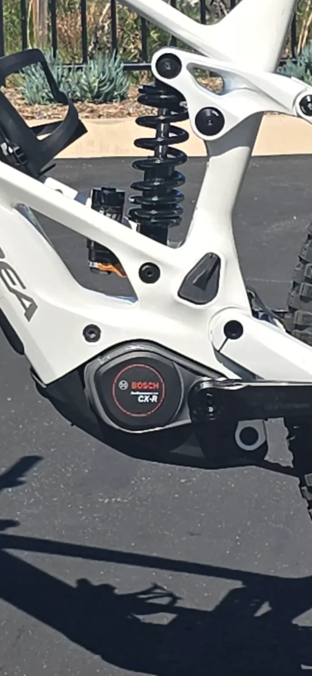

Could someone with 2026 carbon Wild help?

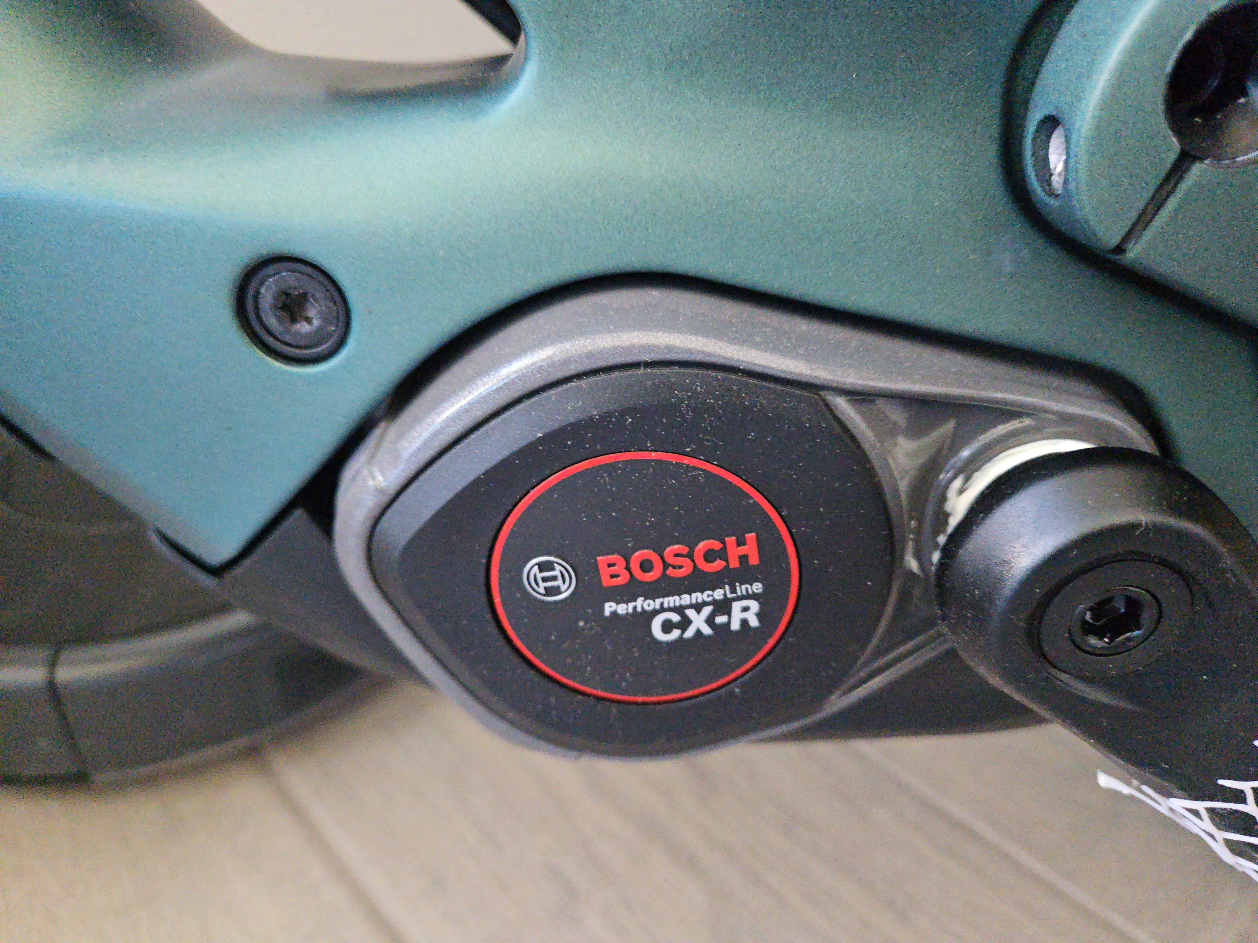

Does Orbea use these new type of motor mounting bolts on 2026 models? Close up picture from left side of motor would tell this. Bluebook still shows old bushing type, but it is based to 2025, so may not be updated on this.
This interests me too. I hope they use new ones, at least they should. The older bushings are crap.
My 2025 Wild motor lost the rear bolt bushing. Due to the missing bushing, the motor could move and the engine cover rubbed visible scraches on the engine. I noticed the bushing was missing when I was cleaning dirt under the motor cover and wondering about the scratches on the motor.

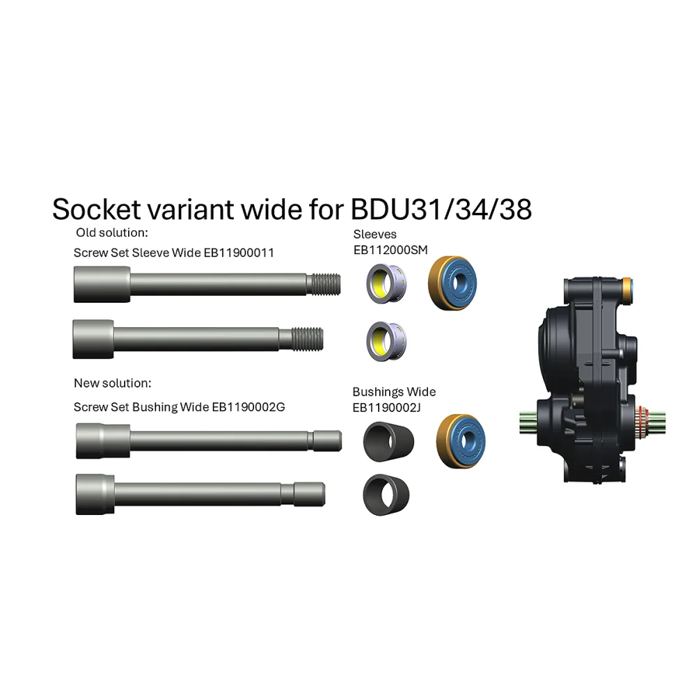

The bad bushings was a Bosch problem, not Orbea. Originally those bushings weren’t tight enough and had a pattern of falling out. Seen it on multiple bike brands. Bosch has since updated the bushings - almost a year ago. They even changed the part number. It’s hard to know whether your bike still has the old ones or not. To be 100% order the new bushings and replace them.
New updated bushings (2-pack): EB11.200.0SM
Old bushing (individual): EB11.200.0GK

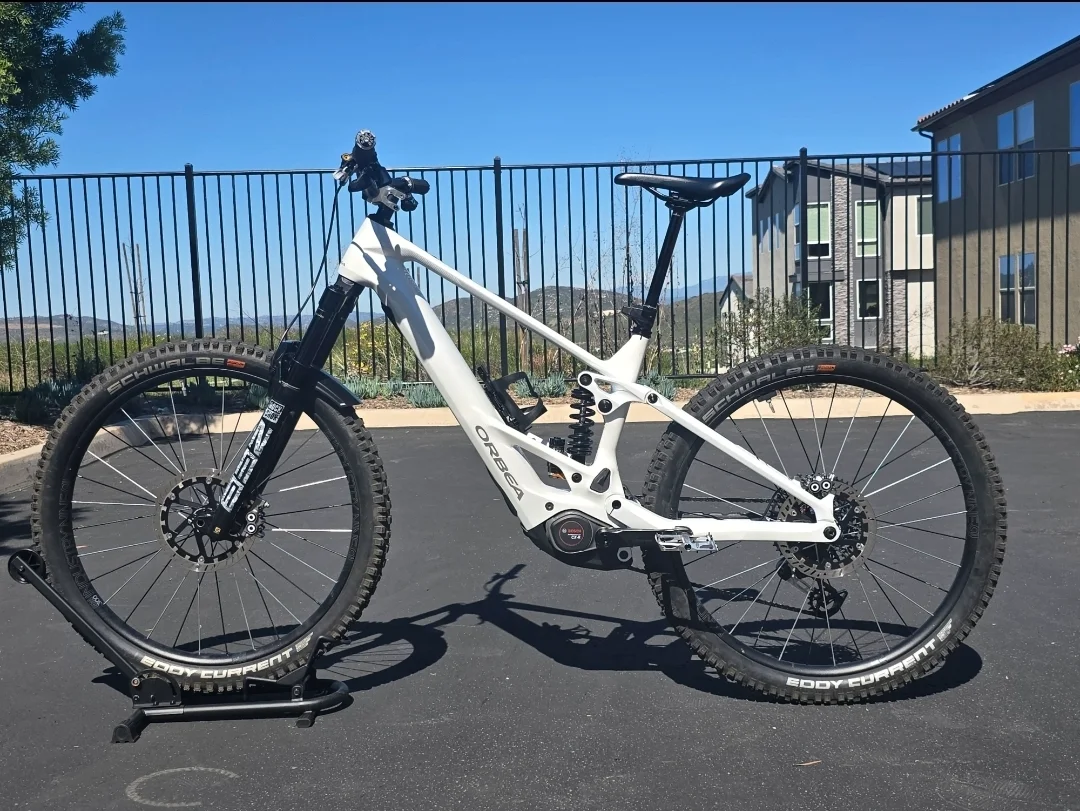

Not sure if this helps guys. I custom ordered the in November of 2025 so it should be the 2026 model. I can take some additional pics with guidance.
Yep, caused by Bosch, not Orbea actually. But the seller is responsible for the problem.
My bike has old bushings and bolts (only one old bushing left). However, I'm not going to buy updated new ones myself, I will demand them from the seller/Orbea/Bosch.
I understand that the latest bushings are EB1190002J and those also require new bolts part number EB1190002G
Ok so I just realized there has been a third update since the new 2-pack bushings. This image shows it clearly.
The latest iteration is new bolts and new (again) bushings. I’m gonna try and get an official explanation from Bosch.
Thanks. Better resolution close up picture of this bolt should show it.
On bluebook they list old model still, but may just not be updated there. There have been lots of reports of these old type Bosch bushings falling out on other brands like Cube. Have not heard before from Wild, mine have been ok so far.
I was preparing to install motor to my replacement front frame. I had possibility to choose both models, but decided to use old model as to be certain of compatibility.
That's a really nice bike and your build looks similar to mine in many ways such as AXS, coil, CXR, rotors, etc. What did it end up weighing with which battery. That's the cf frame?
It's a CF frame/800wh battery. Not sure of the weight. Will weigh later and respond back.

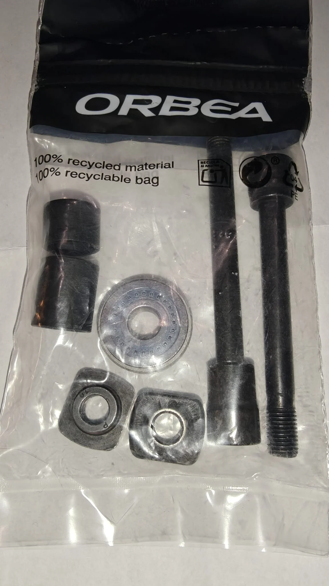

The importer sent me new motor mounting parts.
It seems that Orbea is now using the updated EB1190002J bushings and EB1190002G bolts.

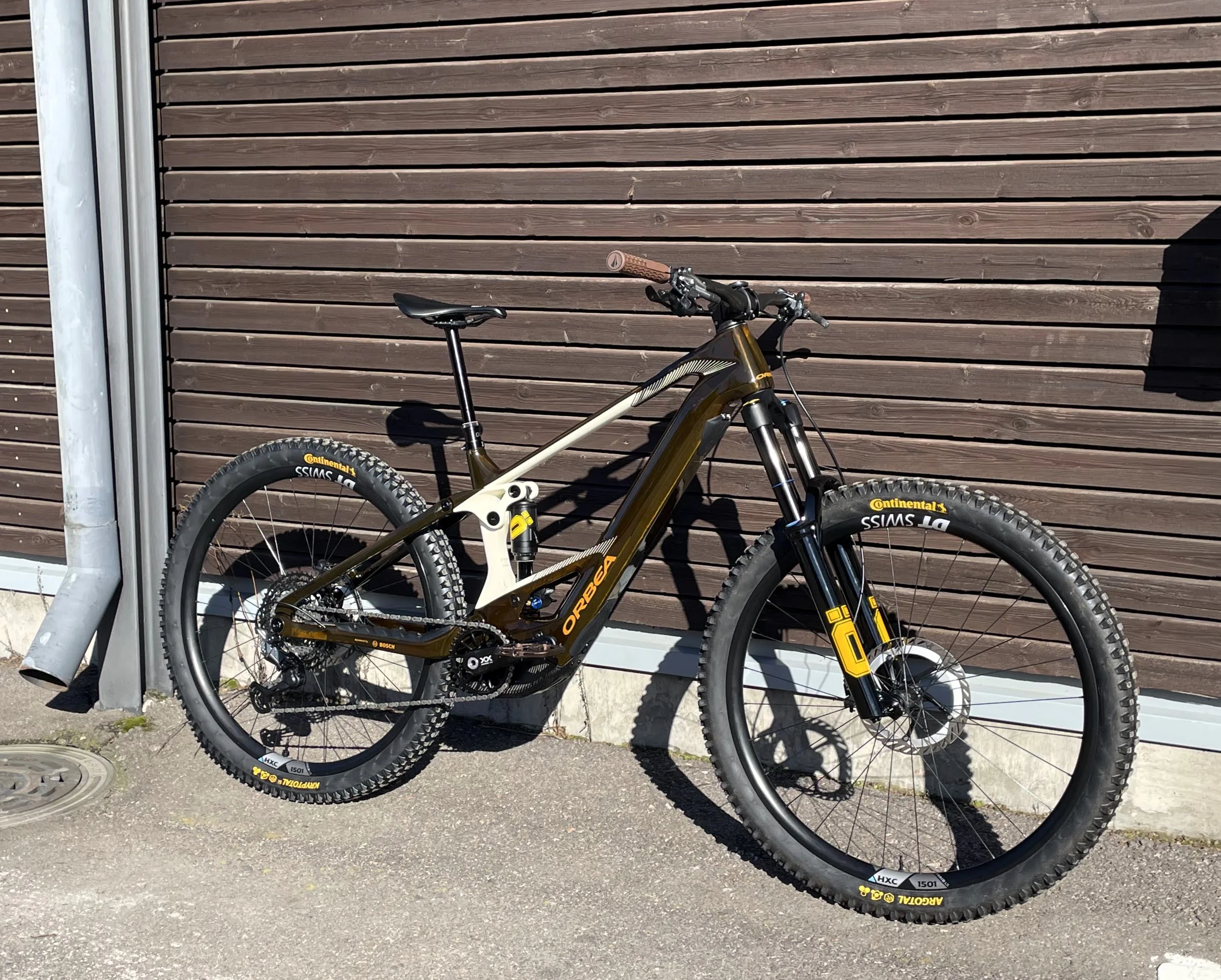

My Wild on version 2, after complete rebuilt. New front frame and Öhlins suspension. Some other smaller upgrades too.
Weight is now 21.00kg even. That is with coil fork and with pedals. With air spring in and without pedals it would be 20.42kg.
Picture from this sunny morning, now it's muddy:D

Sweet bike! Nice color scheme. How are you liking the Ohlins fork? Any thoughts to going with a coil shock?
Thanks. I can't give any opinion of fork yet. I just did short run-in ride today, and its still quite icy here on trails. I would definitely like to try TTX22 coil on the bike.
Current build:
Frameset
Frame Orbea Wild OMR 2025, 29" wheels, Concentric Boost 12x148 M
Shock Öhlins TTX2Air, tune C20 R35
Fork Öhlins RXF38 m.3 Coil, blue spring
Ebike
Battery Bosch Powertube 600Wh BBP3860
Motor Bosch Performance Line CX BDU3840
Display Bosch Kiox 400C BRC3200
Remote Bosch Mini Remote BRC3300
Drivetrain
Chainring Garbaruk Bosch 34T
Crank Sram XX for Bosch 165mm
Shifter Shimano XTR M9100 I-Spec EV
Cassette Shimano XTR CS-M9101 10-51t
Rear derailleur Shimano XTR M9100 SGS
Chain Shimano M9100
Cockpit
Handlebar OneUp Carbon, Rise20, Width 800
Stem OC Mountain Control MC11 Alu SL, 0º 40mm
Computer Mount OC Computer Mount CM-05, Garmin/Sigma
Brakes
Brakes Shimano XTR M9120 Hydraulic Disc
Brake pads Shimano N04C-MF Metal
Rotors Shimano XT RT-CL800 203mm front / 203mm rear
Wheels
Wheels DT Swiss HXC 1501 SPLINE® ONE LS
Tires Continentel Kryptotal-R DH SuperSoft 29x2.4"/Argotal Enduro SuperSoft 29x2.4"
Components
Seatpost OneUp V3, 31.6mm, Dropper
Seatpost Lever Shimano SL-MT800 I-Spec EV
Saddle Specialized Power S-Works 143mm
Grips SDG Thrice
Extras
Shimano SP41 outer sleeves, XTR Polymer cables, BikeYoke seat clamp, PORTE Ahead Cap, Bosch wheel magnet replaced with ring magnet, some ti and alu bolts, Intend Blackline front brake adapter 200->203, optimized Bosch wires length, Wolfcarbon motor protector, pedals Oneup Wave
