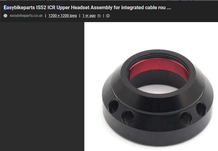

What exact questions do you have regarding the headset? The stock one is miserable. If you have Facebook, search the Orbea Wild threads. Lots of info regarding this aftermarket headset.

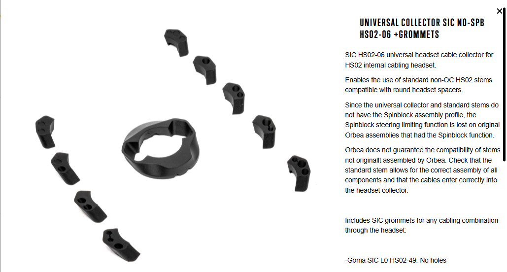

You won't need the Upper Headset Assy if you have the Universal Collector Kit from Orbea.
I used the Universal Connector Kit on my 2023 & 2026 Wild and had no issues with clearance (Size Large Frame/40mm STEM/45mm Rise Bars). From what I understand, if you go to a traditional bar/stem combo versus the stock integrated you will not have the Knockblock function.
I'm in the FB group and have seen no info on this even though I looked.
Do you have personal experience with it being miserable?

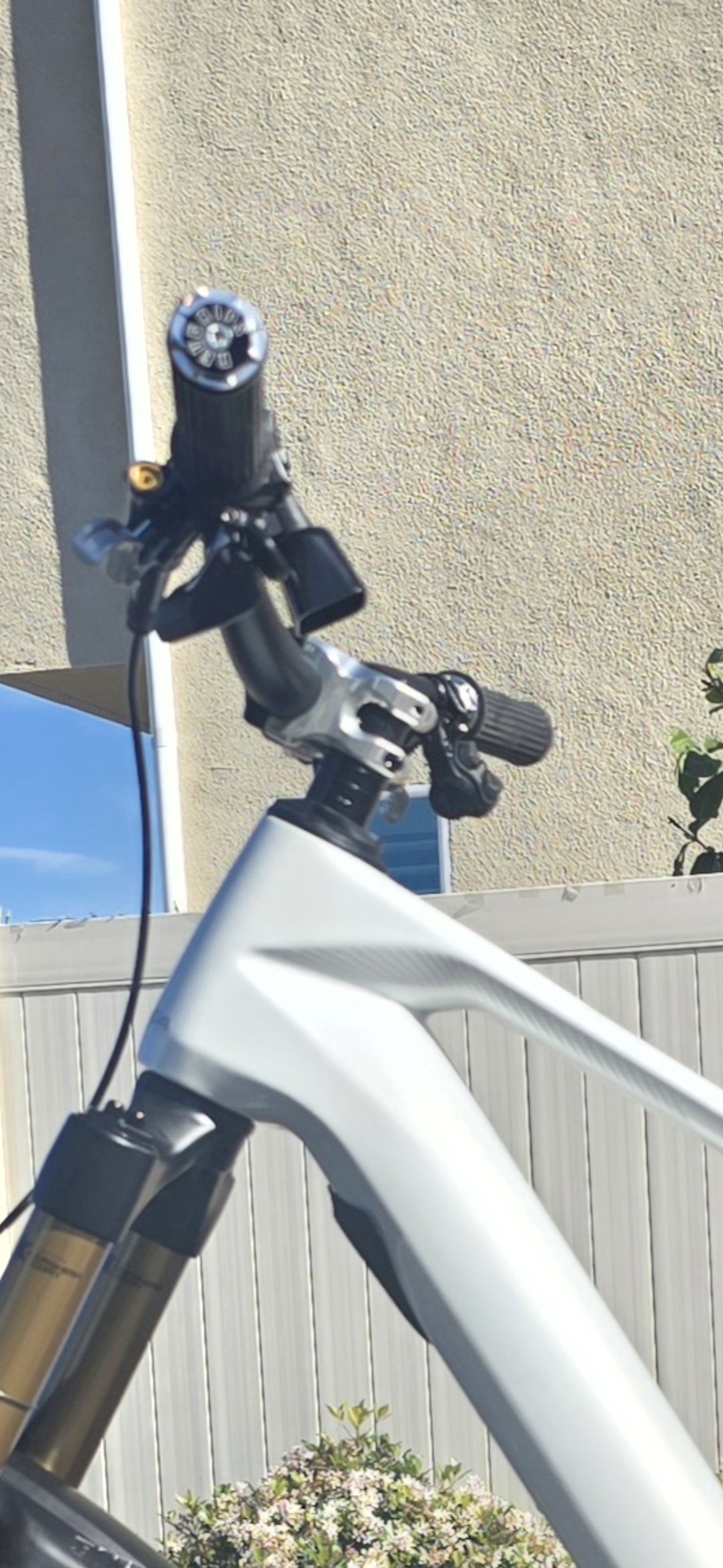

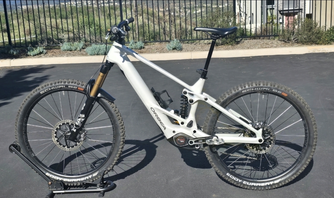

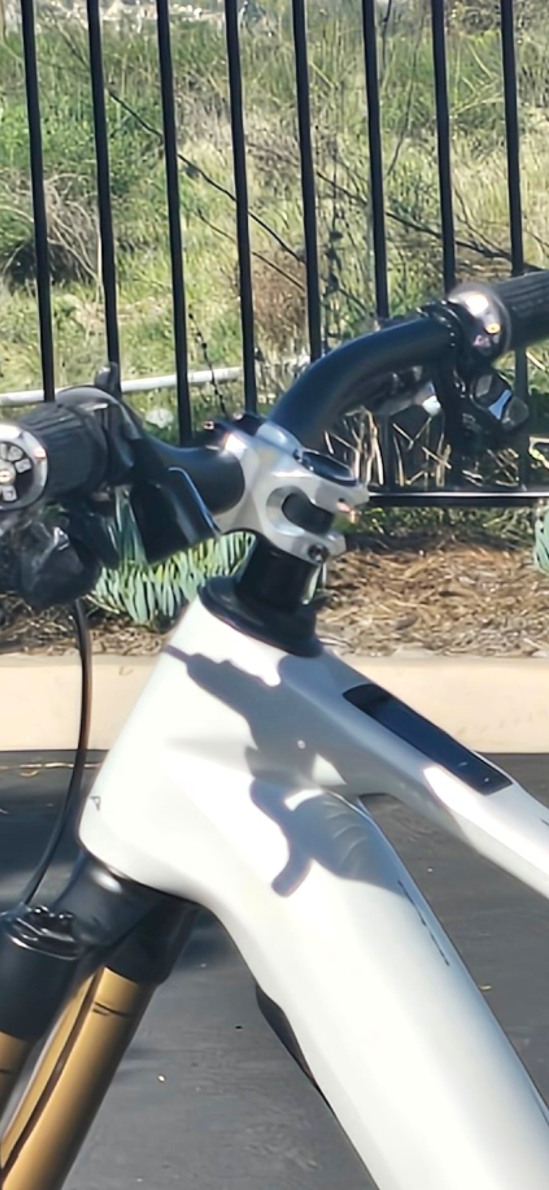

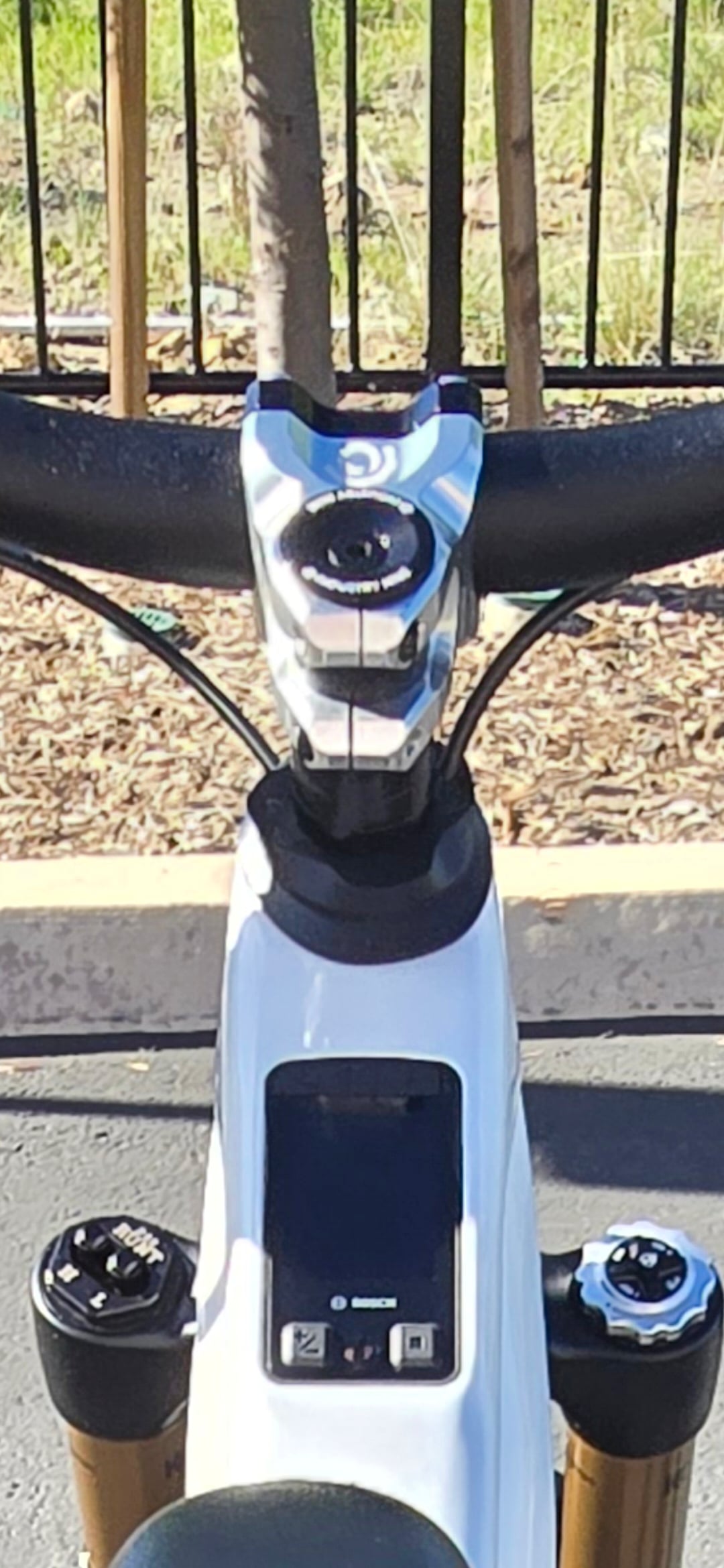

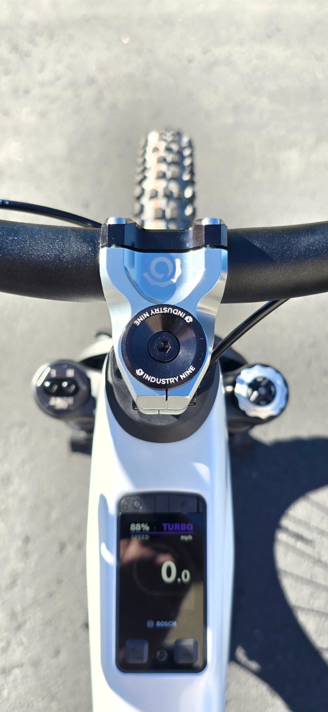

View attachment 174983 View attachment 174984 View attachment 174985 View attachment 174986
Did you do this primarily to keep the rear brake hose outside of the bearings, instead of inside? Or maybe because you dislike the stock knock block?
Your fork does not contact the downtube, but I guess this is a problem on certain combos.
I'm going to disassemble my entire Wild and I will have 3 cables running through there, so I want to make the correct choice on the initial build so that I don't have to redo it again.
Can you add/ subtract stem spacers with this system easily or is this fixed?
Spacer installation is completely normal. Orbea's own spacers are needed as those do interlock the knock block system to stem. Orbea spacers are fine and in my opinion even looks good.
Sorry for the late reply mate. Been on business travel.
I did it for a few reasons. Mainly because I'm running full SRAM AXS Drivetrain and Dropper and was switching the stock brakes to a Shirgura set-up (Magura MT7 calipers/MDR-P Rotors, Shimano Saint Brake Levers with Oak Components Levers) and needed to install a Magura brake hose anyway. I only have 1 cable to deal with regarding the headset.
I run a SQLAB 31.8mm aluminum bar with 12 degrees backsweep (they don't come in 35mm) to offset some carpal tunnel issues and I am very partial to Industry Nine stems.
I do ~90% of maintenance/repair work on my bikes and dealing with internal cable headset routing isn't an issue for me.
