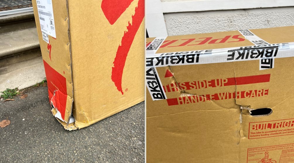

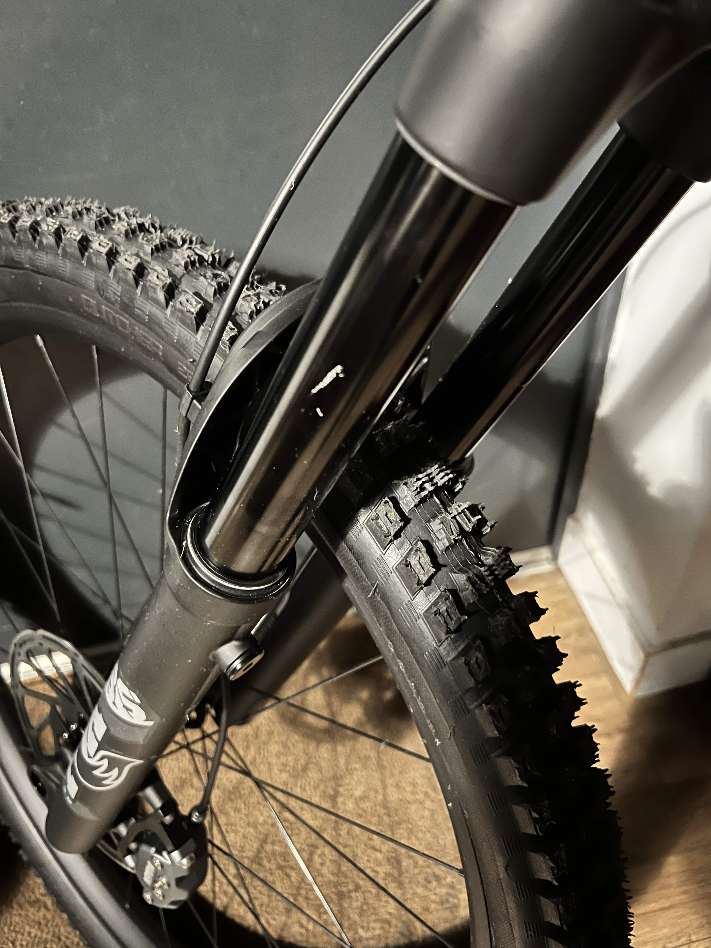

Hi everyone,
I need some advice or help regarding a nightmare situation. I bought a brand-new Specialized Turbo Levo from IBKBIKE in Spain. It was delivered 2 months ago with a deeply scratched fork (damage caused by FedEx during transit).
Since then, the seller has been blocking everything, refusing to repair or replace the part. They keep shifting the blame onto FedEx, leaving me with a €5,000 bike that I cannot use.
I have already contacted Specialized France, but the situation is still stuck. Has anyone else had similar issues with this dealer? It’s truly disappointing to see such poor service for a premium brand like Specialized.

Look, damaged stanchions are proper annoying - I'd be fuming too. But honestly? Sand it smooth, ride it, and never buy from IBK again. @Robson already gave them the review they deserve, and now we've got two people saying they're terrible to deal with.

In France, the procedure is clear: if a package is delivered with visible damage, you must write 'formal reservations' (réserves) on the delivery note. This is exactly what I did. Therefore, the damage was officially reported at the time of delivery, and the responsibility of the carrier is engaged. Thank you for your feedback.

That totally blows receiving a new bike that has been damaged. Having been in a similar situation on occasion, I totally get your disapointment.
Sometimes you have to ask yourself, is it worth my time, effort and general headache inducing fraustration, trying to deal with a Seller who is making it difficult and costly to return a product.
If you would like to just deal with the situation yourself, you have several repair options.

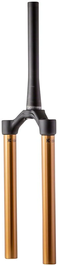

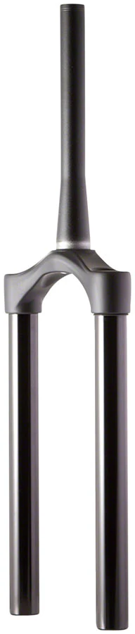

Repair Option One: As others have rightly mentioned, your cheapest, quickest, and easiest option is to buy some black acrylic nail polish. Dab the polish into the scratch. Buff the polish so that it's flush with the stanchion. Bob's your uncle, ride your bike like you stole it. You will occasionally need to reapply the polish to the scratch, it will wear off with time.
Repair Option Two: You can buy a brand new Fox 36 Upper Stanchion for about $280. This option is your absolute best repair option and will make your damaged fork as good as new.
I would suggest contacting the Seller or shipping company and see if they would be willing to pay for a new upper stanchion or at least a portion of the replacement cost. This avoids the hassel of return for all parties involved and the damage to the fork is completely taken care of.
The process of replacing an upper stanchion can be easily done and is not difficult. However, it does requires tools and some mechanical skill. You will need to completely disassemble the damaged fork in order to swap stanchions, the air shaft, and fork damper. You will also need to swap the lower fork crown seal and install it on the new stanchion. Lastly, you will need to cut the steerer tube down to the correct length and install a new star nut. If you are not mechanically inclined, your local shop can easily perform the service for a small labor fee.
Fox 36, Upper Stanchion, Performance
Fox 36, Upper Stanchion, Factory Kashima
