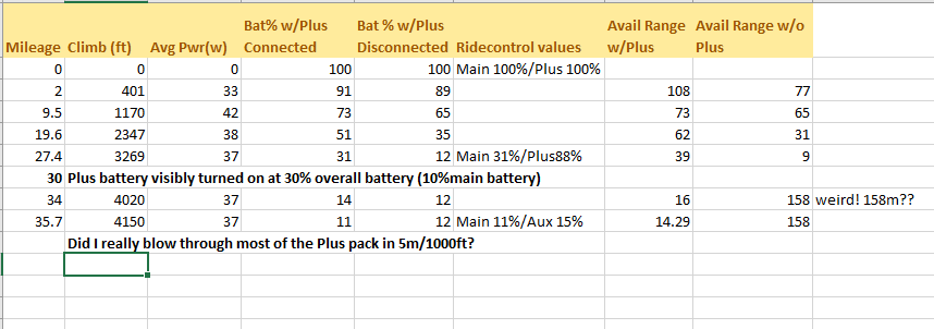

Ok, I took some readings while riding with the Plus pack. It is kind of a pain since RideControl, and whether or not the plus pack is connected gives varied readings. Stop, get a reading, pull the Plus plug out, get a reading, if internet see what RideControl has to say. I need to do this a few more times to make sense out of it since I have more questions now than I did before. My ride was mostly on level 2, with boost turned off on downhills. Bike: '21 Trance w/625wh main, 240wh plus, 100pct charged. Conditions: 40F, batteries warm before starting, lots of dirt fire road or unmaintained dirt road, some asphalt, some of dirt roads sticky. I will post elevation chart in next post.

Ok, I took some readings while riding with the Plus pack. It is kind of a pain since RideControl, and whether or not the plus pack is connected gives varied readings. Stop, get a reading, pull the Plus plug out, get a reading, if internet see what RideControl has to say. I need to do this a few more times to make sense out of it since I have more questions now than I did before. My ride was mostly on level 2, with boost turned off on downhills. Conditions: 40F, batteries warm before starting, dirt fire road, some of it sticky. I will post elevation chart in next post.
