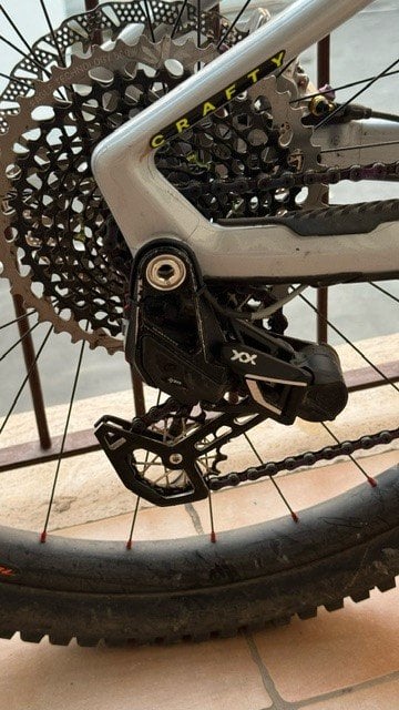

I've been wanting to get the Sram powercord for my AXS derailleur for a while but the over 160 euros required have always held me back.
Yet another battery change on the fly on the trail, however, made me change my mind and so, still convinced that I didn't want to spend over 150 euros for a cable, I built my own. At motor level, the only thing I had to do was to have the port on the motor enabled for high absorption by a Bosch centre.
Total cost of the work:
8 euros for the protection of the battery compartment of the Sram Axs derailleur (which I already had)
1.5 euros for a 3A step-down module
8.8 euros for the Bosch cable for third-party HPP applications
heat shrink, double core cable, and epoxy I already had them.
Once the adapter was made I resined everything with elastic epoxy resin.
tested it in the dry and it works, we'll see over time if it proves reliable (in the meantime I'm still going around with a spare battery) and how it goes in wet and rainy conditions.

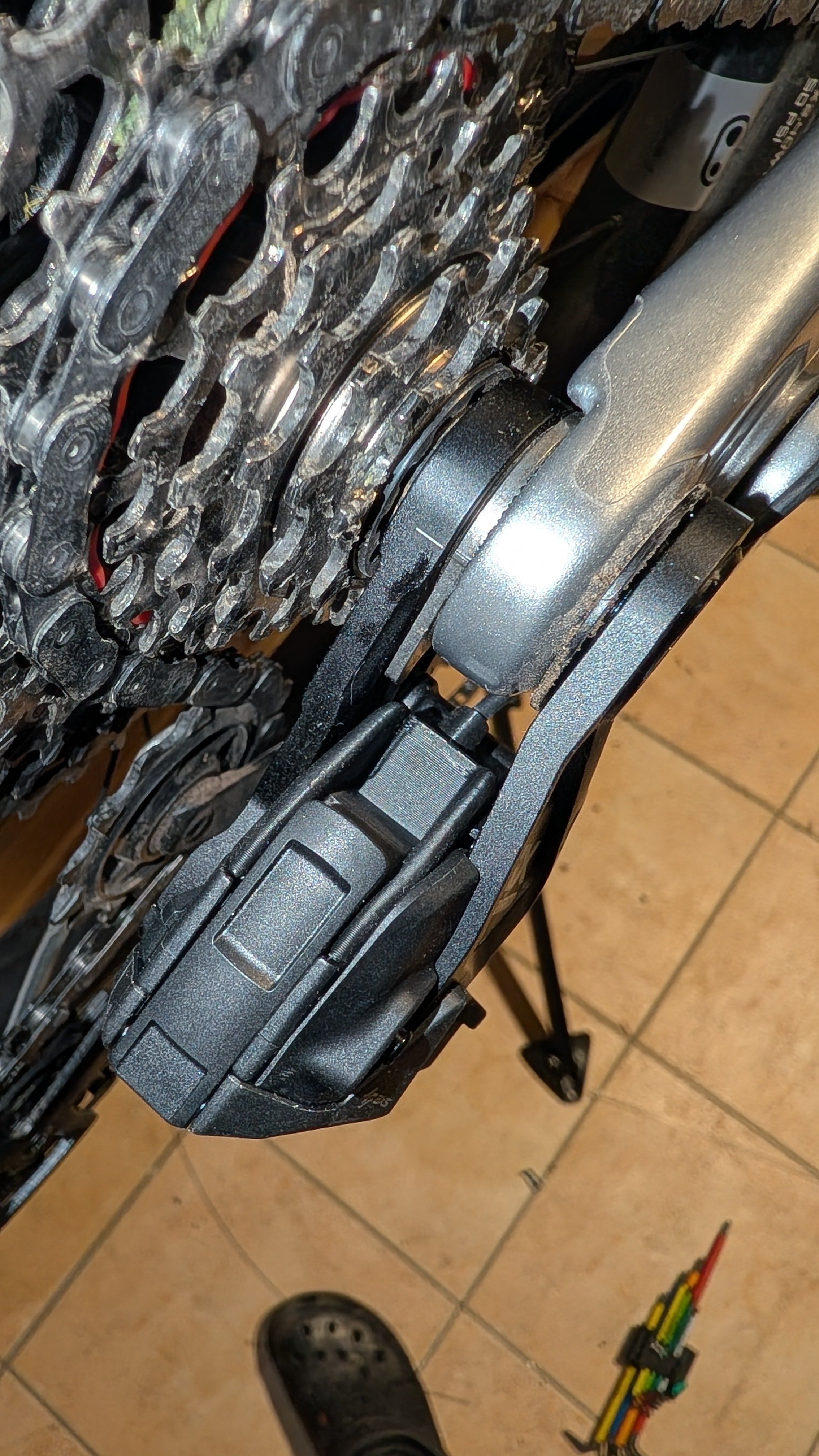

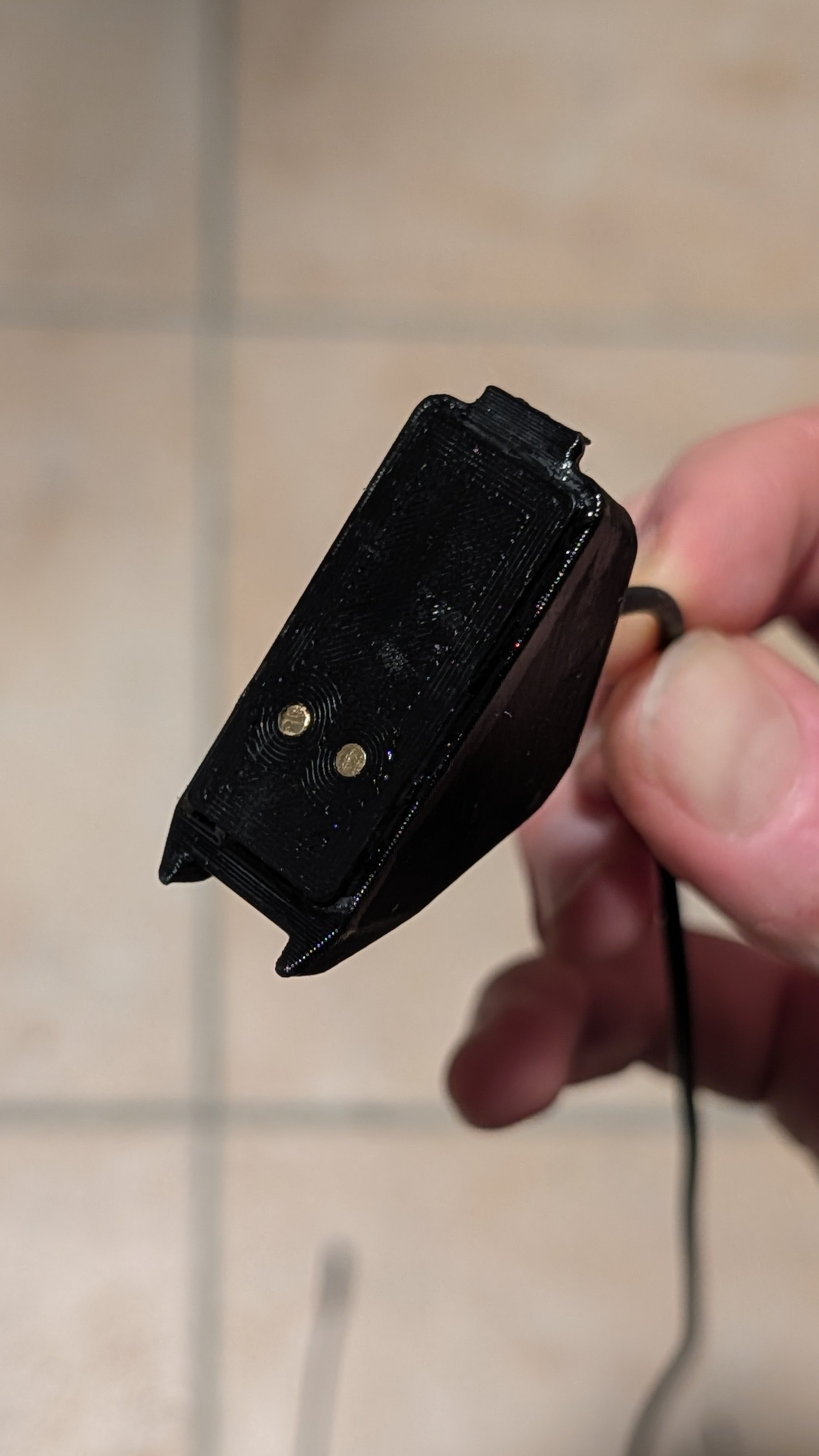

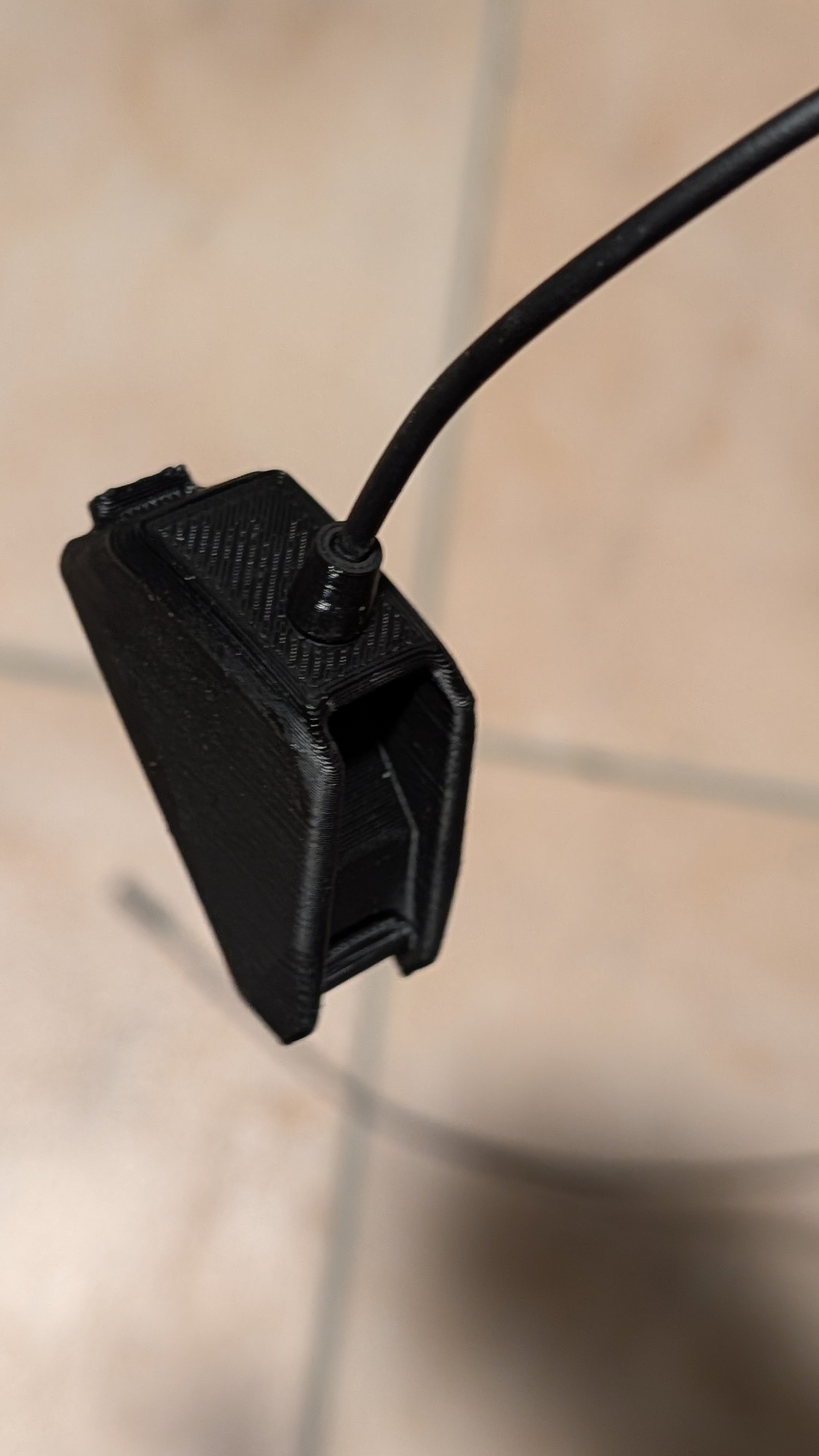

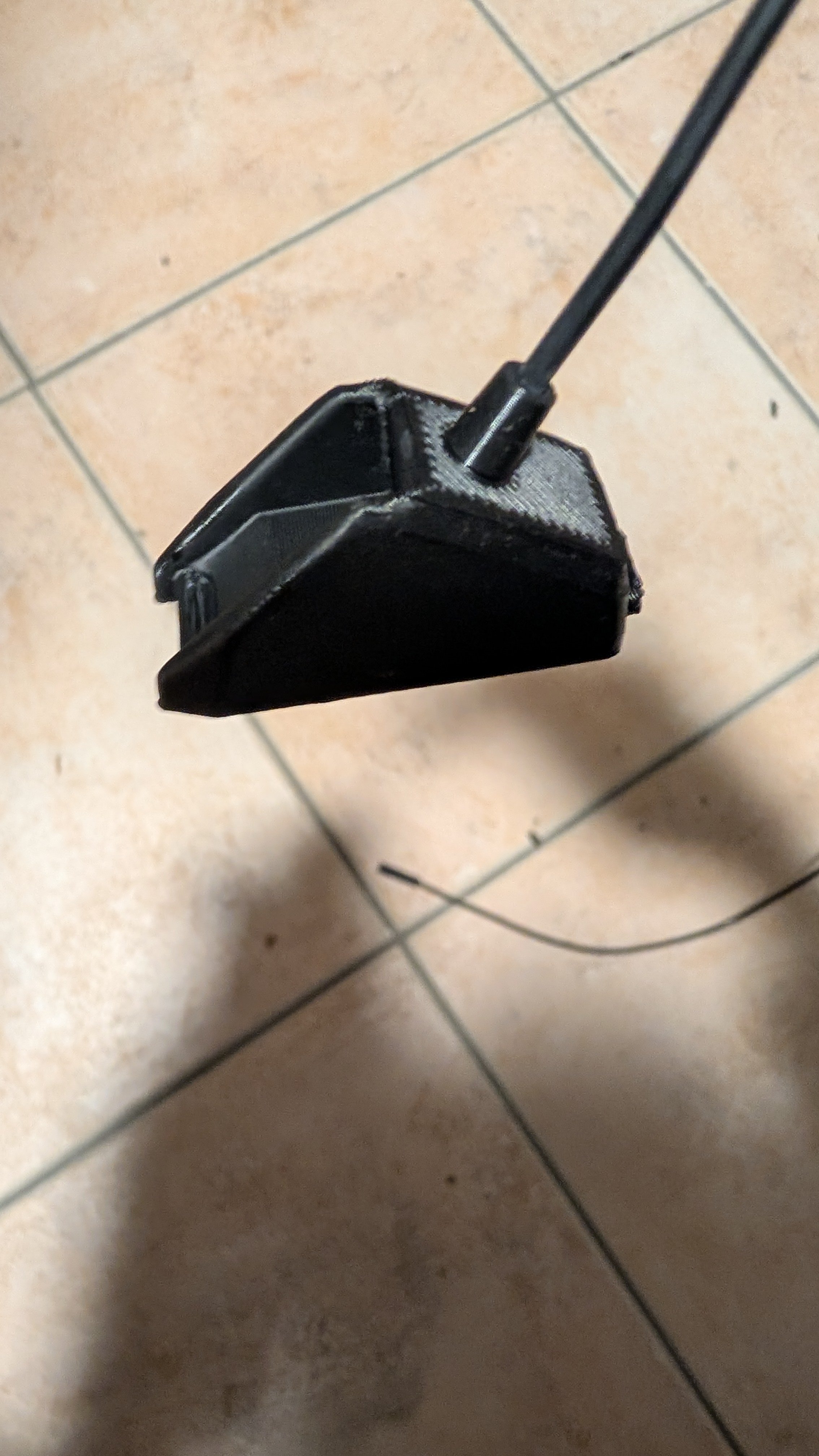

I just built the cable myself. Redesigned it a little bit because on the AXS GX the mounting point of the battery connector is slightly different. Case ist selfmade (3d printed ABS and TPU for the bend protection) Nice profit SRAM 🤣
Some soldering and glueing needed.
On the higo connector blue wire is - and black wire +
BOM
2.5mm brass Sticks for contacts.
DCDC step down set to 8V
Higo Micro A Cable (DJI Avinox)
HIGO-S2-MA
PXL_20251126_165502013.jpg PXL_20251126_165645763.MP.jpg PXL_20251126_165657734.jpg PXL_20251126_211824470.jpg PXL_20251126_211850841.jpg

Do you still have the stl files to print that? or are they openly available somewhere? Would love to go the same route before paying 130€ for that stupid cable.
Here you go. Ich printed the Housing with ABS and the Cable hose in TPU.

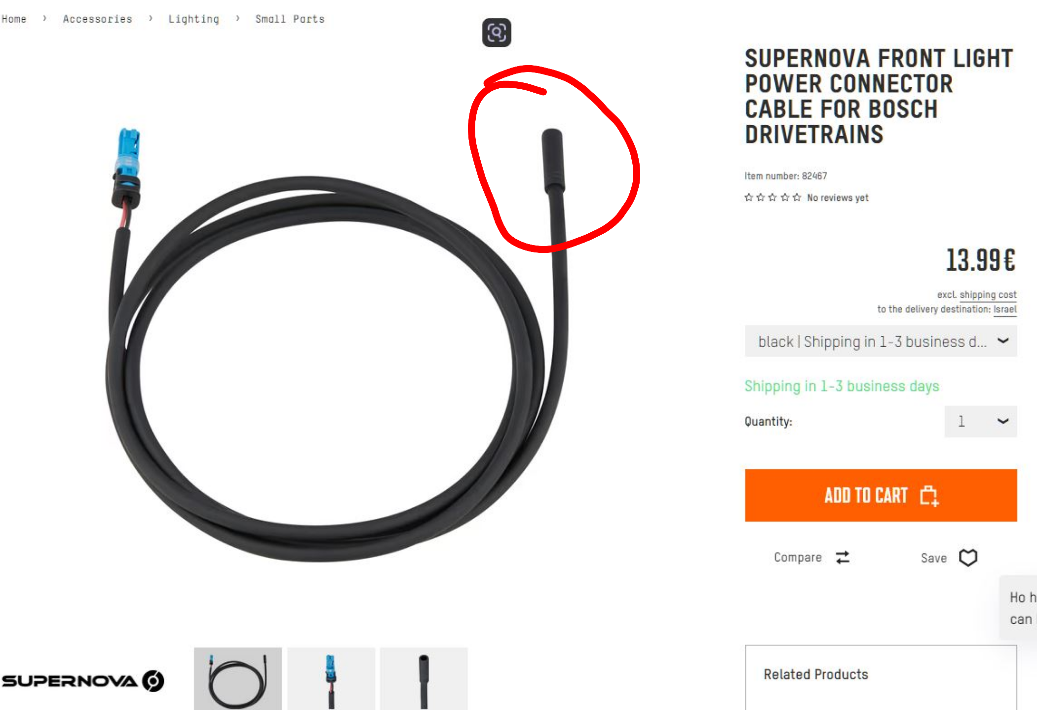

A guy in a different thread (I think it was the amflow one) used a Bosch cable to connect a lamp to the battery, which seems to have the required Higo Micro A connector on one side and a Bosch one on the other. The cable is even 1300mm long, so more than enough to cut down. Cable number is U-SNPC-BC1300 and at least in europe this thing is widely available but does cost around 14€ instead of 7€ what the above mentioned one costs. I have the cable already here and it looks ok to me. Connector says Higo. Seems like the cable connector is the one used in Z205BG P 00 S4 1000 instead of the Z205AG P 00 AW 1000 .. The contact inside should work though. Might need tape around it. But at least there is something else to be used.

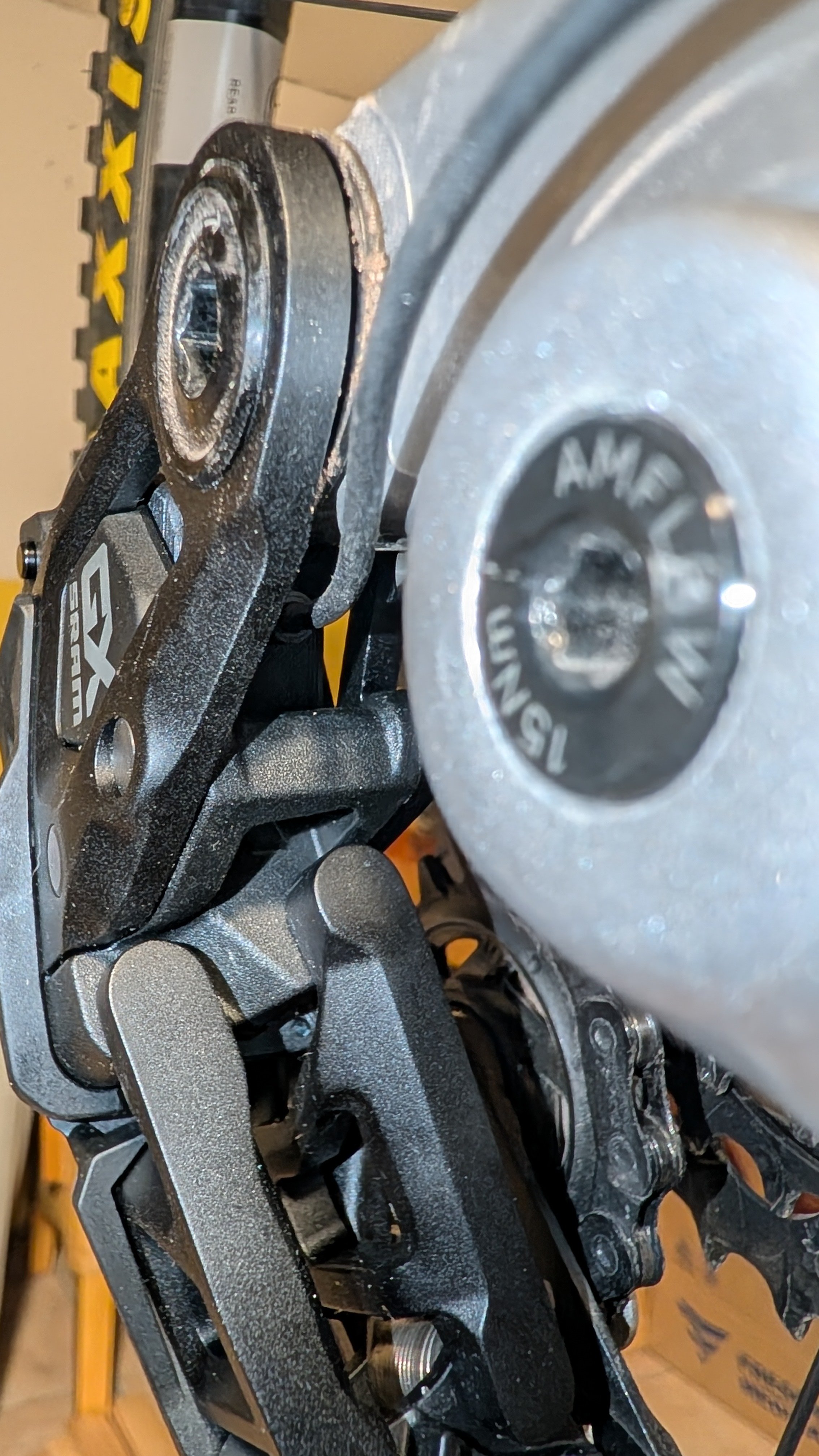

I just tested it out. Works flawlessly. Clips right into the cable on the motor. There is no slack in the connector. Looks like a perfect match. My only downsides are the step down modules. The motor applies 12.5v on the cable, tested 4 modules so far. None was giving me an output under 10v 🥳🥳 lucky me I guess
Some different ones but the same almost. The fourth one actually worked. It's on 7.8V coming from 12.5V. My soldering iron gave up when putting it all together.. Buying the cable from SRAM might be as expensive in the end lol :D

U-SNPC-BC1300 apears to be a universal No. for a lighting cable from which you select which motor it is for.
That part number on it's own is NOT for a cable with DJI connector on the end.
It has a female Higo connector on the end. The cable is thicker though (as expected for a cable to power a lamp). It fits perfectly on the drive unit cable of the DJI Avinox motor and sends 12.5V through. Nothing else needed really. The only thing that might NOT work is getting the cable through you chainstay on your bike since it might be to thick (connector has 5.3mm).. It does work on my Forbidden Druid Core though. Soldered it to a dc stepdown module that I set up to 7.8v output voltage. S1000 AXS derailleur works and smoothshift as well.

Hi, please note I meant the connector circled (see attach). Is this Higo plug suitable for connecting to DJI?
