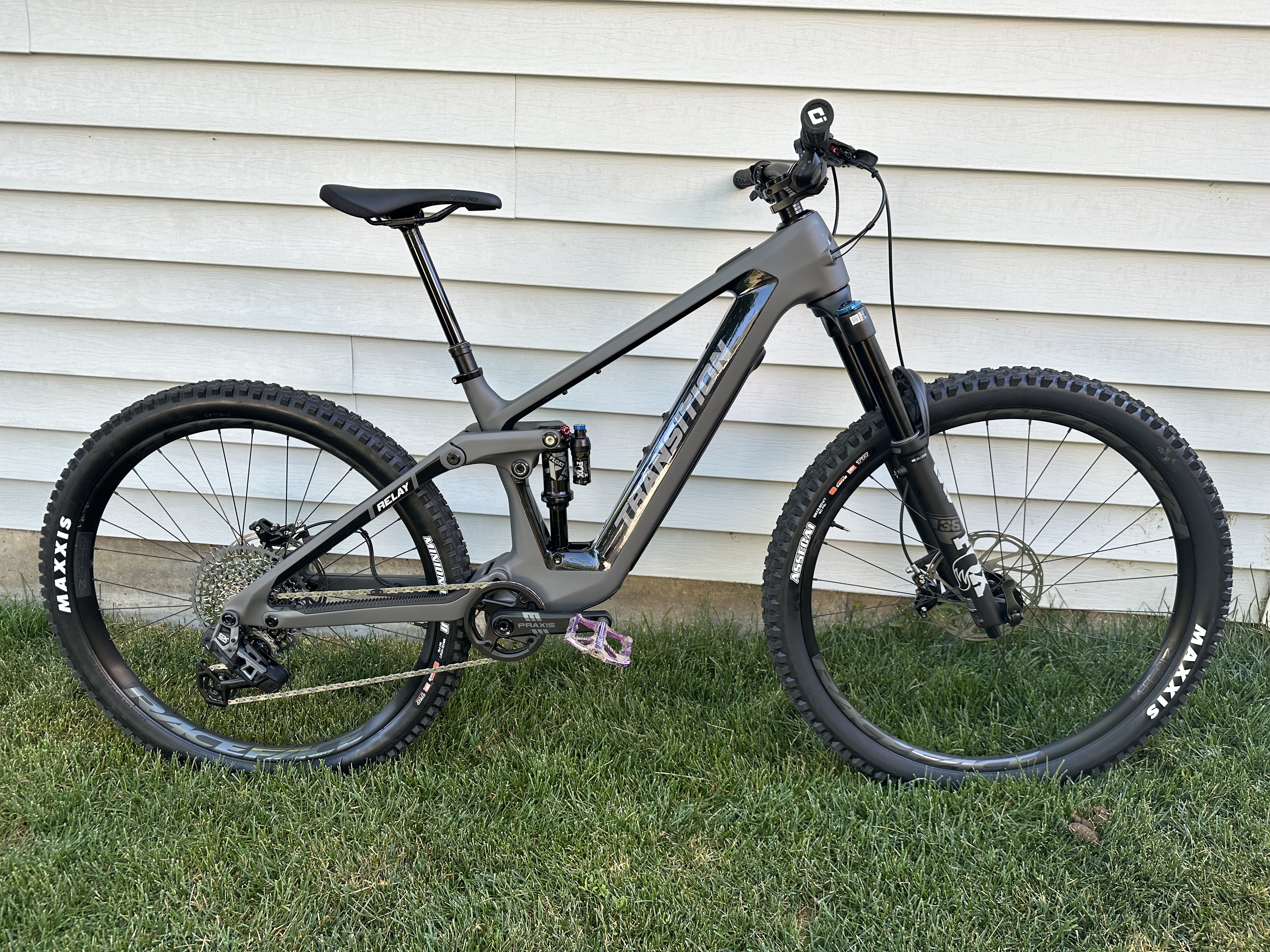

My medium GX AXS finally made it! Just finished my first ride on it and liked it a lot. Some details/thoughts:
  • Weight: 44lbs with battery, 39lbs without
  • Ride details: 11.5miles, 1433ft of vert
  • Modes used: 3/4 of ride was in the breeze setting (green). 1/4 of the ride in river (blue). Used the 12 second boost mode maybe 5 times to try it out.
  • Battery usage: 66% remaining
  • Impressions: felt like a natural ride, both up and down. The motor kicks in smoothly and is very quiet. Really impressed with the downhill feel/ composure.
  • Noise: minor "clunk?" coming from the battery area on repeated compressions. I am a fan of quiet bikes so I am going to have to do some investigation on mitigating the noise. Wasn't horrible my any means, but was present.
  • GX AXS: really impressed with the shifting - especially when cranking down. Definitely an upgrade from my XX AXS version one.
  • Wasn't expecting the motor coast "click/ free hub sound" to be as loud as it was. It pretty much drowned out the sound of the rear hub. If you buy hubs because of their sound and not because of engagement, then save your money....I wouldn't be tossing I9s on this ride because they sound cool lol. But I will swap out the rear wheel for a 27.5 at some point and will likely consider a nicer hub at that time.
Still some minor adjustments to work out on the suspension and need to figure out some pedals/ grips, but for the first ride I couldn't be more stoked!
