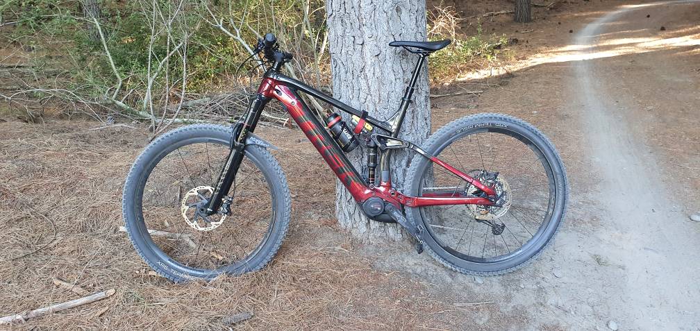

I just bought the rail 7 in black/red. I had to do a double take at first, as the paint job made it look like carbon.
I took it for a spin through a local forest last night, and it was outstanding. I still need to fiddle with suspension a bit, but I have zero doubt about bike choice.
It is as its name suggests... it rides like its on a rail.

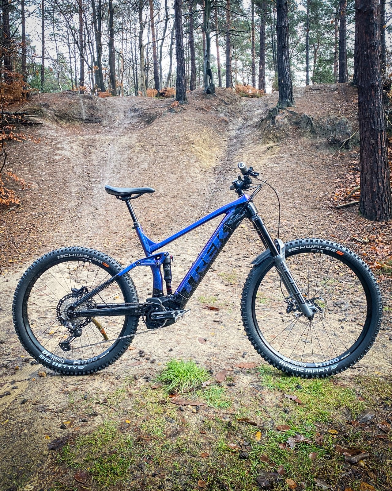

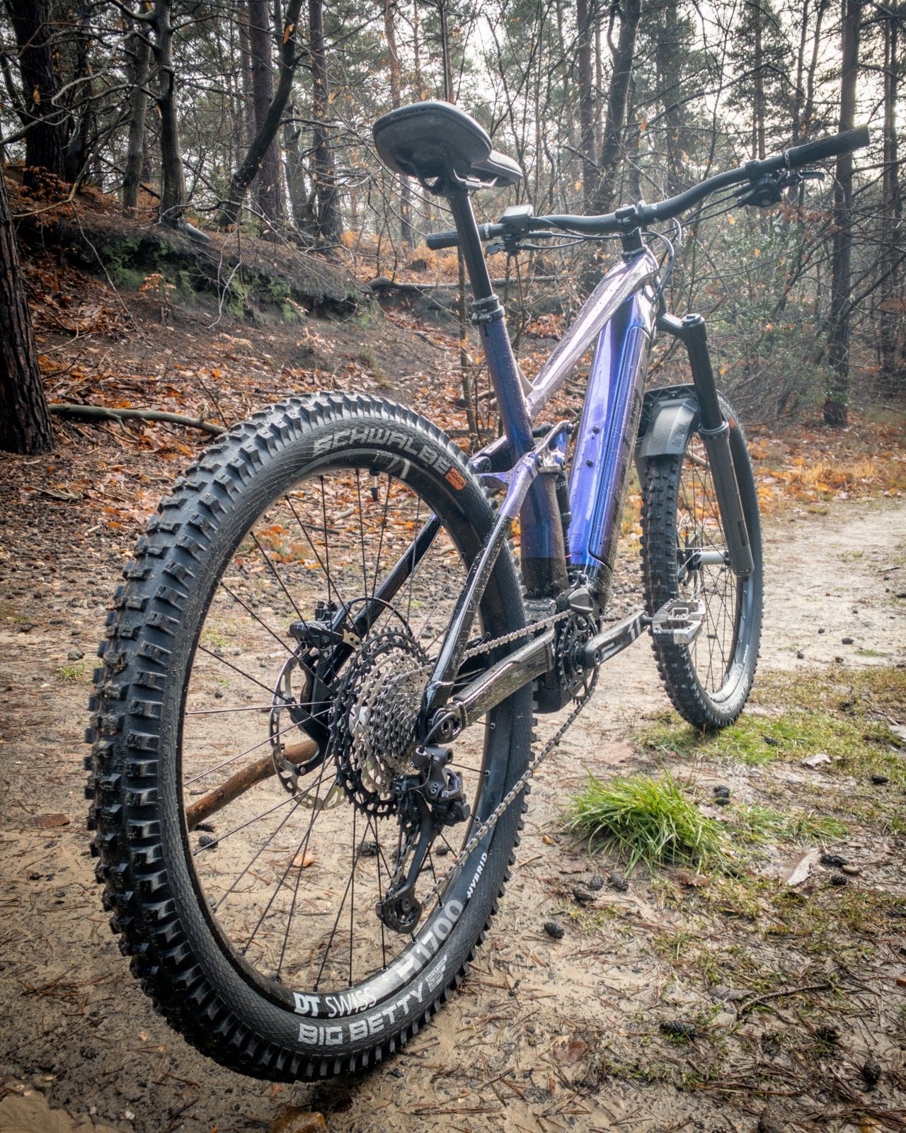

Ok some updates

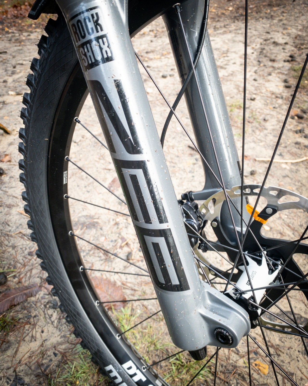

Zeb 170
Mullet with Magic Mary 29 front 2.6”, Big Betty rear 2.6” 27.5” on
head angle 63.3 degrees
BB height 334mm with flip chip in low (stock reading was much higher than Trek quoted height)
Deore brakes
210mm One up V2 dropper
XT Drivetrain
weight approx 24.1 KG

Great looking bike, interesting comment about thinking it looked like Carbon, have ordered this bike in a small for my wife, gets delivered before Friday hopefully.
Hope you enjoy it (y)

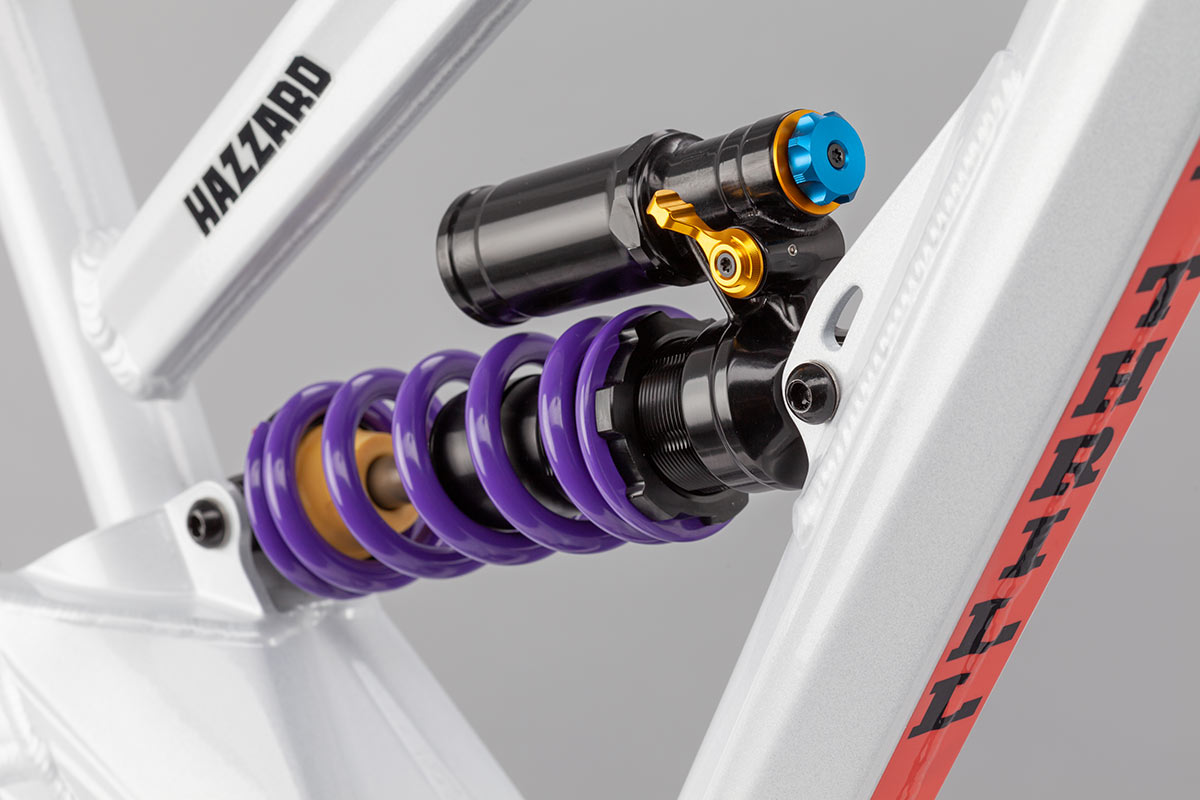

I can’t find a shock in stock. Have looked everywhere!
What are you looking for?
I think you have to be very careful choosing the correct shock for this bike. Taking into account Rob's height, the terrain he's riding, tyre choice, balancing the front and rear performance, safety, the importance of nice video ..
I can only conclude : Purple ..

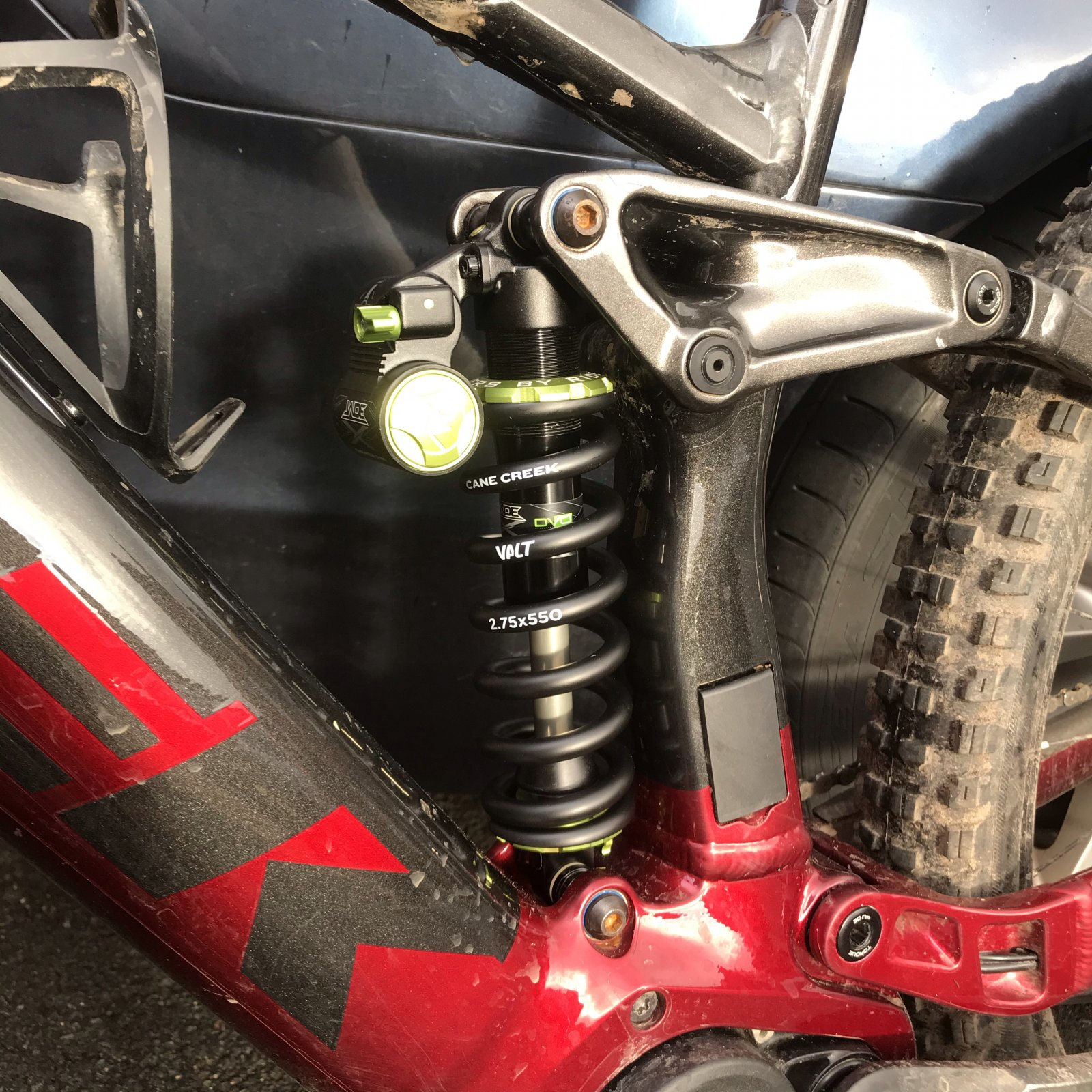

I too have a trek rail, so interested in a shock reccomendation
Depends on frame size. Small and Medium definitely have clearance issues, Large may do depending on the size of the reservoir.
I have a DVO Jade X 230*60 on my Medium Rail.
XL frame so hopefully something would fit! The question for me though, is it worth it in its performance vs price.
