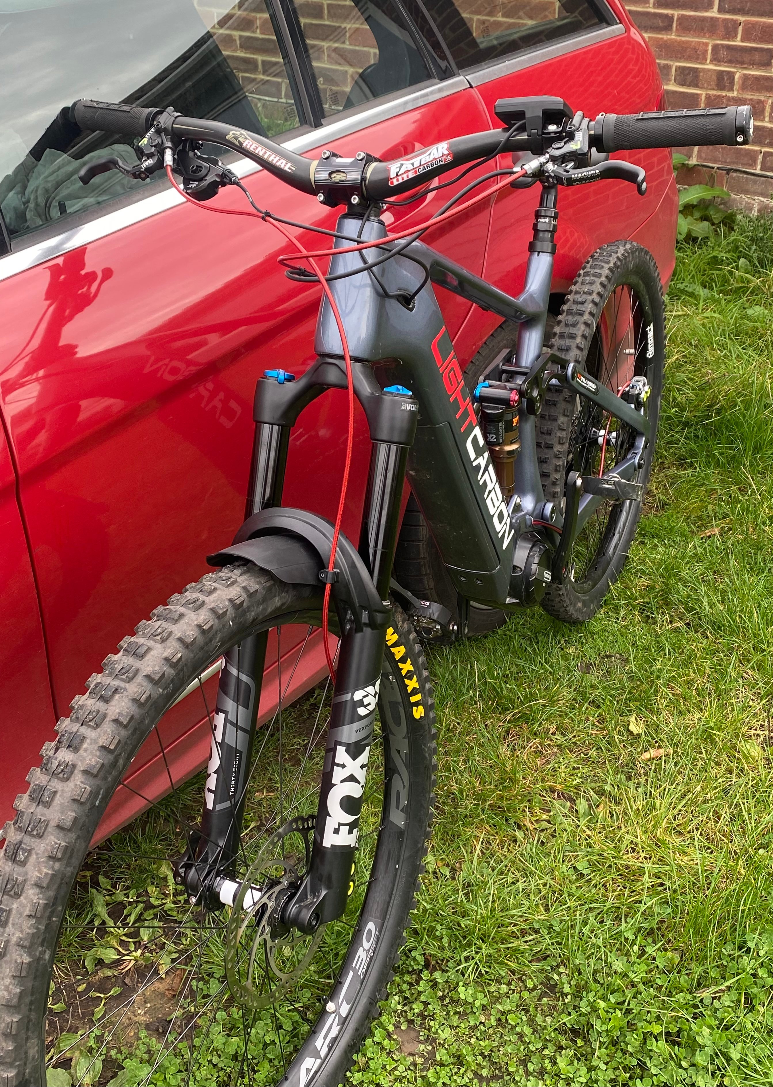

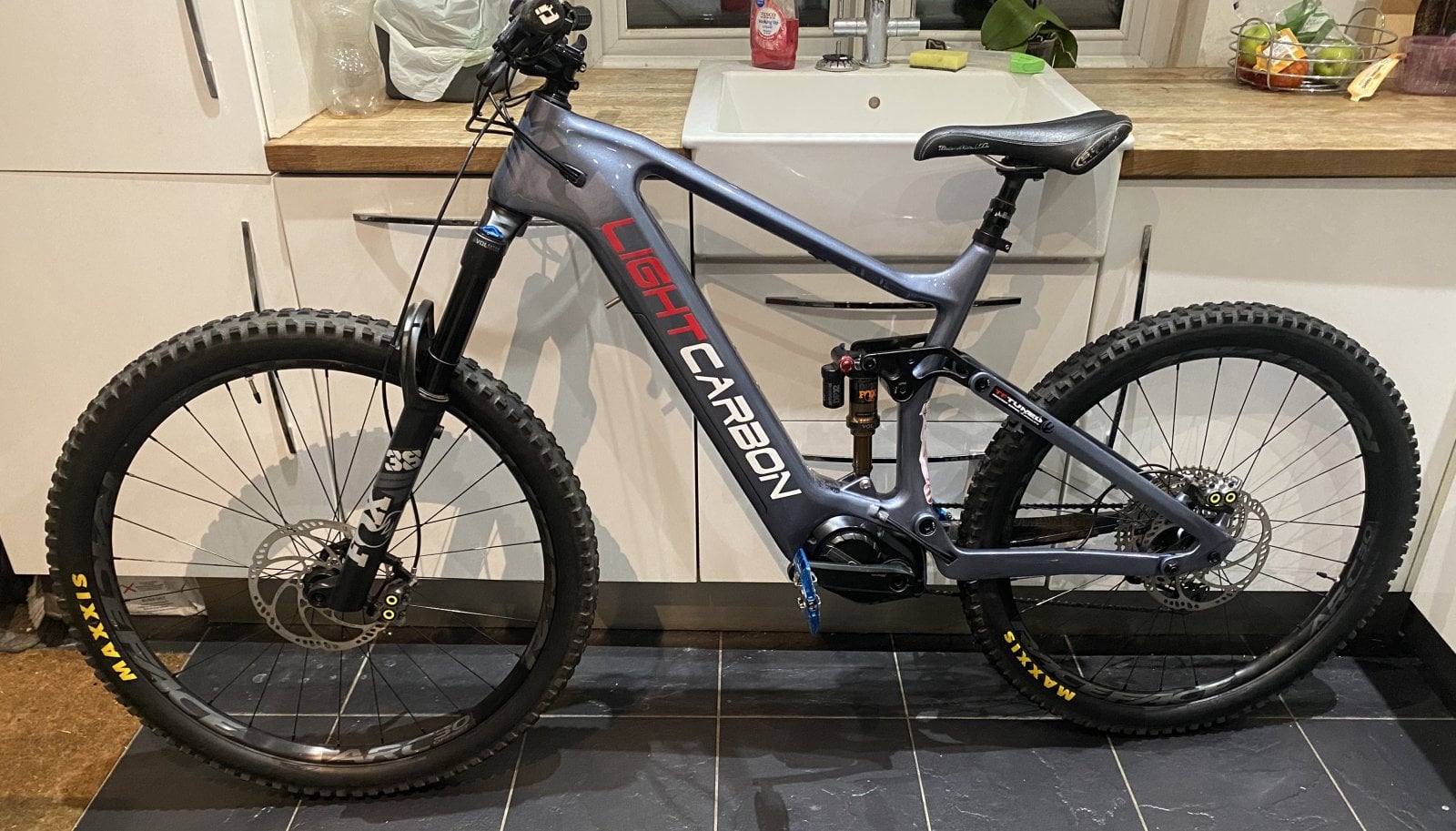

My Lightcarbon Lc4 😎
Its amazing that the extra stiffness is felt more than the weight. And I’ve bought the stem up a bit (because this has a longer steerer) which has made the front actually feel lighter.
roll on tomorrow!! To the WOODS! 🥳🥳

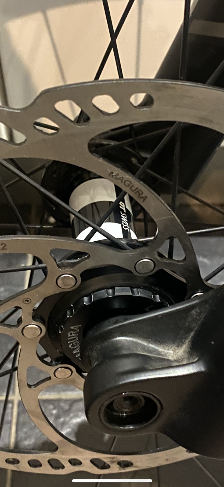

Magura Centre lock discs to suit the hubs.

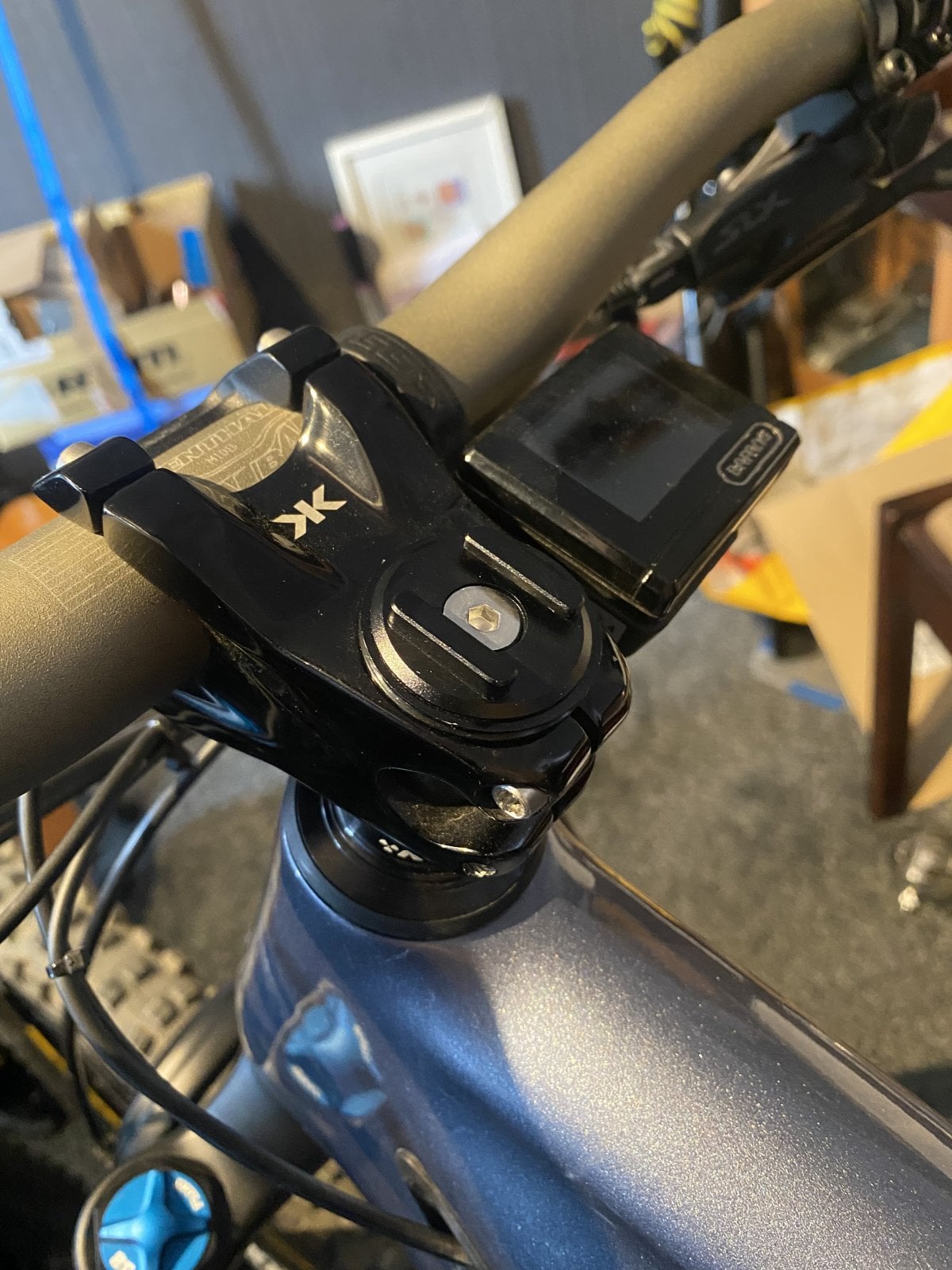

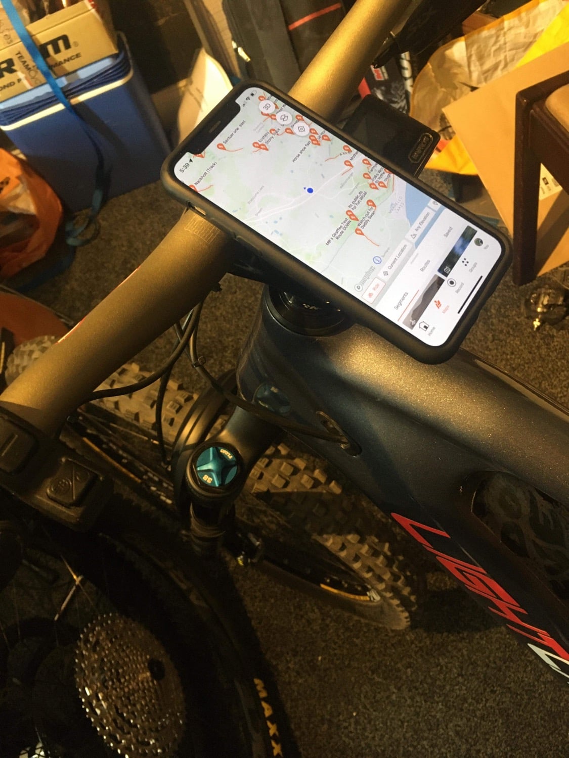

And SP steerer phone mount.
Only bugger is the seller of the wheels fitted non boost torque caps in the front wheel so waiting for those to arrive 😡.

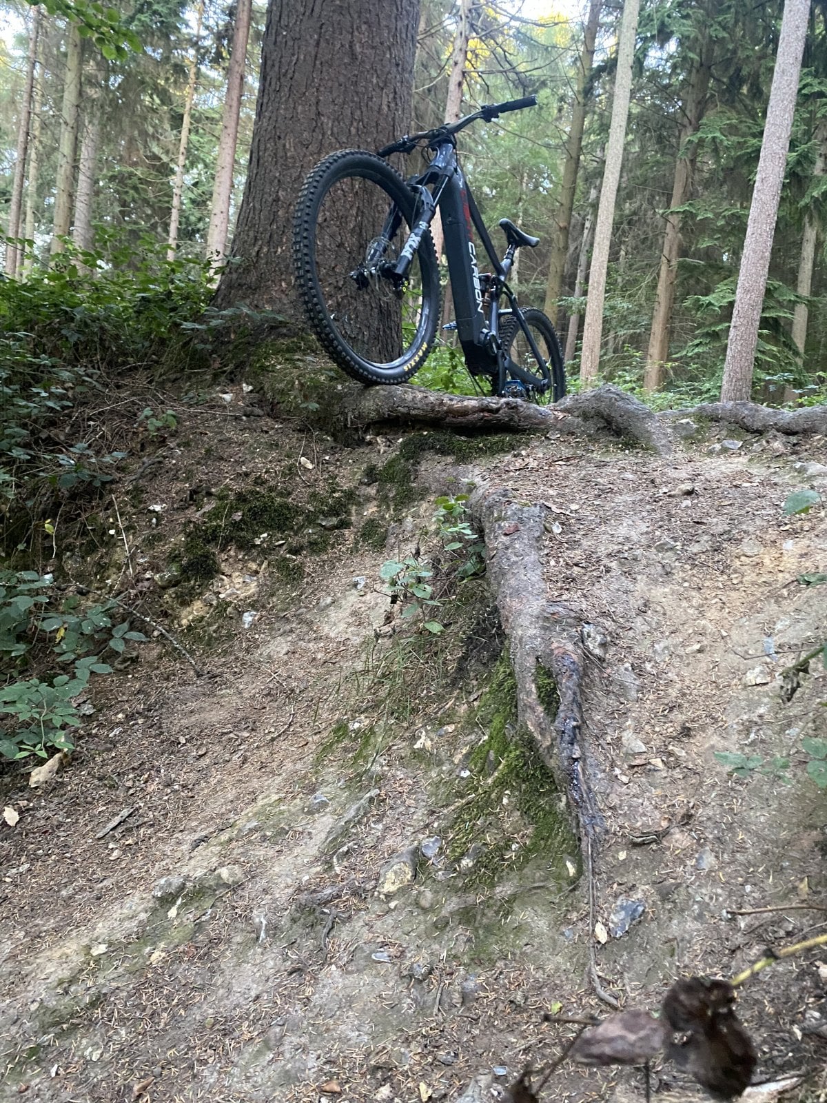

Took some mental effort to send that! Wasn’t pretty but I did it! 🥳

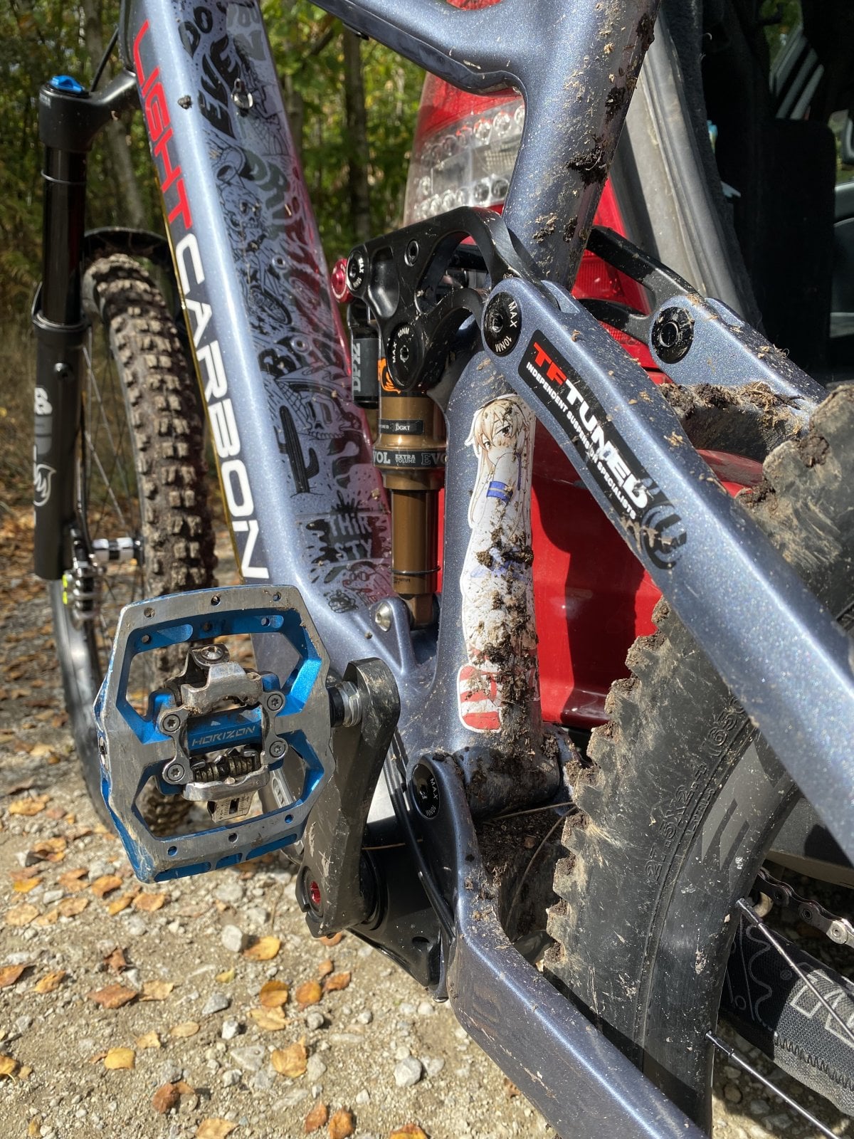

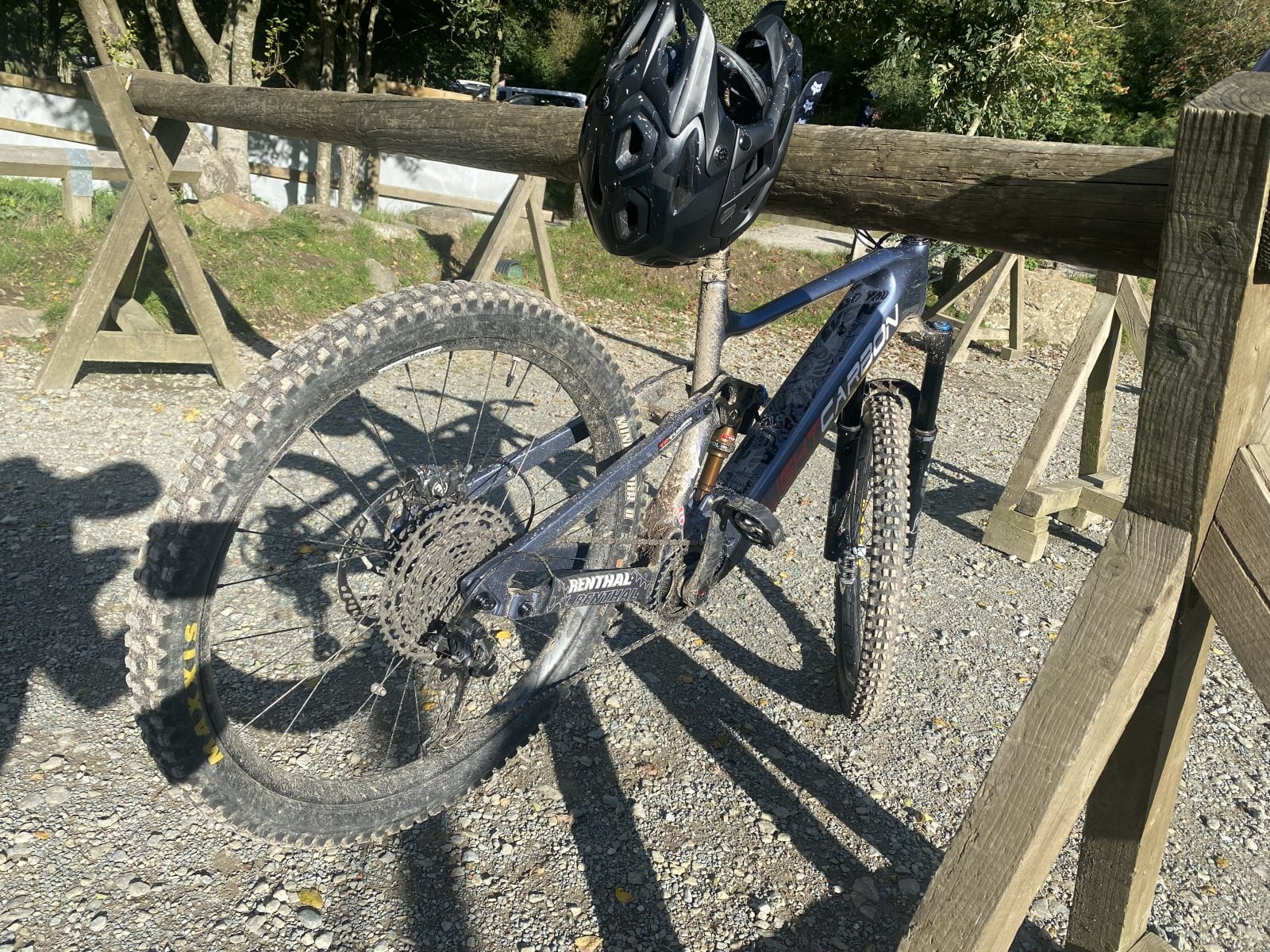

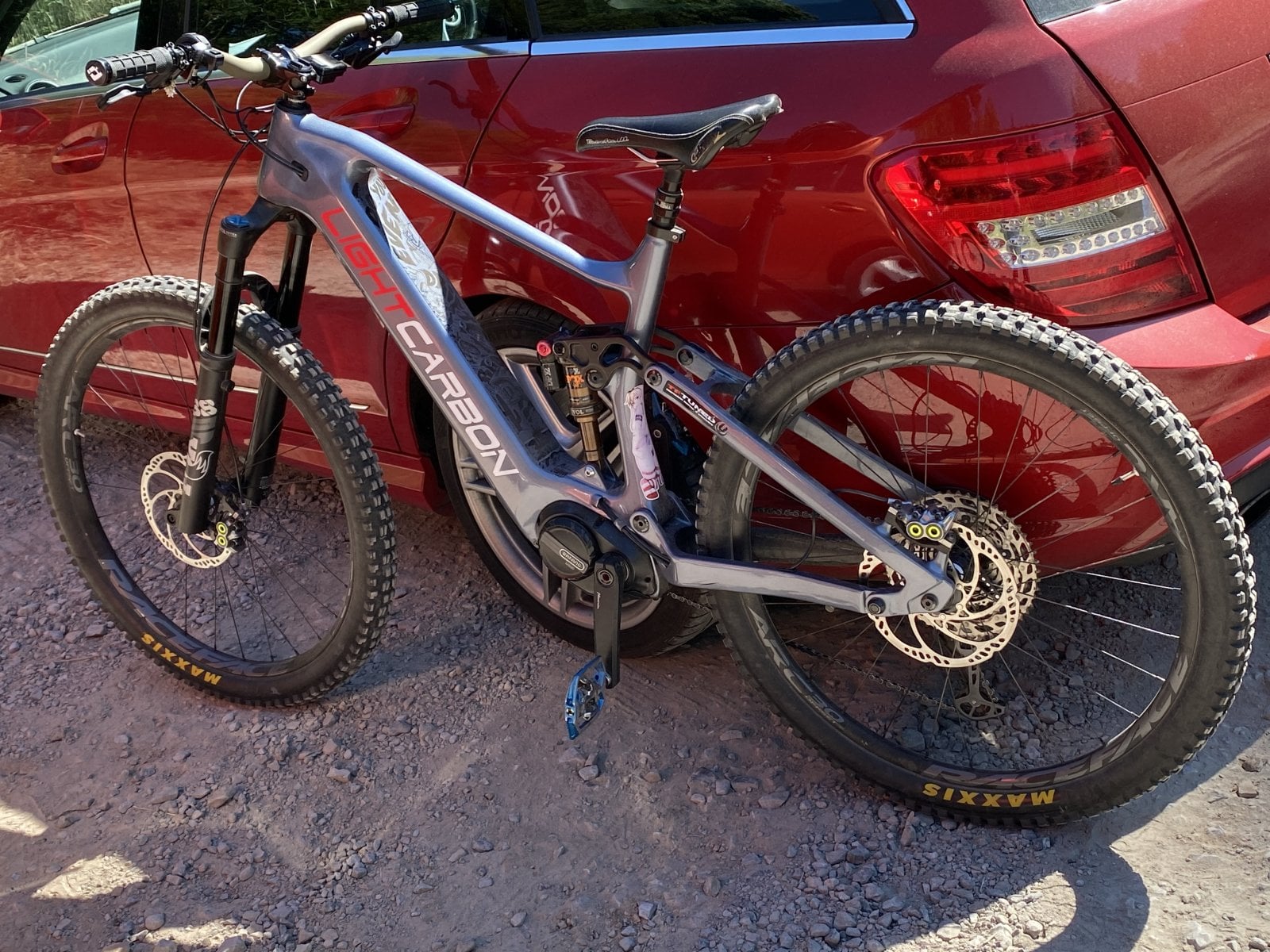

300 miles in.
A few things are becoming apparent!
Fox 34 isn’t man enough on the really rough stuff.
And the none boost wheels with boost adapters are quite flexible.
which makes the front feel soft and sketchy when hitting big stuff or fast rooty stuff.
but on day to day trail riding it’s great 😊

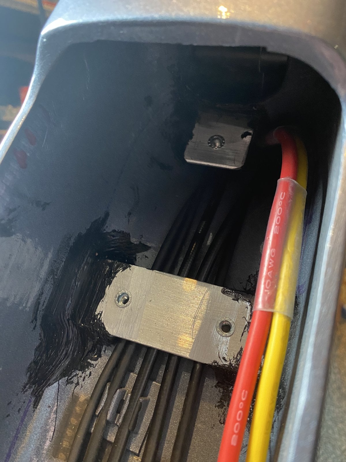

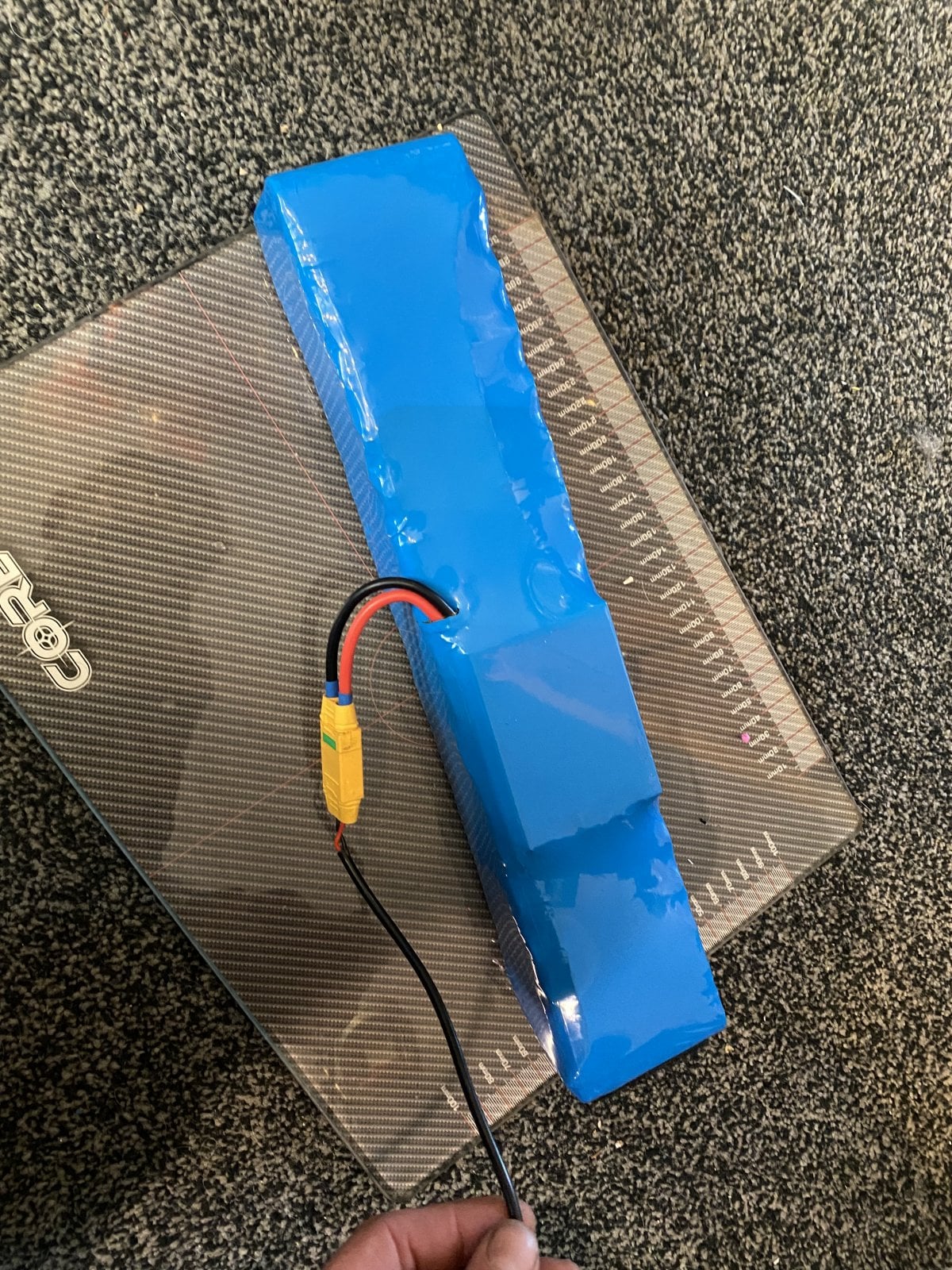

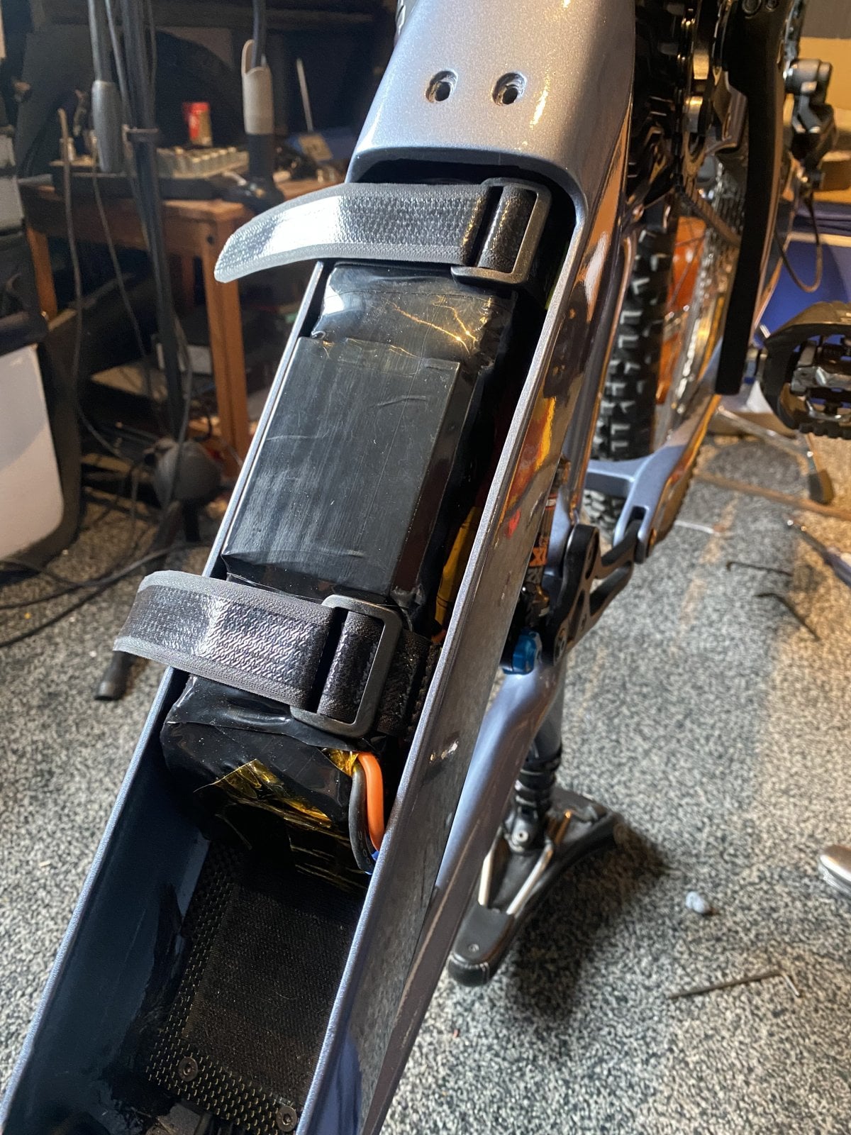

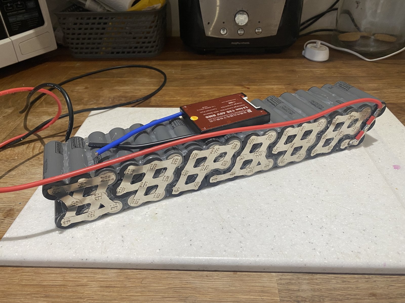

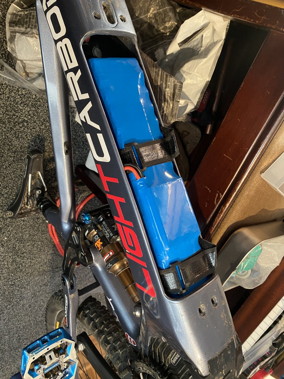

built a 19Ah 988 Watt battery for some long range riding, it’s an extra 13 cells so doesn’t add a lot of weight. Hopefully get 40miles in power mode 1

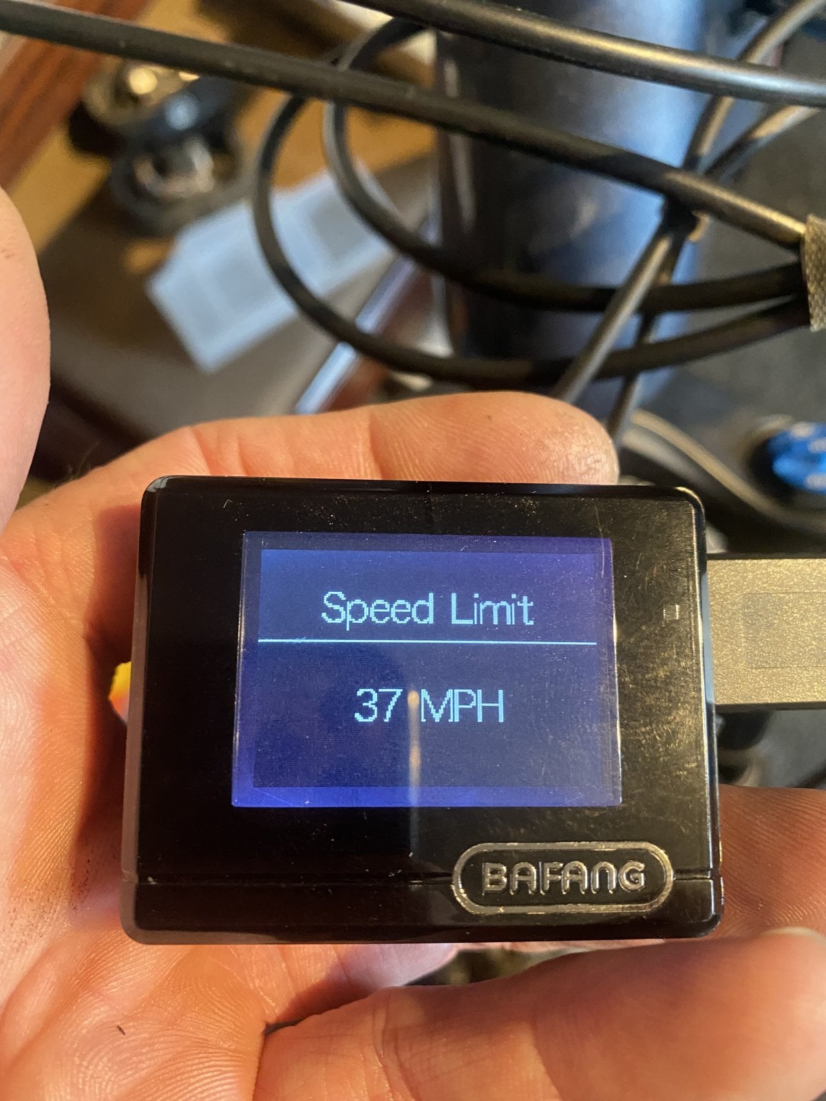

increased the speed limit to 37mph 🙂

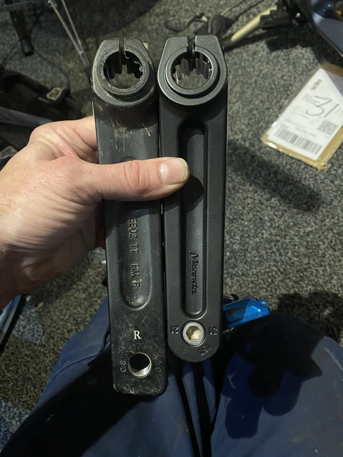

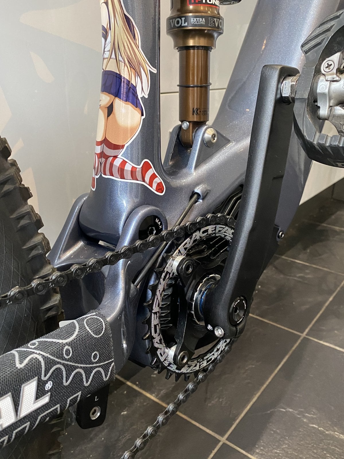

fitted the 150mm Miranda crank arms which feel great when riding, but boring as hell to look at 😖

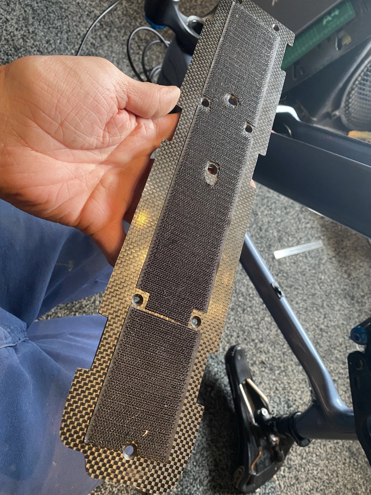

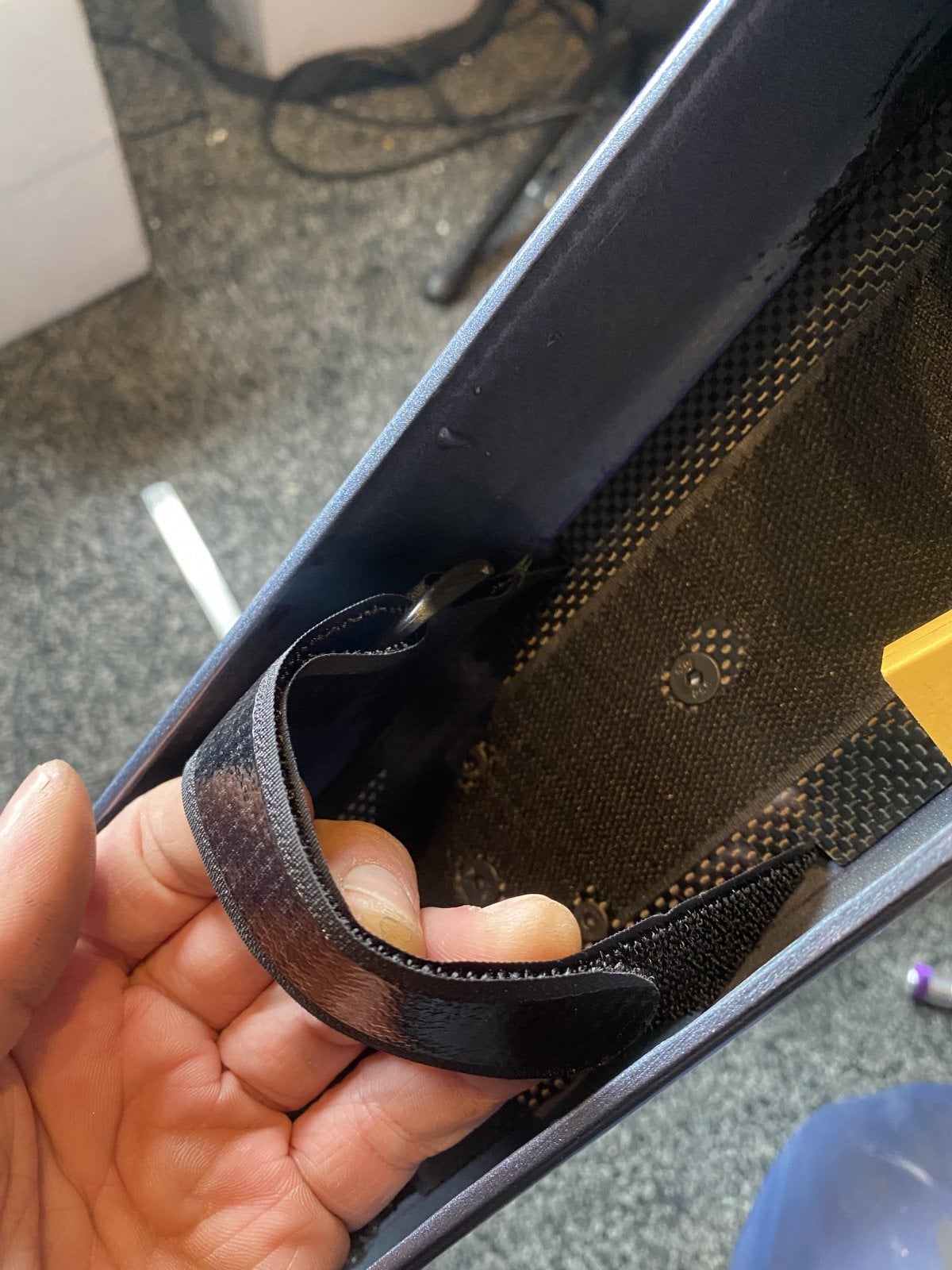

Three dumb questions regarding your 988 Wh battery pack...I'm just getting ready for my first DiV 27000 pack build for my second LCES004.

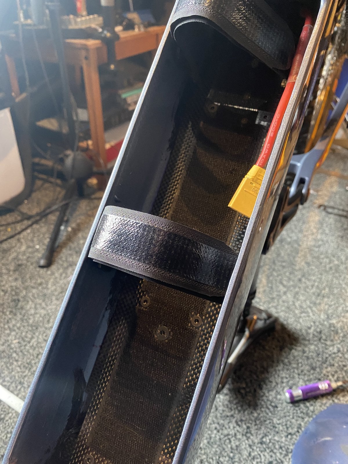

1. How do have your Velcro straps mounted to the frame internally? (good idea BTW)
2.Do you just pull out of the frame to charge? Looks like you plugged the key hole on the frame. I have a Bafang charging plug for the frame that I was going to attach to the hole like others have done.
Lastly, how's the range in general on the 988 Wh battery in power mode 1?

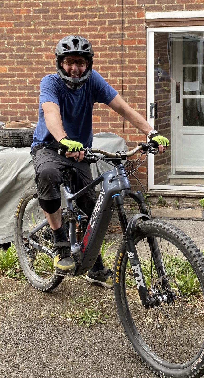

Great few days! My Lc4 had its first run around the block 🥳!
Felt very fast @ 28mph 😂
Surprised how light she is will weigh her later on.
Few jobs left to do!
Shorten front Brake pipe.
Battery cover upper clip.
Frame protection kit.
Lube the chain

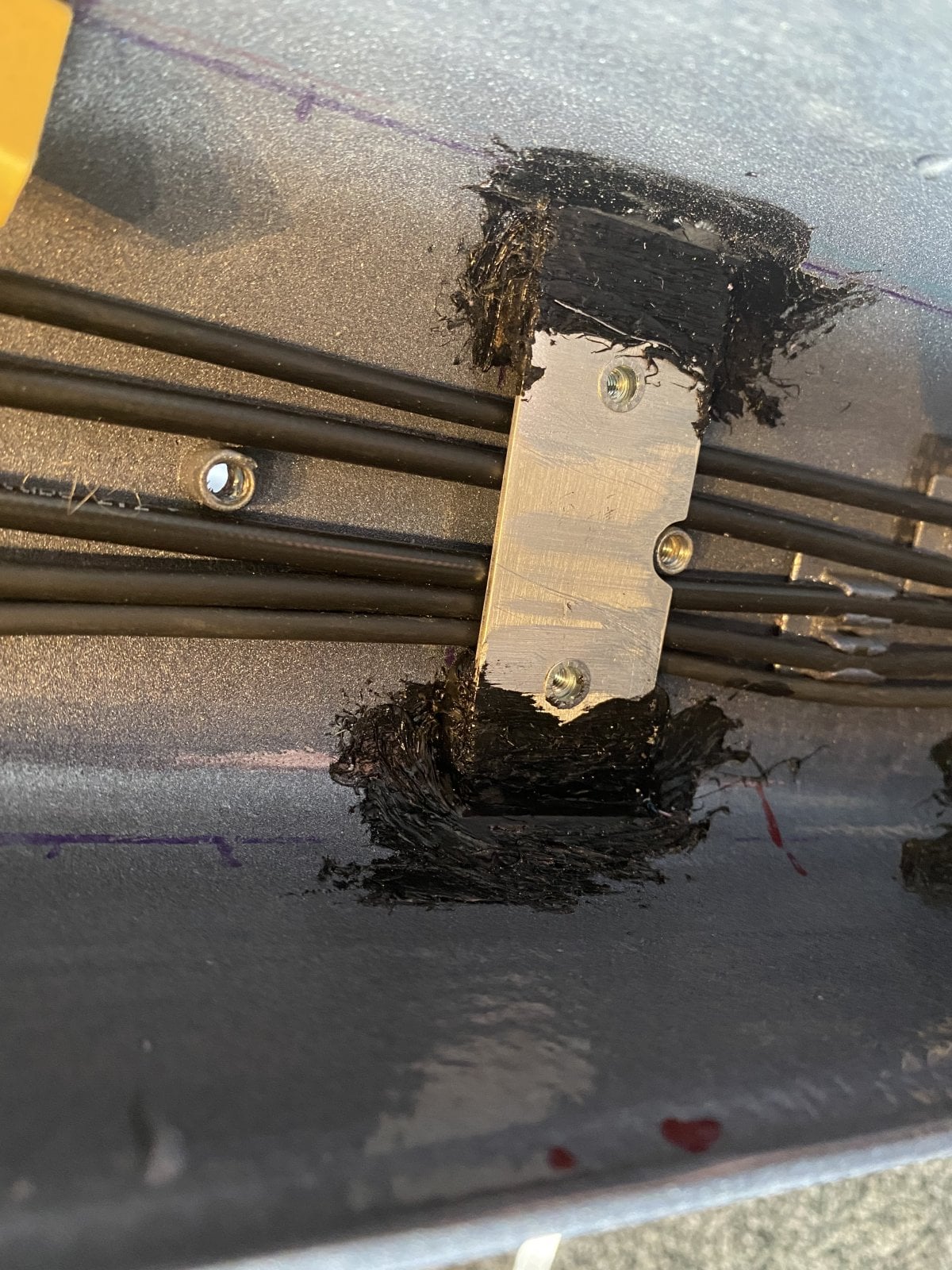

Oh, I see how the Velcro straps are attached to brackets and carbon mounting plate. That's pretty sophisticated and super secure-looking...very clever! I've got the plastic cover-plate hoping to modify. My plan was to stuff the lower frame tube cavity with foam and glue the Velcro straps to the carbon frame under the wire guides?
Cheers. I normally just pop the cover off and unplug and charge leaving the pack in the frame.
Whatever mounting system you create just make sure battery, Wires etc can’t chaff any edges, Carbon frames are conducive and a short would be a bad day.
On power mode one I get 40miles on single track in good weather.

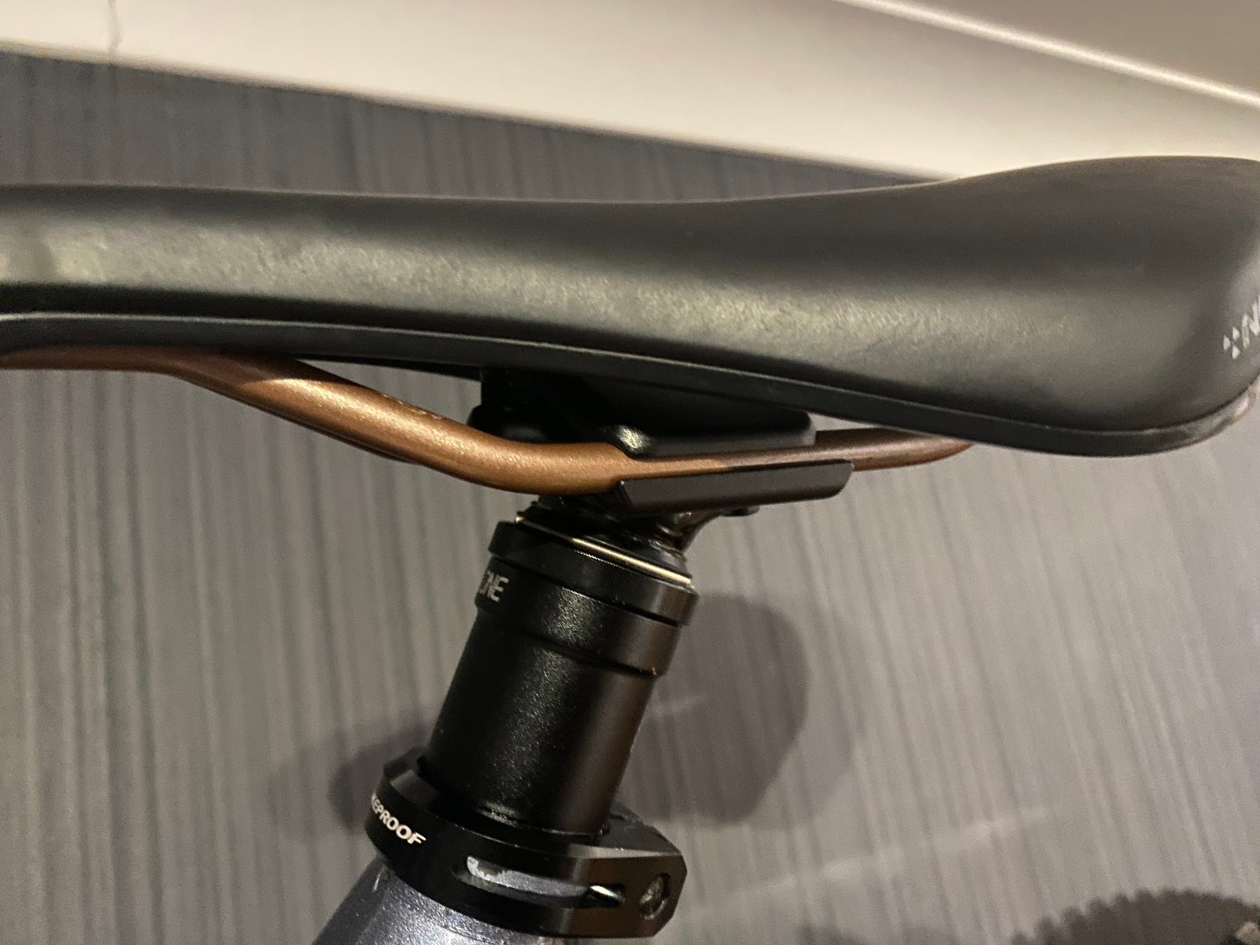

only problems I’ve had is the original Lightcarbon supplied head set is utter crap. And my Sdg saddle started creaking.

Nice mid-air action photo! 🤟 You're battery pack is stable and noise free still?
It is.

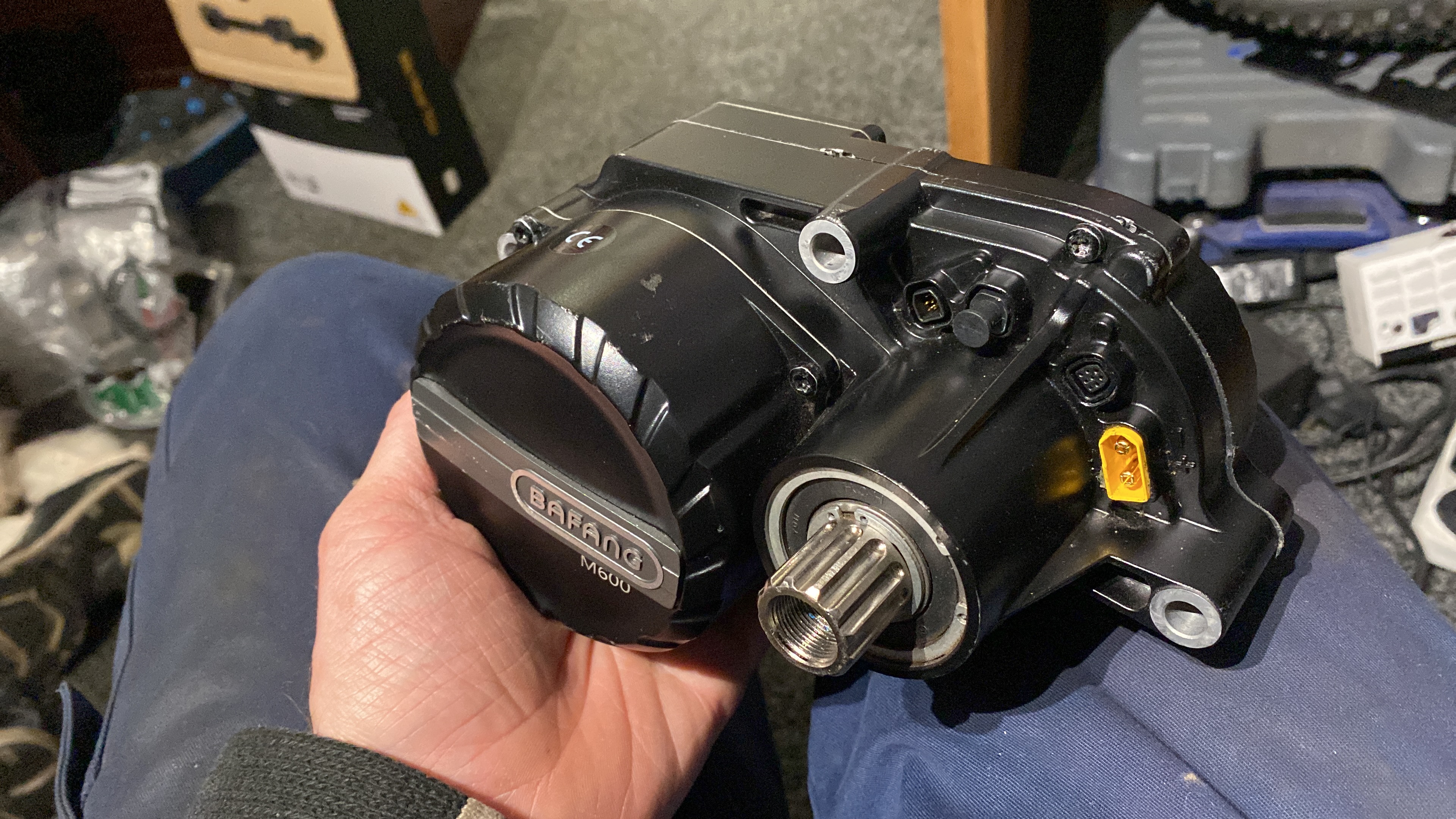

Oh and bought a spare Bafang M600 motor that needs repair, so looking forward to getting that stripped down and sorted.

Can you post some pictures on how you solved the battery cover/ plate mechanism. Did you make your own cover? I got my own frame on order and just finished the battery now, wondering how I am going to make the plate for the cover. I think I am going to 3d print the cover but still not sure about how to attach it to the frame so that it will be secure. Your solution for the battery seems very nice, but I am not seeing how the cover is attached to the frame. Thanks
