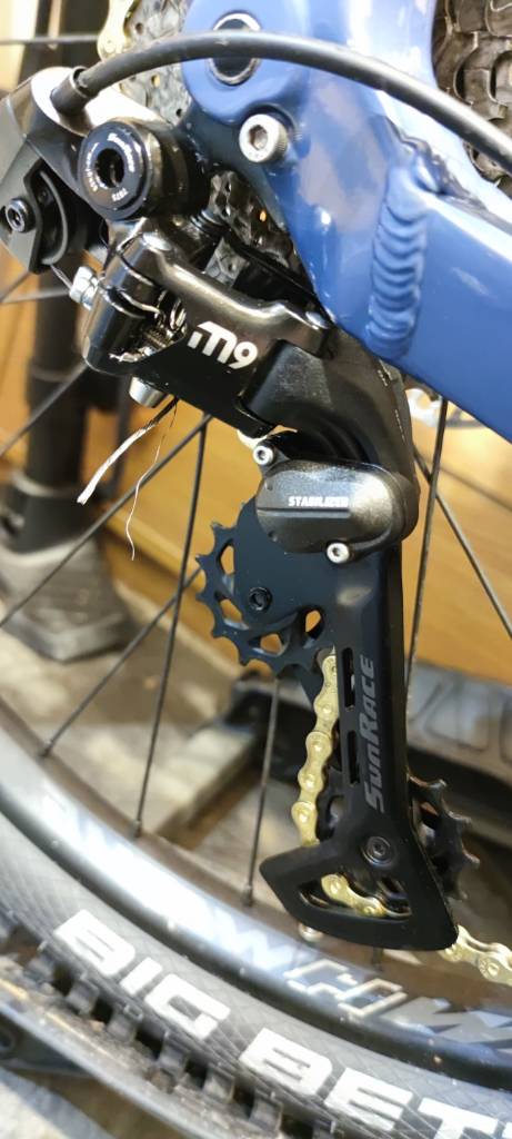

Sunrace rdm900 fitted, bit of a pita with the cable routing around the guide wheel on this thing and indexing out of the box ( the upper,lower and tension screws ) was so off it was insane. Need to test my other chains now on this to see if the clutch does fix the issue on them.
Bike stand tested one of the other chains that was having suck.... Seems ok with this clutch mech. Need a ride to test fully. @Zimmerframe

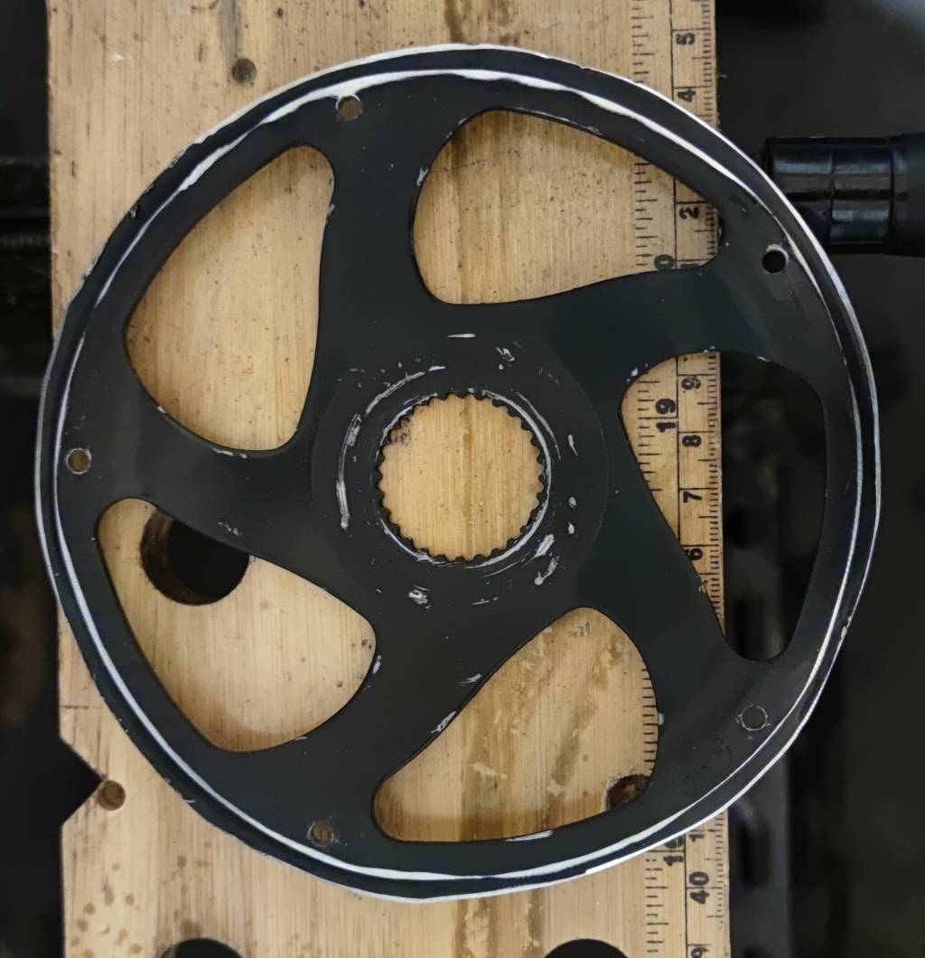

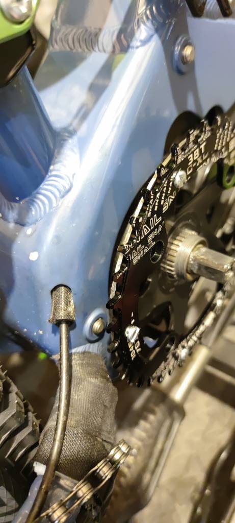

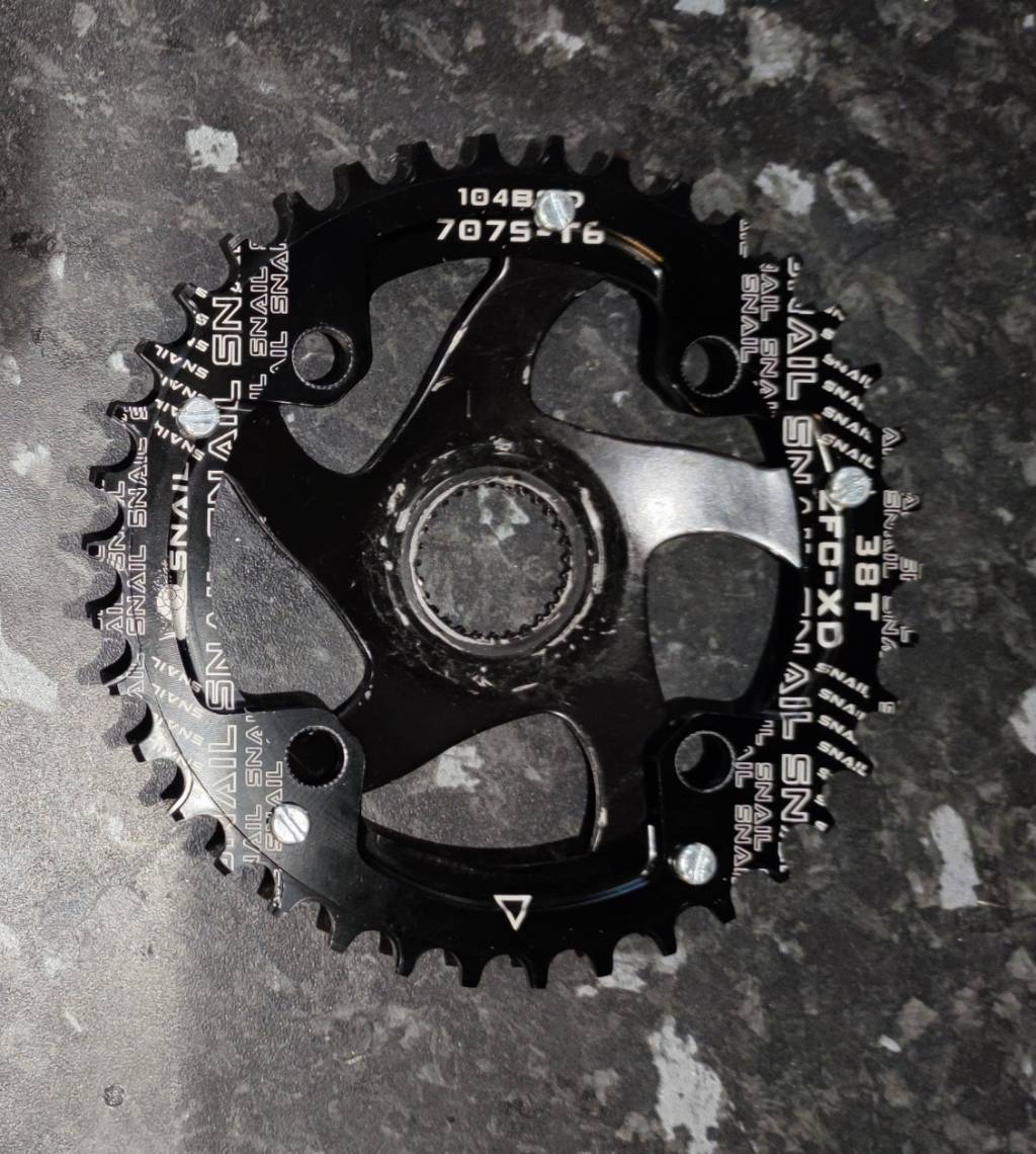

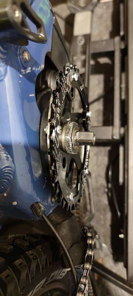

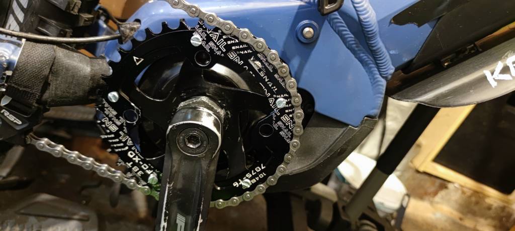

Follow up....

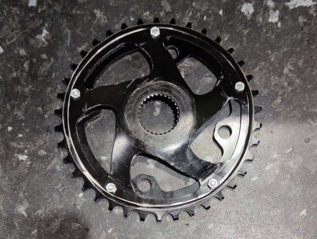

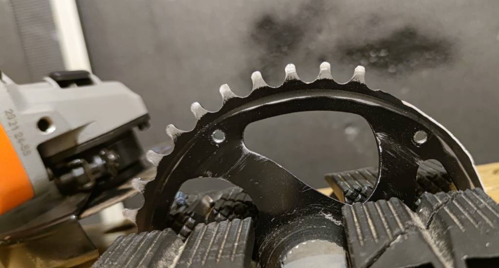

Got the grinder out and got to work,
Not the neatest but I can do better if it works out,
Bolted the pieces together ( again this can be worked on if needed later ),

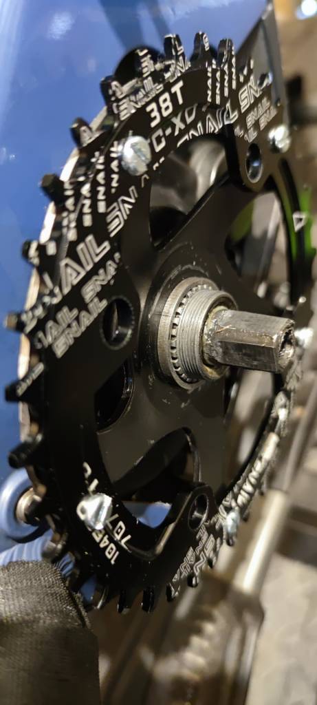

Swapped the inner washer to the outer to counter the chain line difference,
Attached the locking nut ( This is far more accessible now too ),
Took it for a test around the block and it only bloody works absolute zero indexing needed and no signs of suck
Overall working time was under 45 minutes and if this continues to hold up it will save on chainring cost immensely as I only need to source the 104bcd chainrings which are cheap as chips lol.
Hack or bodge

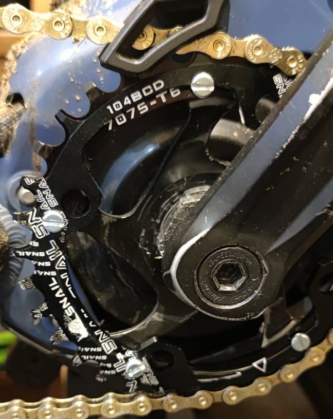

This has been working perfectly so I'm in the process of making a 34T version as the current 38T is really noticeable on the steep climbs.
Good idea that I decided to keep all my used kmc chainrings so now I have a stock that I can recreate and make 34T, 36T and 38T versions
34T all done in around 25 minutes this time, tested on a short round the block ride and all is good.
Amendments this time were to use a threaded drilled hole so the bolts now thread in and are more secure, added a locking nut on each just to be safe.

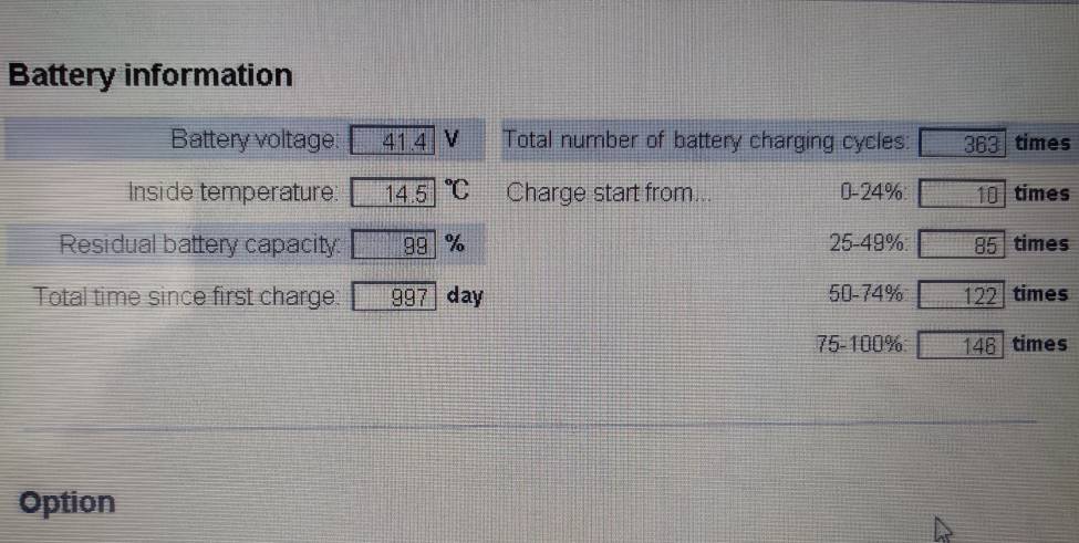

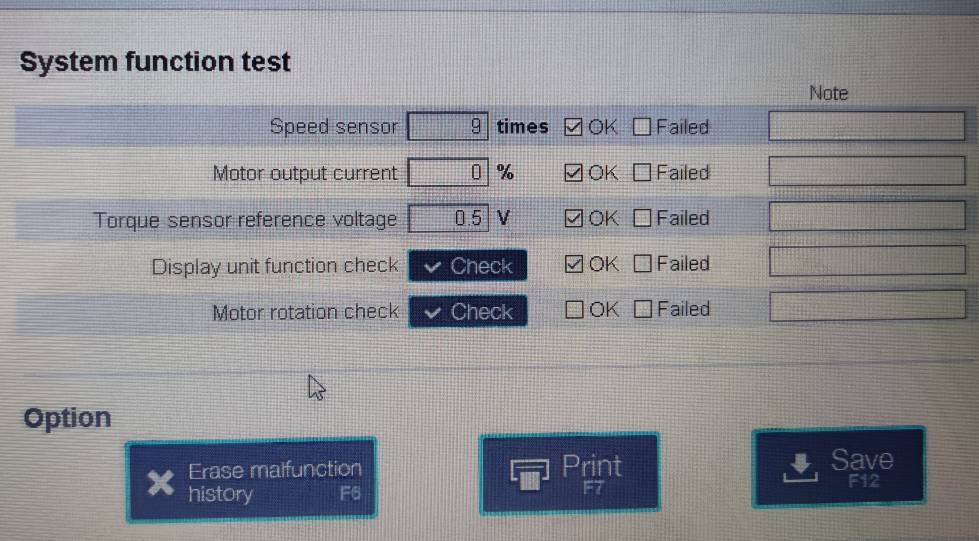

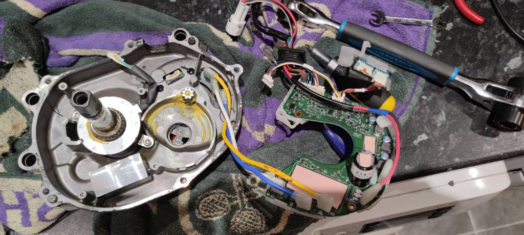

thought i would grab the screens from diagnostics.
seems ok to me
motor rotation was fine, i just forgot to tick it off.

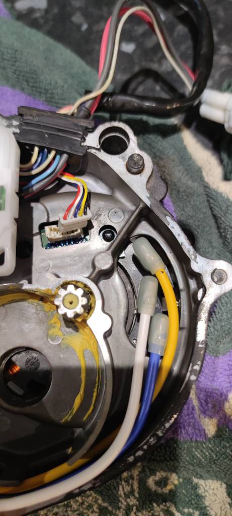

In at the deep end now
i was expecting much worse, bearings seem ok to me cant see any circuit damage so clean up and put back together..... if this motor even runs after I've been at it will be a miracle lol.
To be continued.....
Well that was easy, all cleaned up the best i can, regreased and sealed. managed a round the block test and its working still.
Just need to get out for a range test to see if by just disconnecting all electrics and circuits etc has maybe done something good.
If the issue still occurs then i will need to research how to test for a damaged cell but i still think that would throw an error in diagnostics?
Was good getting into the motor and being able to put it all back successfully lol.

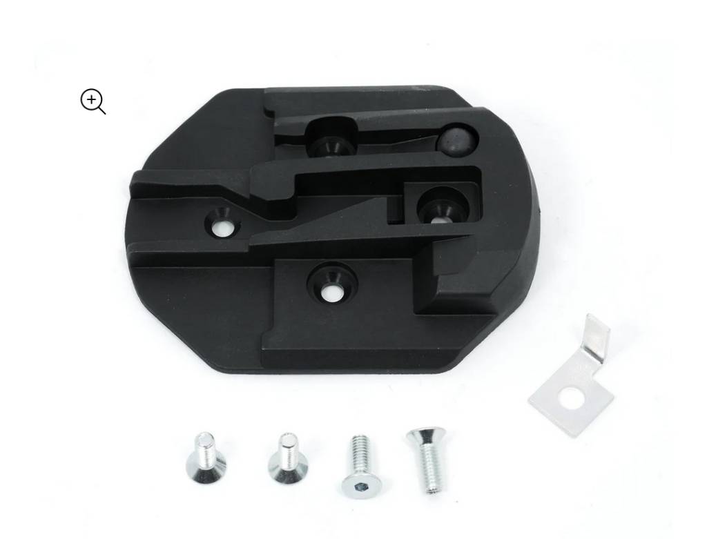

This is a part that fits onto the Yamaha xr1-10 500wh battery to clamp into the downtube locking mech,
and then at the bottom end ( nearest motor ) the battery connects into a similar plate that has the connection pins etc.
I am wanting to try and replace this connection plate part but for the life of me i can't find the part probably due to not knowing the terminology of the parts name lol.
For some reason ive got D.C plug receptacle in my head but thats not really returning any search success.
