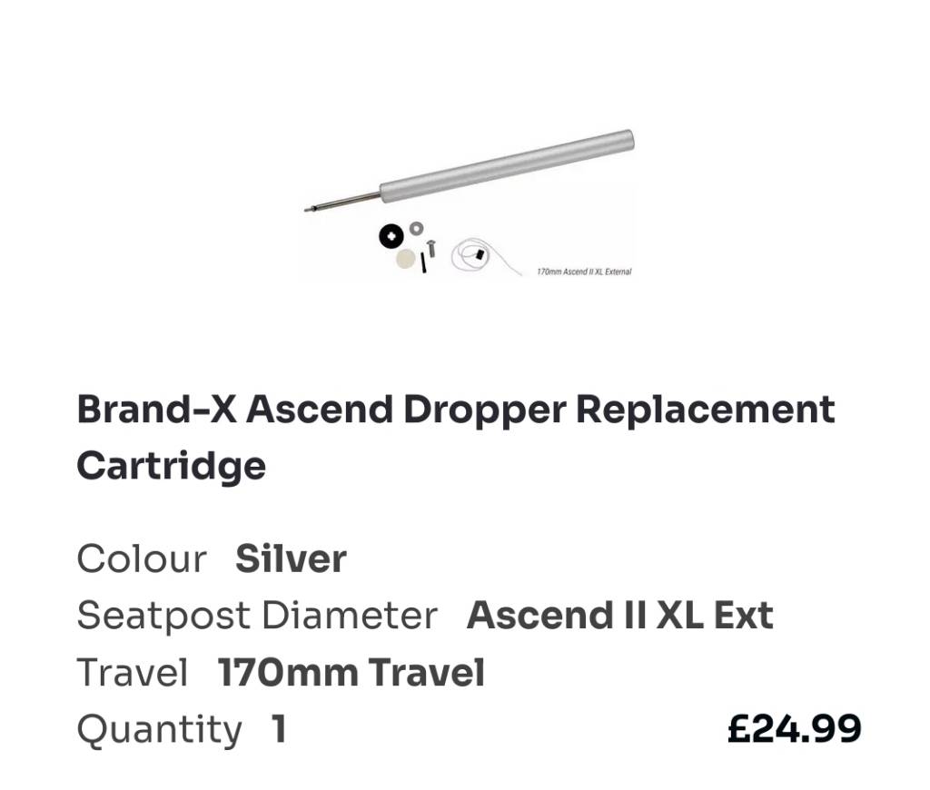

No more riding in the lakes this year.... Ordered a cartridge to see if I can fix the dropper before buying another.

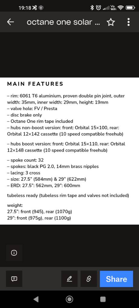

Hello again mate old account rhys99 stopped working for some reason just curious if you have upgraded wheels ? One of mine is bent and just wondering what you went for and what specs/dimensions
Cheers
Hi mate, yeah I upgraded my wheels initially to octane one solars which I rebuilt myself using the existing spokes and hubs. I felt I did a grand job but it was always stuck in the back of my head that I had done the rebuilding ! so not having 100% trust in my mechanic lol I further upgraded to a set of Miche xmh 30AXY which have been fantastic. I actually use my octane set as the winter set and in all fairness they are fine.
Both sets are still 27.5's.

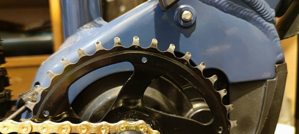

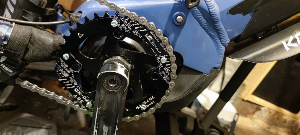

Is this worn ? Looks ok to me but I'm no expert so advice appreciated View attachment 126349
A tiny bit .. but not a concern unless the chain is new and it's just started to slip with the new chain. The Teeth are long and if you imagine, the chain is connecting with LOTS of them ..
It looks steel too. Sometimes the cheap aluminium ones wear really quickly and deform and start grabbing the chain and clicking and the connect and release, but I can't imagine you have that.
Not sure what speed you're running, but will certainly invest in a "shadow" (clutch) Shimano deraillier - will stop your suck and stop the chain coming off the chain ring if that happens in the rough stuff.
Weirdly your chainring doesn't look narrow/wide (could be the picture), but that also helps with both of the above.
Derailleur first though ! Try Merlin-Cycles for example .. I think an 11 speed is about €35.
Appreciate the input, I will elaborate a little on your advice...
Running 9 speed.
Chainring is steel super narrow direct mount.
I've got a DIY chain guide and catcher that has eliminated the chain jumping off the top and reduces the chain suck slightly to a point where it is not sucking and jamming ( it basically just sucks and sticks a bit whereas without the catcher it would suck and totally jam up if that makes sense ).

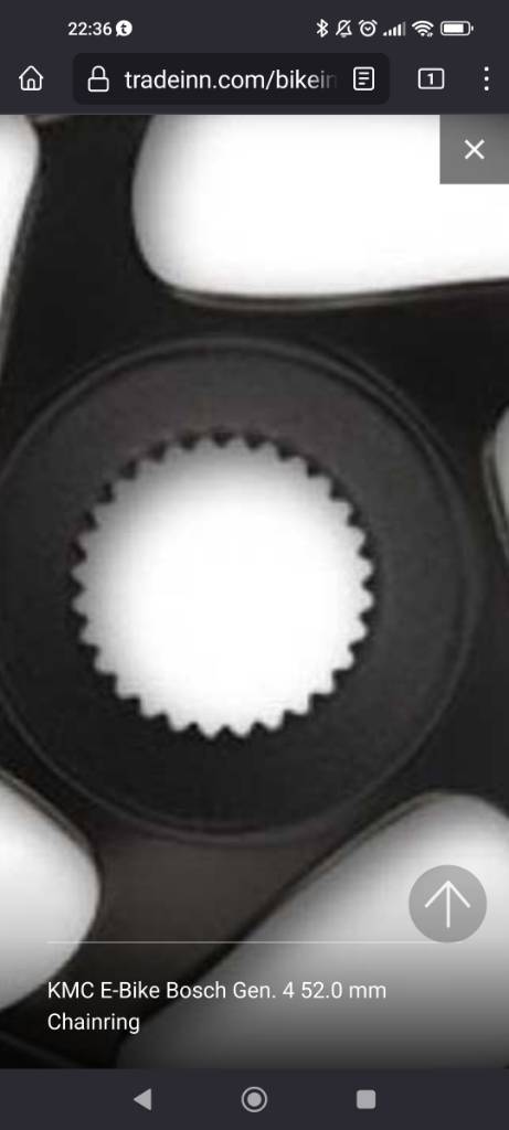

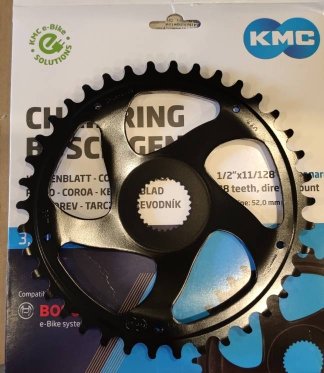

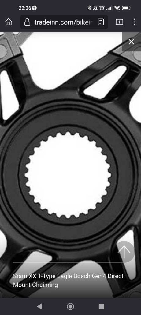

Narrow wide advice... It's a long story documented in this thread but short story is : I have a Yamaha pw-st motor which was Miranda chainring OEM ( I can't source this ring ) and after many many different attempts of sourcing a compatible chainring the only one to fit is a KMC Bosch gen 4 !! Which doesn't make any sense to me but it's the ONLY compatible ring. Even other branded gen 4's will Not fit due to their teeth being more square than the kmc version which is more pointy.
Chain is new and lubed well with few different types tested but still getting chain suck on pressured drive, no chain suck on gear shifting or non pressured drive. ( Trying to explain the pressured drive !! - It's like if I'm just slightly peddling or turning the cranks by hand during maintenance etc it's fine, as soon as I put a certain pressure into driving the chain suck starts to develop. At times it's non existent and then bang out the blue it happens ).
Very frustrating as like I said the current chainring is really not that old.
Teeth examples: you can see that the kmc teeth are more pointy than the SRAM ( all others except kmc are more square and not compatible ).
I even went down the route of trying to get a compatible spider so I could use narrow wide stuff but again non of them were compatible on this bike ( Hardseven Sduro 2.5 ) which was a limited edition kind of thing.
Haibike themselves have said that ONLY the Miranda ring is compatible!!
Which was when I discovered the kmc after many a wrong chainring purchased lol.

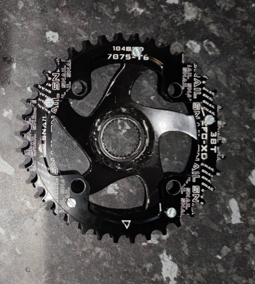

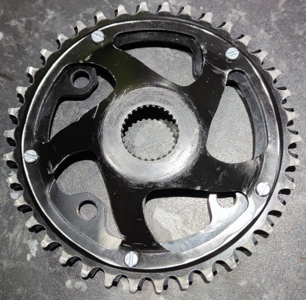

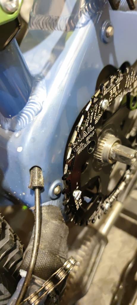

Hack and bodge job....

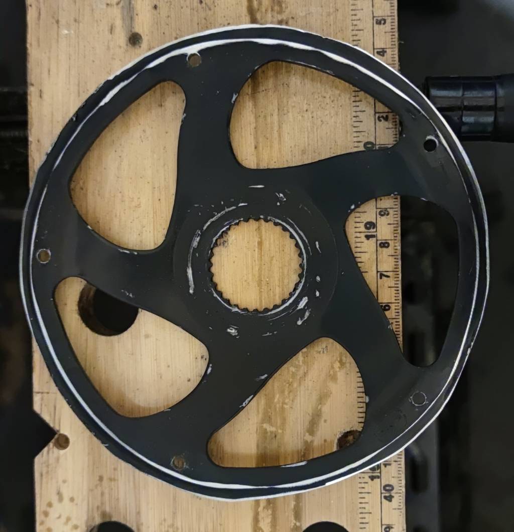

Have about 4 of these kmc direct mount chainrings which all have little holes ( x5 ) around them for attaching a guard plate.
I had an unused 104 BCD wide narrow chainring for a spider so aligned up the holes and drilled into it ( x5 ), found some nice fitting bolts with nuts and hey ho simple as that !!
Just need to grind off the existing teeth from the kmc, reverse the bolts and modify my indexing for the new chain line and I reckon I'm good lol.

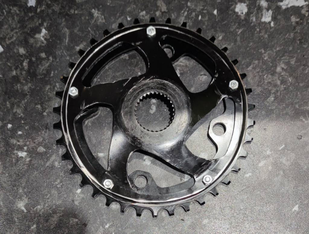

@Zimmerframe you like ?

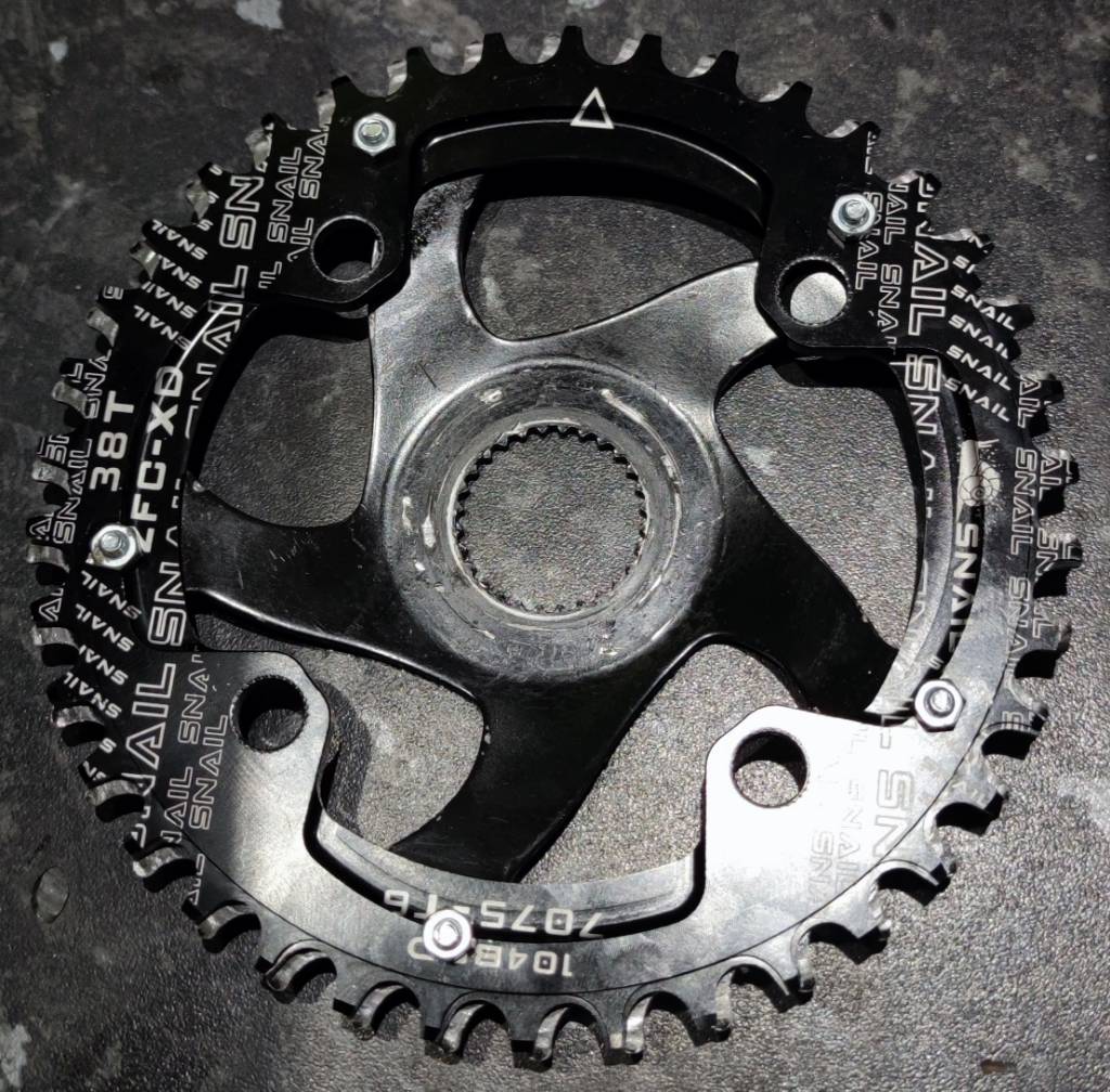

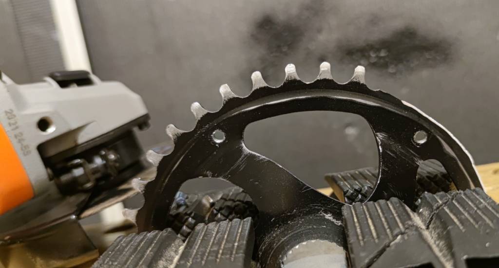

Follow up....
Got the grinder out and got to work,
Not the neatest but I can do better if it works out,

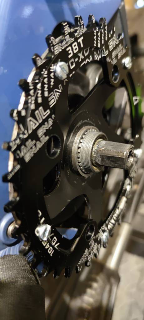

Bolted the pieces together ( again this can be worked on if needed later ),
Swapped the inner washer to the outer to counter the chain line difference,
Attached the locking nut ( This is far more accessible now too ),

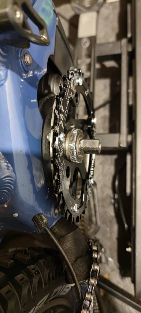

Took it for a test around the block and it only bloody works absolute zero indexing needed and no signs of suck
Overall working time was under 45 minutes and if this continues to hold up it will save on chainring cost immensely as I only need to source the 104bcd chainrings which are cheap as chips lol.

Chainsuck STILL occurring.
Out of ideas now.
You need a clutch ..
I'm pretty sure the Shimano 10 speed is the same ratio as the 9 speed, but the initial alignment is different so you need to space it out 4mm .... (or my mind might be dreaming).. There's plenty of 10 speed shadows for 30-35 ish.
Advent (microshift) do a 9 speed, but you'd probably need a shifter too .. and I'm not sure on the cassette spacing.
Seems odd why it's suddenly occurring frequently now though. Derailleur is the same from purchase and I've had many miles out of this bike without chainsuck with the original derailleur.
I'm now on a new chain( I've tried 3 now ), new cassette and new wide narrow chain ring and still getting the chainsuck !! Makes no sense to me as in the past these are the same components I've changed when experiencing chainsuck which have remedied the issue, the only difference now is switching to the wide/narrow I modified ( It held up to the torque test lol ).
The derailleur tension seems as it's always been but never really looked at that too much, could it have slackened over time ?
I've got a brand new kmc chainring ordered to see if that fixes things !
If it doesn't then I guess I'm gonna have to change up to a 10 speed clutch set-up. Pfffffft lol
Absolutely bizzare.... Last test I could do prior to parts being delivered was one last chain test, this chain was at the bottom of my pack and only intended for emergencies as it was unbranded cheap as chips tat ? ( 3 for £10 ).
Took the bike out and thought let's give it some abuse in the wet sloppy gritty conditions fully expecting the worst chain suck to date..... NOPE, the smoothest issue free ride out I've had in months !!
