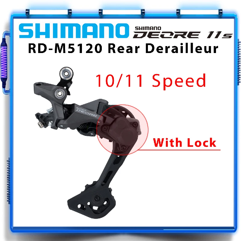

Derailleur: Shimano Deore RD-M5120 34 €

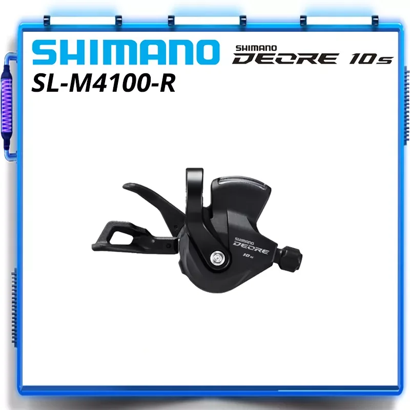

Shift Lever: Shimano Deore SL-M4100 23€

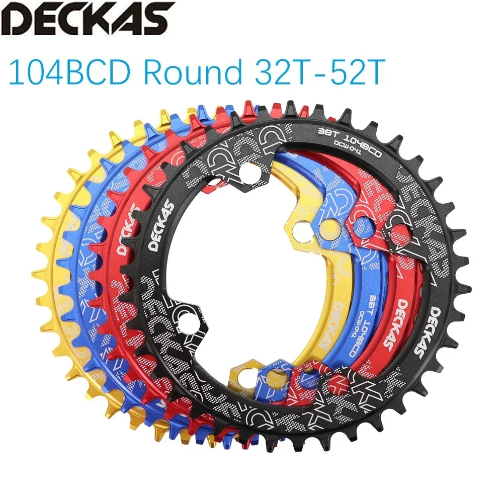

Chainrings: Deckas 36t and 42t Aliexpress 18 €

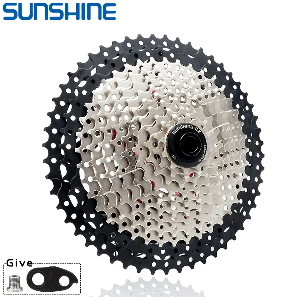

Cassette: Sunshine 11-46t 10s Aliexpress 27 €

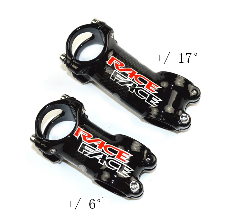

Stem: RaceFace Next 31.8 60mm 13 €
Handlebars: Race Face Next carbon 31.8 760mm 17 €

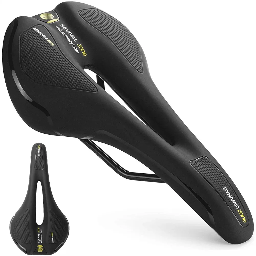

Saddle: MTB saddle Aliexpress 12 €
