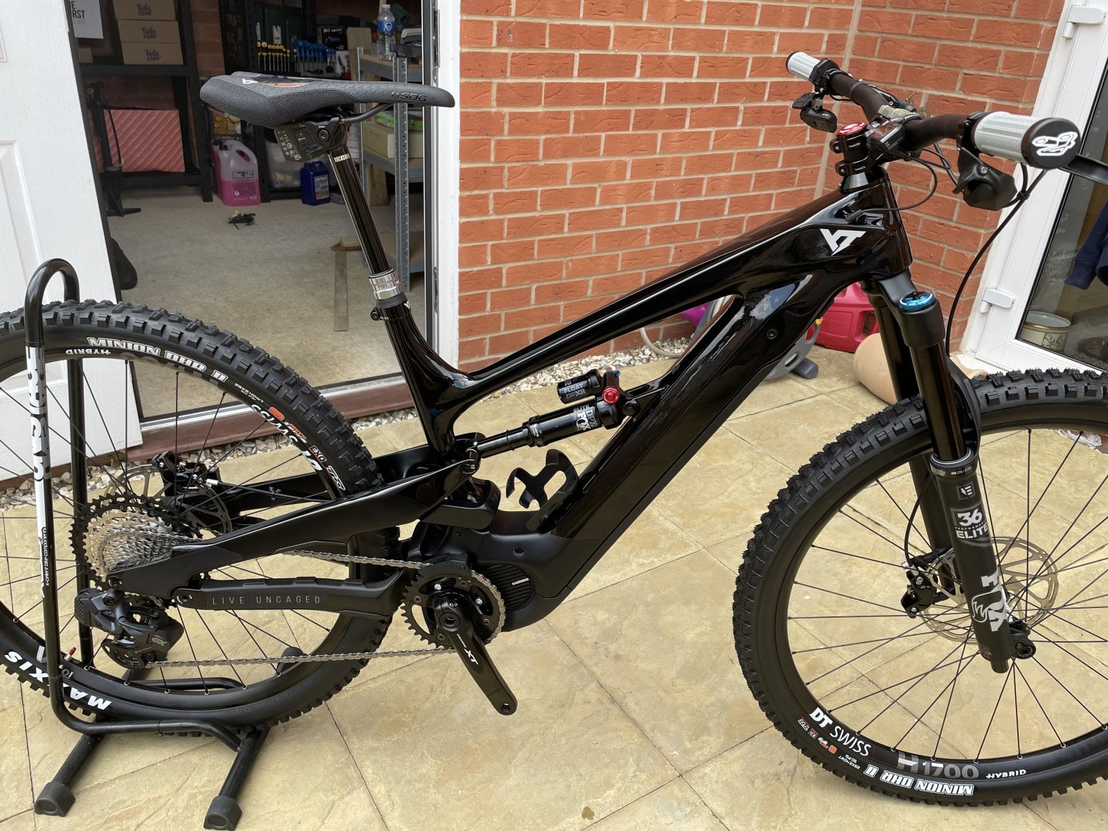

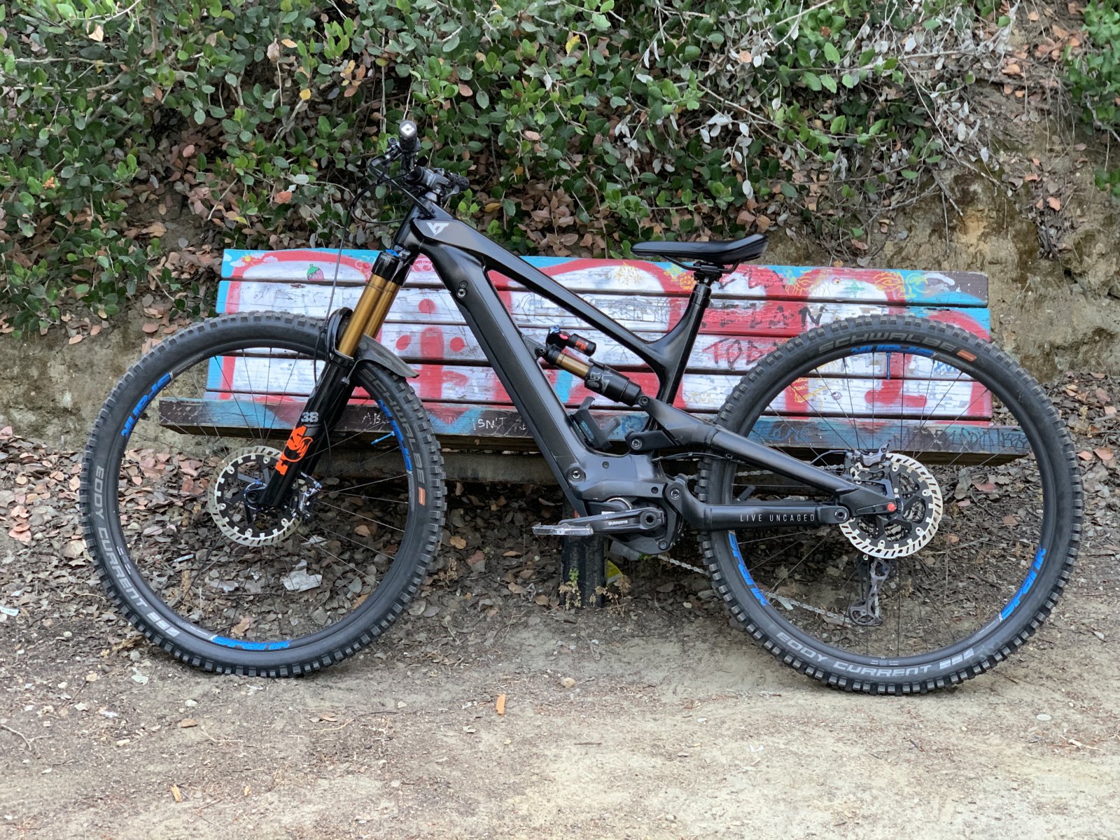

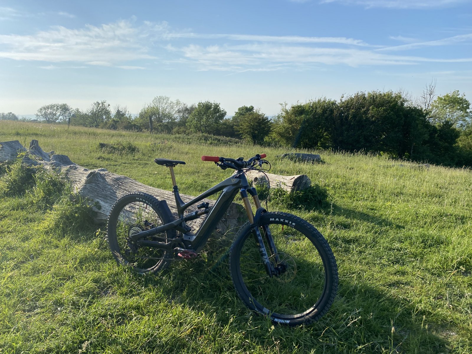

Nice. I am happy with my fox 38 180mm I've upgraded to. I decided to go with the none emtb version as it was the only one I could get at the time. I did not change the head set at all for it.

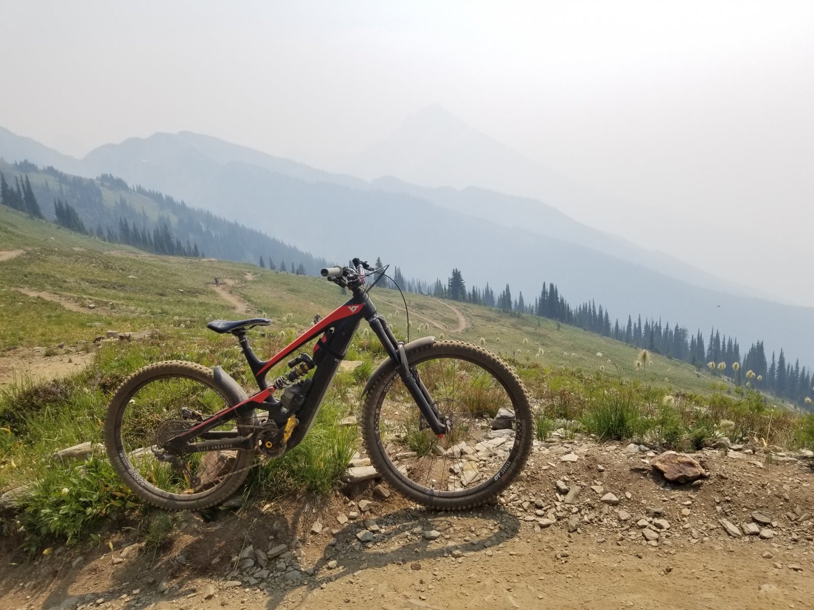

Great! Same here. Just swapping the non emtb 38 from my meta am. I figure it will slacken the bike another .5 degrees from the 180 yari.
Might add a luftkappe or secus to it at the next service. Ordered a progressive spring from race only springs to try on the reat shock. Feels like a bit more progressivity will be good, jury is still out on that though

I see yes it should slacken it slightly more. be interesting to see which upgrade on the fork if you decide to go that way. I am running a progressive spring on my decoy now I do like it a lot.

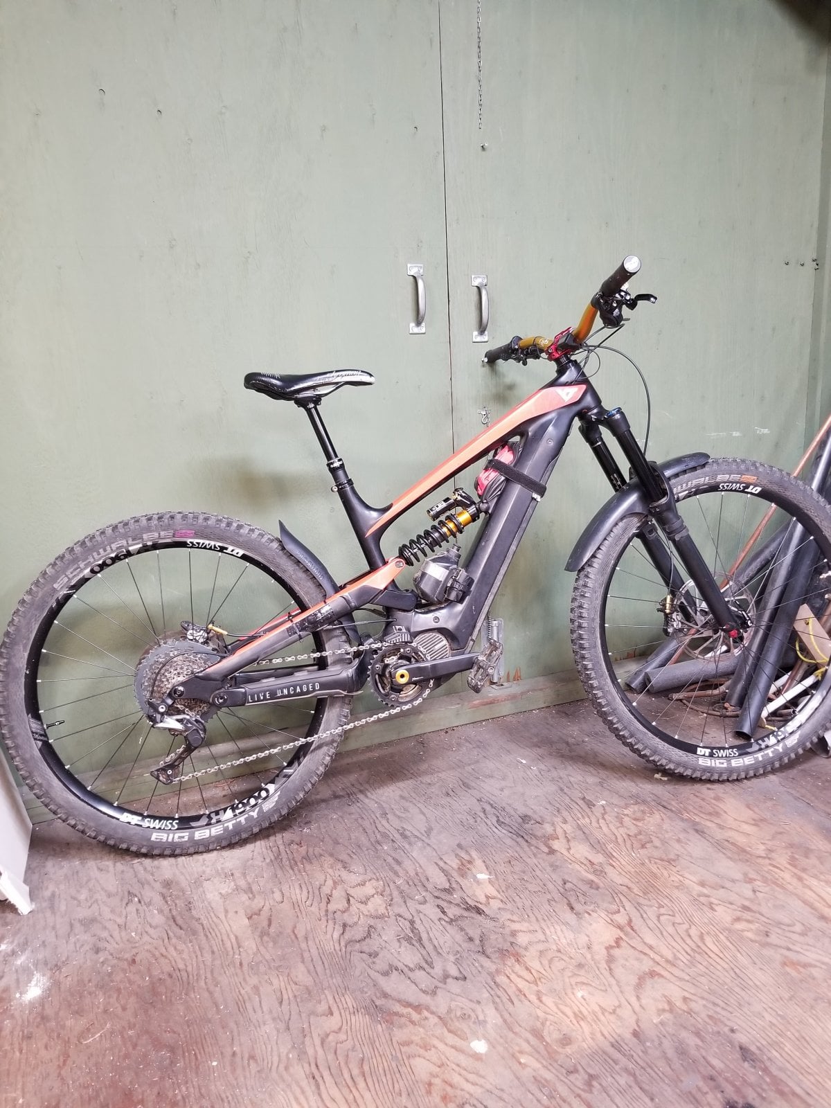

Leaning on the shop wall after i installed the rrp proguard rear. Couple rides on the new 2.6 big betty super gravity soft with a tannus tubeless liner on the front. Little by little the duck is getting more beastly.

I’m running a pretty similar setup like yours, dhx coil and 170 mm 36 up front. Same base model frame. Changed recently my rear wheel from dt swiss hx 1900 to SC reserve DH. Can fully recommend it. Rear end feels little bit harsher but the bikes appears lighter, is more snappy, rolls better and holds the line better. Quite a difference to the stock wheel.

Sounds like a nice ride. Ive found im not really a carbon guy. Sold my carbon bar and wheels and wish my frame was all aluminum. Too stiff for me. I wonder if i went to a 28 spoke wheel if it might take some edge of them and all carbon isnt the same(i had lite bicycle 31mm inner rims laced to hope pro 4's w dbl butted spokes and a renthal carbon fatbar and a race face carbon bar before that). Guess ill never know. Some weight savings wouldnt be bad and i can see the appeal for pedalling i guess but it didnt save much weight in the wheels and i prefer some compliance especially in the rear wheel. Im not a bikr breaker per se but ive been known to smash the odd rim and tire pre 1200g/+ tirds and inserts
