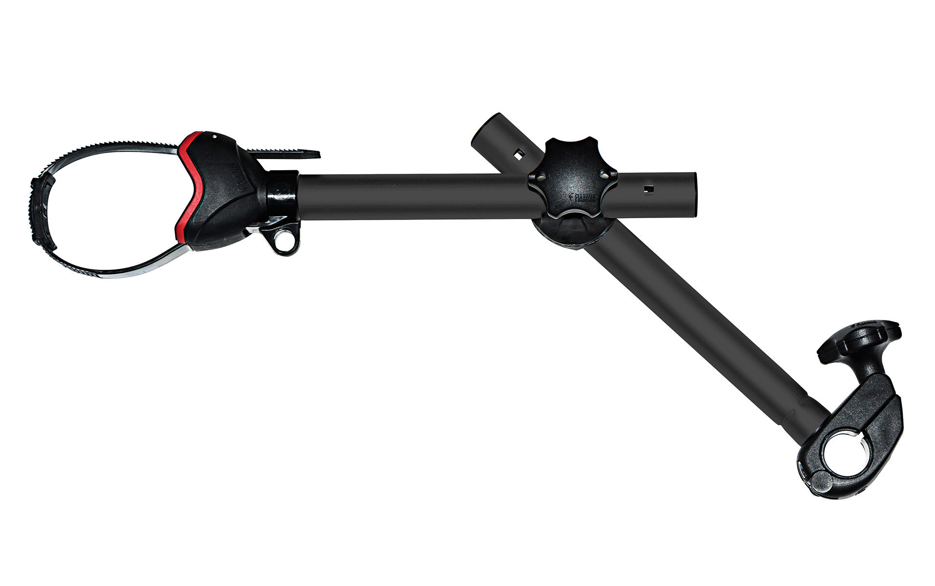

I have the Thule XT2 rack but I back the Thule bike clamps up with a Fiamma Bike Block Pro as it fully loops around the frame. It's not lockable, but between the two of them the bikes not going anywhere and the Fiamma fitting is the same diameter as the Thule tubing so its a perfect fit on the Thule rack. I just leave it permanently fitted to the rack and always use both.

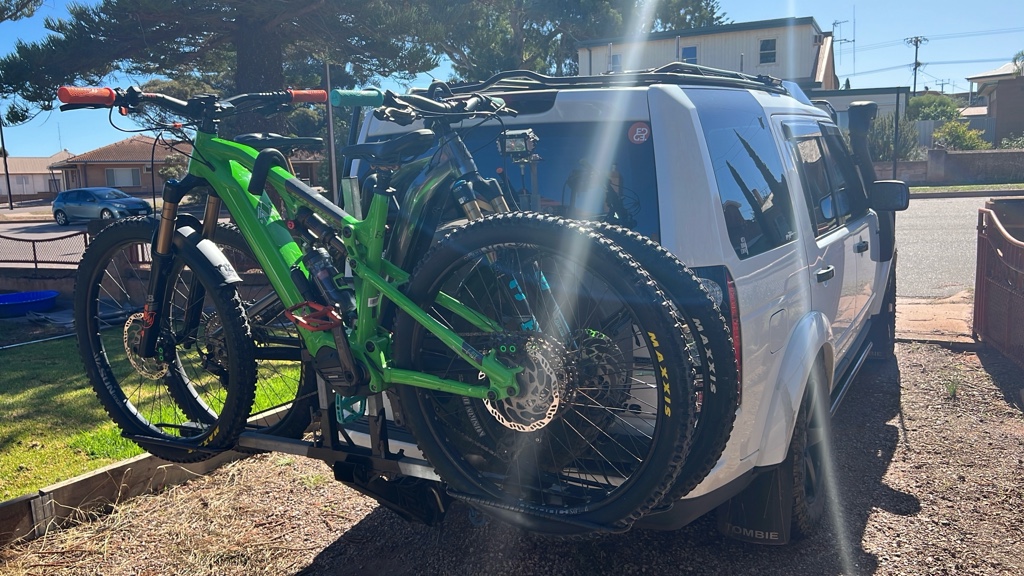

We’ve been using this rack for a few years now with no issues.
