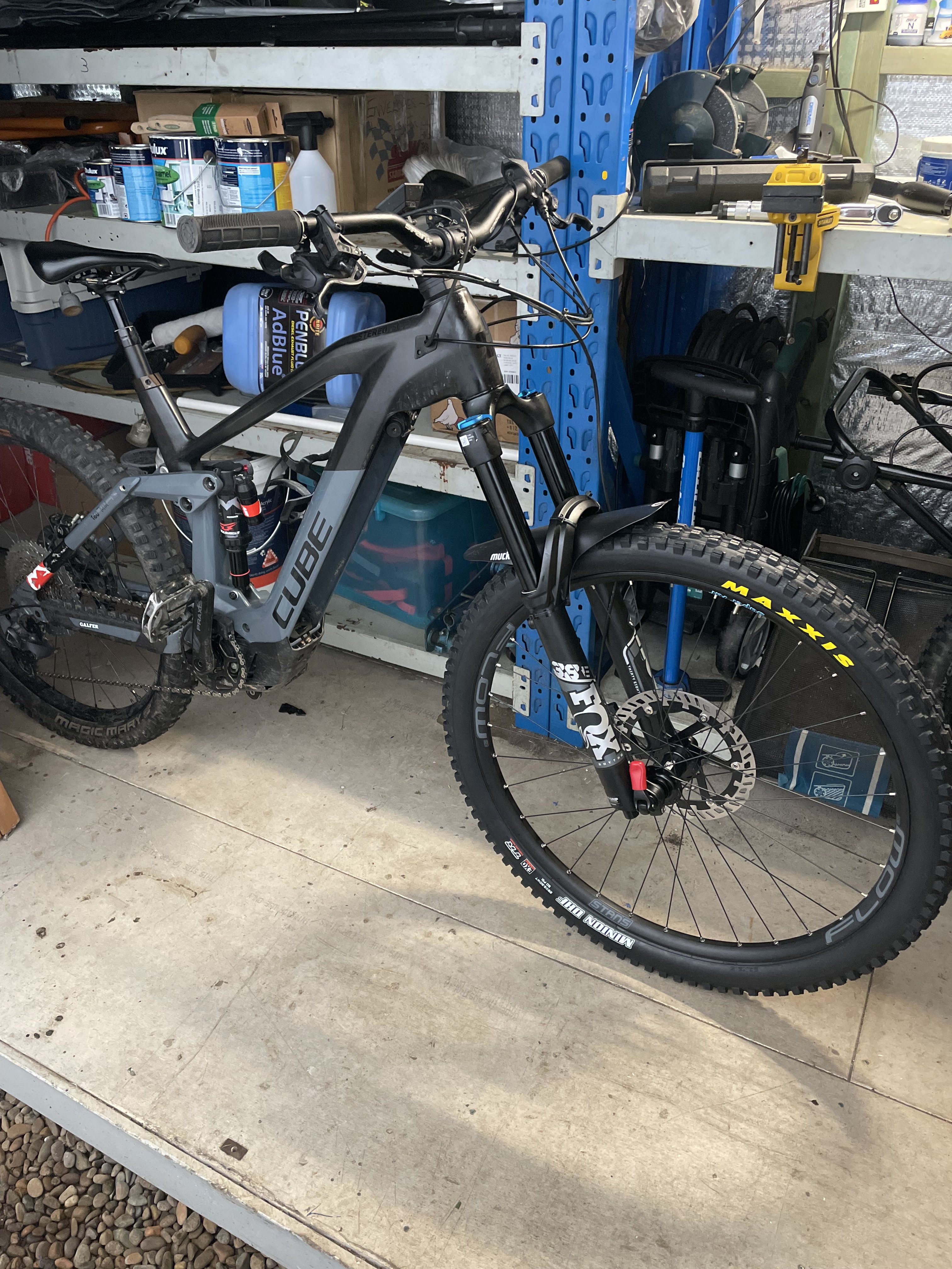

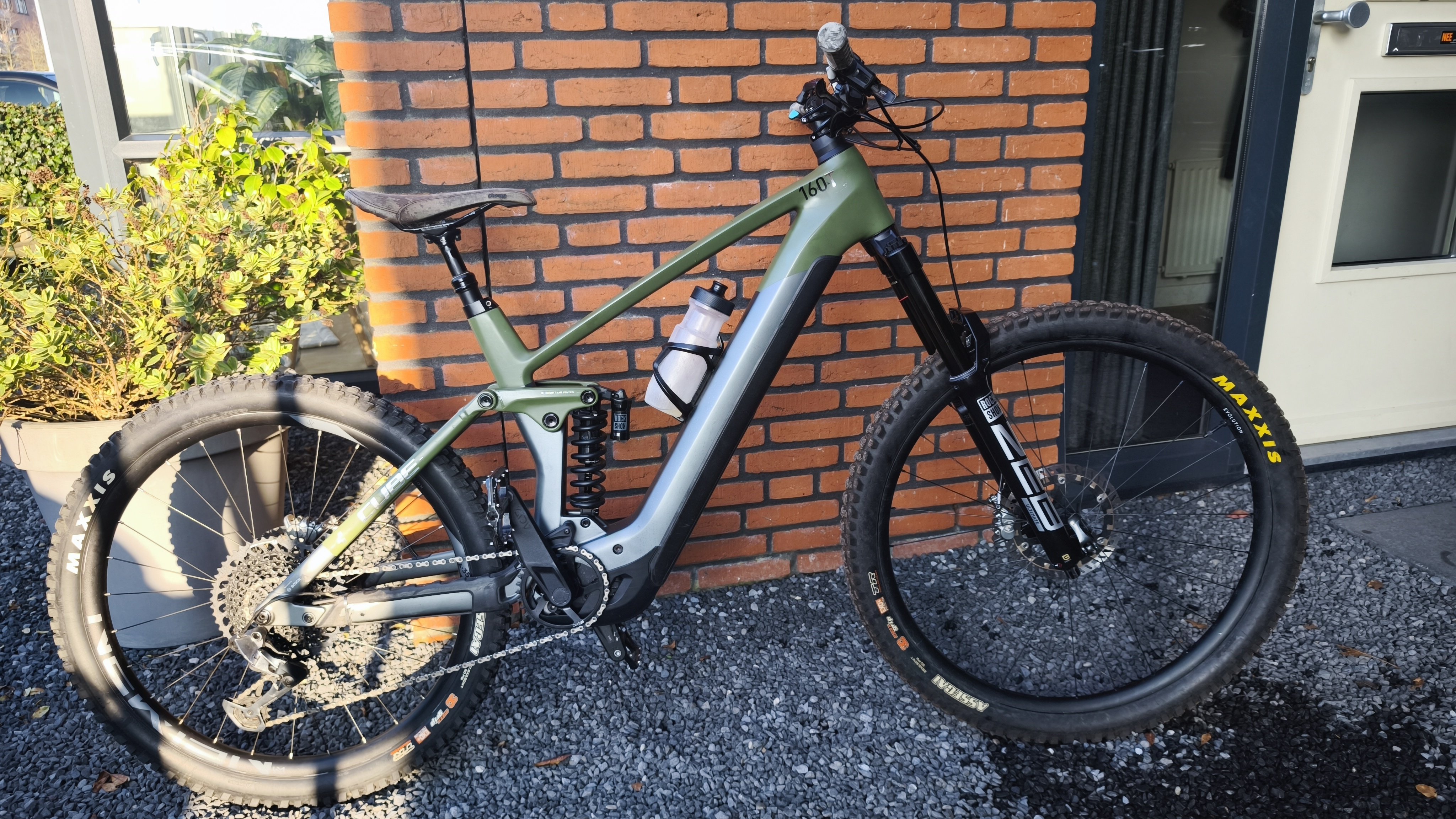

The bike started off second hand stereo 140 medium which had 29" wheels 140mm fork travel in the intension of swapping out stuff to see what happens with the geo
What I've done is replaced the back wheel with a 27.5 in doing so, I've swapped out the rear shock which was a 185 x 55 for a 205 x 65 super deluxe ultimate to raise the back, I've put 170mm Zeb Ultimate up front,
I have 150, 155 and 165 cranks I will play around with, I'm in the throws of slackening it, I've got 1mm and 2mm winging their way from a company in Staffordshire UK
So this will be interesting to see what sort of Frankenstein bike I've made
also put a 500watt battery in it to keep the weight down
Got to admit over the last year, I've pulled together some decent parts
Its working out nearly half price from the year before that 👌

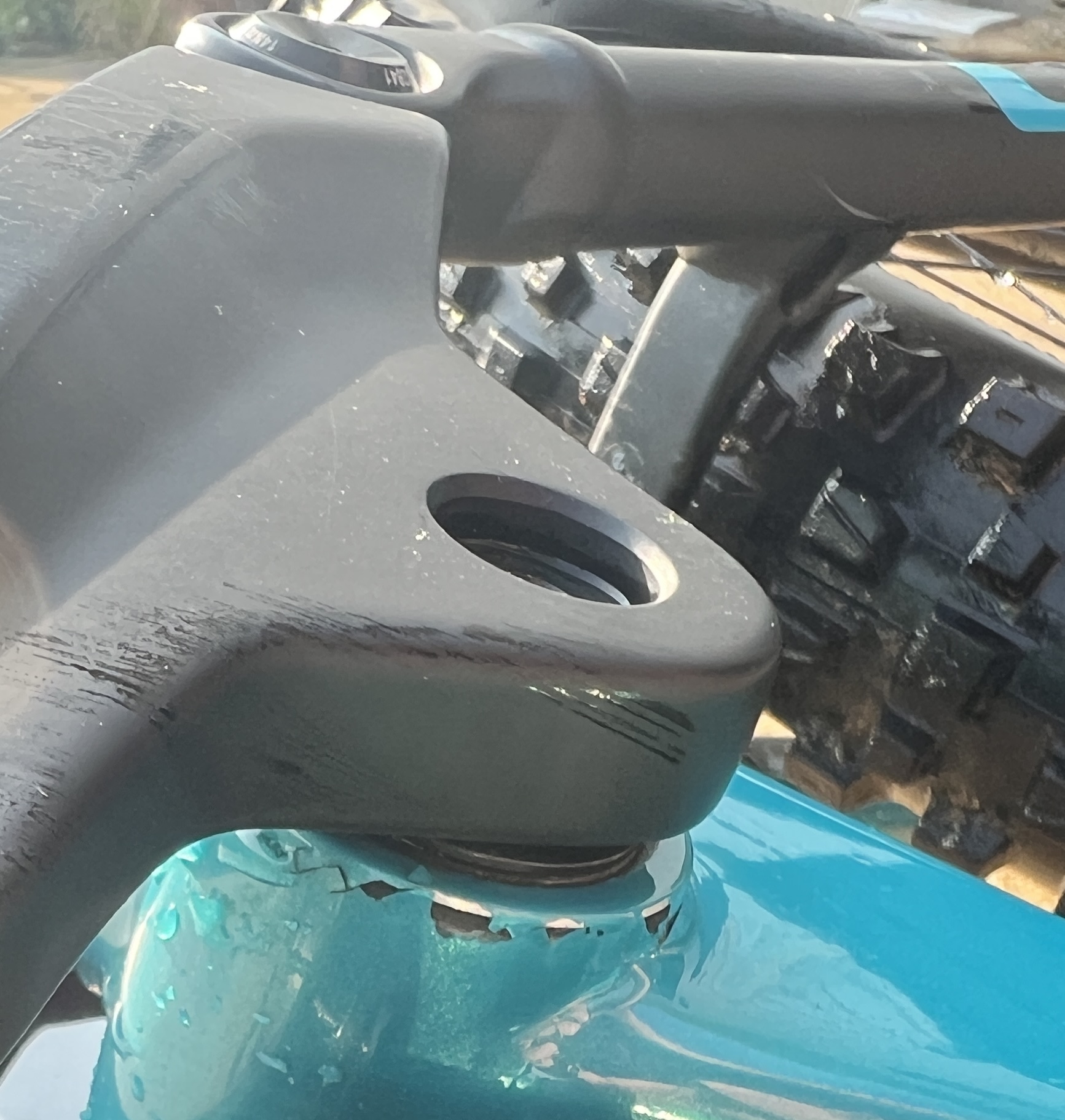

I probably send it a bit more than the average rider and I destroyed my lower headset bearing quickly. Replaced it with a cane creek bearing and it’s been great since.

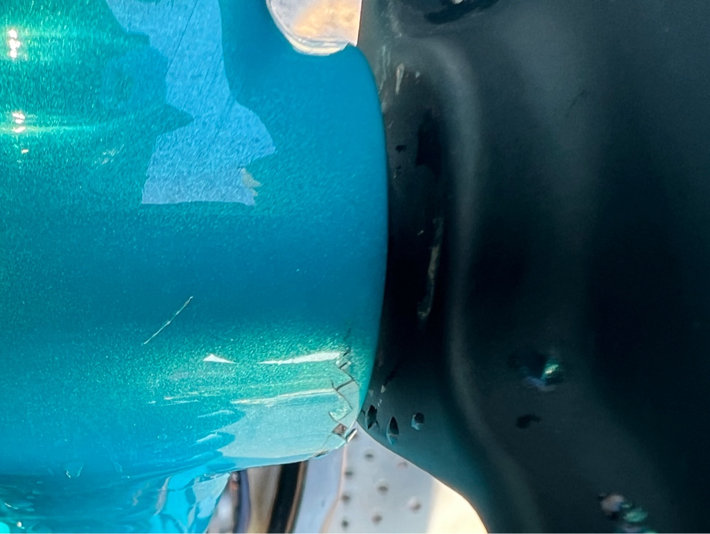

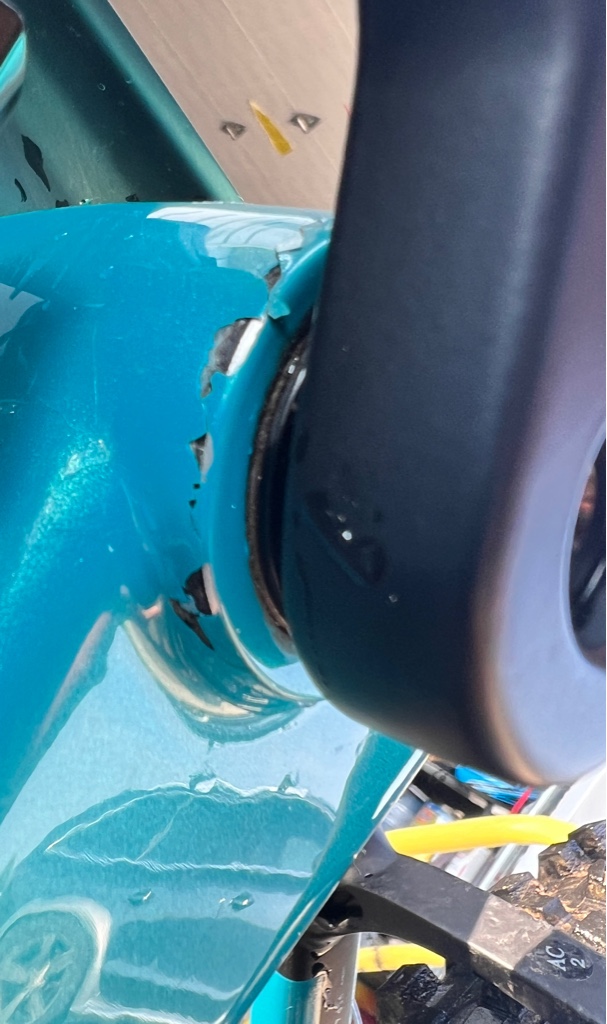

Stress less...I know it feels like a disaster but it can be fixed and strengthened. I broke my frame, near where the rear motor mounts are as I used the bike for gravity racing and the original entry level RockShox shock wasnt up to it....that and pressures in rear tyre that were too low. I searched for an experienced carbon racing yacht repairer and he has been great. He has the knowledge and tools to fix high impact carbon things and he loves the idea of fixing something other than "just another boat." He did a quick and dirty repair on a weekend for me to get me to a race and then when I broke it again, he took his time and made a whole new carbon block for the mount to sit on and it looks "Factory." You would not be able to tell he has been in there if you were not told first. Got the Marzocchi air shock, had it tuned and the frame has never been better. When I took it to the repair guy, I got him to look all over the frame to see if there were any other issues or if there were any places on the frame that could not be fixed and I did this for two reasons.....we are always told that carbon frames are throw away once they are damaged and also because there was quite a bit of talk on this forum about head stocks breaking on 160's at the time. He told me he could fix any part of the bike if needed and there was no existing damage........best part was, it costs me a case of beer and $200 to fix the frame. Fmxr47, do the talking to Cube thing but while you are doing that, search boat mast or boat hull repairers and speak to them and ask who is the "carbon guy", there always is one and he is the one you want to go to....if you think about the forces that go into a racing yacht mast for instance, and these guys break and repair them in the one weekend so they can keep racing.......find that guy!

My original Arcos lasted about 6 months. Replaced with Cane Creek. My professional suspension repairman speaks most highly of Chris King headsets.
I've been mullet on my stereo 160 for 3 years now. Zero problems. IMO (and it's only an opinion) slacking out the head tube angle by a degree, and extending the length to the ground by .75" ((29-27.5)/2) is not going to take the head tube beyond it's limits. Even running a fork with another 10mm (I run 170mm travel) is not going to do it. The highest loads are typically when the fork is compressed, at which point the leverage issue is significantly reduced. If it's compressed at all, then the fork is in the original travel range anyway.
I think some primary and contributing reasons for failure are 1) poor/weak frame construction and it was going to break anyway, 2) loose headset, where the fork hammers back and forth (brutal on carbon fiber frame), 3) heavy riders, and 4) an improperly tuned fork that bottoms out too much. While the frame should handle bottoming out, if you have any of issues 1-3, then continued bottoming out will compound the issues. Full kit I weigh about 170lbs (77kg). I'm sure that these frames are engineered to handle ~240lb riders, kitted to 260 (118kg). If you're not in that range, then blaming a head crack on a 29" fork seems an unreasonable engineering proposition.

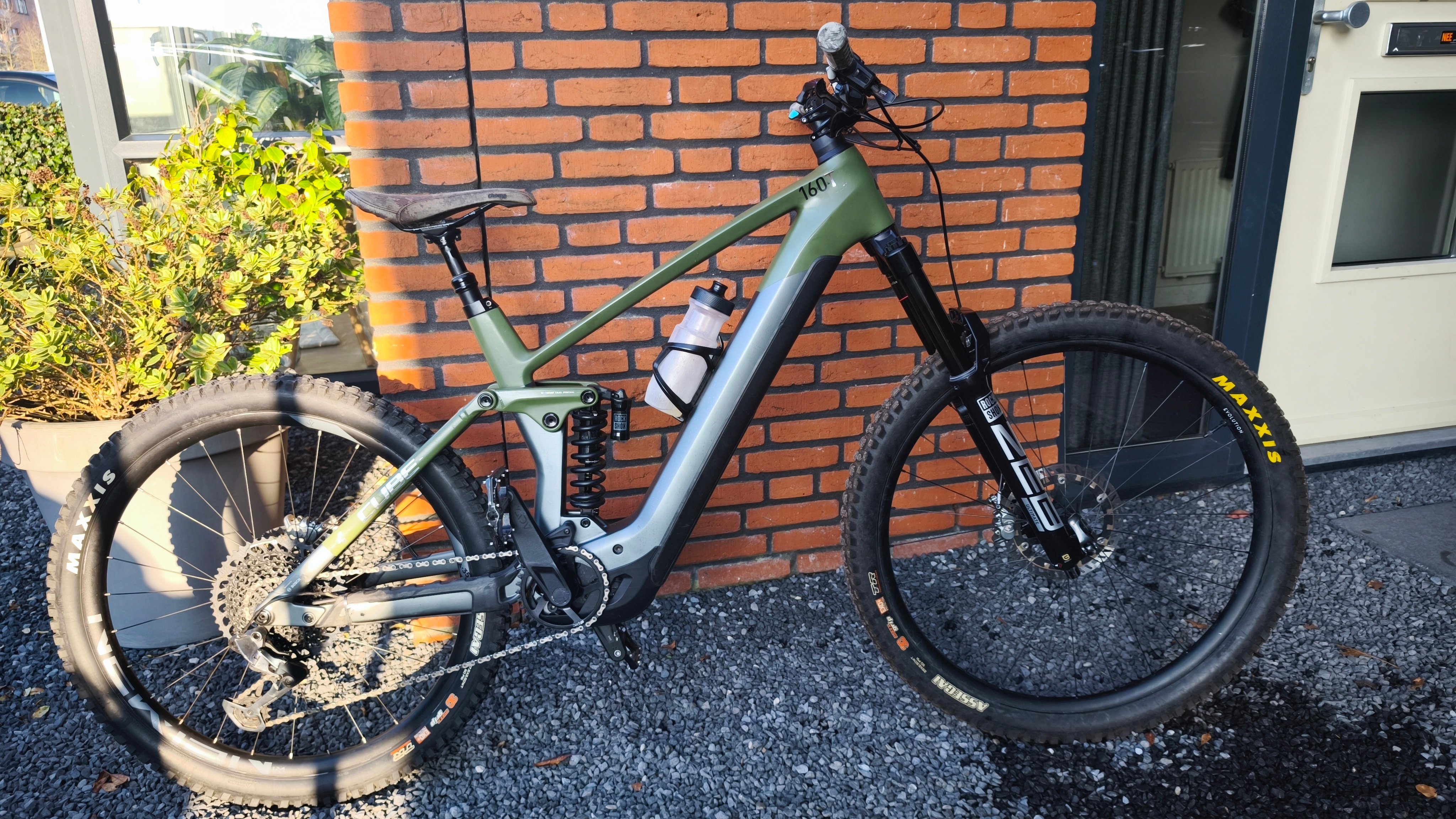

So, initial impressions are very positive. I need a lot more time on the bike to fully adjust and set up the forks, but I don't think I'll be going back to a 27.5 front wheel anytime soon.
I spent the day at my local bike park which has a good mix of short tech and jumps lines, very easy to session with some short steep sections of climbs back up.
I should note I am an average rider at best, but I try to get to bike parks most weekends, I also use the bike for mid-week countryside rides with friends, so a bit of an all-rounder.
Coming down the first flow trail, the larger front wheel is immediately evident making the front end feel slightly sluggish on tight turns/berms, though in reality it's not sluggish at all, it's just getting used to the transition of the bigger wheel.
After a few runs I naturally adjusted my riding to the bigger wheel, and it felt just as nimble as before.
One of the biggest changes was how grounded and confident the front end felt on descents, the 160 is known for being a nimble bike and sometimes could feel skittish under quick steering inputs. With the 29er I'd say It's still just as nimble but far smother and planted.
Roll over is greatly increased, and over roots and chatter it flies!
Jumping felt good, I didn't see any major difference here, though I'm not a high-flyer, still improving.
One of the main negatives I'd read to converting to mullet is climbing ability, so I was keen to see how it performed.
The climb to the top of the hill is fairly tame apart from a few steep sections that most people with analogue bikes can't pedal up, I've ridden them a lot over the last year so have a good comparison for the 29er.
The 160 again is known for being light in the front when climbing, and I found this to be true, having to shift weight to the front of the saddle on steeper climbs.
It's just the same with the 29, on steeper sections you have to get over the front more to stop it from lifting, but I actually found the increased roll-over of the 29 made it climb better in certain situations.
The front can still get light on the steepest parts of the climb, just as before but moving forward soon has it under control and I only saw a marginal difference in climbing, if any at all really, I was pleasantly surprised by this.
After the initial transition to the bigger wheel the bike felt great. I had an amazing day and felt I was hitting rough sections faster than I ever have.
As for the Manitou Mezzer's, They felt great! Just as stiff and compliant as my Fox 38's but soaked up chatter far better.
I need to play with the IRT a bit more as the initial ccs86 calculator felt great in the mid-section, but I was bottoming out on larger drops. Again I need a lot more time on them, but I'm impressed so far. One thing I do miss though is the Fox quick release axle
