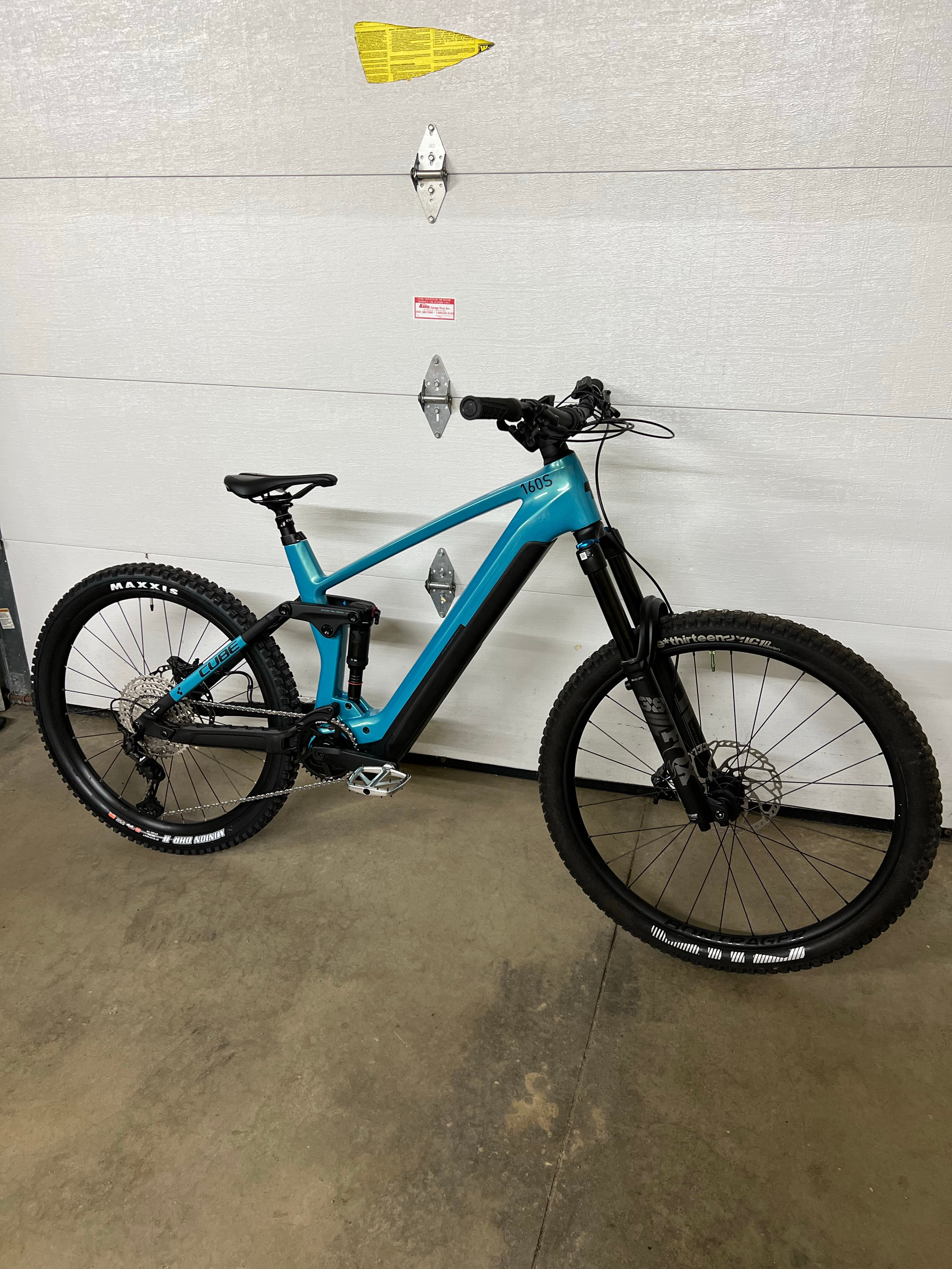

Has anyone with a 2022 model found an angle headset that works with the integrated cable routing? Having no luck finding one that will work as the frame does not have external homes for the cables.

I have just fitted a Fox 38 29er fork in 170mm travel and a bontrager line 30 alloy wheel and the head tube angle now is 64 degrees. So far from pedaling around I’m very happy with it but will be hanging onto the 27.5 setup for a bit to be sure.

It is honestly working great. I mostly take the bike to a local “DH” park but also ride all my local trails with some steep climbs just fine. I think going to a 160mm would make it climb a tad better but it really descends well and doesn’t feel any longer in the front end than my YT Capra 29 is. Correct the head angle is 64 with the 170mm fox 38 and a 29” wheel.
If you enjoy descending I really am happy with it, the original headset didn’t last long so I changed out the lower bearing as a bandaid incase I find an angle set with the internal cable routing. That would drop my front end a bit more but also make the bIke a tad longer.

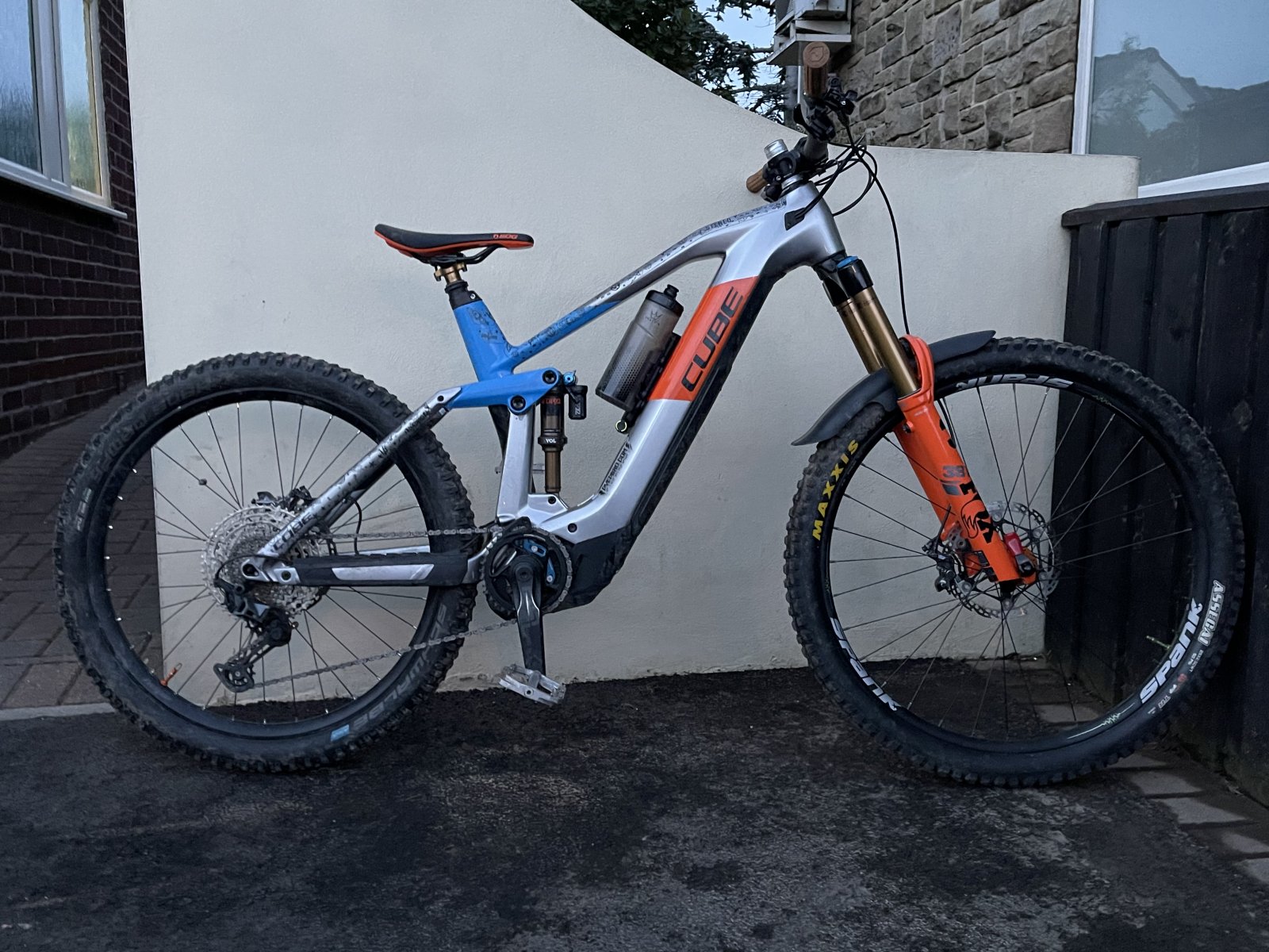

I know it's along time ago this thread But I've been giving info to Superstar components in regards to a angled headset and they didn't seem to realise that that Cube use a 56 cup top and bottom
So checked posts on here took some time but come up Trumps with you in this thread
Cheers buddies this has help me out
