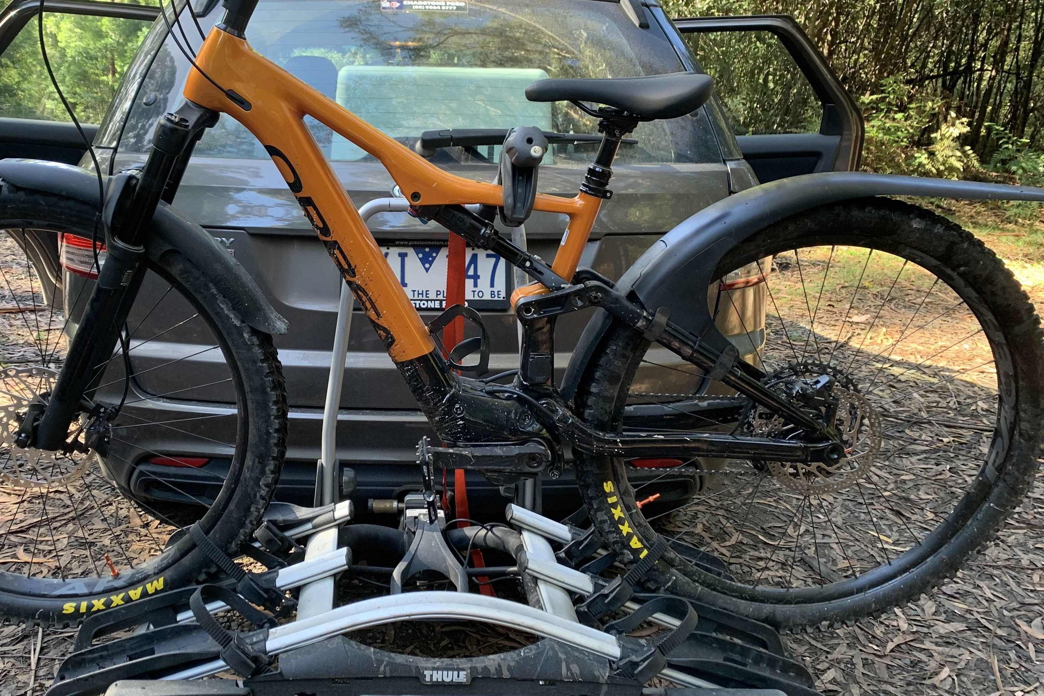

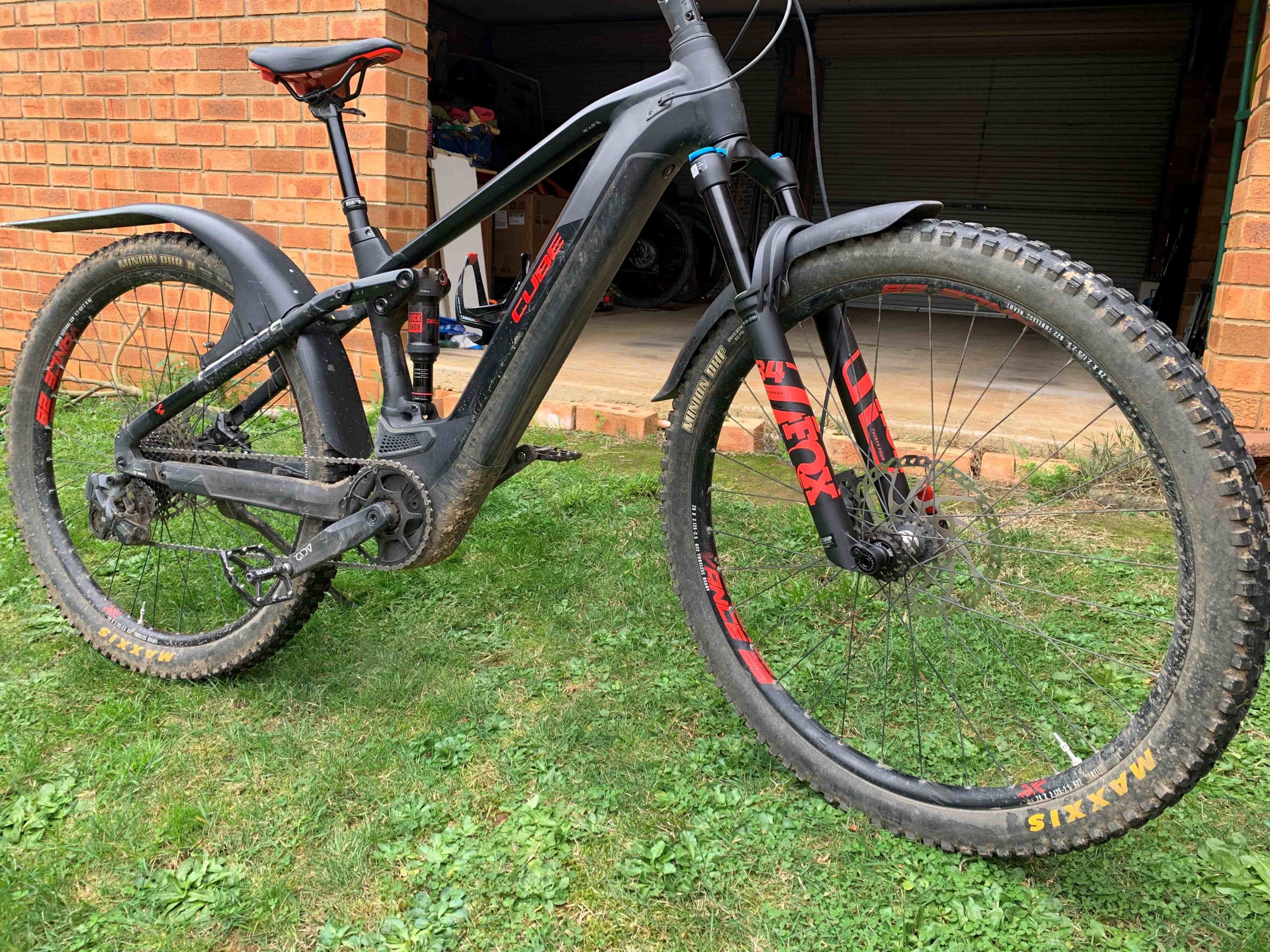

Even if it needs a little trimming or alteration the Mudhugger V2 should fit your bike. The tongue does a pretty good job of keeping mud off the bearings on my Rise. I've got the first version on my Cube and rivetted on a bit of old mudguard to act as the tongue - looks ordinary but most of my riding is in muddy conditions.

The size L mudhugger extends past the end of a 29" wheel and can be trimmed by about 2cm.
I'm sure mine is a Large mk2 and it definetly doesn't as shown in the picture I posted in this thread.
maybe mk1 were longer? but also it could depend on the angle of the rear suspension pivot beam thingy whatever it's called that the guard attaches to.
so one one brand it does but on a whyte E-160 it doesn't because of the shallow angle it sits on.
Like on the your Cube pic. it looks like the mudguard sits a lot higher on the frame than on my whyte
