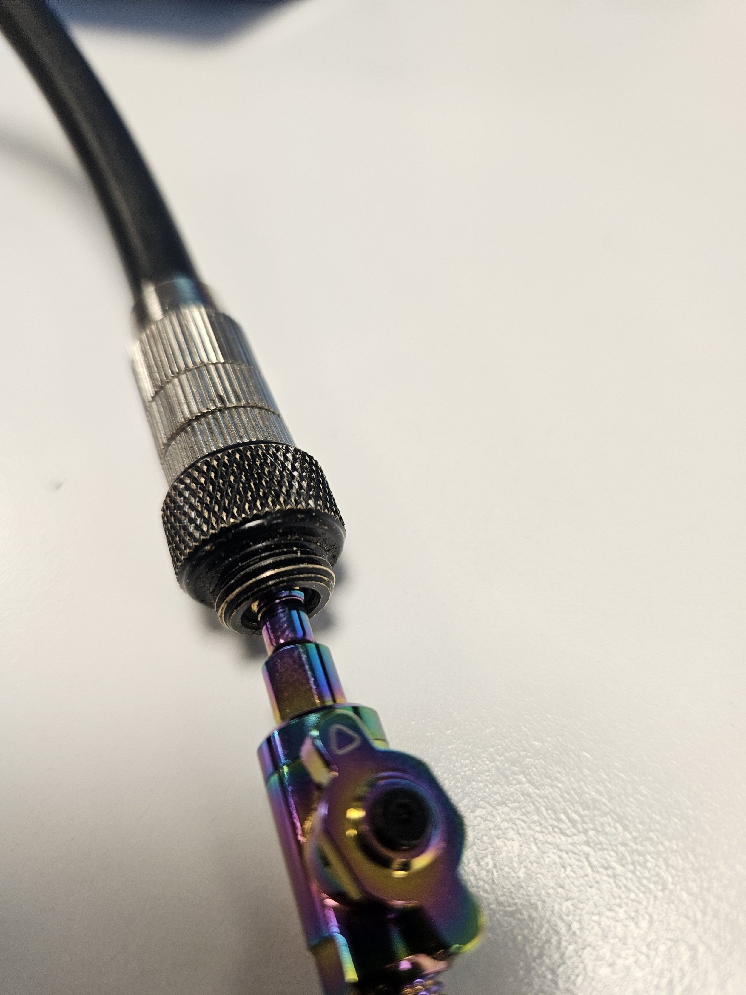

I reached out to Muc Off to ask about compatibility with pumps with screw-on chucks (specifically Lezyne), and this was their reply:
"Our Big Bore lite valves have a standard sized Presta thread with the only difference being the length of the threaded section. On the Big Bore valves the threaded section does not extend all the way to the head so we have found that with some threaded chucks you need to just engage the threads to create a seal rather than thread it all the way to bottoming out. If you attach the chuck past the threads then it can loose it seal and not work correctly. I have attached a photo to illustrate this for you."
This could be what "Michael F" was experiencing ? This is the photo Muc-Off sent to illustrate the point
I'm pretty keen to give these valves a try - probably the hybrid version - I think they're a great idea
So in the above event you have to thread your chuck just the right amount and no more in order to ensure getting an effective seal?

As mentioned, if you have a screw-on chuck, the coreless design of the Big Bore is the bees knees because there is no core to unscrew. That said, I must have dodged a bullet getting the Hybrids instead of the Lites, as I don't have any issues with my pumps getting a seal on the schrader head. Regarding the Lites, it looks like a redesign is in order to add some thread length to the head. AFAIC, the fundamental ball-valve design is not at fault here, so maybe an update will not be far off.
