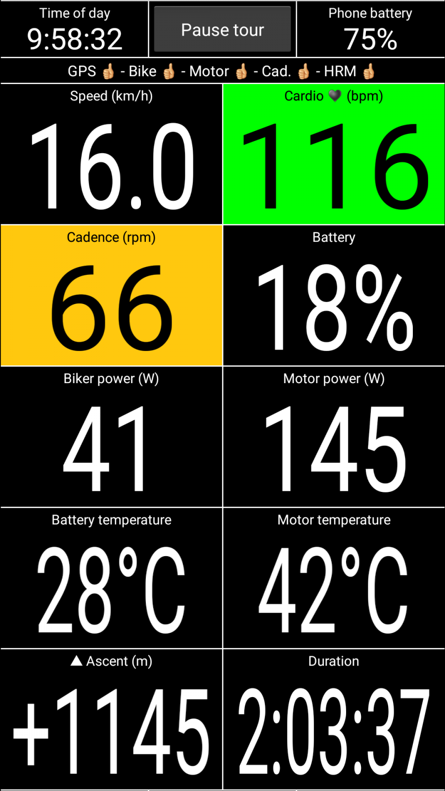

After your related post on power loss when the battery is lowish the other day I did a small test yesterday whilst riding back on the road from the pub.
I set the bike to Turbo and road flat out ensuring to keep just below the 25kph mark for the entire trip so the motor was working continuously and wasn’t disengaging to keep the work rate of the motor and battery up.
The distance was just over 7km.
I was at 30% battery level at the start and finished on 5%.
As it is Wales there were a number of ups which worked the engine fairly hard.
Max reading on the battery was 33 degrees
Max reading on the motor was 49 degrees.
We may be able to get @PaoloBLEvo to code in the above output values in the Blevo ride stats. He was able to do this for max motor power and max biker power. So he may be able to do it for battery and motor temperatures?
Both temps dropped quite quickly after I stopped.
The ride took about 16 minutes.
The interesting bit was the power output. I couldn’t get any more than 550 Watts so a loss of 100 plus of what I normally get when I am in Turbo on my 2017 Levo.
Not sure if the lower power output was down to heat or down to the low battery level or down to both. I will need to try the same test on a full battery to see what happens

This is how I have my display set up when I am riding.
