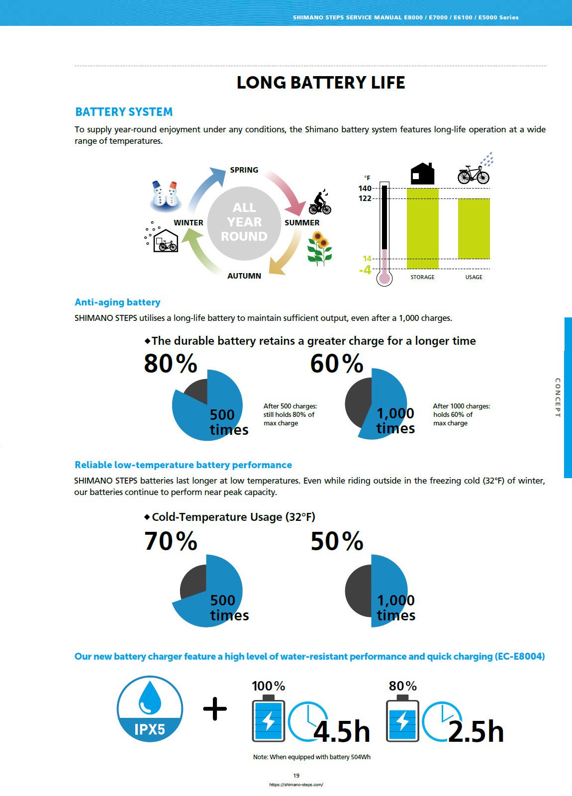

My first emtb was in 2019and it had an e8000 motor. The data that came with it spoke of 1000 recharge cycles before the battery charge fell to 90%. I wish that I had kept that hard copy, because I sure can't find that on the internet anymore. Now people are mentioning 500 recharge cycles!
Here it is....

Interesting specs, 80% after 500 charges doesn't sound great. Is that the spec for today's batteries? I'm trying to baby my battery, keeping it ~60% when I'm not using it. I have it on a smart plug and charge it the morning of to 100% when I know I need it. I have never gone completely to 0%, I think the lowest I've gotten to is ~10%. I have a 900 watt battery so I usually am able to get at least two rides before worry about charging. With that much battery, I think the very worst case scenario of 20miles per charge at 500 cycles would equal over 10,000 miles so I feel pretty good about longevity...
80% at 500 cycles is very good compared to the real Shimano batteries.
I had a Shimano 504Wh BT-E8010 that after 80 Cycles had a degradation of 76%, then Shimano removed the degradation number from etube diagnostic after V4.0.3 .
But it still could be read using STunlocker, and take into account that when reading degradation value from the battery, the data path is: Battery->Motor->Display->BT->Cell.
As battery FW is not upgradeable it was not possible for Shimano to "improve" the degradation number calculation in the battery, so Shimano fix was to release a motor FW upgrade 4.9.4 (For E8000, but EP6 and EP8 have a similar FW upgrade) that when degradation data was transfered to the motor, it changed the degradation number from 76% to 86% , so it was not covered by the battery warranty.
