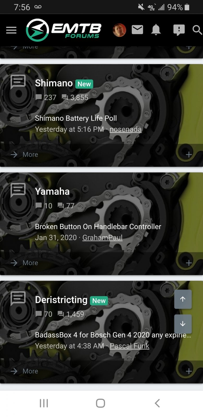

I check the motor section of the forum frequently, and if Yamaha has a reliability issue, they hide it very well from folks riding their bikes.
The last reported yamaha problem on this site, in the motor forum, was a broken button in January. Lol.
