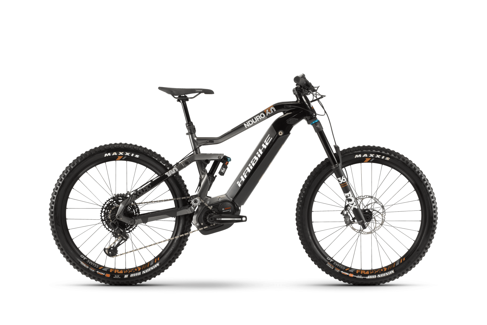

It really varys from bike to bike - TBH the main culprits of drag with the Bosch are Haibikes imo - the use of an idler wheel on some of their bikes means lots of drag when post the assistance.
If you rode a Cube for example, back to back with an idler wheel equipped Haibike, you would think they had different motors past the cut off.

Probably you'd have to measure motor drag by riding the bike with a power meter with and without the gearing and motor installed in the casing, which no one will ever do. So just make up a number.
My Haibike SDURO with Yamaha PW-SE motor has a lot of inertia in the motor, which I feel mostly riding through the park on the way to work when I sometimes turn off the assist. The odd thing about the drag / inertia is that it is inconsistent. Climbing a gentle grade with assist off I don't notice this as much; and I can ride a couple of hundred yards in the morning before I remember to turn on the bike.
I wouldn't want to pedal the bike any distance with the motor off; but I went 9 miles with the motor set at 50 percent assist and used 7 percent of the battery, so I'm not too worried about running out of juice.
