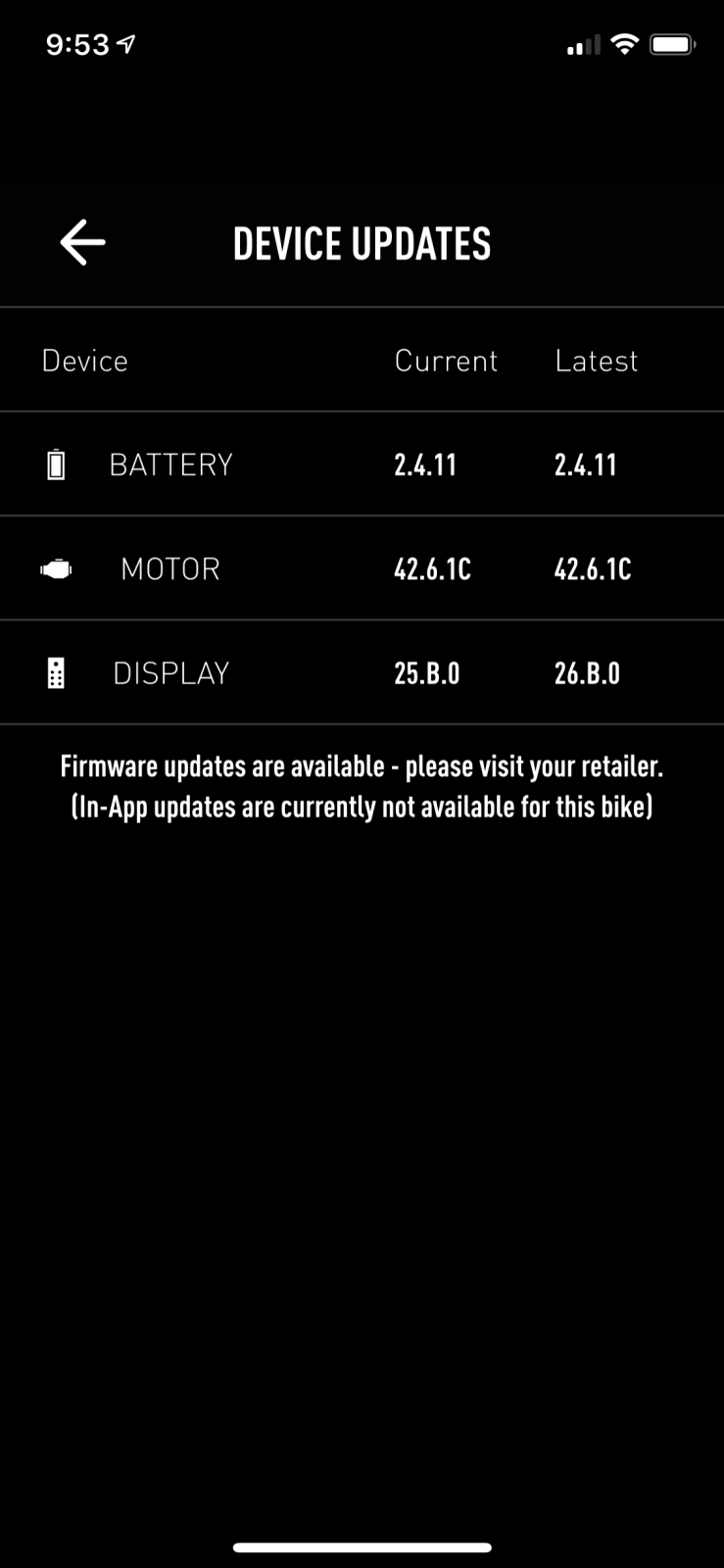

I've just updated Mission Control and tried this but I'm shown a message that I can't update through the app. I have a 2019 Turbo Levo. Any ideas from the experts?
Sorry to hear - you definitely don't need to reinstall Mission Control. Could be worth logging out and in again, if that doesn't solve it I'll PM you get serial number and check in our back end here.

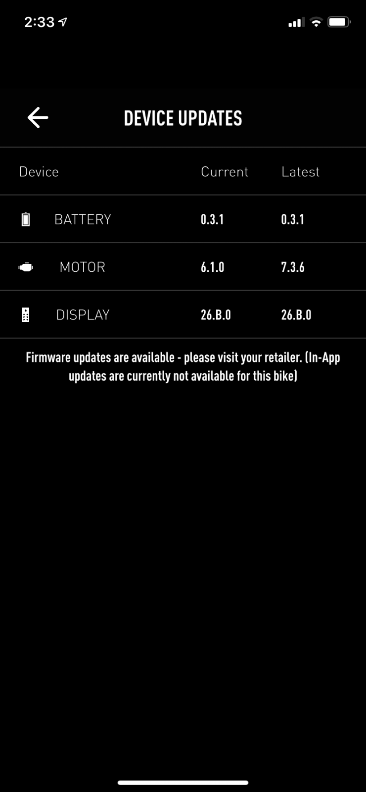

So I have a Levo 2020 and the latest iPhone App and still cant see the upgrade option
My motor is 6.1.0 but told the latest is now 7.3.6 but I cant see this option. A friend with the same bike has the upgrade device option on the app
What I am missing here please

Maybe Logout/Login in MC app is doing the trick.
Yes, logging out/in was the key for me when they first released MC with in-app updates . I didn’t need to again to see 7.3.6 is available but we’ll have to visit a retailer for it.

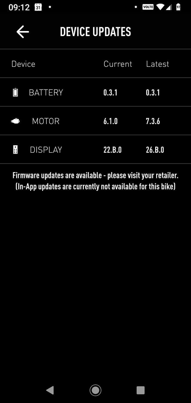

You're missing a decent Andriod phone instead of that over priced Apple rubbish. LOL.
