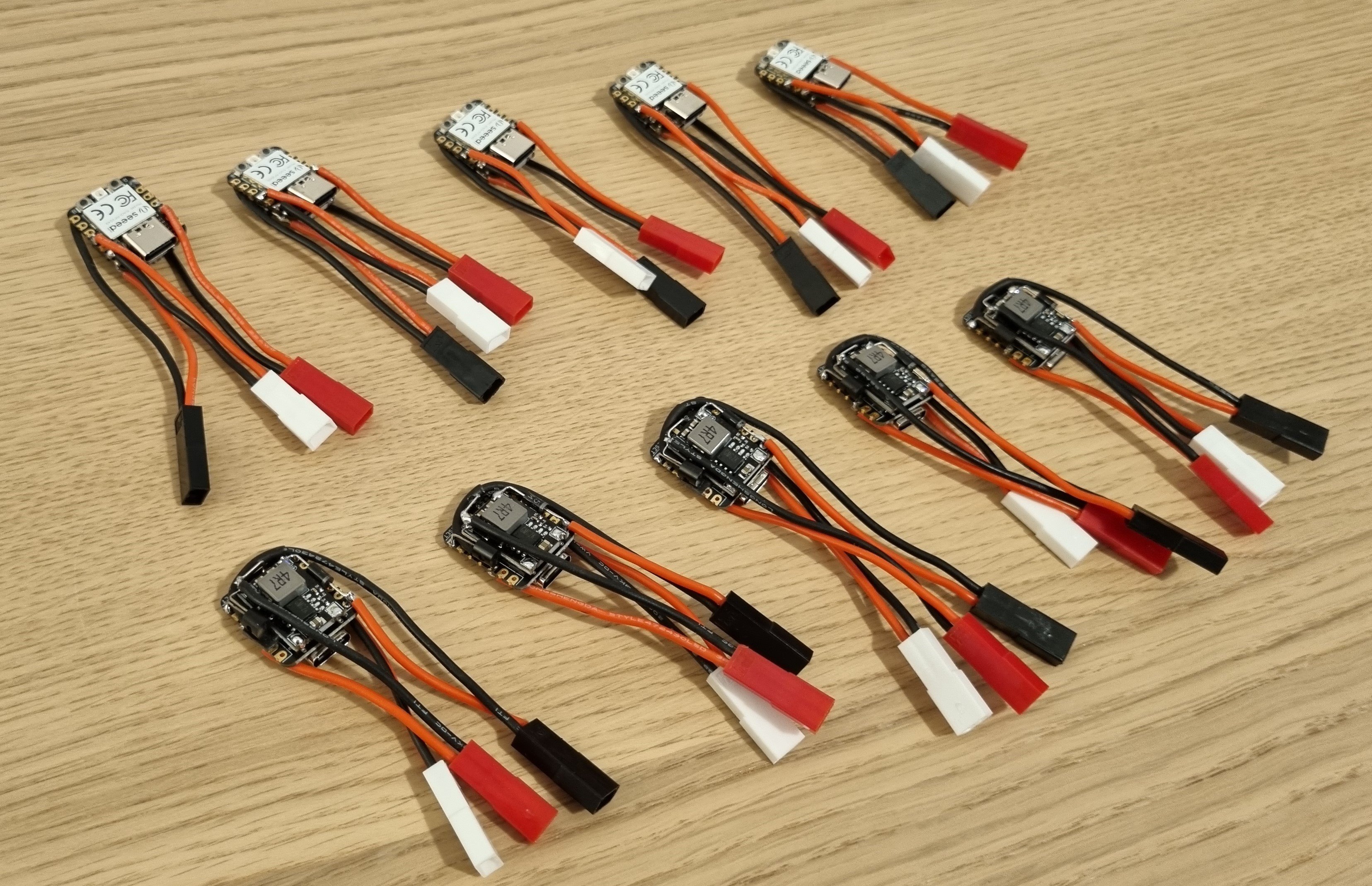

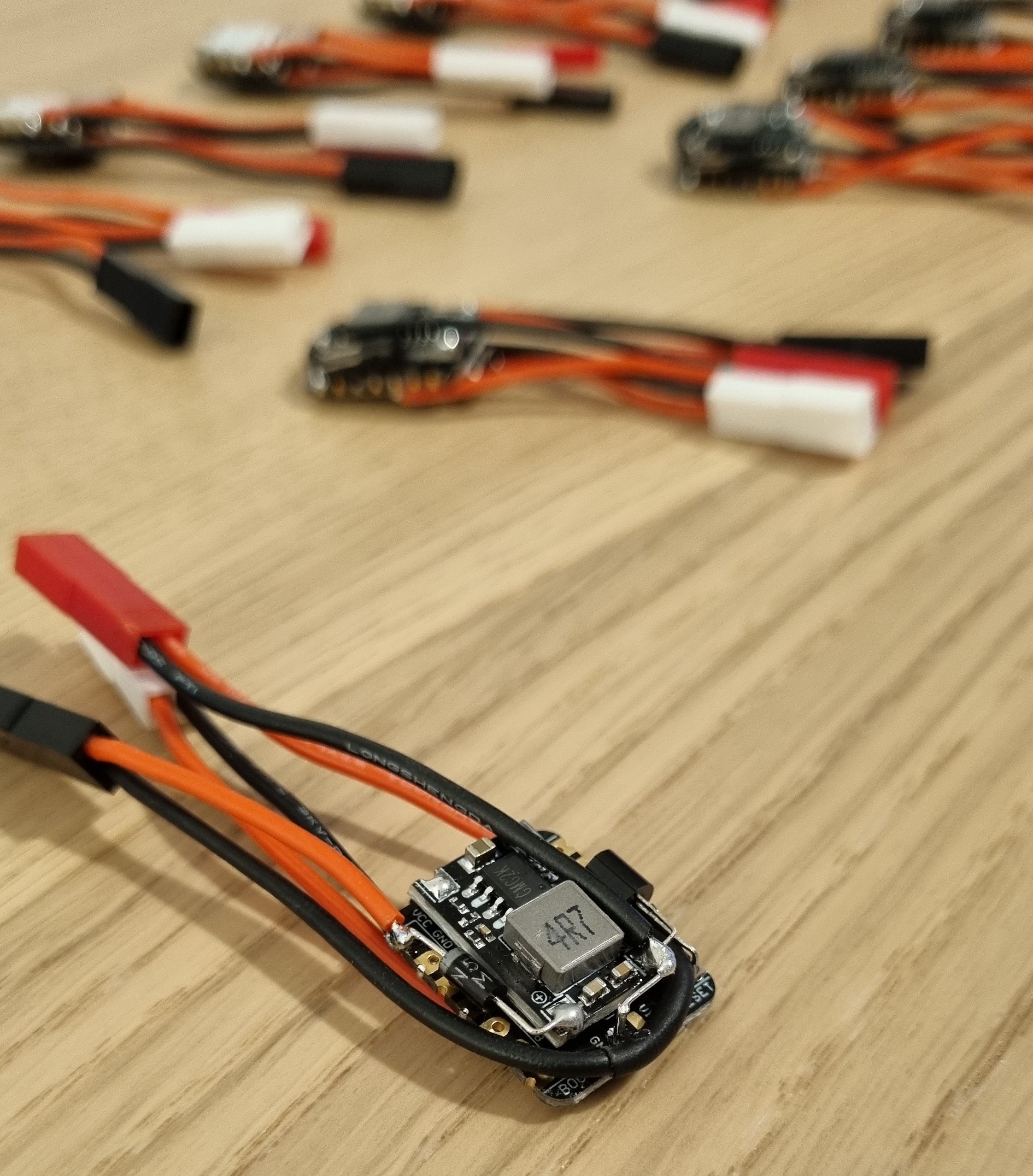

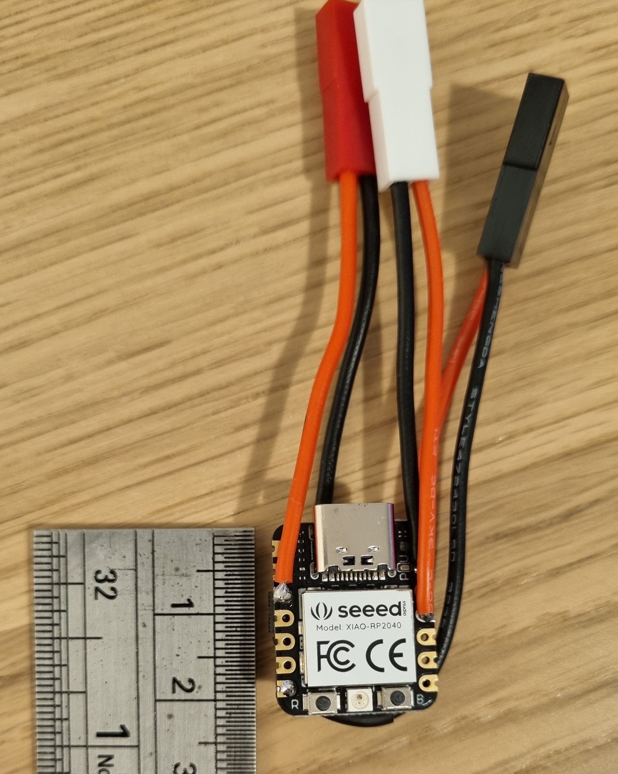

Finally, most of the components turned up for the first batch of Megabobras. Still waiting on the Bosch LPP cables, but the remaining parts are assembled and are waiting to drop the cables in.
There have been a few upgrades since the original tutorial. These models all now run on the RP2040 boards; more than 10x faster clock speed and less than half the size than the original Arduino Nanos. These devices now also feature the Setup mode jumper cable to assist with electromagnet placement.
Once the Bosch LPP cables are installed, these will be sealed up in heatshrink end caps. I'm finalising a manual to assist with setup and operation - this will be ready by the time the cables arrive.
Now is a good time to remind everyone that these devices, as with any which lift the assistance speed, are only for use on private property, may increase wear on your drive train and may void the warranty on your motor.
I'll begin reaching out to everyone directly by direct message in the order they expressed interest once the Bosch LPP cables have arrived.
