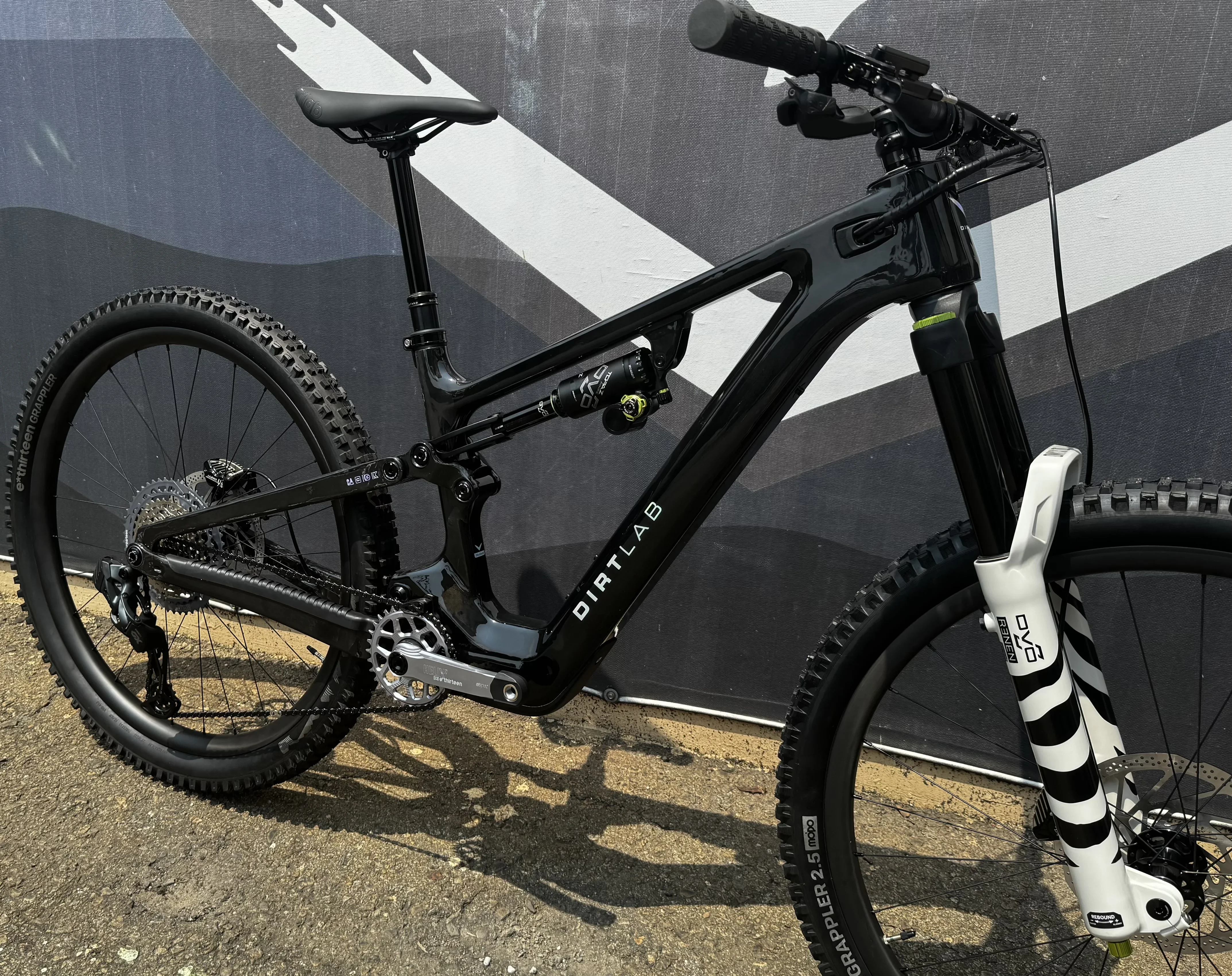

Good points overall, and we’re aligned on more than you might think.
On the flexstay — fully agree, and honestly I was curious what you’d say. You landed exactly on 130, which is precisely where we’re at with that. We did try it at 150 but felt it was too close to the Paratu CP’s travel range and frankly not good enough to justify producing. So 130 it is, different rider, different brief. The Paratu CP runs a concentric pivot, proper four-bar, so none of the chatter and brake sensitivity issues you’re describing. Rear travel is adjustable at 145, 150, 160 and 165mm via shock stroke, and we run longer 230 eye-to-eye metric shocks for heat management and durability on a platform that’s working harder. Coil approved too — personally I prefer coil anyway. The weight penalty is a non-argument when you factor in what you get back in feel and longevity on a heavier, harder-hitting bike. You put weight where it makes sense, and low in the rear linkage is exactly that.
Frame-only is actually our default — it’s how we prefer to sell. We’re a smaller operation and we’re not going to pretend we can nail everyone’s spec wishes with a complete build. We don’t want to put together a kit someone pulls apart the day it arrives. We like custom builds ourselves, and our kits are set up for exactly that. Suspension-wise you can run DVO or Öhlins now, RockShox coil coming later.
On battery — noted, cell technology is moving fast and it’s something we’re watching closely
Only other input is I prefer the 180mm native rear brake mount. I think it's enough for a bike in this travel range and pairs really well with a 200mm front rotor.
Every other sport has a larger front rotor than rear, because it just feels more balanced. Bikes have not caught on. If you do a 200mm rear, well now you need a 220mm front.
Regarding HCR, it's extremely unpopular but as long as you have electronic shifting and dropper, I really like it. It's clean, light, works with MX or standard brake mounting, cheaper to implement, etc. If I was designing a bike, I would not know what to do here because a huge number of people make a big deal about this. But I feel with only one rear brake line entering, it's a moot point. Maybe a really slick upper headset cup would included would remove those concerns?
