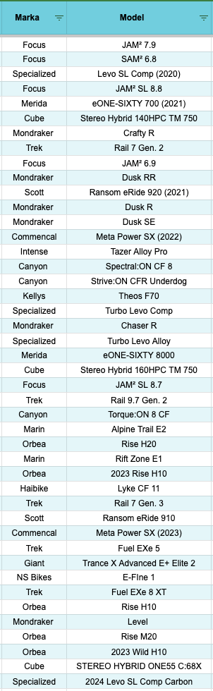

Well gentleman, and ladies - if there are any here ;)
I know this question seems as trivial and beating a dead horse, but please bear with me and prepare for a small essay :ROFLMAO:
I've become extremely unsure of my decision to buy an EMTB as I spent last year educating myself about EMTBs, what they offer and what would be the best choice for me and more I read the more unsure I become.
  • First of all, I am an analog MTB rider - I've been for ages and I do enjoy it greatly.
  • Second of all, if I would live in or near mountains I would not waste you time.
    I live by the sea with not much of an elevation.
  • Thirdly, I do not have much if any experience with EMTB.
All these aspects I mention create my unsureness.
You see, spending circa 6k eur on a bike is a MASSIVE challange for my budget.
Currently I ride 150mm travel (f&r) 29er, with 465mm reach, 66 degree head angle and 74 degree seat tube angle.
On most trail rides and daily basis, it is "ok" but due to my weight, height, but most importantly not the best (to say at least) suspension I feel it is heavily limiting me on my local bike park, which I enjoy greatly.
Here is 1min video of one of the trails just so you get an idea -
Since there is not much elevation most people in this region rides EMTB as it allows them to do more runs/loops.
I can do 6-8 runs and I'm completely done, where some of my mates are doing double in same amount of time.
Obviously an EMTB was my first idea of an upgrade, and I prepared full google sheet breakdown with models/specs I fancy the most (screen shot attached) but more and more I dive into the subject I get more and more unsure.
My main issues/worries are the weight of EMTB and the power delivery.
I know the engine helps with the weight but at the same time I do not want to feel like I'm riding an off-road motorcycle.
So my second idea was choosing something equipped with Fazua or TQ motor but then Bosch presented SX and there is no info what bikes will have it.
So to sum it all up, should I not be worries about the weight and just get full power EMTB, or due to my liking of analog bike should I get something mid-powered. And if so, should I wait for SX, or should I hunt Focus JAM SL or Trek EXe?
Any insight of people with lots of experience would be massively appreciated.
Thank you :)

After quite some thought I limited my choices to these 4, as they are available in similar price range and specs.
Question that stays is which one to choose :D
FocusJAM² 6.9Bosch CX Gen. 4Fox 36 FactoryShimano XT
CommencalMeta Power SX (2022)Shimano EP8Fox 38 PerformanceShimano SLX
Canyon Strive:ON CFR UnderdogBosch CX Gen. 4Fox 38 RhythmSram DB8
PropainEkano 2 ALShimano EP601Rockshox Zeb Select+Formula Cura 4

These are all nice bikes, but none have the new EP801 Shimano speed motor, so you will be limited to 19mph which, after you get used to riding an eMTB, will drive you nuts. Buy a full carbon hand-built LaMere from us built up just the way you like with carbon hoops and instant engagement Onyx hubs!

Nowt with Shimano on it, which leaves only 2
Focus. Way better all round bits.
