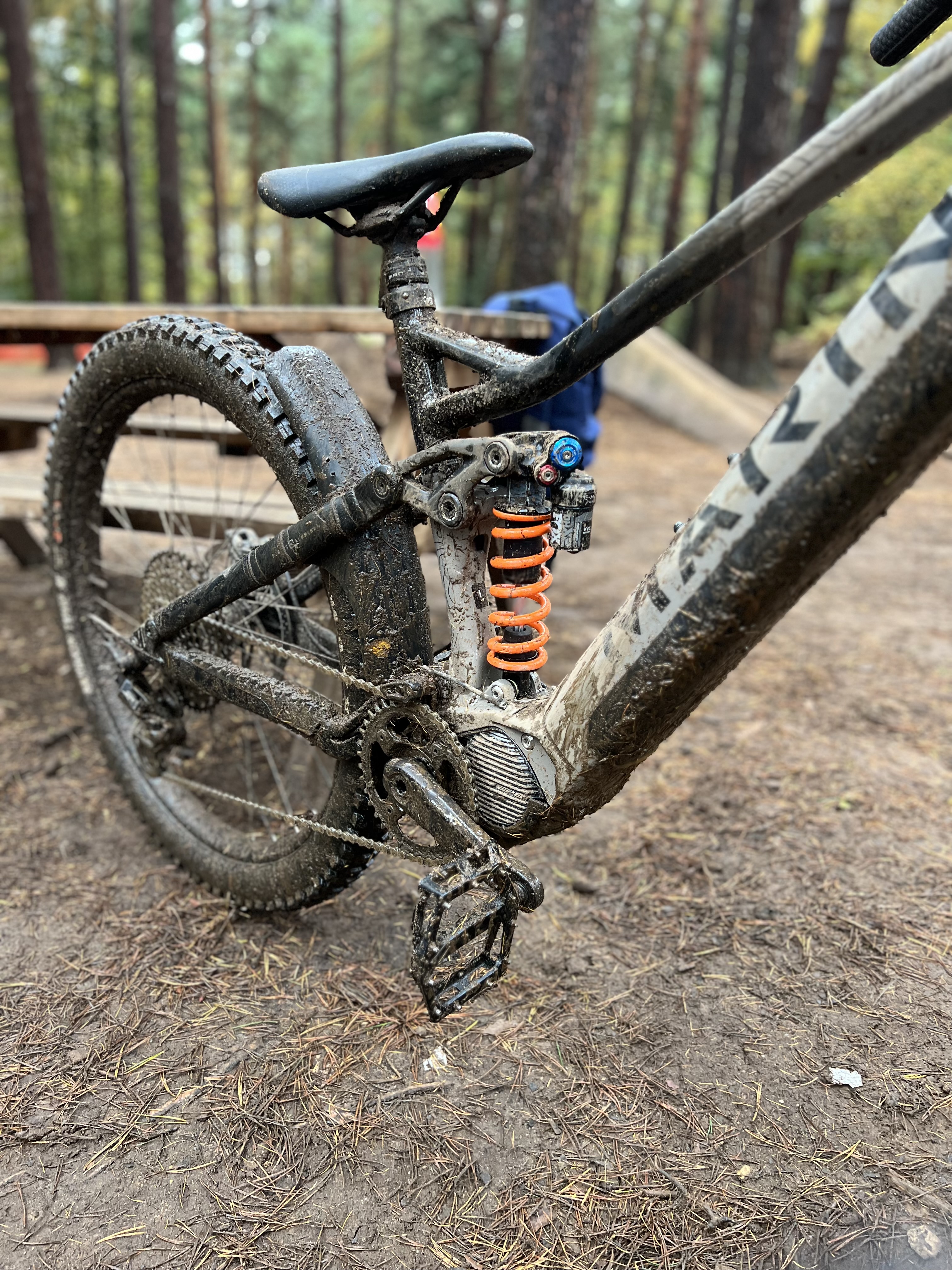

From day one I've loved the E2, more so now I have the heavier spring fitted and had some riding time on it.
But there is one thing I hate and that's the speed restrictor, it's like hitting a brick wall when that thing kicks in. If UK/EU were even permitted to use the US speed limit that would be a big improvement, I notice it most on approach to jumps, I guess I need to improve my technique and pop more rather than rely on speed.
What say you guys/gals?

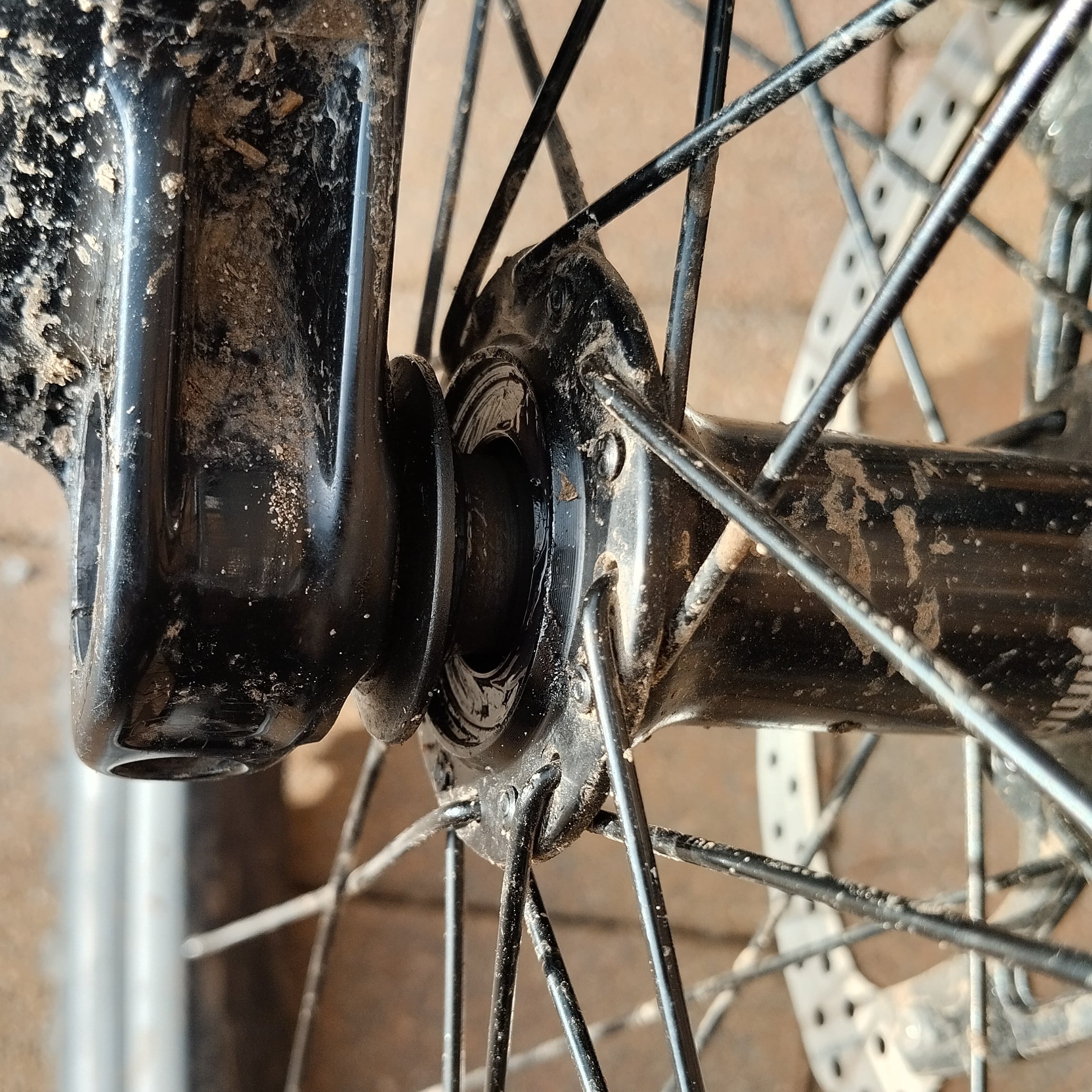

every time i remove the front wheel thru axle on my E2 the hub axle end cap adaptor shifts with it and makes it very hard to remove the wheel until I manoeuvre the end cap adapter back in place beside the wheel bearing. Anyone else have this issue? Anyone come up with a solution? I was thinking some heavier grease behind the adapter to try and hold it in place better?
yeah some marine grade grease sorts me out
So after today's ride (before washing the bike) matey and I took a closer look at it, degreased the fork, thru axle etc, then ran a little pinky round the inside of the adapter and discovered a small bur. Filed that lightly, then regreased and refitted and all is good for now. I'll keep an eye on it going forward.
