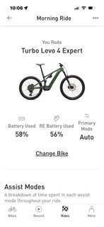

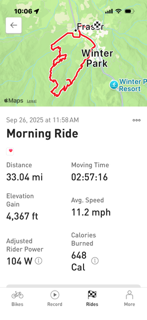

I'm trying to relate to the range anxiety but I frankly can't.
My longest Gen 4 ride last month covered 33 miles with nearly 4400' of climbing in the Colorado rockies (lots of steep up/downs)
74% in Eco-, 13% turbo, 11% eco/sport
I had my Range extender "just in case" but I didn't need. The app shows that I used 58% of the main battery and 56% of the range extender, so I could have easily have done this ride only with the main battery.
For reference, I'm 170 lbs with gear and my bike is on the heavy side with dual coil suspension and dh tires.
my settings mirror fodmtb's recommendations - I don't use any of "extras"
750w battery & 250w RE?
So you used 575 wh (750x.58 + 250x.56) for 4400' climbing?

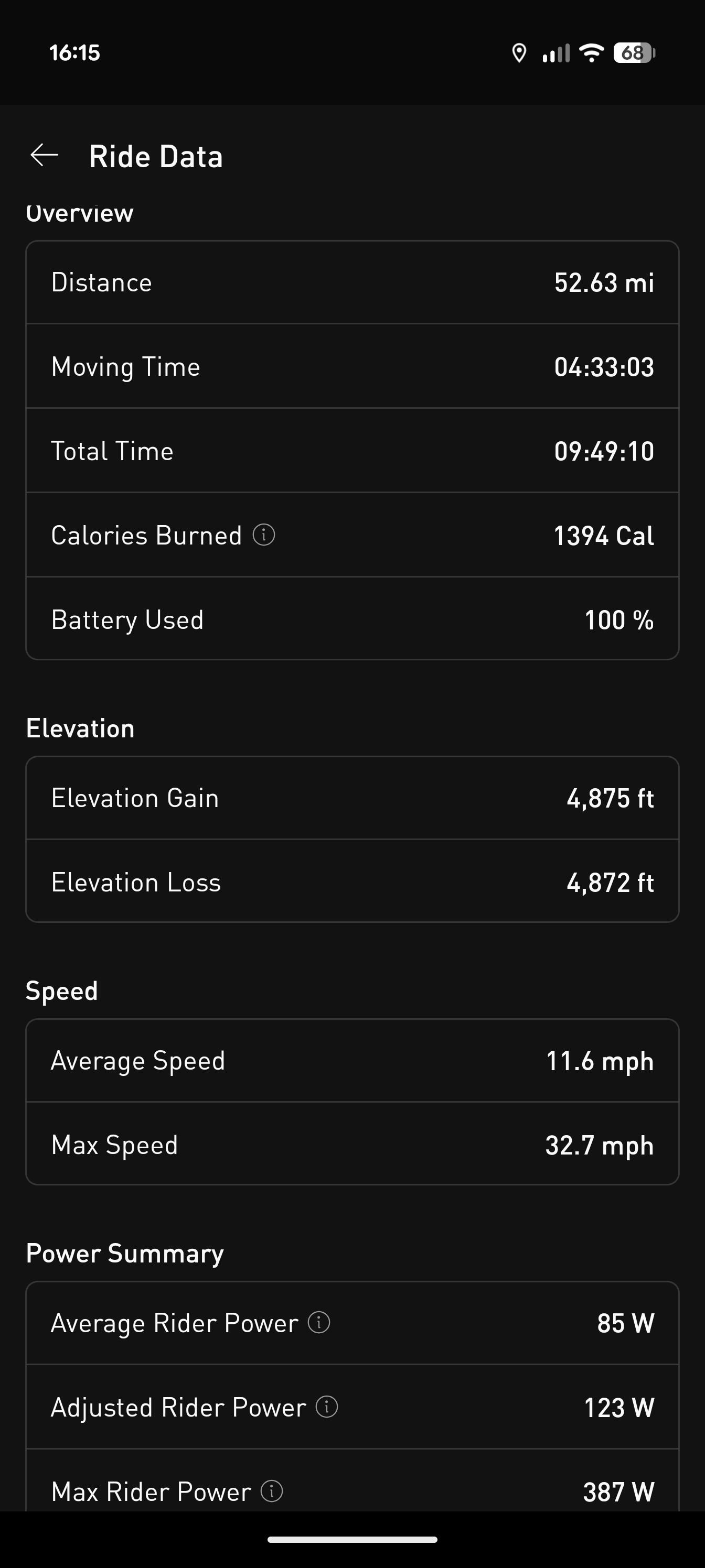

This is my longest ride so far and the battery died a few hundred yards before I got home. It was a very stop start ride as we were collecting route signs after a big MTB event. I used microtune and kept the assistance as low as I could manage. This is the sort of ride that gives me range anxiety.

I understand. 52 miles is a lot. If using microtune, then I presume you didn't use Auto much.
What was your mode distrubution? I ride mostly in Auto - and Eco. Turbo only for boring pavement or fire road.
My eco mode is dialed down and feels lighter than Auto-
My trail feels like Auto standard and my Turbo is full-tilt-boogie.

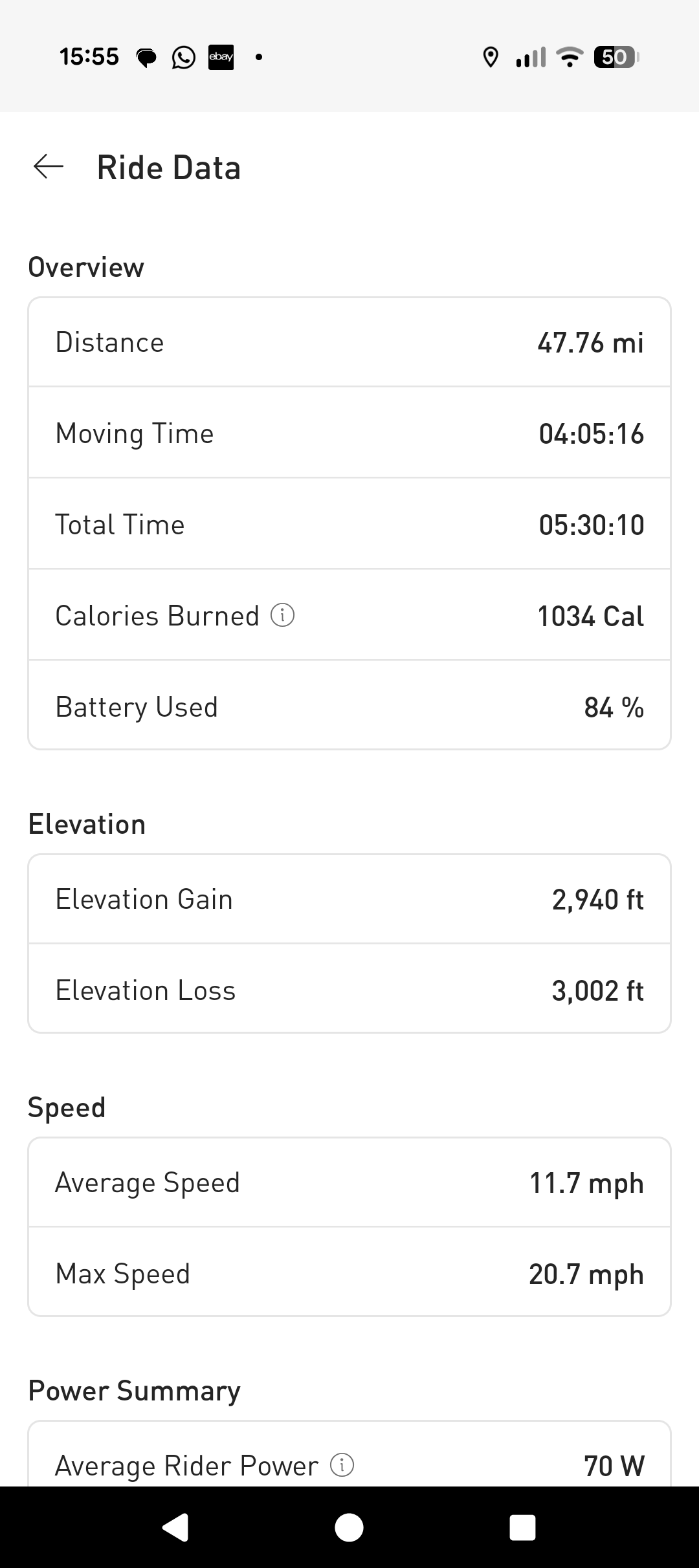

No complaints from range here, using eco 25/25. Still had 12 miles on the clock left, biggest ride I did was 52 miles and came home with 7 miles remaining. This is a mix of off-road light hills and canal tow path

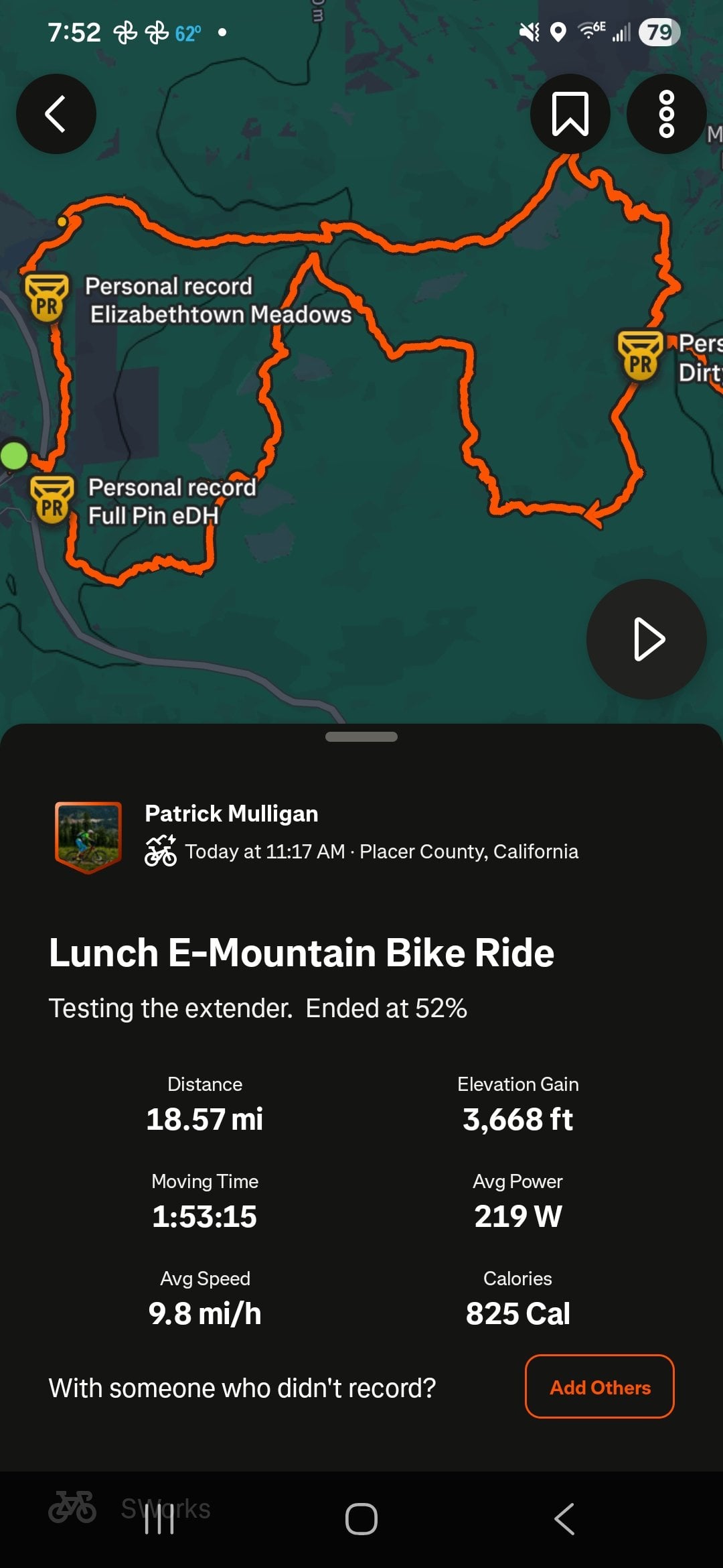

I was testing my bike with the extender today. I ended the ride with 52% main battery and 54% extender. I rode in Auto+, no other battery management tricks. I too do not understand folks range anxiety. We're given so much control over the usable power of the bike. I feel like 50m rides on the reg would be no problem with the extender.

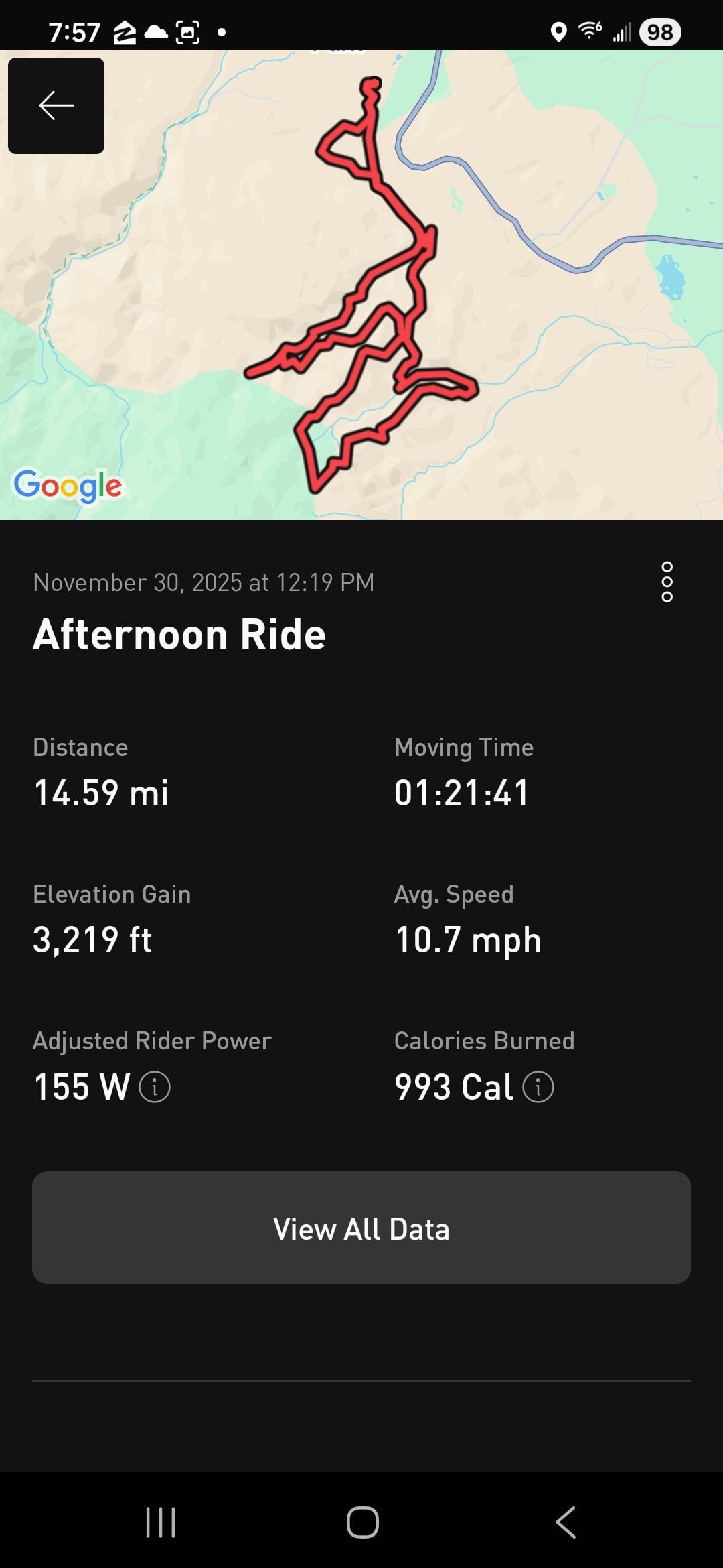

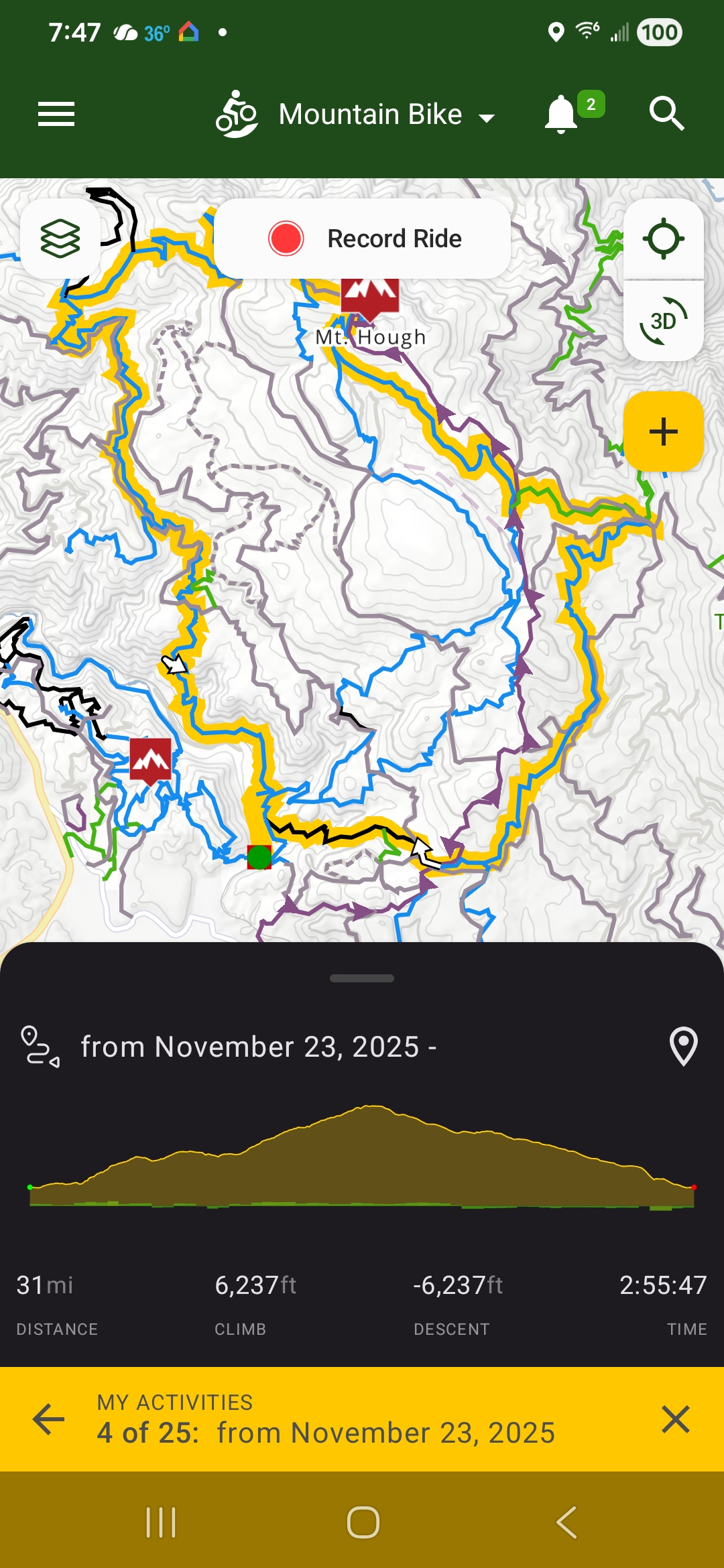

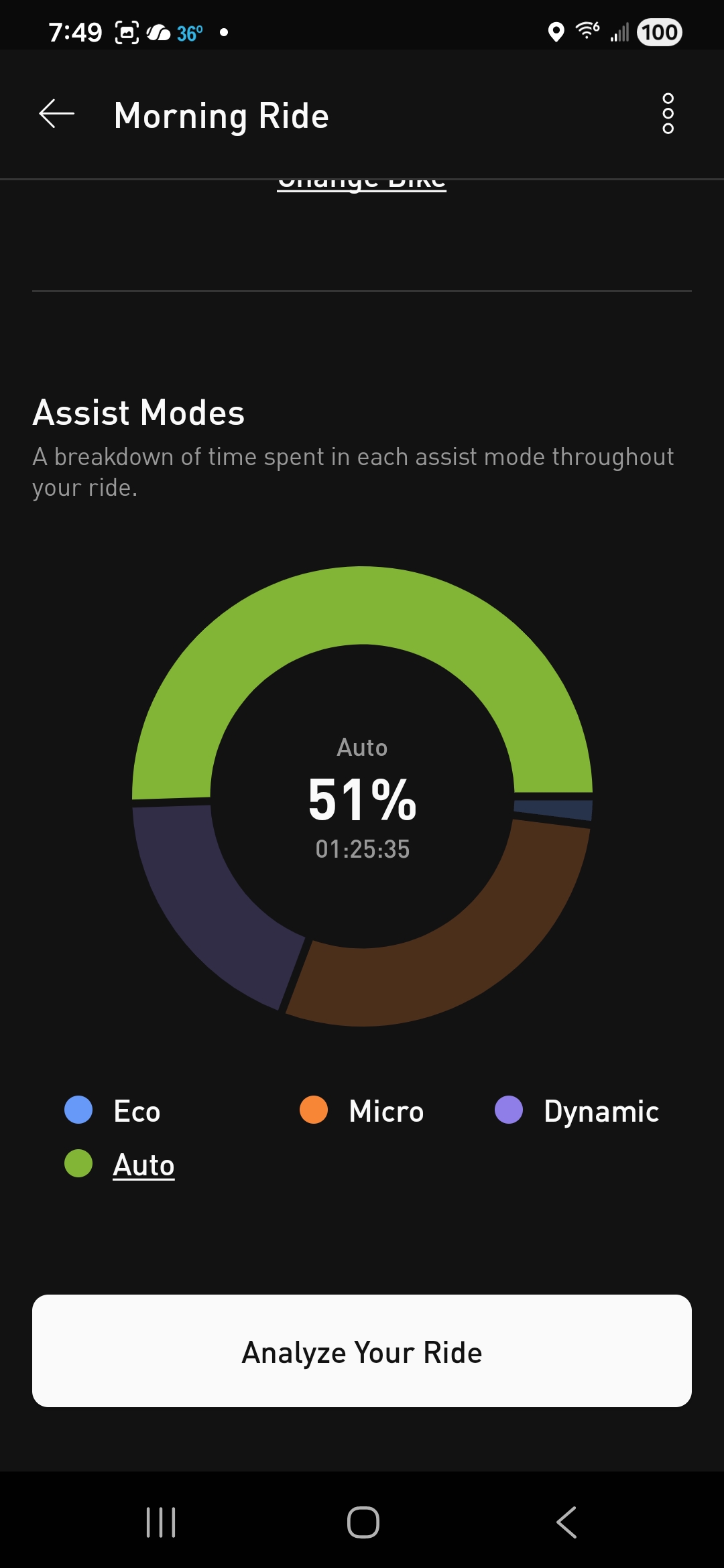

I'm still playing with range and modes as I learn this bike. I wanted to see what I could do using auto and dynamic modes for long climbs. I did the climb in all auto and dynamic tune at 50/100. The downhill I did in eco till the bike was at 5% when I tuned down to 10/10. Battery died the last mile. In Auto - we could do much more.
The next day I rode 14 miles with 3200' in 10/100 dynamic tune using less than 30% of the battery. I really think with active management 60 mile rides could be done on the reg. I just need longer days.
Screenshot_20251206_074904_Specialized.jpg Screenshot_20251206_075703_Specialized.jpg

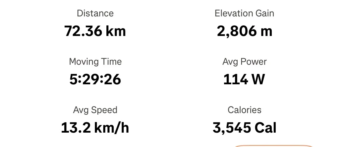

Did a ride recently and could have hit 3,500m climbed easily if I didn’t turbo the last climb😅👌
