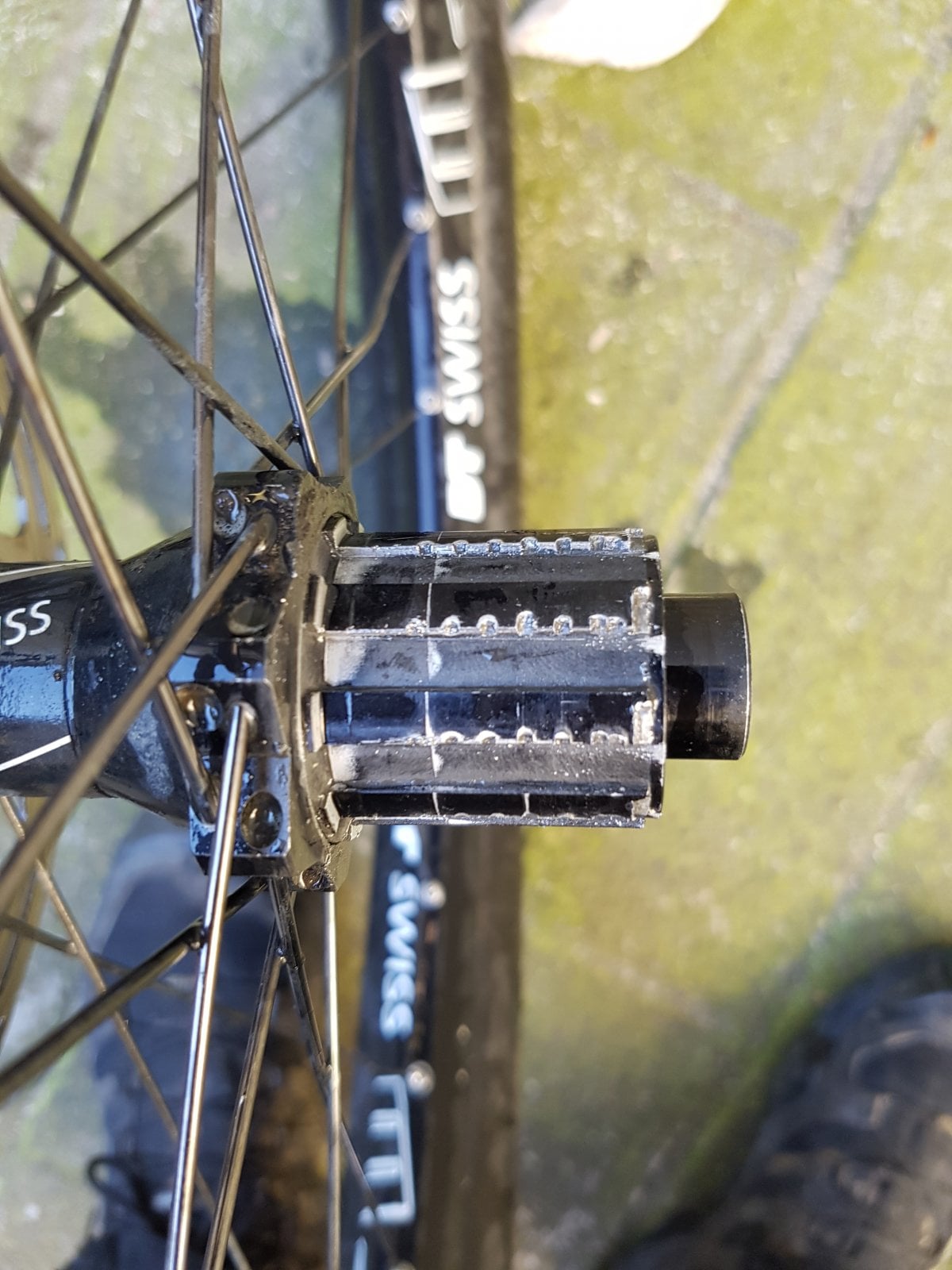

thebarber
May 28, 2018
986
596
Norfeast
Mine was rattling it's tits off so tightened it up and still the same .
Took it off to find this....
It wouldn't tighten because some of the rings were cut into the freehub.
Filed it and refit cassette and all's well.
