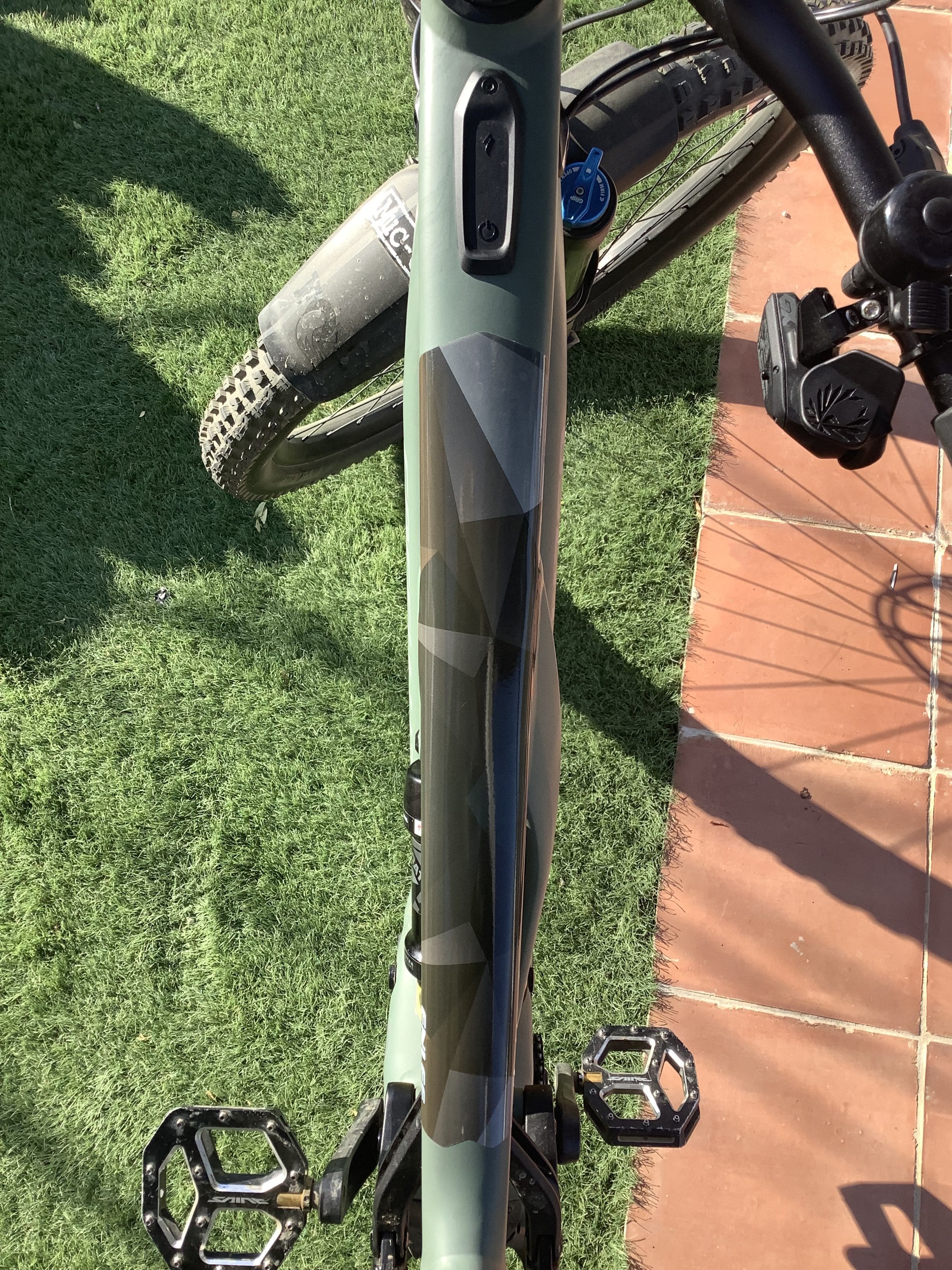

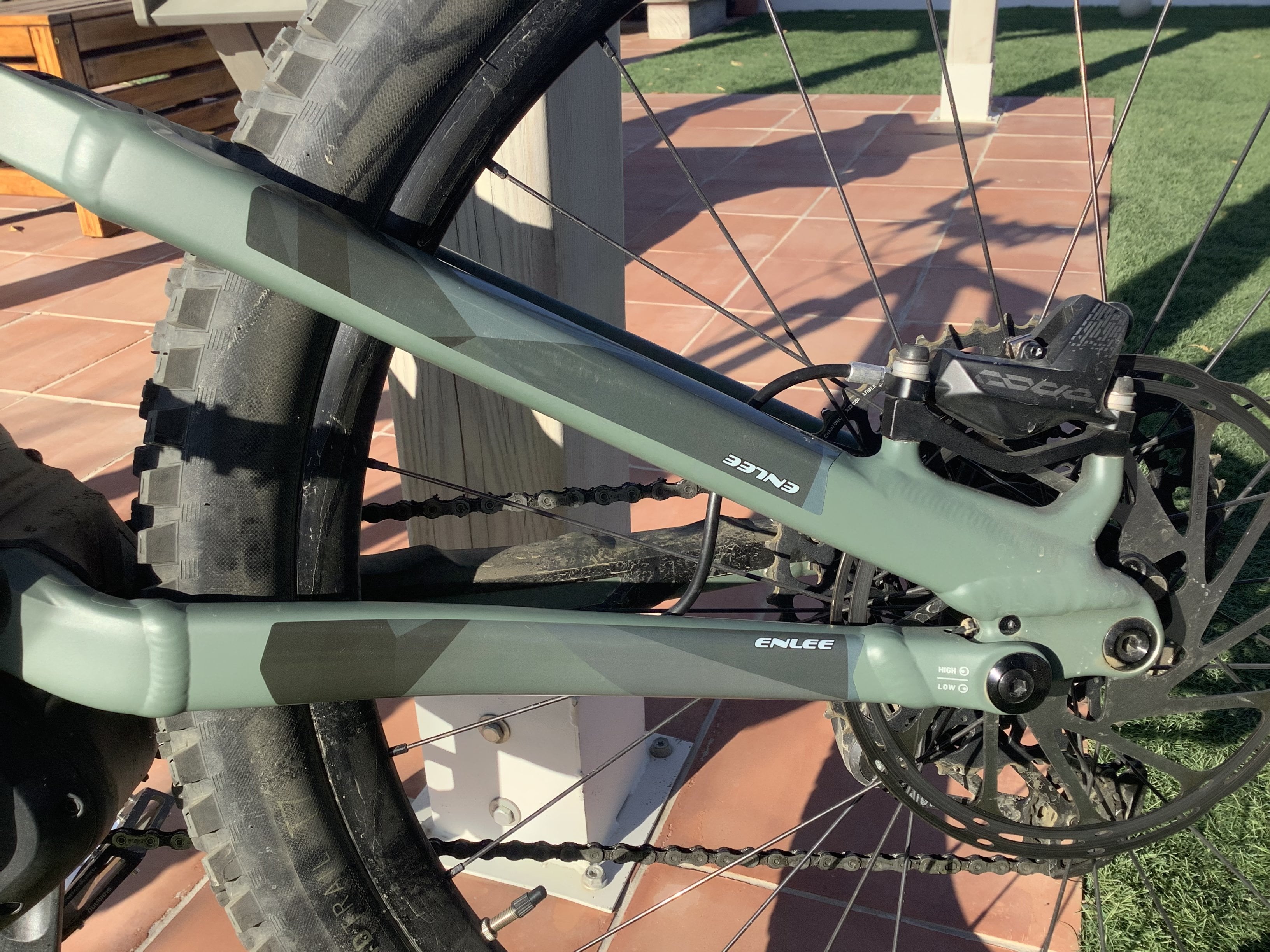

I think this fits very well with my colour bought in China, €15 nice quality.
I have a little bit of paint damage, so the top of one I had to fit a little bit higher.

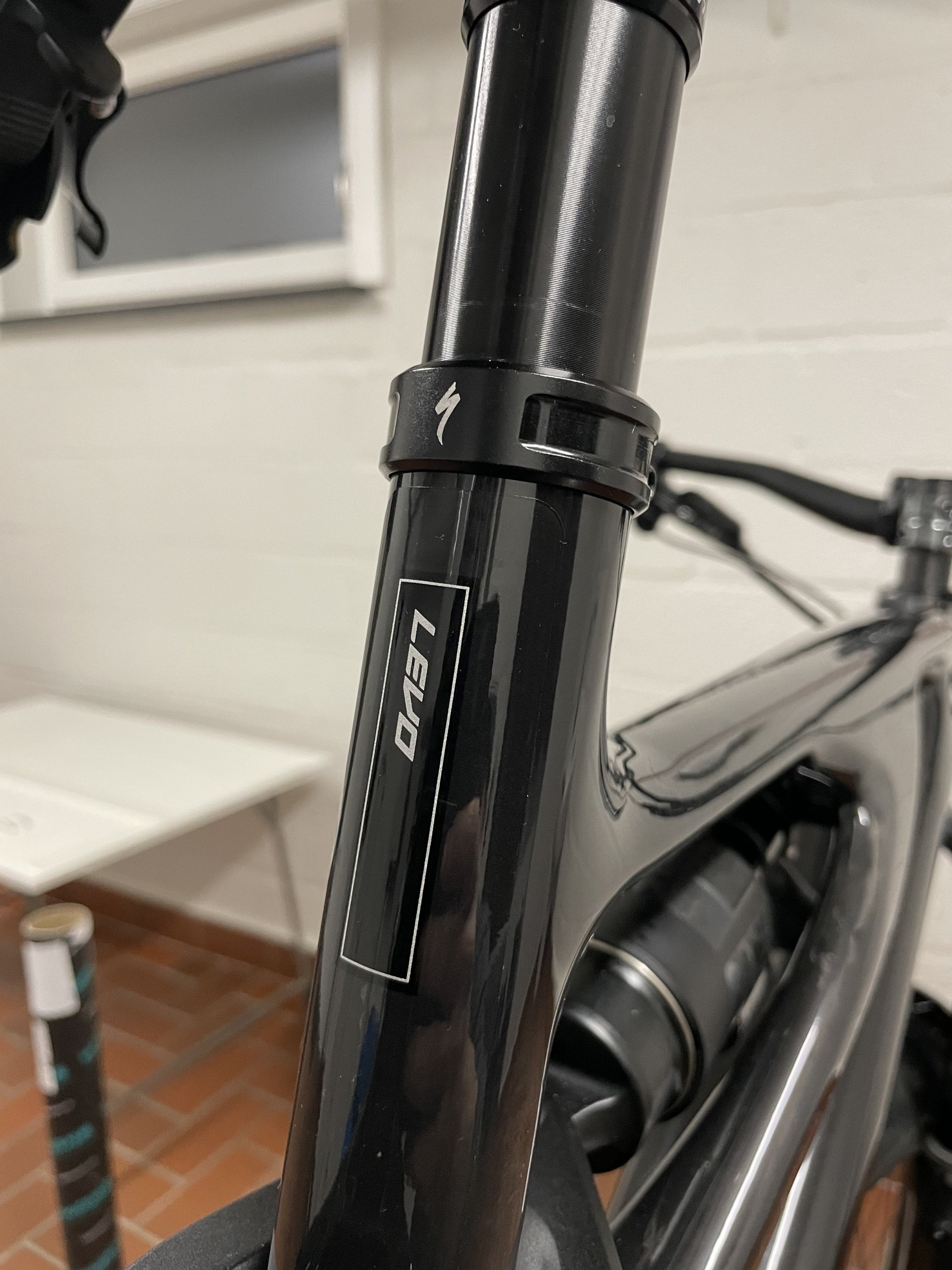

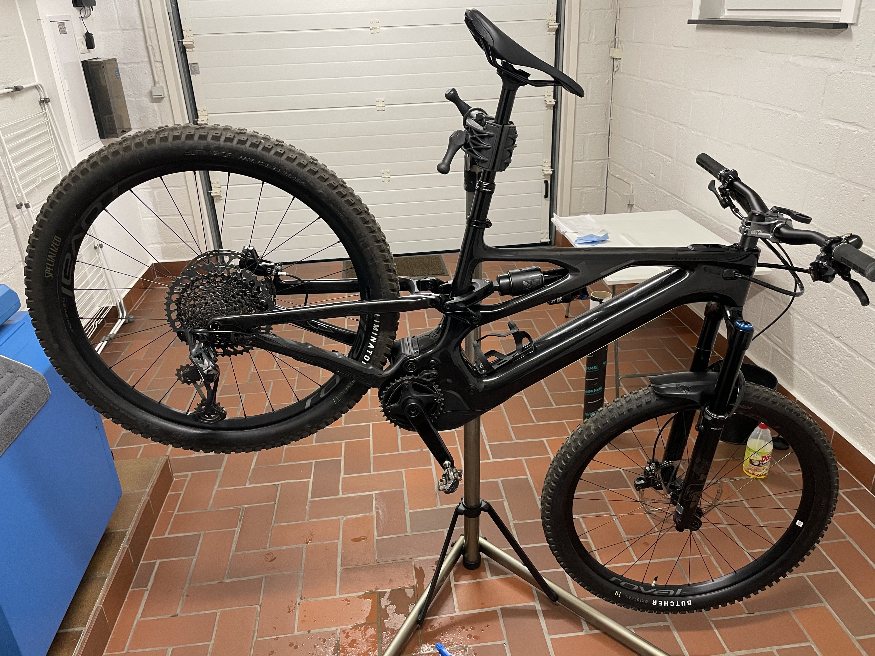

Hello guys. Today i finally came to installing the invisiframe kit on my new levo frame
I have done the rear triangle en crank arms and fork. And now looking to do the rest of the frame (the large parts)
I wanted to start with the rear of the seat tube. Where i woud need to remove the original protection film…. Does the levo decal come of when removing the original film? or does it stay on the frame?
Then the top tube part…. There are decals with frame nr ect just above the rear shock. Does the invisiframe kit go over these or not?
0AAE4AC2-81FA-49D2-A448-45972A87D728.jpeg 836792D6-A781-4286-8ECD-41F6362F9AFE.jpeg
Same bike and color way. I removed all of the stock protectors even though others on this thread indicated I didn't necessarily need to. None of the factory decals came off with the protector, so I covered over them with the film with no problem.
