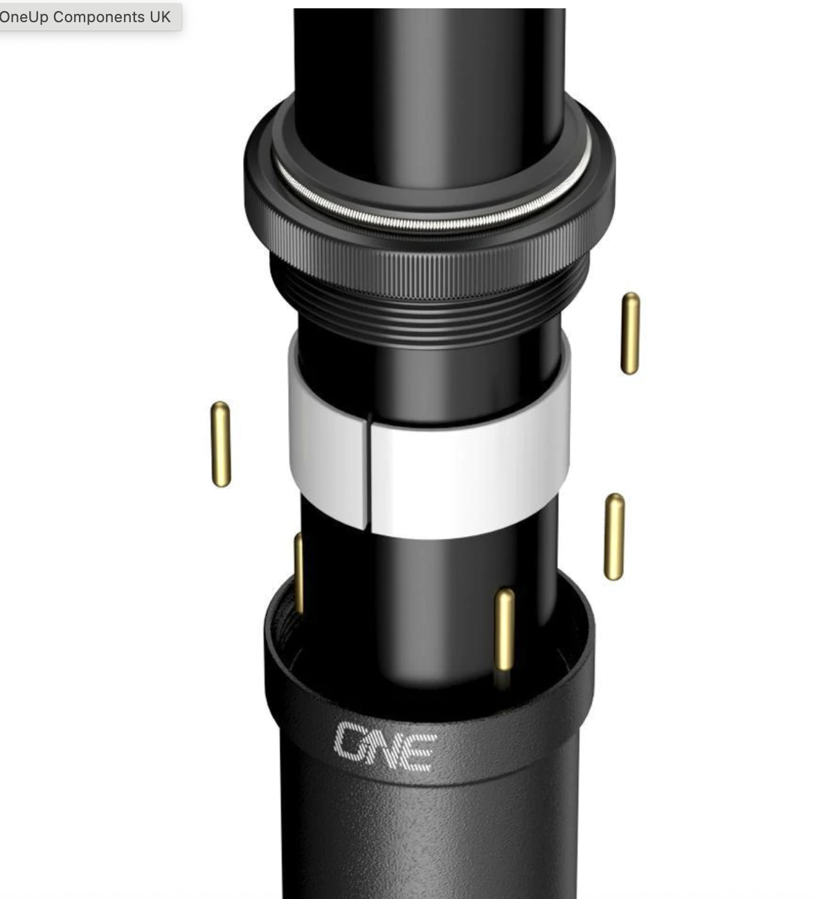

I think it can go down for about cm, I'm pretty sure it cannot be slammed it all the way in ... It comes with pins with which is possible to shorten the travel by 1cm increments ...

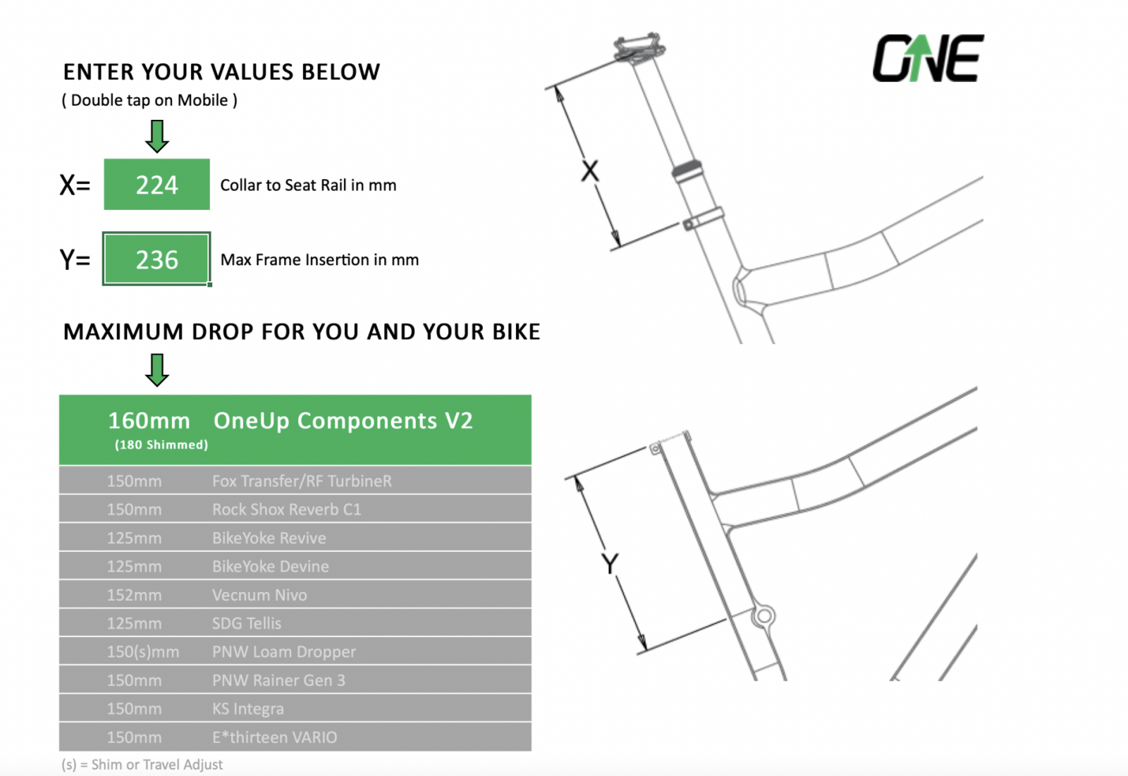

Measured my Levo (carbon) today and used the OneUp selector and got the result below. So my lbs was right about 180 being the longest that would fit a large Levo, and that will require shims too.
Also, I measured the current X-Fusion dropper which is meant to be 150mm, it is actually 140. Using the 180 OneUp would give an additional 20-40mm drop depending on the insertion depth.

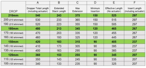

I got in touch with One-Up regarding this item - I wanted a 210 dropper for my large '19 expert but also wanted it slammed.
They were really helpful - sent me the Levo schematic and linked it to their dropper posed insertion lengths and suggested the 180mm vs the 210mm. I got the 180mm and am happy with it. Here's a paste of their email:
Hi there Andrew,
Thank you for your contacting us,
I'm excited for your dropper post upgrade!
Great question -
Our 210mm has a insertion length of 297mm, see measurement F in the chart below:
It looks like the Levo has a maximum insertion length of 255mm, based off of these measurements.
Based on this, you'll be able to fit the 210mm but it looks like you won't be able to have it fully slammed.
Your best bet may be to go with the 180mm post, depending on your current riding height.
This will give you the longest drop and the most amount of insertion into your frame.
Hopefully that helps guide you into the right direction.
