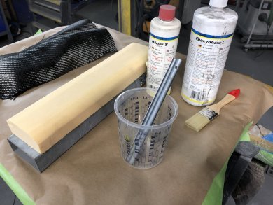

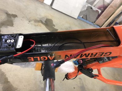

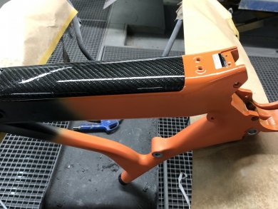

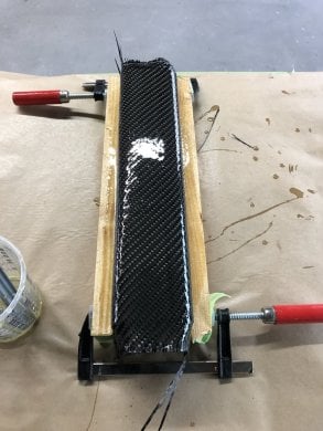

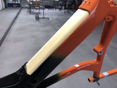

The small 280Wh battery is only to save weight, the frame is usually for the M500 / 600 motor and has space for up to 800 Wh. But you have to make the battery cover yourself :unsure:
