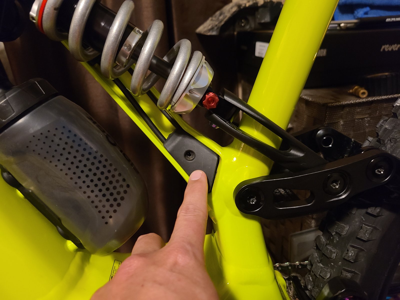

Was doing a deep clean and lost the screw ?
I can't find any info online. Anyone point me in the right direction for a replacement.

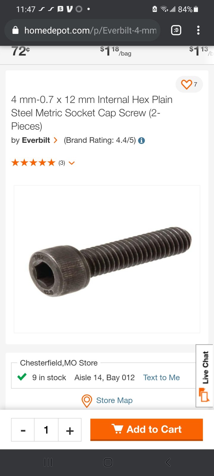

Aluminum flathead machine screw. M4 thread (takes a 3mm hex key), 14mm length, 7.7mm head diameter.
I'd Loctite that. Because it secures plastic, it's a low torque spec.

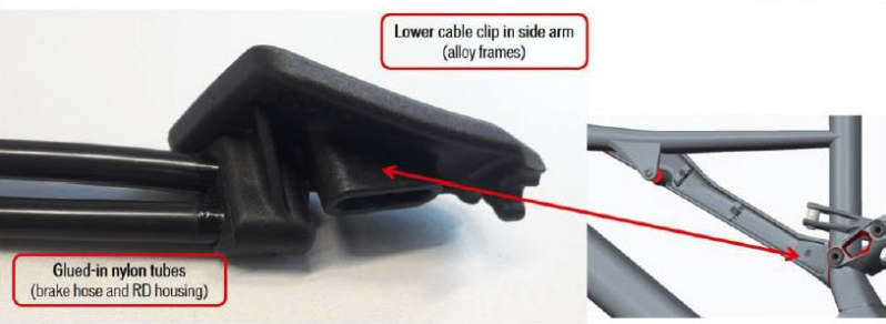

This screw has a wrong head, you may damage the screw seat in this plastic cable holder ... You may leave it without the screw until you find the right one, it will not fall off the bike cause it has nylon tubes which goes into the frame and cables are inside them ...

I could of sworn it was a pretty short screw. Good to know that it won't fallout.

if you want something immediate, this would work better than what you found, albeit uses a Phillips driver instead of an Allen key:
The other ones with a similar head (eg. brake hose securements, "cable bats" behind your shock) on your Levo are pretty short. But this one is longer.
