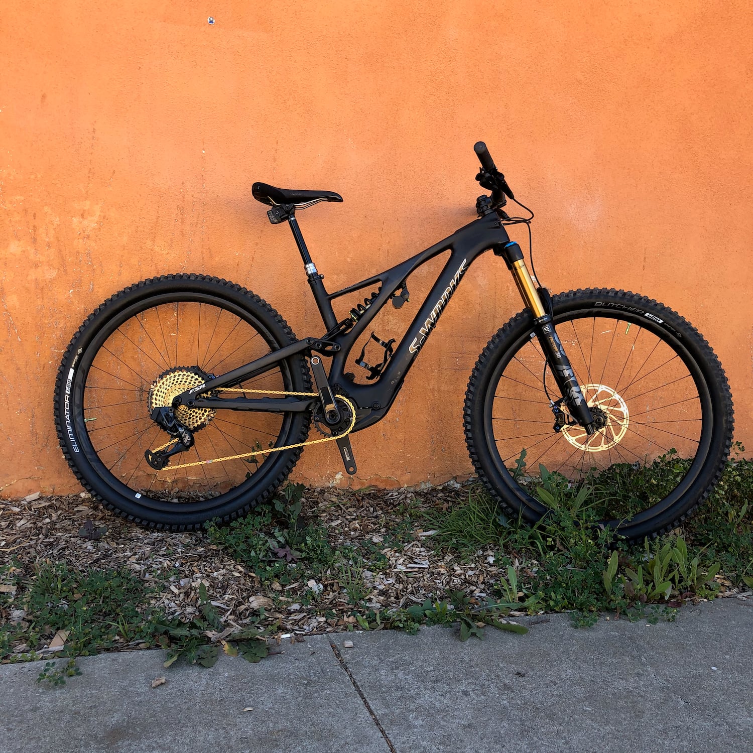

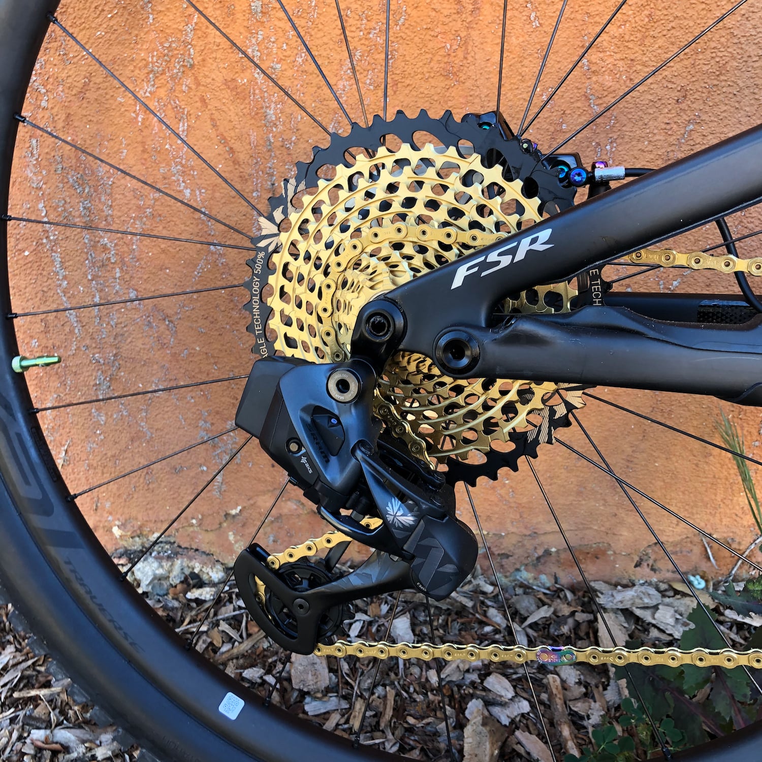

Picked up my SL two days ago in Cupertino, CA, at Trailhead Cyclery. Amazing shop.
I opted for the S-Works SL with these upgrades:
Fox Factory 36 Fork (160mm)
SRAM XX1 AXS wireless RD
SRAM CODE RSC brakes
Reverb AXS wireless dropper post (stock item on the S-Works)
Cush Core front and back
DVO Jade X Coil shock with LS spring (light steel)
WTB Volt Titanium saddle
Specialized Butcher Grid Trail 2.6 (front)
Specialized Black Diamond Eliminator 2.3 (rear)
OneUp flat flat pedals (not pictured below)

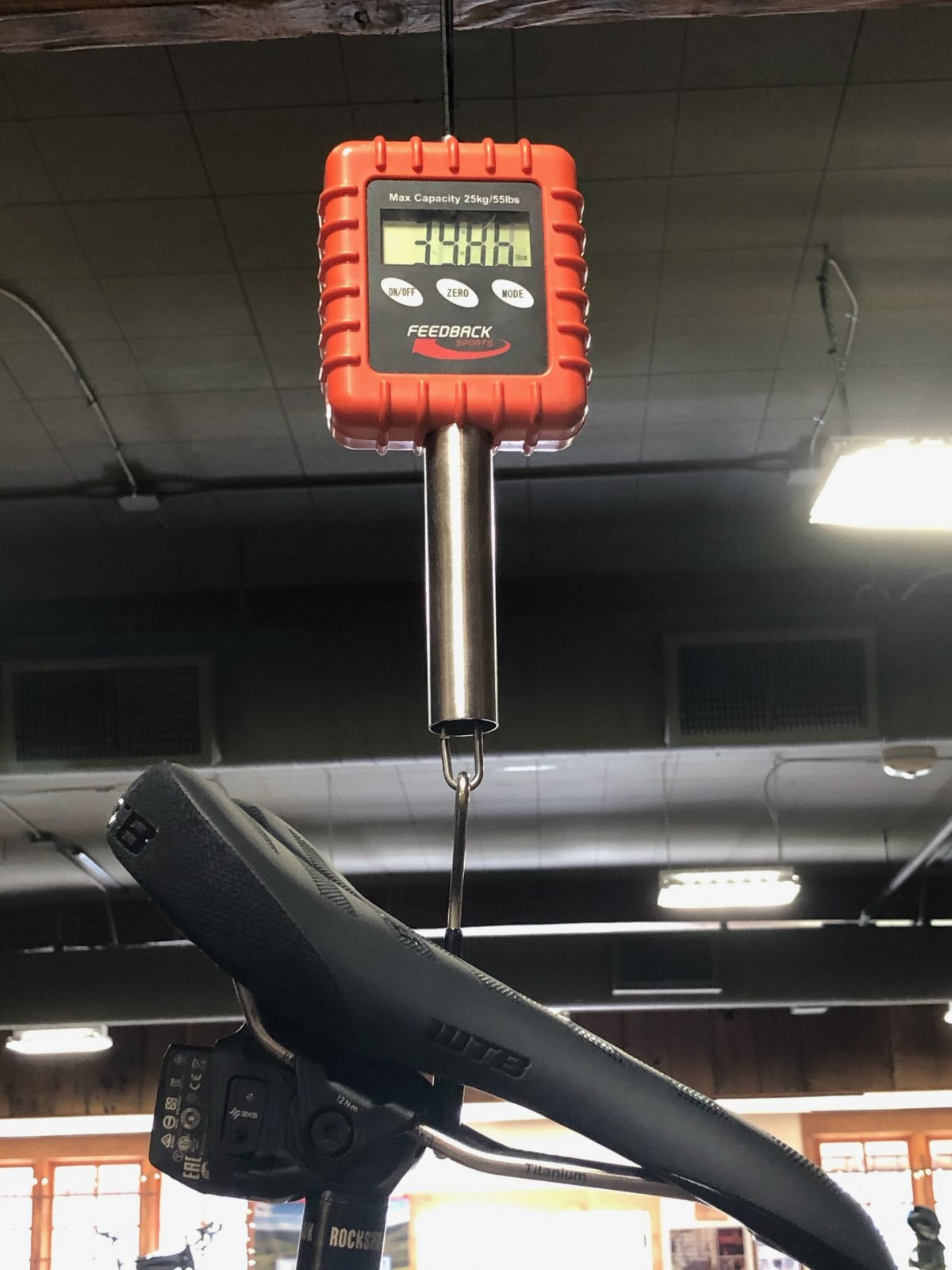

Weight without pedals is 39.86 lbs (18kg). BEAST.
View attachment 27395View attachment 27396View attachment 27397

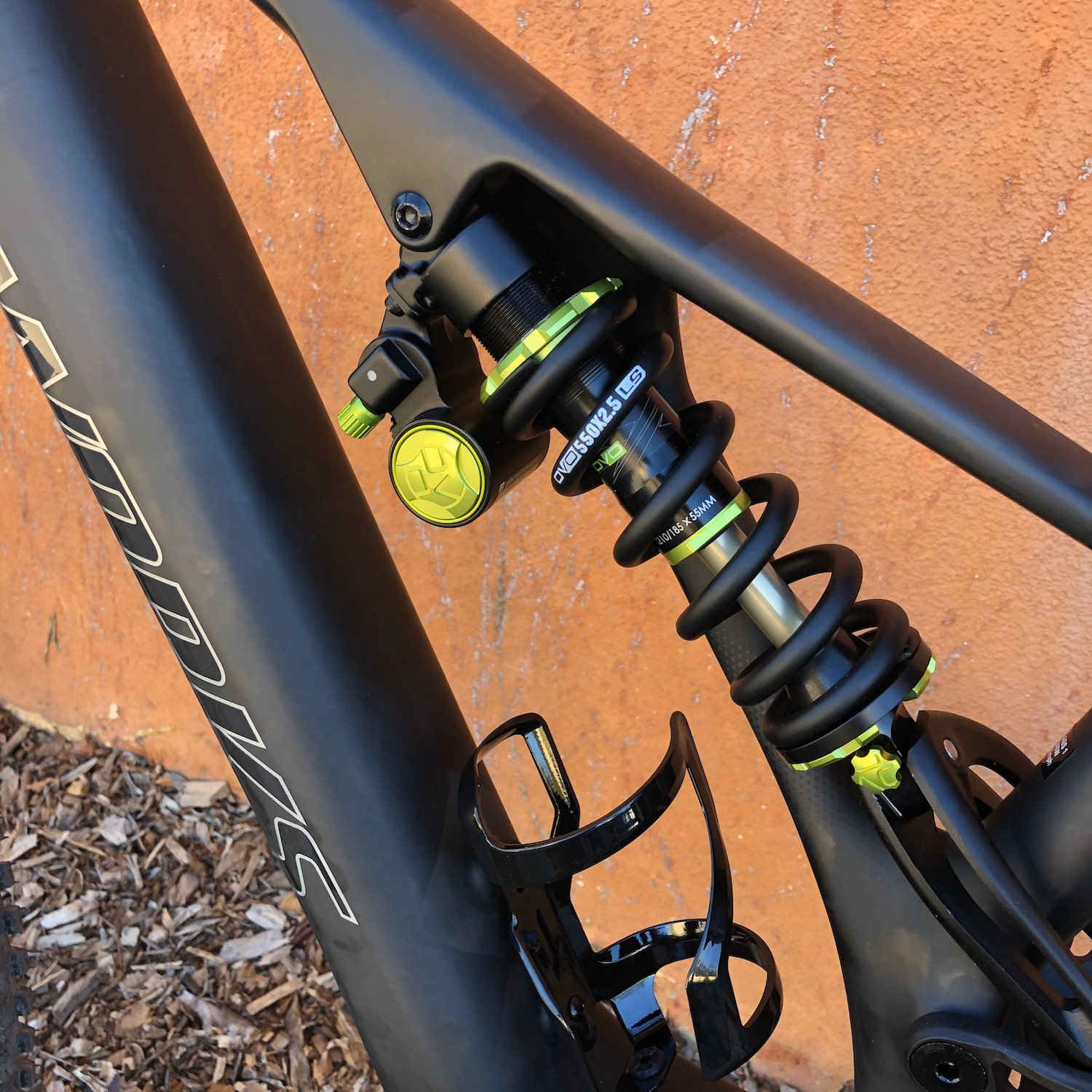

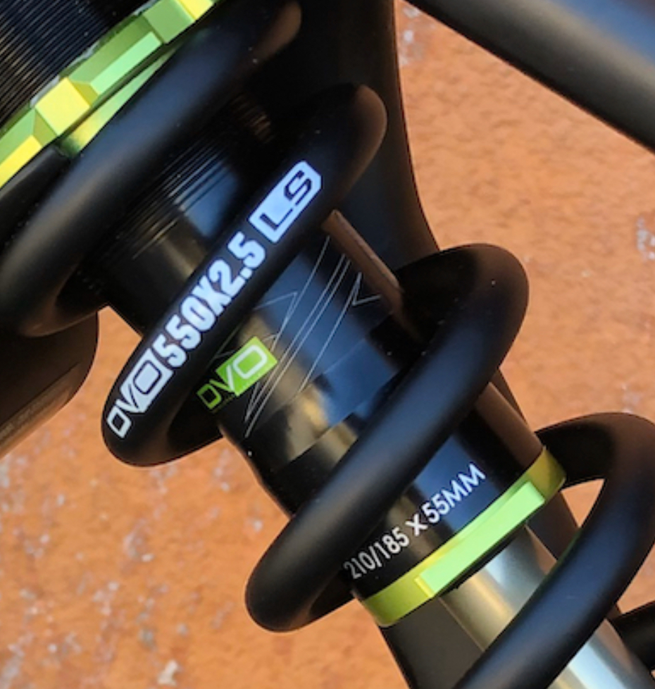

What length shock did you get?
The 52.5 isn’t a normal size. Did you Find a 52.5 or go with a 55 or 50 stroke?
55. see attached.
Hey there! So, given all the crazy COVID stuff which kicked in literally a few days after I got my bike, I've only been able to take it out a few times. I absolutely love the shock though, even though I have not ridden it in any situation where I would potentially bottom out yet. It has incredibly smooth and linear compression -- so it doesn't "bunch up" the way my Fox air shock would as you approach the end of the travel range.
As I recall, the preload on the spring can and should be set at a point that eliminates the risk of bottoming out—the preload is based on rider weight and amount of sag desired. If the preload is too much, it will reduce the amount of travel the spring has throughout the compression range and it will completely compress the spring, causing it to seize, which is not only jarring if it happens, but can also crack a carbon frame which is now forced to absorb the shock.
I am no shock expert, but that's what was explained to me at the shop. As long as the length of the coil exceeds the length of available travel, you can't bottom out. So, you have to make sure your preload is not set at a point where this is a possibility. At least that's how I understood it.
So far I love the shock. I've probably used about 80% of it's travel range and I love it. I actually forget the bike even has a shock -- in a good way -- its so smooth and linear that I forget it's there. And for 25% off, that's a screaming deal.
I think that's a bit extreme,you will have a bottom out bumper on the shock so you wont transfer any massive shock into the frame! Just go by 'no more than 3 turns of preload' and you should be alright any more and you need a different spring. Thats why I prefer Air sprung weight varies too much, summer packless ride spring 1, midwinter full on day out need spring 2, too much pfaff for me.
Good point about the bumper. I've only used the bike for about 50 miles so far, so still getting used to how it rides, but overall I've been impressed with the shock's ride quality.
