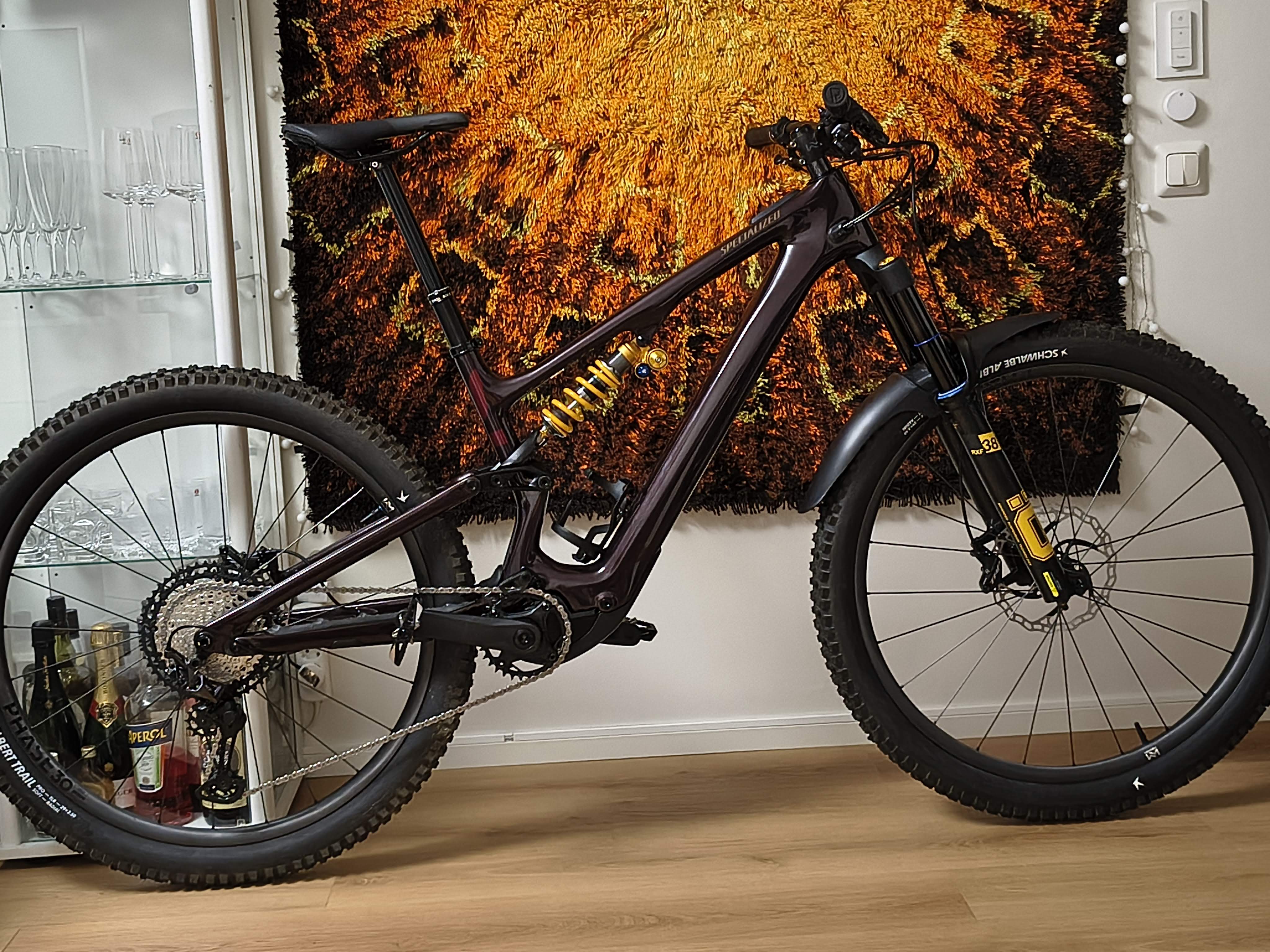

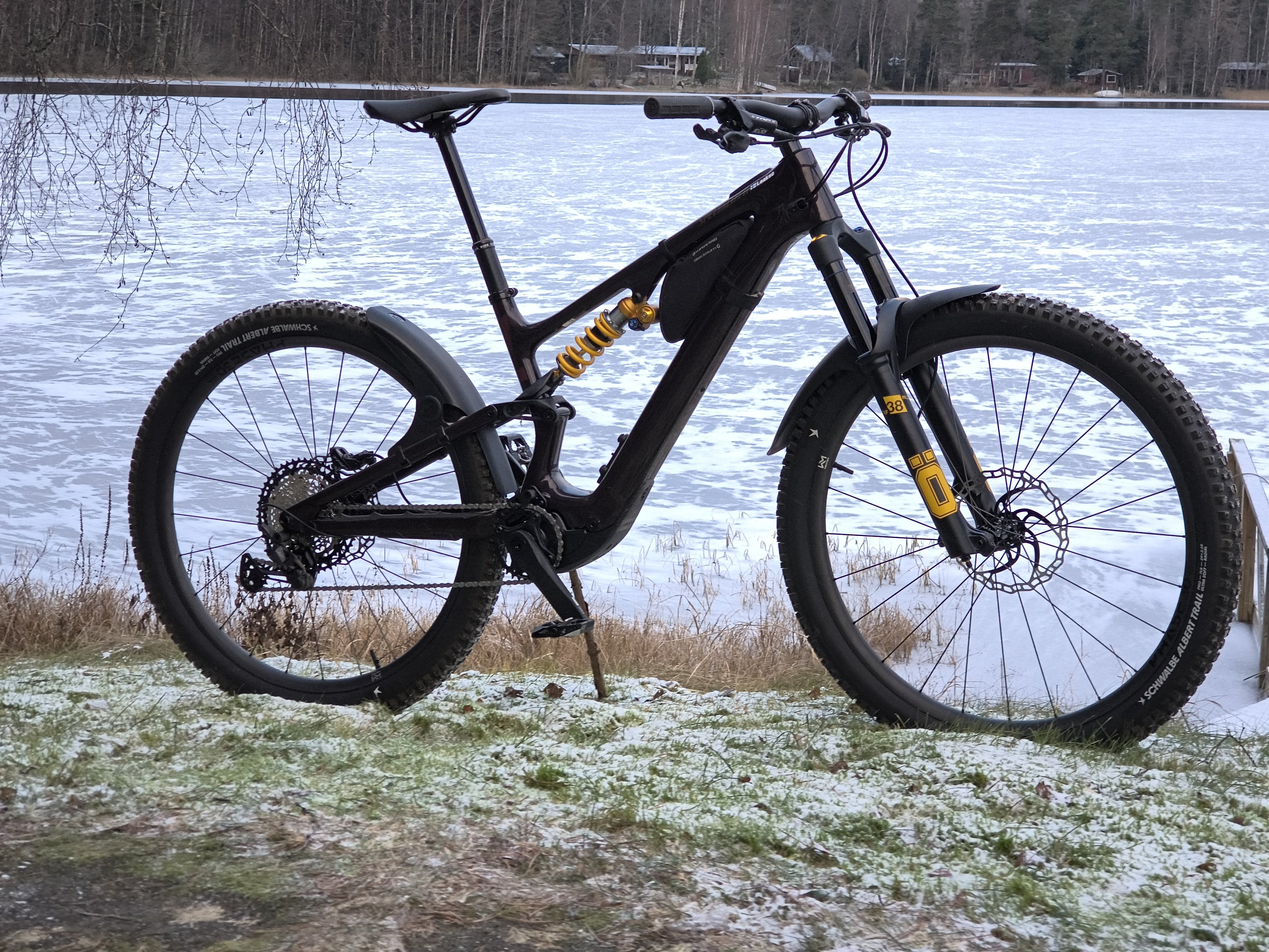

Well, here it is. Replaced parts, took a while since the rear shift housing rounting was a bitch. Had to drop the motor and fiddle with the top tube cable ports. Wasn't that hard but took time.
Happy with the result, weight came in at 18,8kg with pedals (cb mallet e). Not bad considering the burly suspension setup. Just need to reconfigure the wheel diameter at my LBS.
New parts:
Newmen Advanced Carbon bar
Newmen Evolution SL.4 stem
Newmen Phase Vonoa Trail Carbon 29" wheelset
Schwalbe Albert Trail 29x2,5" Ultasoft+Soft
Galfer 203mm Brake discs + pads
XT M8100 drivetrain
Mudhugger Evo Bolt on fender
After first ride, it's pretty dialed. Absolute ground hugging feel with the coil (my first experience on coil shock). Really happy with the build. The winter has become here so the trails are pretty slippy without spikes tyres. Still, it's was nice.
