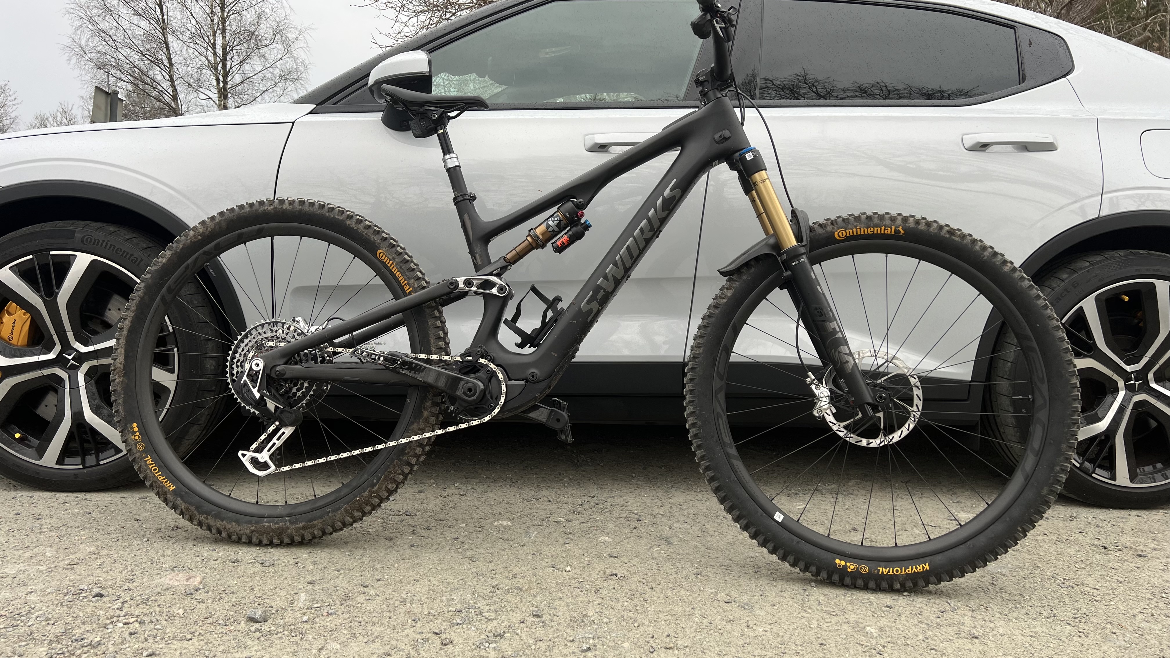

.. I have it setup to 29er but using a mullet wheel, and I have the HA in "slack" but the BB position set to "high" to compensate for the 27.5+long chainstay lowering the BB. It rides like a dream! ..
Does anybody know how much the BB will be lowered by flipping to 29 while runnig Mullet?
I'm running HA in neutral and BB in low, ca 5mm lower BB would still be OK for me
hehe, I know. But considering my craftsman talent i maybe end up with a broken flip chip and still having 27'5 😅 maybe i am lucky and someboday measured already the BB.
I haven't measured, just went with the recommendations (and now running Cascade so must keep it in high anyways)
