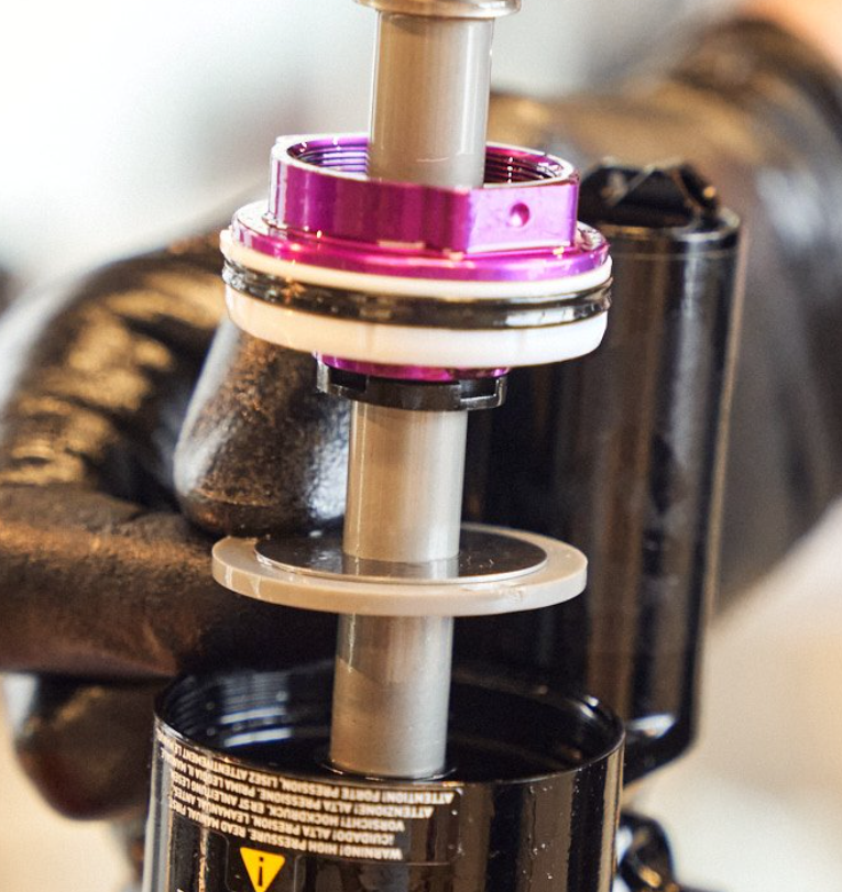

Sharing in case it's of any use to anyone else. The Fox Float X that came with the bike failed after a few hundred miles, leaking air and oil. After a number of failed Fox components over the past year I decided to try another air shock.
RS Super Deluxe was the obvious choice, I reached out to Specialized to find out about the recommended tune for the Levo SL, they were pretty unhelpful saying that their ride dynamics team had never tested this shock so specific state of tune could not be shared.
I reached out to SRAM who were far more helpful, you can buy the shock with a specific tune for the frame (00.4118.358.065) but they said that a few folks were using the stock LNL tune on their Levos at their Colorado HQ with excellent results.
I decided to try the stock tune (00.4118.358.004) and I have to say that it's been amazing. It feels more supportive, plush and controlled that the Float X, it now makes me wonder about the value of RX tune program!
I've got a Super Deluxe Ultimate on mine, with a custom tune from J-Tech... and the difference between that and the Float X is night and day. The SDU was on my LSL 1.1 for about 3 years, and I had it re-tuned for the LSL 1.2. I also have a MegNeg on it.
The MY23 RS SD (C1) is not compatible with the NegNeg, it now only uses either a progressive or linear air can. The Levo/Levo SL works best with a linear air can on this shock.
A little tip, metric shocks share the same parts between shocks with the same eye to eye but different stroke lengths. The 210x55 shock on the Levo is a popular size so it is typically priced higher than the less popular 210x50. I bought a 210x50 shock and removed the travel spacer for a pretty substantial cost saving!
One word of warning, don't attempt to do this on the version with hydraulic bottom out (HBO) as you will destroy the shock! :oops:

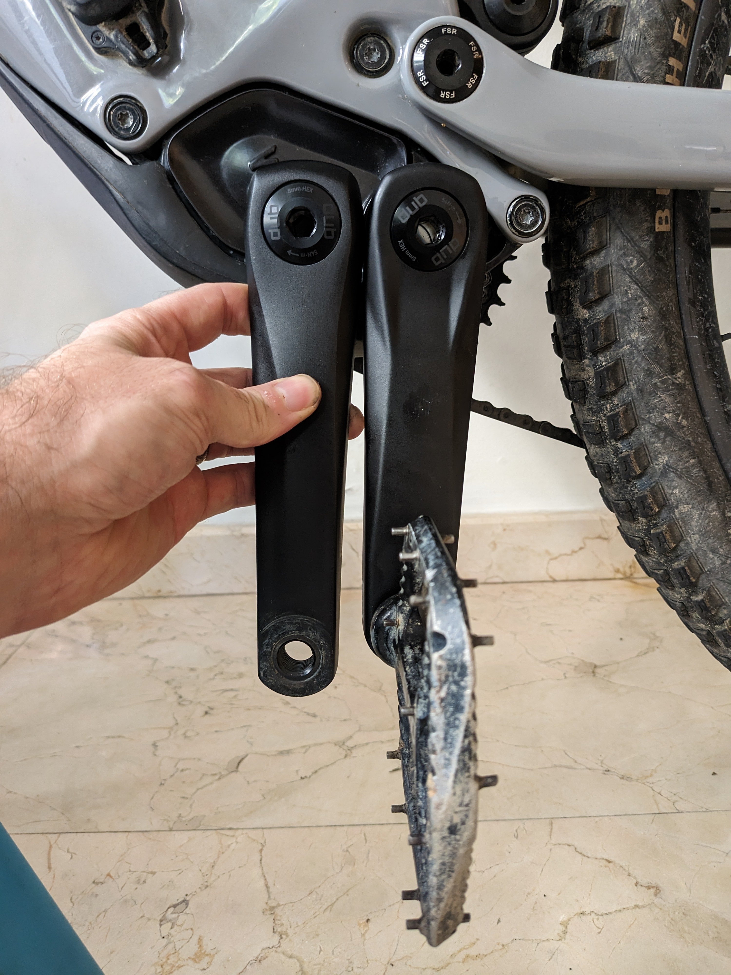

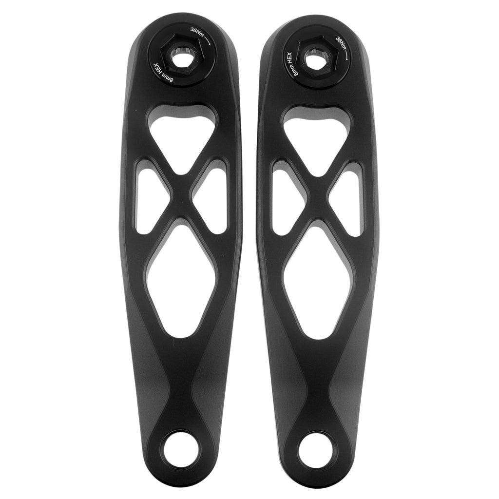

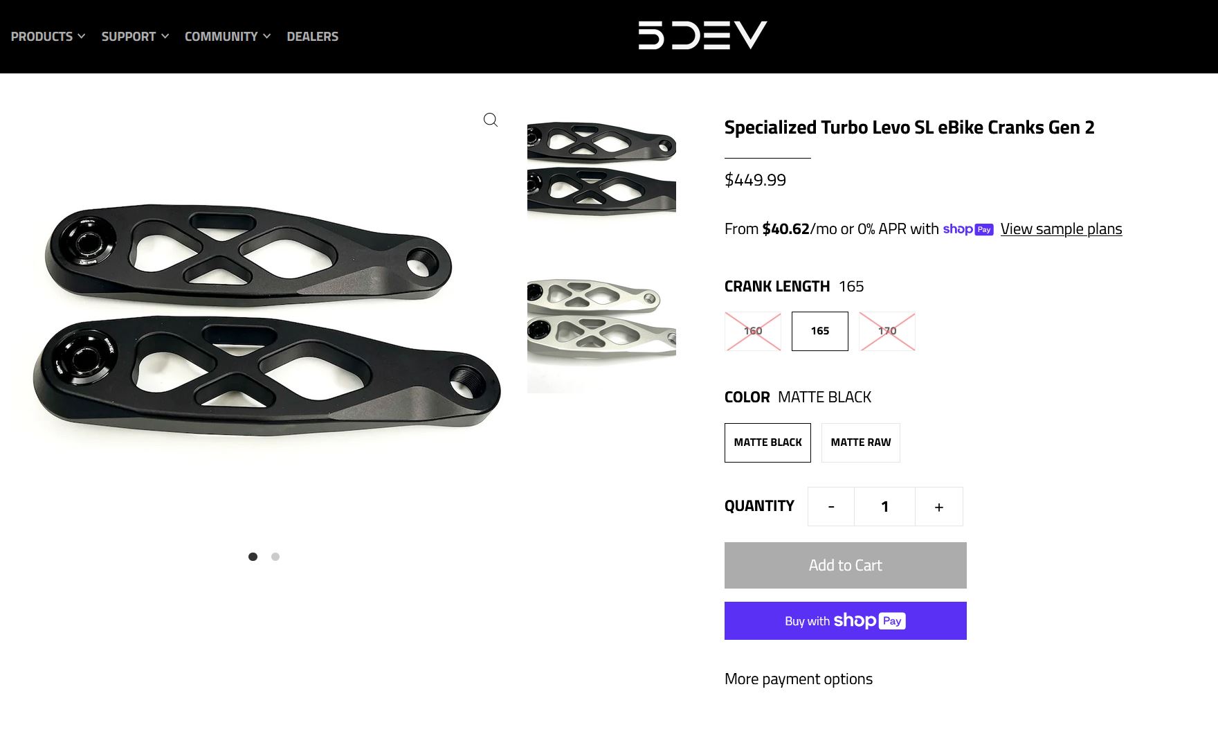

Has anyone upgraded cranks yet ?
Looks like they are standard dub cranks but without the spindle. Is it just as simple as that ? Would 5dev dub cranks work? How about xx cranks meant for acoustic bikes ?
Looks like they make them now.
I am looking to upgrade my 23' Specialized Levo SL 1.2 crankset to the Sram DUB Carbon crankarms, as are offered stock on the Sworks bike. Anyone have access to the part/ part number? I wonder of these are the same crank arms as the analog bike , minus the spindle, or if the e-bike version has a different q factor? Any info or correct part/where to buy would be appreciated!
