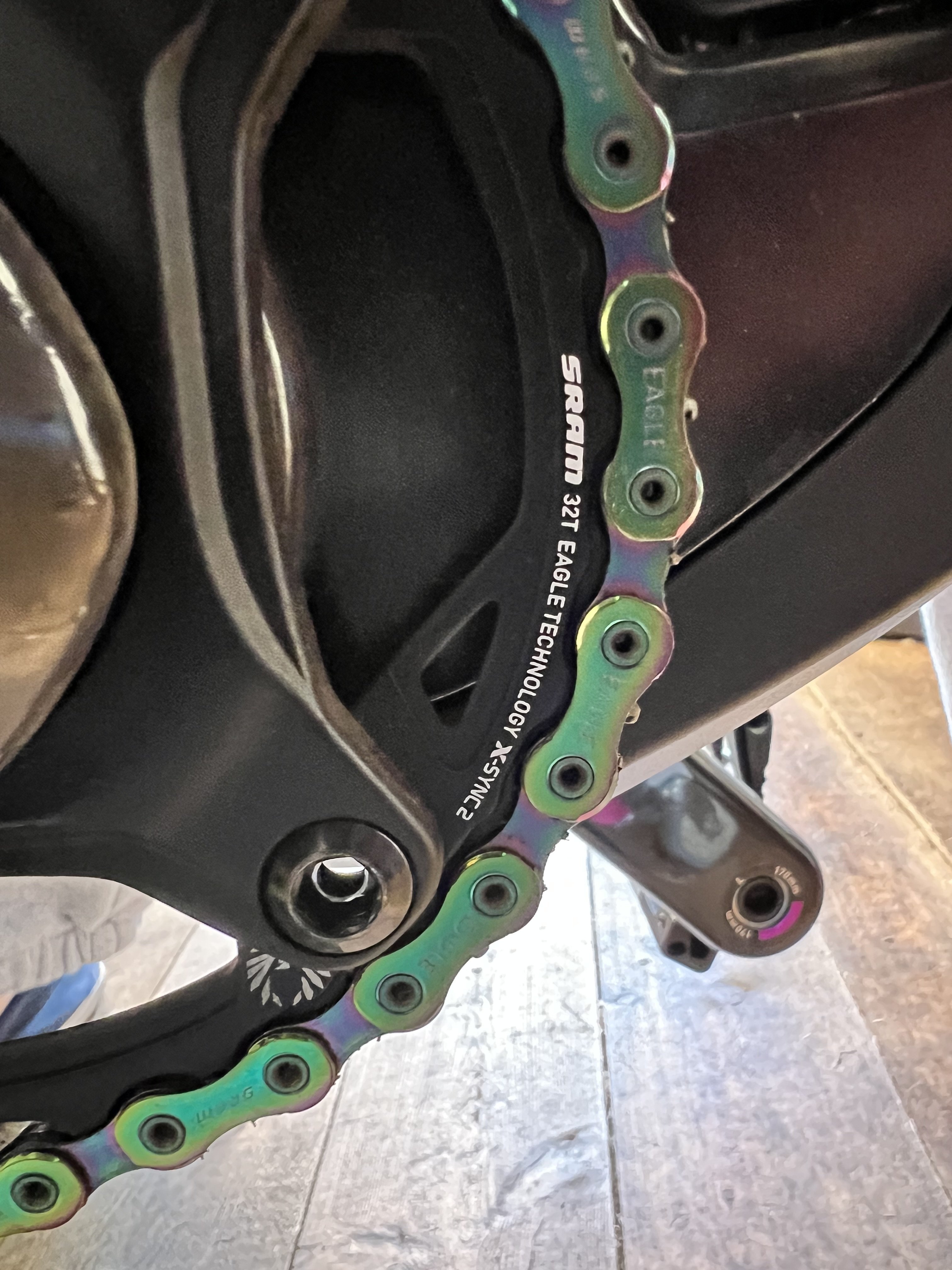

Has everyone had their bike supplied with a SRAM x-sync 2 eagle chainring? Asking as this chainring is not supposed to be compatible with Transmission according to SRAM.
  1. Eagle Transmission T-Type chainrings are compatible with Eagle chains, so they can be used on Eagle Drivetrains when mounted to an Eagle Transmission crankset. However, Non-T-Type Eagle Drivetrain chainrings are incompatible with Eagle Transmission T-Type chains.
Specialized now have the correct chainring listed on their website but they don't seem to be available anywhere...
ChainringS231400001CHR TURBO, 32T, T-TYPE 12-SPD, 4-BOLT, 104BCD, 1X RING, ALLOY, SRAM (00.6218.040.010)

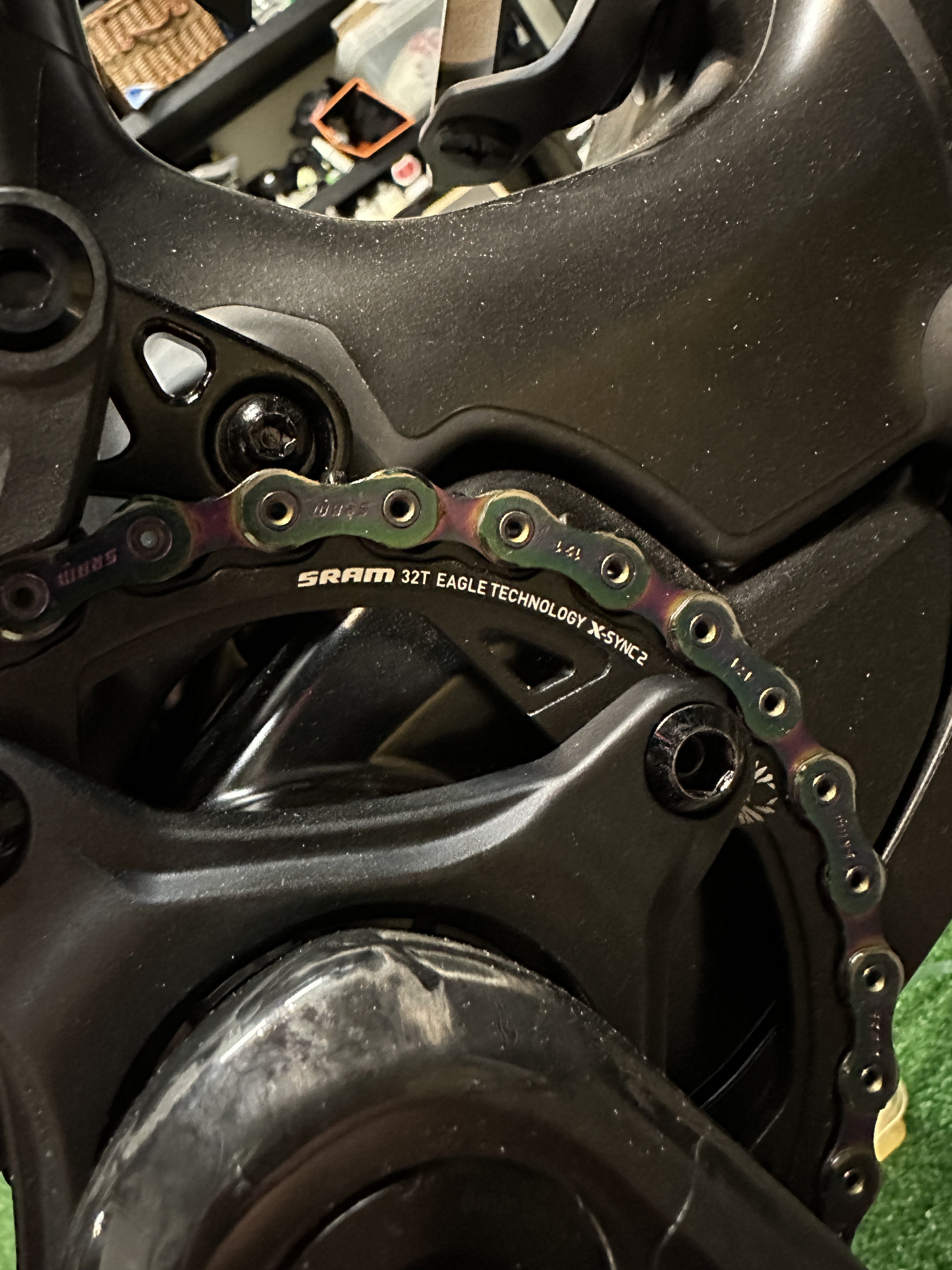

That’s interesting, yeah mine has X-SYNC 2.
Looks like this doesn’t officially support the T Type Chains….. You’re running a T Type Transmission aren’t you, any obvious issues?
So this chainring is not supposed to be transmission compatible. I suspect the issue here is that the bikes were build before transmission was available. Specialized are looking into it for me and I have asked SRAM to comment on the compatibly of the X-Sync 2 chainring.
Looks like I might have to buy a BBT-79 after all to get this thing off!!
I haven’t tried but I reckon you’ll be able to remove the chainring with the spider in place, I’d try that before trying to remove the spider lock ring… it had red thread lock on it so I don’t think it will undo easily!
I'm building up the frame this weekend, Transmission is being moved from another bike. I knew about the chainring when I received the frame so tried to source a t-type version (Eagle Transmission E-MTB Chainring 104 BCD - CR-TTYP-104-A1 - SRAM) which turned out not to be compatible with the spider. So it looks like SRAM now make a compatible t-type ring but it's not available anywhere.
I suspect that the full S-Works build will also have an X-Sync 2 chainrings.

X-SYNC 2. I would imagine t-type chainring will only come on the bikes being built from now on...

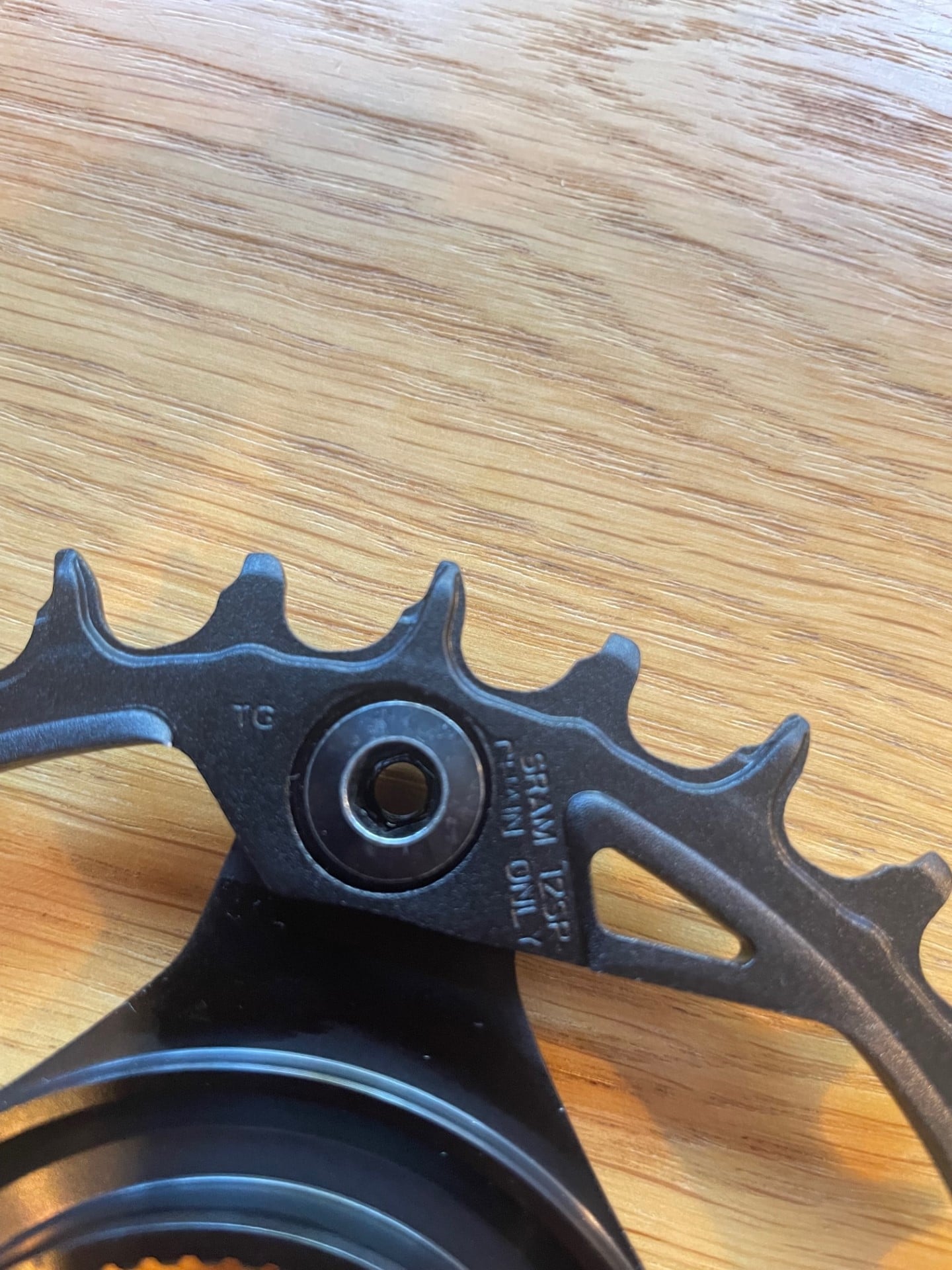

You can ignore everything I said, SRAM responded with the following:
I apologize for the confusion and will try to help clarify! There were some compatible chainrings that were released ahead of Eagle Transmission that were marked "X-Sync 2" on the front but are compatible with T-Type chains. These compatible rings will be stamped "TG" on the back, near one of the bolt holes
Specialized didn't seem to know anything about this! :rolleyes:
Well done with the digging and getting an answer!
Odd that the teeth pattern isn’t the same as the t-type one you posted… but SRAM will know best.
I’ll make sure I have a TG stamped on mine.

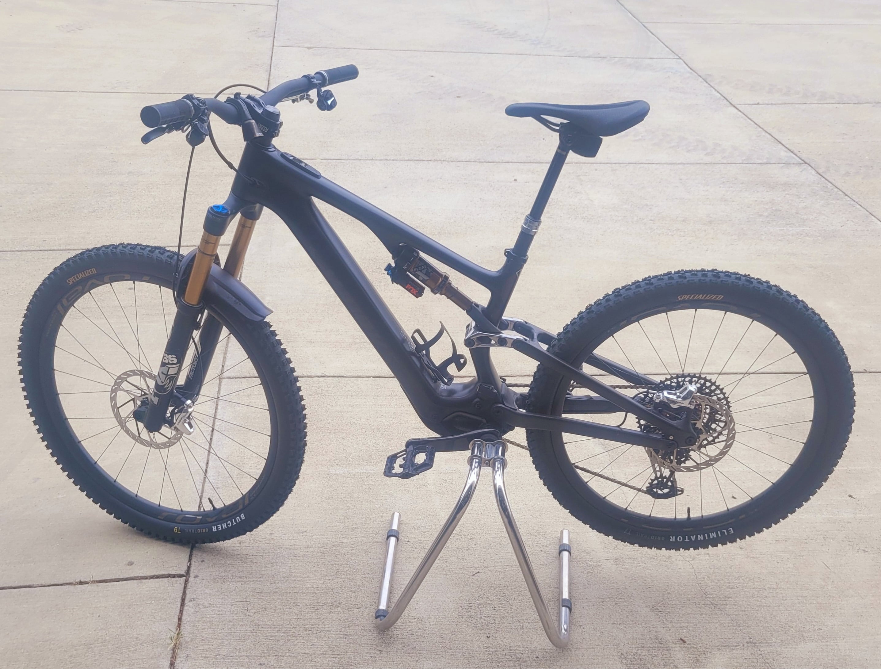

What stand is this? I’d like something similar.
Pulled the trigger on the Sworks. Great bike, very lively on the downhill. Quiet, not 100% Quiet. But way better than the Gen1. 1st time on a mullet. Switch backs are a breeze. Rolling small bumps at speed makes you wanna do a manual.

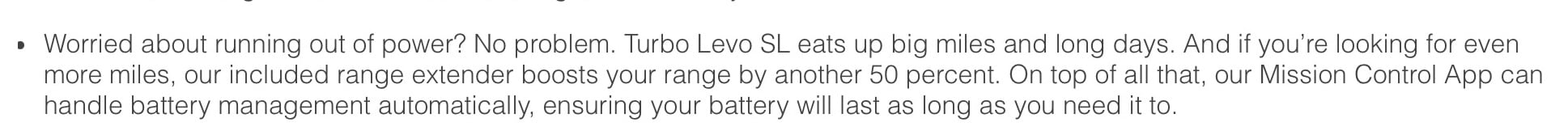

Picked up my SL today and the s-works didn’t have a range extender included even though the specialized website says “our included range extender” for the sworks
Picked up my SL today and the s-works didn’t have a range extender included even though the specialized website says “our included range extender” for the sworksView attachment 115959
The S-Works only definitely comes with the range extender, new shorter cable, and Y-split charging cable. I now have 2 range extenders!
It comes with a y-split cable too? I had to buy one with the extender battery I bought. Was hoping to have 2 extra batteries. I’m definitely calling specialized to sort this out. The bike shop didn’t know much about it. I ordered online from specialized and the shop built it up
Nice bike 👍🏻
As P3eps said, the S-Works should come with the RE, RE cable and Y cable. Mine did as well.
Maybe the shop forgot to include them, I think it’s unlikely Specialized would have shipped your bike without them.
