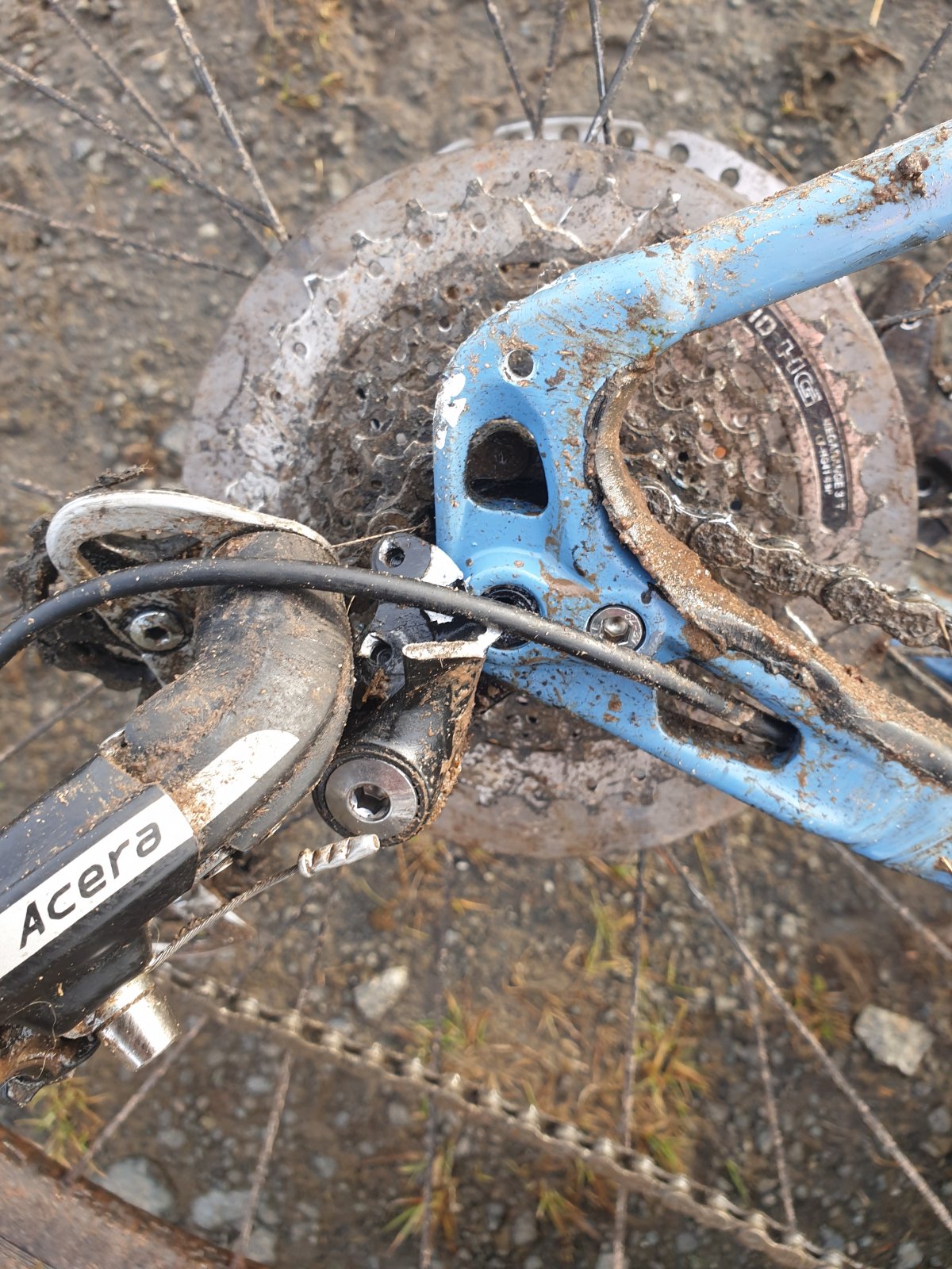

What the was out on a fairly boggy section today and rear derailleur snapped off my 2019 specalised turbo levo ht ,what do I do how do I upgrade very peeved

I up graded my wife's Levo Hard tail. I changed the forks to Rock shoxs as they where off my bike. Worked a treat even though her wheel size is 29 and my is 27.5 plus.
Changed the brakes to Zee levers (there where going cheap) and XT callipers ( freebie from a friend). Purchased SLX shifters and Deore rear mech cheap.

What rear derailleur hanger did you use please looking to do the same upgrade ?? I’ve already changed the rear break system to a 4 pot caliper which has made big improvement. Also have the 203mm disc to go on but have purchased wrong bracket to fit.
