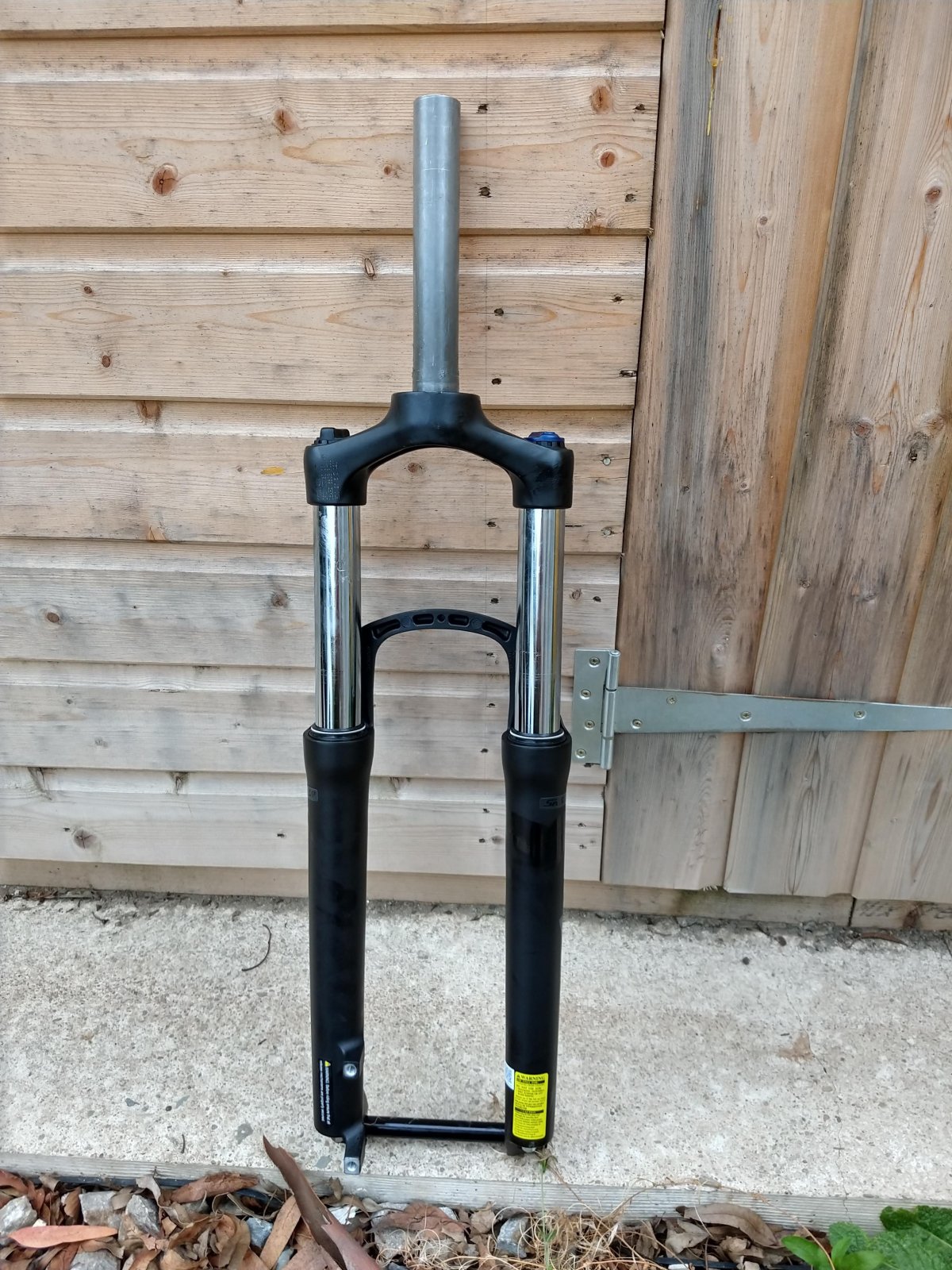

We bought one yesterday and measuring the fork its at 150mm
Im pretty certain that it should be 120mm for medium but wondered what others have
That is indeed interesting, what fork is on the bike? The entry level should be a Suntour and the Comp is listed with a Reba.
Karsten
Its a suntor and its stretching the imagination to call it a fork

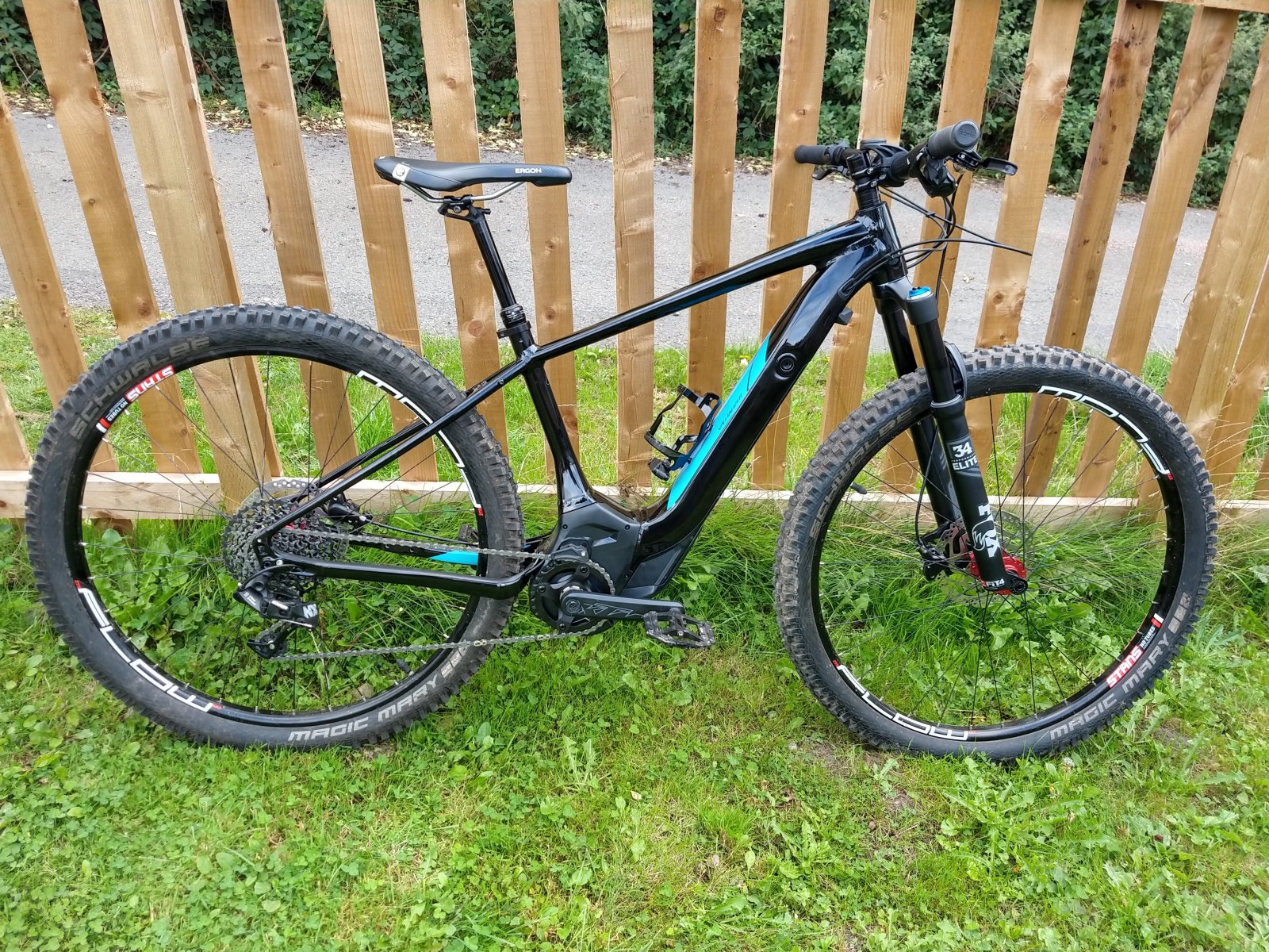

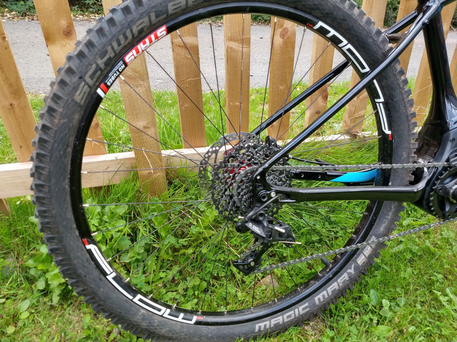

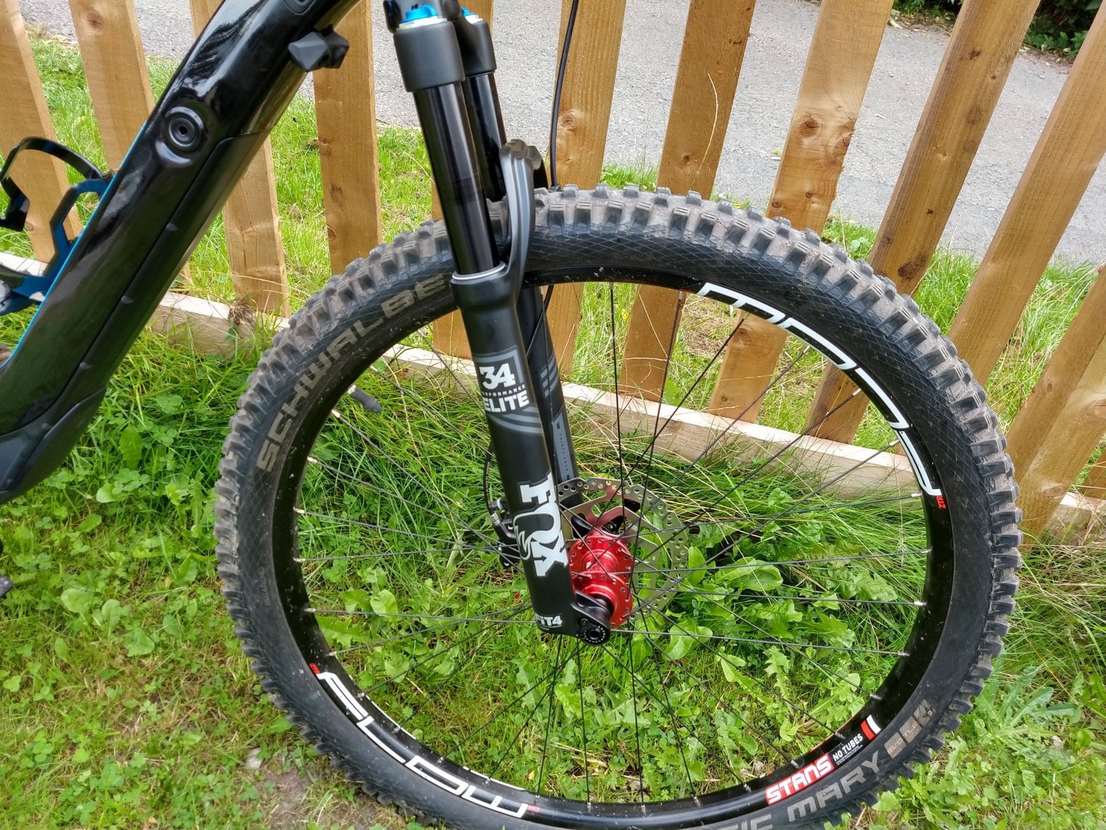

My wifes 2019 levo hardtail after we fettled it
Specialized this is an insult to mountain bikers
Those are some big changes you made. Did you do this all after you bought it a couple of days ago? Wasn't it a better option to buy the comp instead?
Bought it yesterday apart from the fork we had all the bits and we got it for a very good price.
To be honest we bought with the attitude we were just buying frame, motor and battery and for what we paid it was a fair price.
To be honest as it came apart from the very horrid fork it was perfectly usable
Now it abso,utly brilliant and as for the comp which is what a grand more? its still crappy spec for that price
