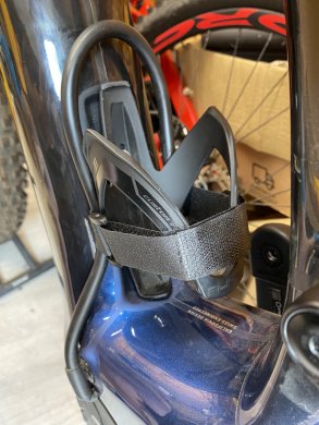

Do you have a picture of what the harness port looks like when you want to go for a ride without the extender?
Many thanks. No plans at this time for a removable extender cable?
Due to the space within the bike, I could make the link cable removable but you will need to remove the factory battery to access the connector.
