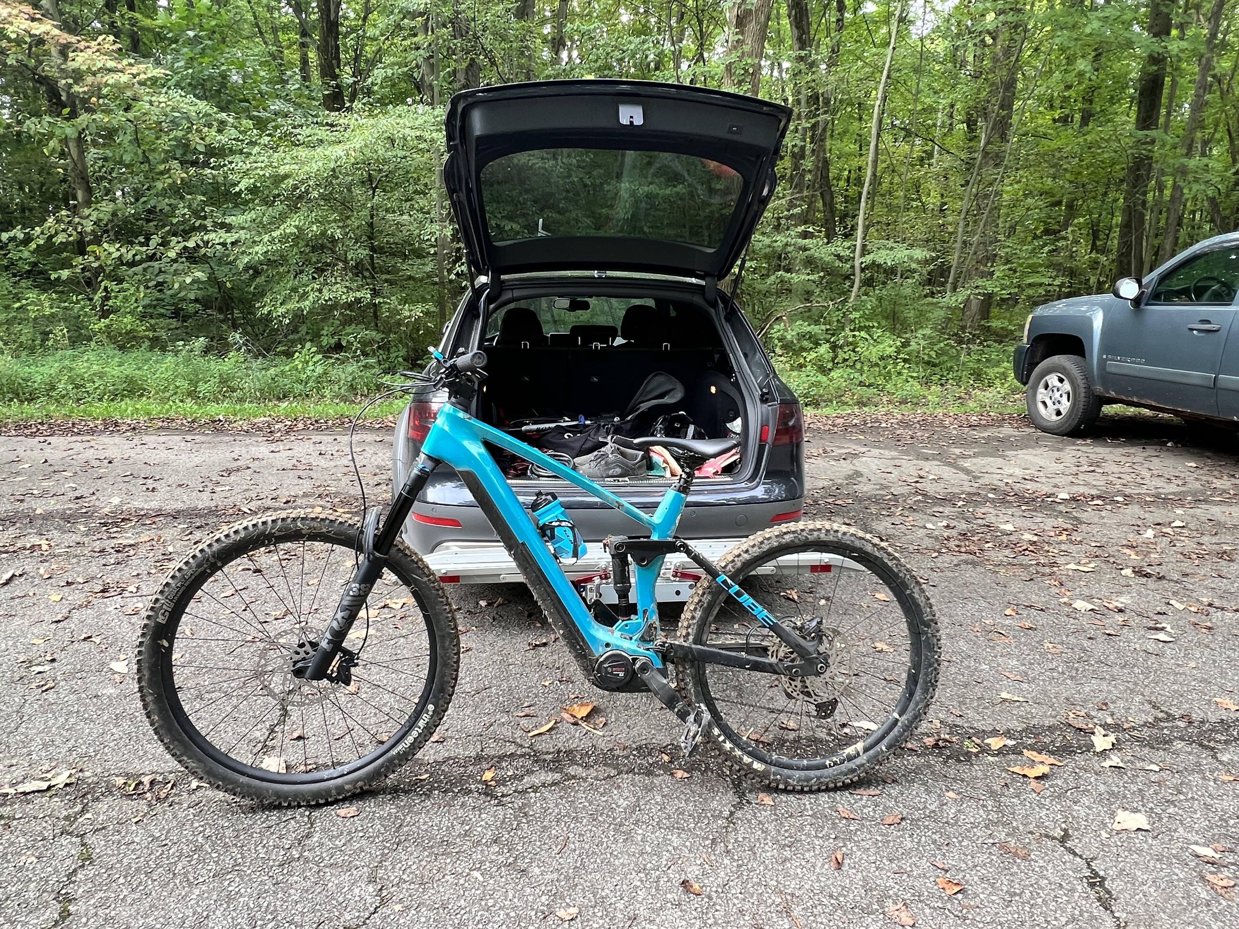

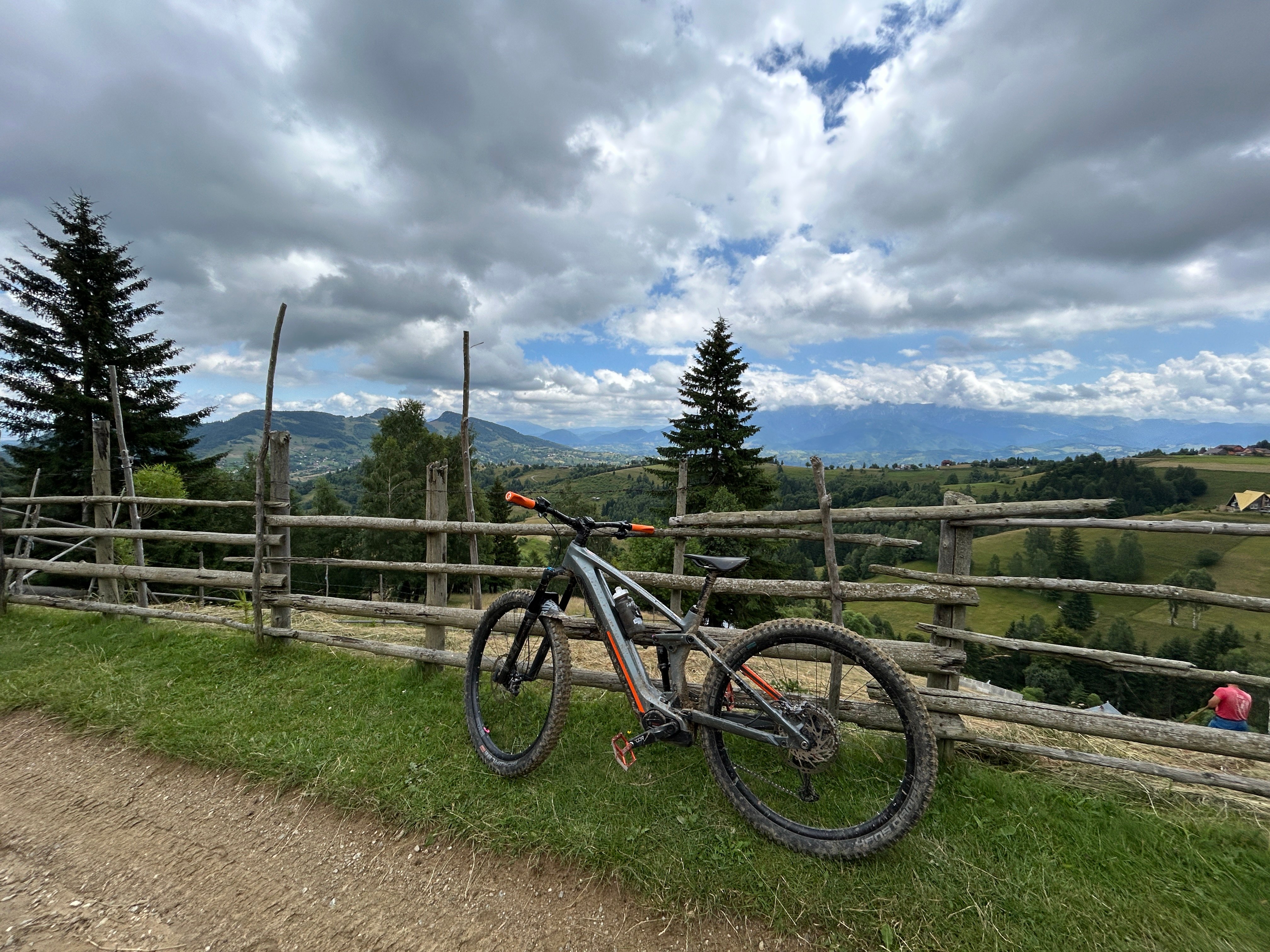

Uplift, I thought about doing a full climb but I wanted to get the most runs out of the day as I won't be back for a while.
Not been on my Cube, but ha e visited a few times in the past and love it. Wish it was bit closer to home.
Rim Dinger and Poppity Ping were my favourite trails.

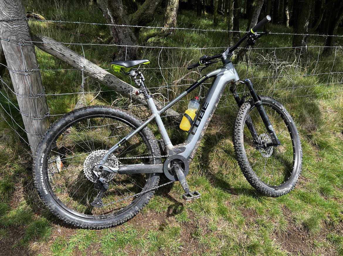

I've got the Race version of the 160, so it will be bottom of the range wheelset.
I had lots of problems to get them set-up as tubeless (I've been running tubeless for years on other bikes).
The bearings never really felt smooth and are rapidly heading towards 'rough' and the rear (Newman) thru axle has a tendency to work loose every ride - this has now been addressed with a small amount of thread lock which is keeping it much snugger, but still easily removable.
That’s annoying and surprising, in equal measure ! I have the low end Newmans on my ‘22 SL and they are great. Tubeless since new, never lost any air, roll forever and generally working exactly as they should.

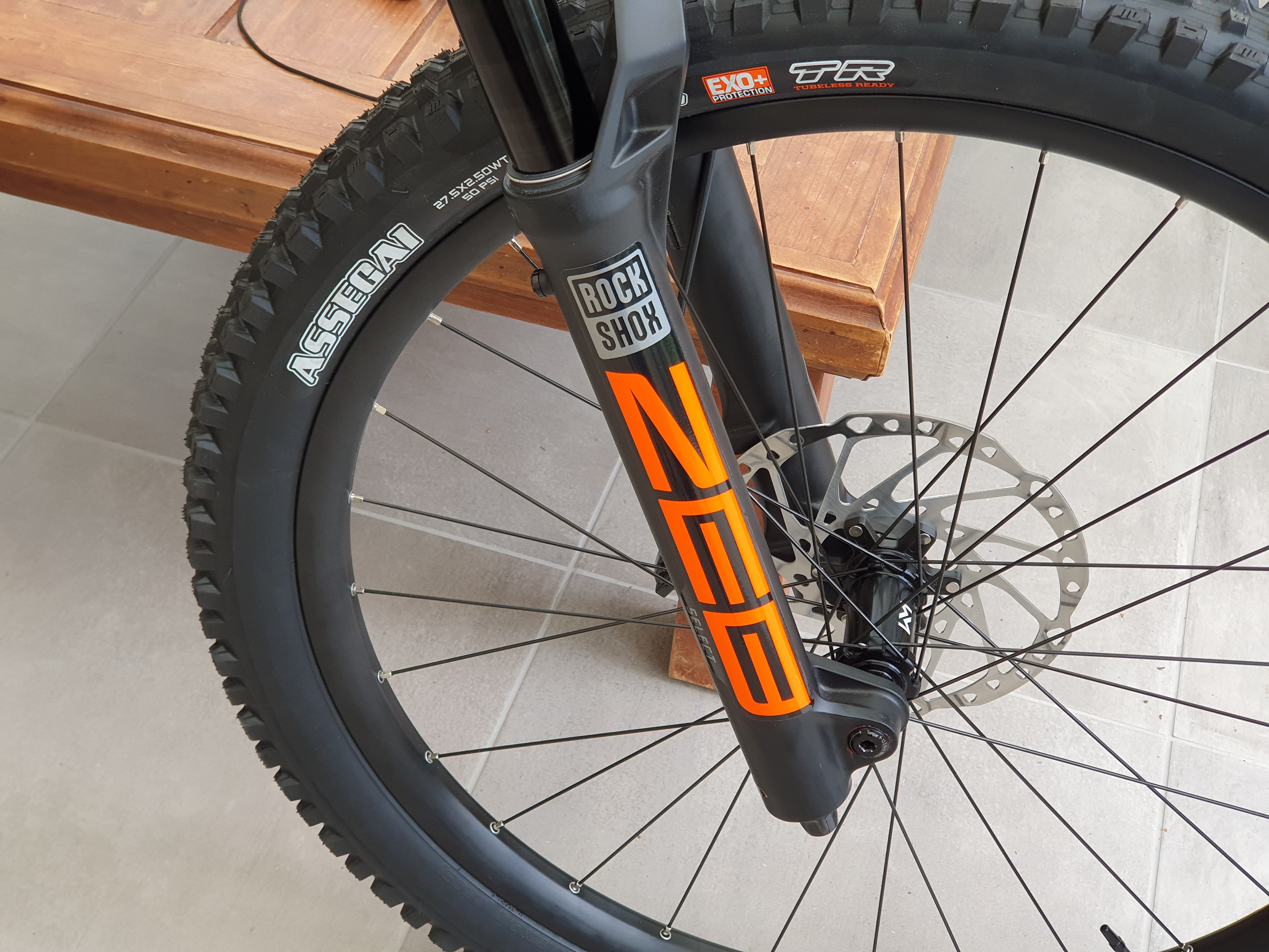

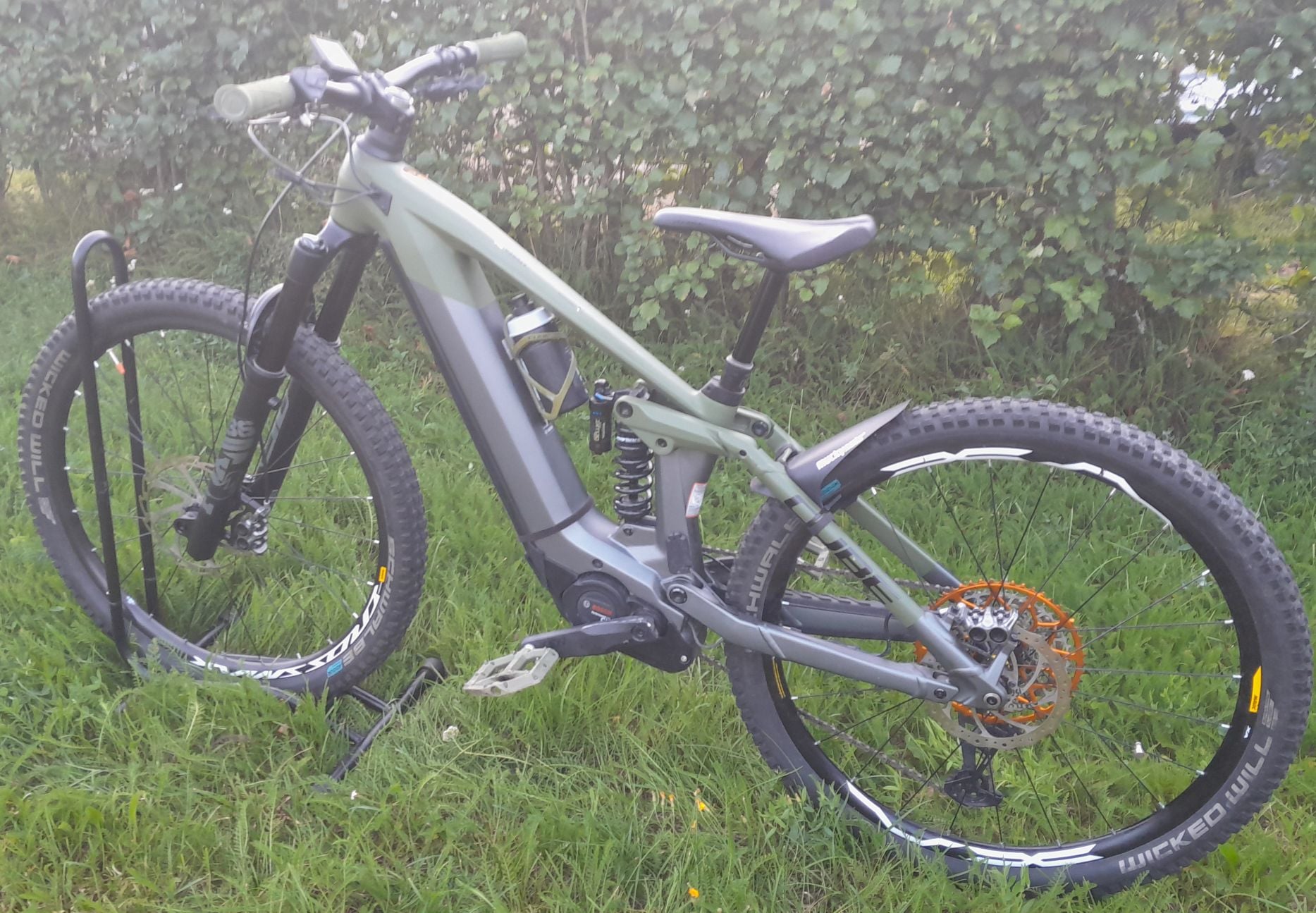

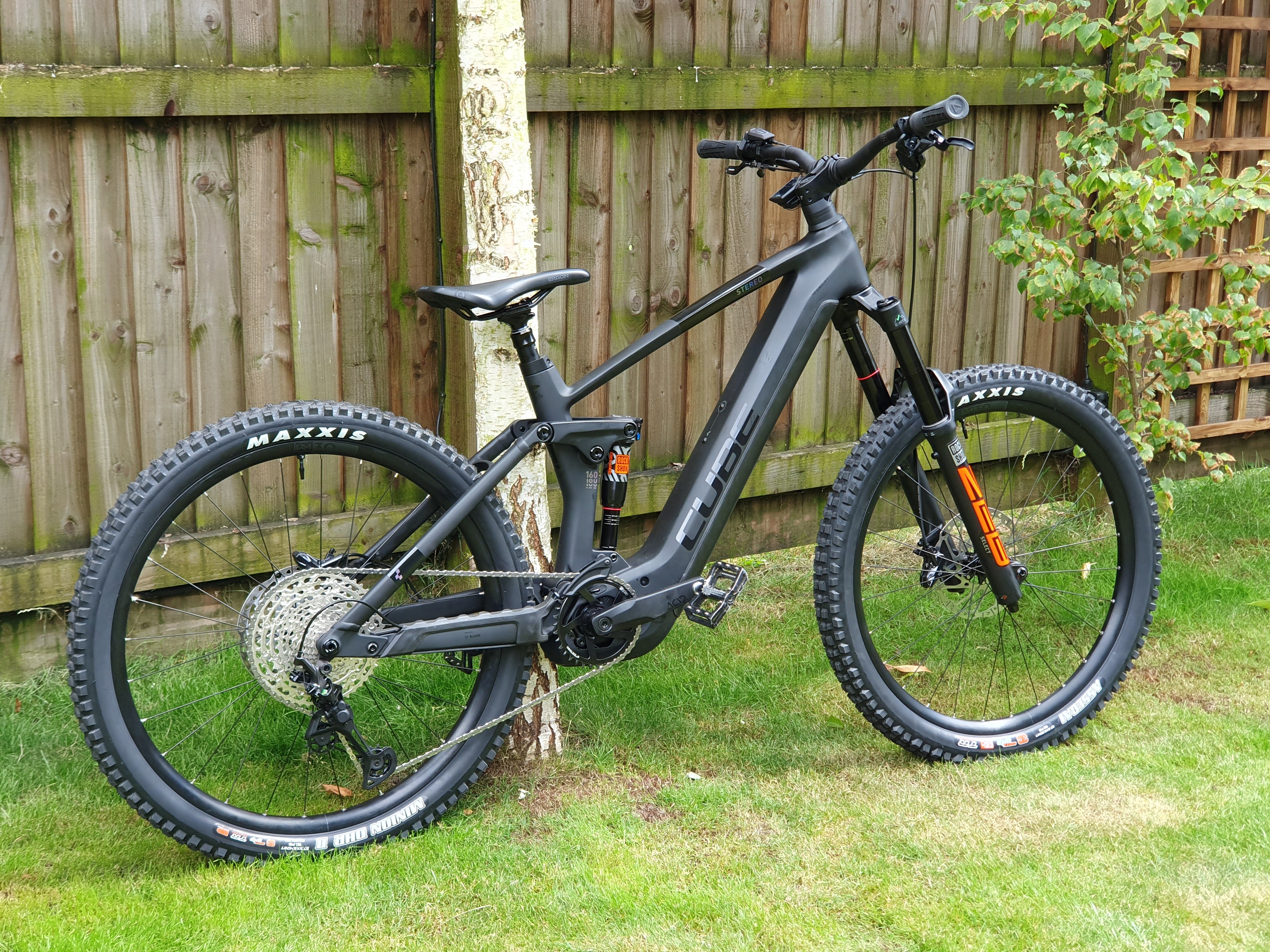

Just fitted some fork and rear shock graphics from Slik Graphics. The photos don't do them justice as the orange is pretty much neon in person.

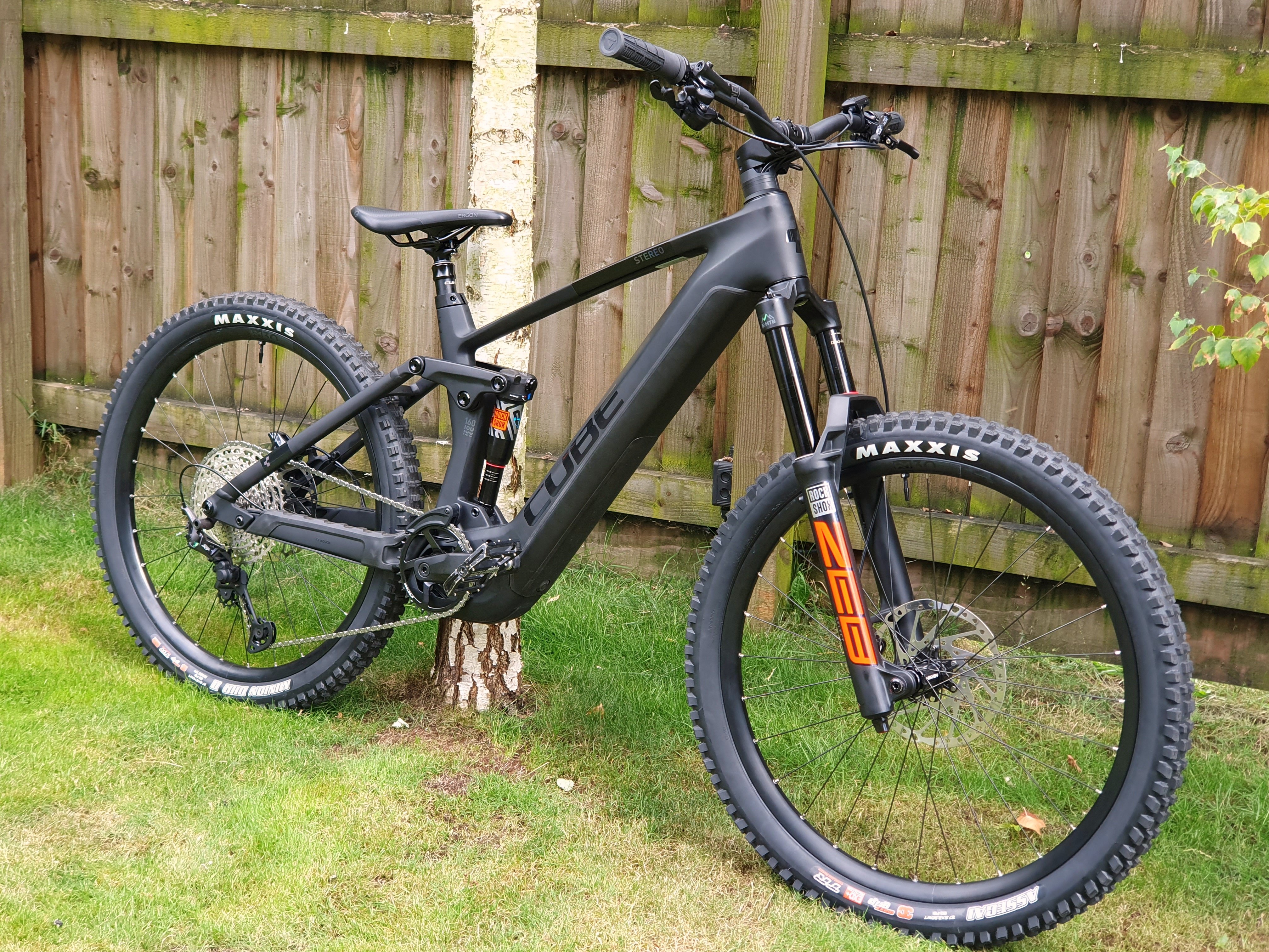

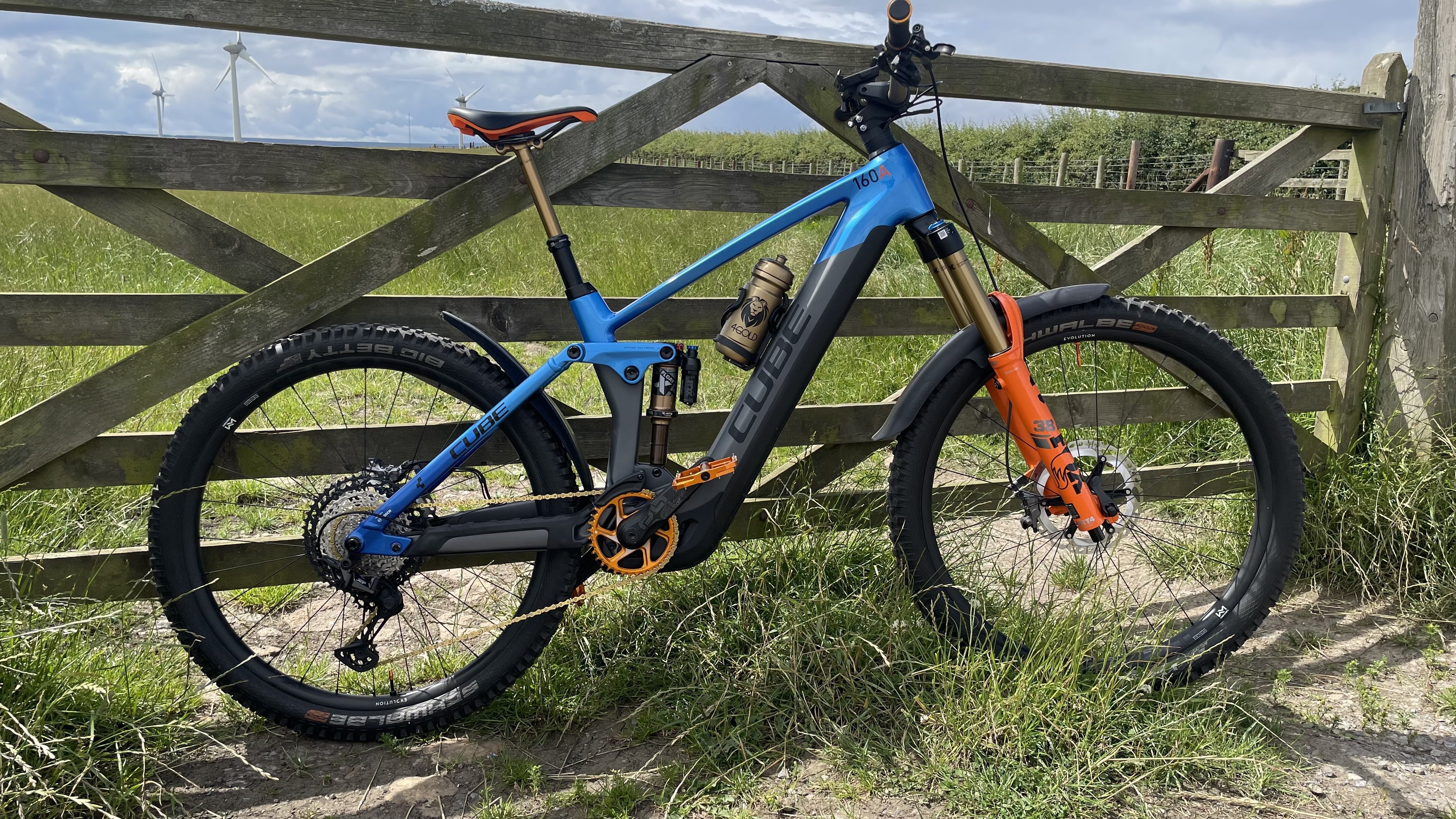

Here’s my 2023 Reaction Hybrid Race with the 625wh battery. I’ve upgraded the tyres to Maxxis DHF 2.5 up front and Rekon 2.4 rear, both 3CT, tubeless as well. OneUp dropper post, WTB Volt saddle and OneUp pedals (don’t like the color anymore, switching them up soon). Chromag format grips. Had a blast with it so far (800km down)

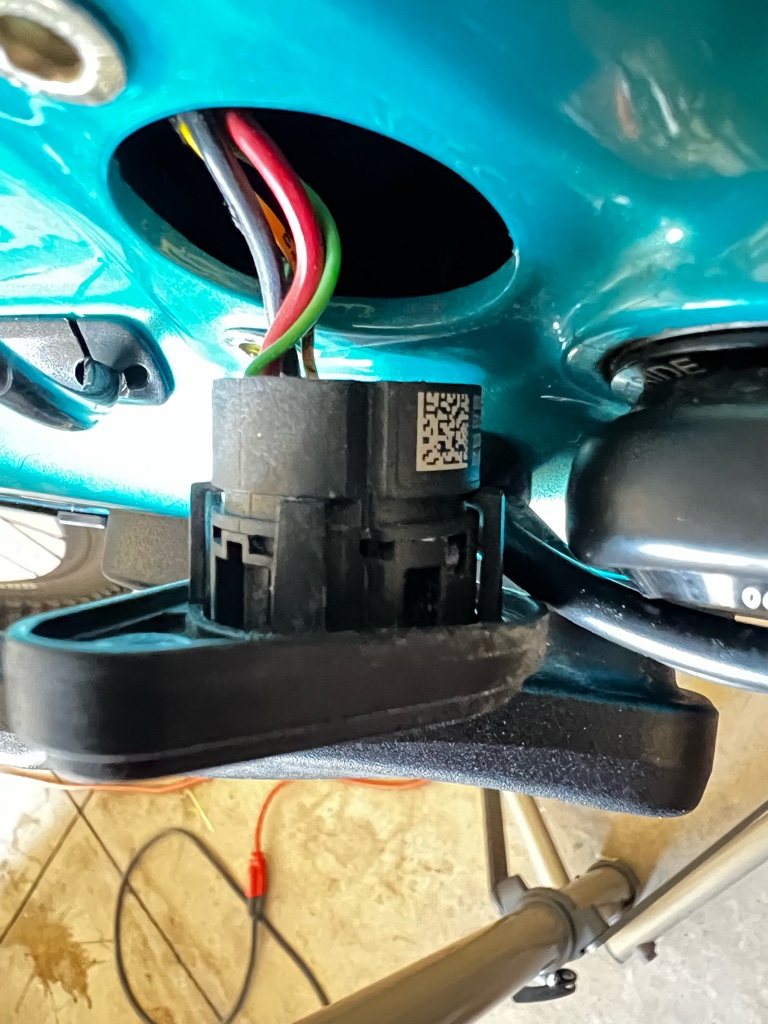

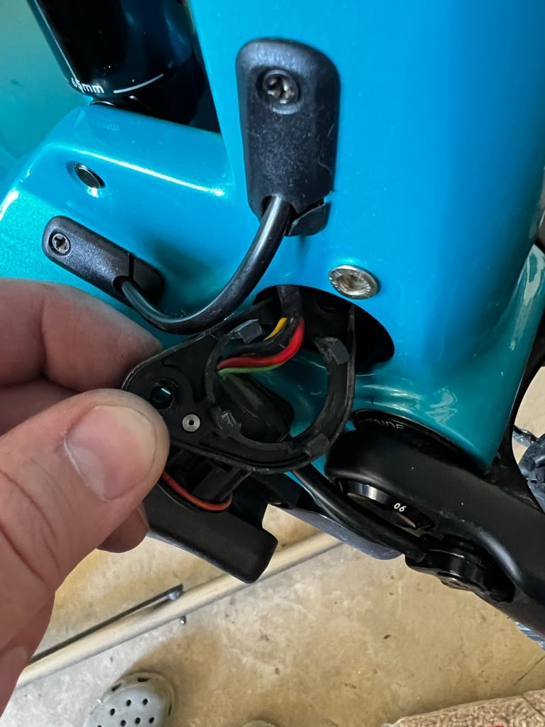

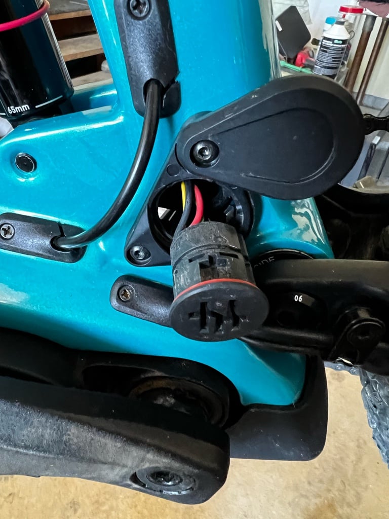

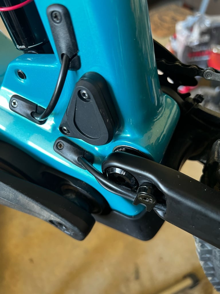

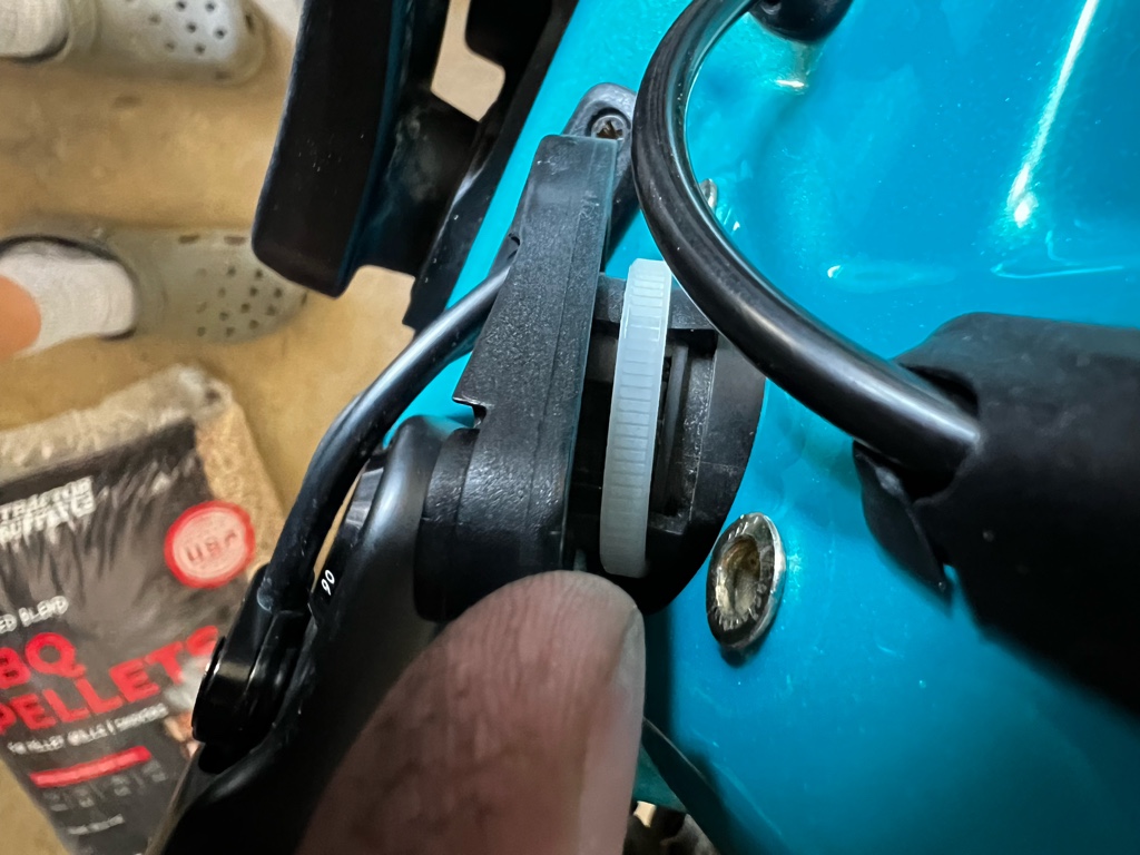

I had my battery charging while the bike was in the stand today, went to unplug the chord and the socket pulled out of the flange. Pooped it back in, no problem. Found that if there was any kind of weight or side load on the socket when unplugging, the socket would pop out with the chord. I removed the flange and added a small zip tie around the plug to put more pressure on the 4 prongs holding it in. I contacted the bike shop about it and am waiting to get a response from cube but I honestly think my zip tie will resolve the issue unless they come up with a newer solution than what’s installed.
It’s a well known, well documented design flaw. Lots about it on this forum.
I don’t believe there is a reliable fix beyond holding it in place with one hand whilst removing the plug with the other.
Very poor from Cube.
Thanks for the info. First time I had ran into it.
My shop did the zip-fix before delivering the bike to me.
In addition there was a fix on a screw of the battery hold that may be loose or get loose or not being correctly adjusted to hold the battery without rattle. You may want to check on this as well.
I ran into the loose battery holder on my 3rd ride, pulled the locking mechanism out and tightened it up, been good since.

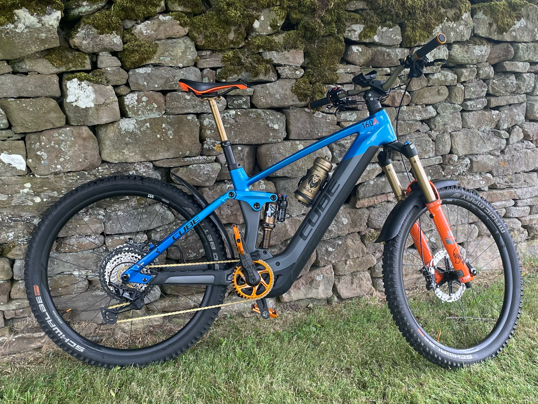

coming this week Hope Gravity stem,Hope Tech 4 E4 black & orange brakes,Hope orange 203mm floating rotors,Hope Blue 165mm cranks,Hope orange seat clamp,Hope orange jockey wheels. Then coming within next couple of months Hope Fortus wheels with orange decals and orange Hope pro 5 hubs. Current mods are Hope orange 36T chainring,Burgtec penthouse 5 pedals and Renthal fat bar light 40mm rise bars and a KMC gold titanium nitride chain. And a Bosch smart phone grip in place of kiox 300 so using I phone 12 as display and map plotting with Komoot, front proguard direct bolt onto Fox forks mudhugger and a Cube stereo hybrid 160 specific sicomtb rear hugger to protect rear pivots. Oh and not forgetting my Kashima water bottle.

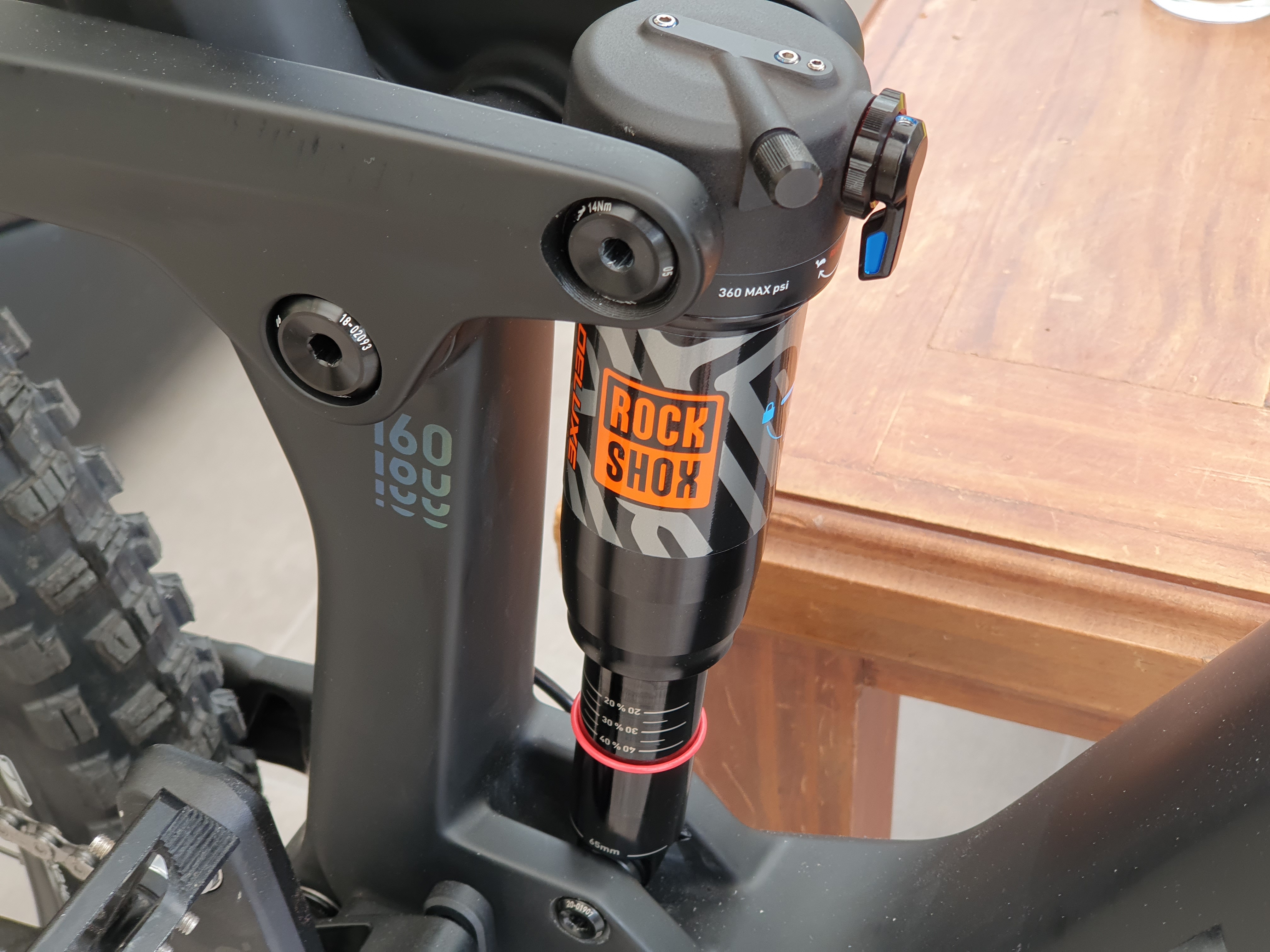

Do you have a creak on the head seat cable routing ? If yes, how could I remove it ?
And, the battery cover is a little bit noisy. What can I do ?
I had a loose battery cover and adjusted the top screw to make it a little bit of a tighter fit, also had the battery tray coke loose in the frame, very common. Rebid the battery lock and tightened the bolt up. I do have some kind of cream when seated and pedaling but have not figured out where it’s coming from.

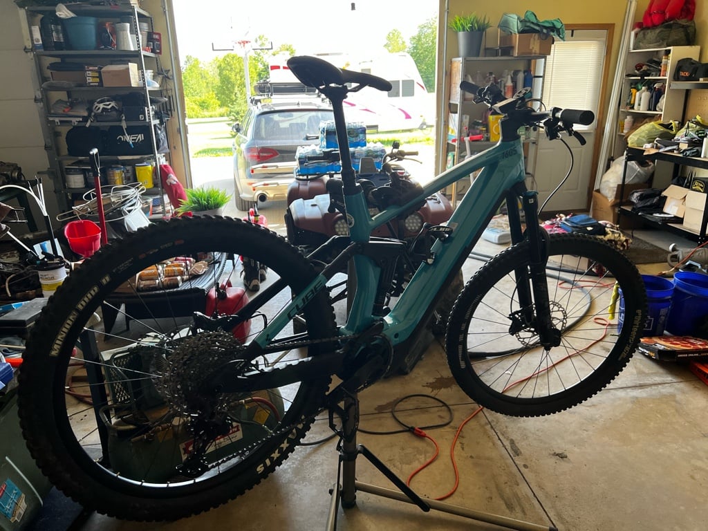

Enjoyed a nice 12 mile ride this morning with a few slick spots along the way to keep me on my toes. Slipped off a short skinny bridge and bent my rear rotor real bad. Luckily I had my multi tool and stuck the rotor between a couple allens to grab the rotor and straighten it enough to finish the last 4 miles. First time bending a rotor like that and it bent about 79 degrees. New one on the way.

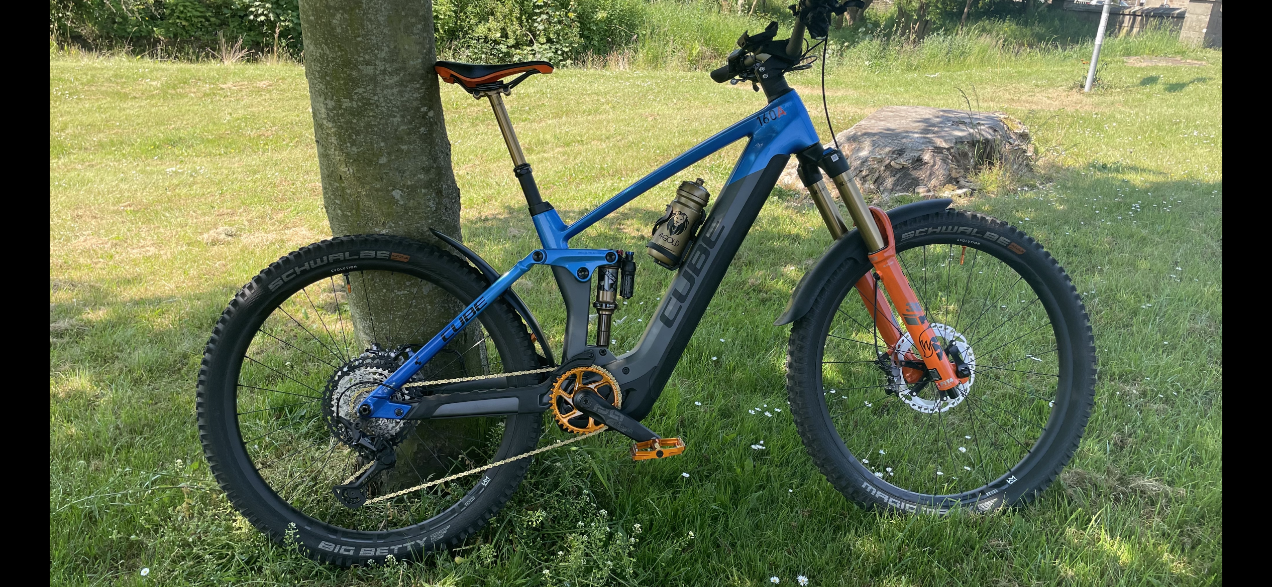

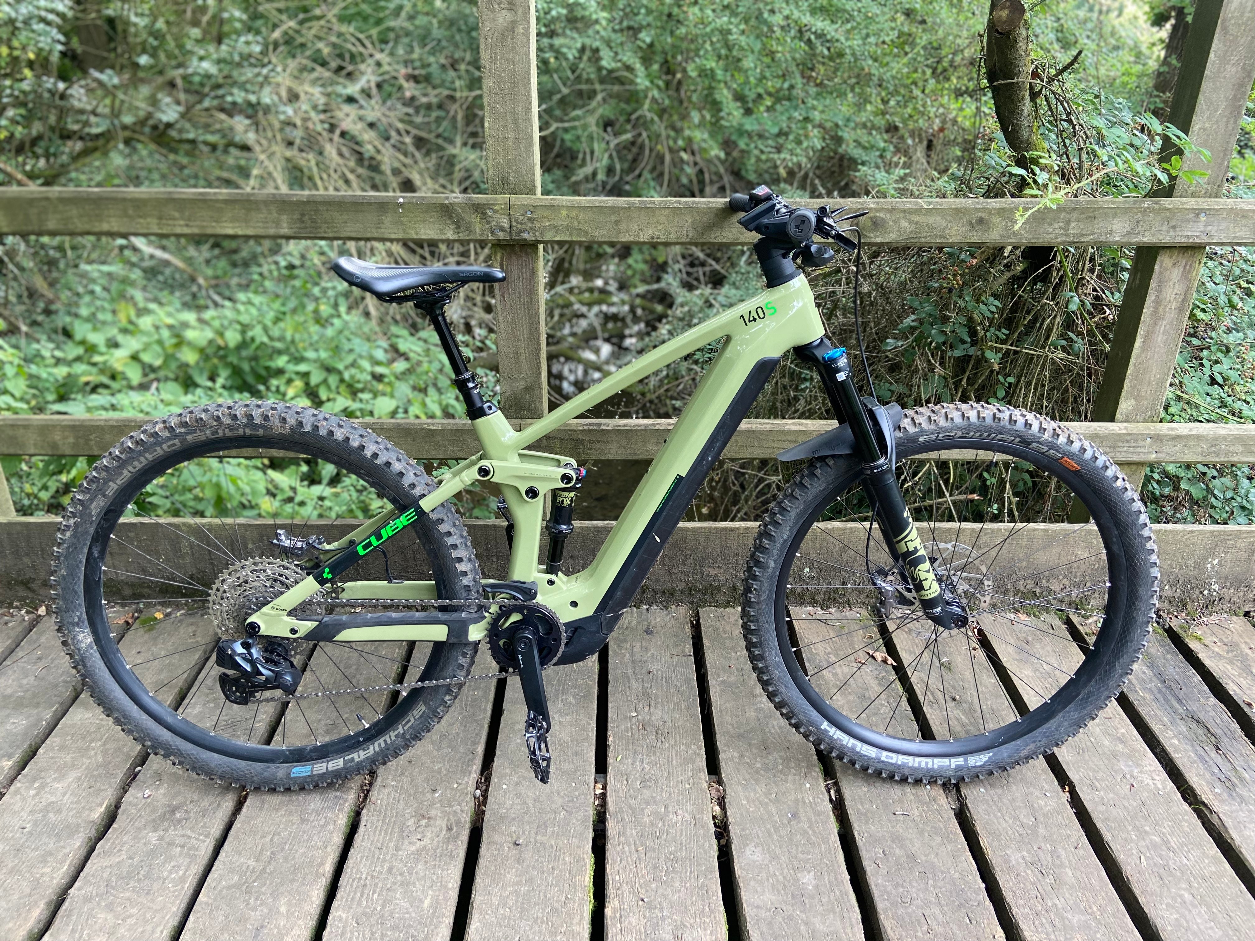

This is my XS hybrid - now for sale, I was riding this with Cane Creek Helm Coil more than this Marz 36 coil conversion. Bike has been great, but I really don't like the limitations of 140 rear stroke - no XS available on any longer. I've been so happy with the Bosch Gen 4, as an exercise I can easily pedal back home from work without any assistance and eMtb is something so lovely whenever I choose to go off-road (quite often :D).
