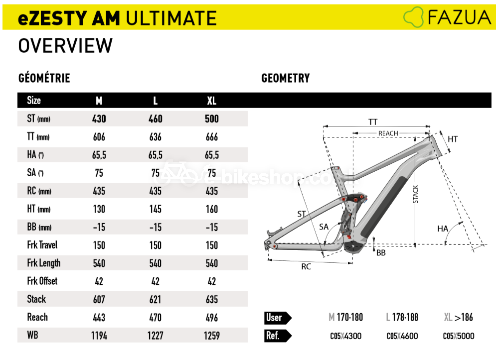

anybody got a link to geometry chart of this?

Looks pretty much on the money to me - chainstays are short at 435mm...
Yeah. I'm definitely a fan of shorter stays on most bikes. a few of mine have sub 400mm stays. But I'm not sure properly short is what I'd want on an emtb. BB could be definitely be a fair bit lower but it's not exactly high.

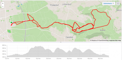

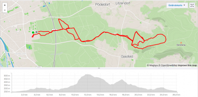

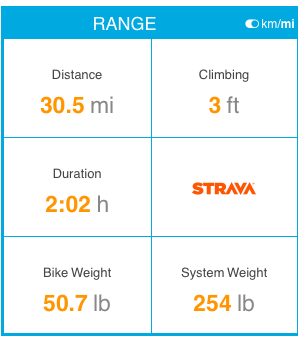

A quick comparison using the BH Carbon bike used on the same track and the LaPierre as per the tests on that site shows a significant difference in performance. While the LaPierre is 10lbs. lighter it is slower with less range/elevation gain and in fact several time it was mentioned that it lacked uphill strength whereas the BH was listed as not lacking at all.
Zesty:
12.8mph @ 15.5wh/mi
BH:
15mph @ 24wh/mi Above climbing says 3 ft. but should be 3450' of elevation, twice as much as the Zesty.
Not surprising given that the Fazua system is not as powerful as the Brose M and the battery a third of the wh's. You could carry extra batteries to extend the range of the Zesty but unfortunately you can't add more watts of power.
