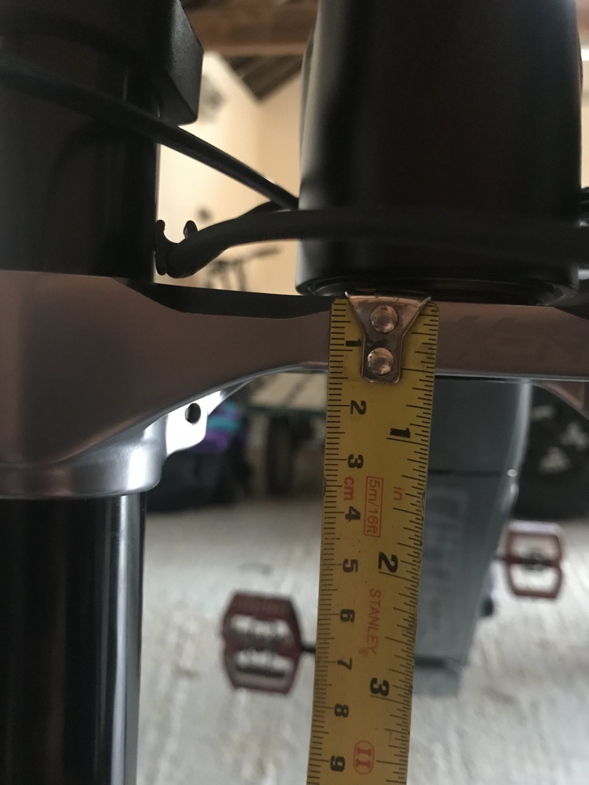

can I ask by how much have those forks changed the geometry? the axle to crown height difference looks massive in one of your pics

Think it’s the image , we are fitting the forks Friday when we have the wheels I am going to upload lots of pics and measurements as we fit. I think with full 200m travel it will add around 15mm as triple clamp crown is less with a little more sag maybe 10mm

Just finished my sons (L) Kenevo looks amazing.
took some quick measurements before and after..
Boxxer 29” forks are set to full 200mm Travel ,
BB to ground : Lyric 180mm = 273mm Boxxer 29” = 278mm
Head tube to ground : Lyric 180mm = 973 mm (Boxxer 29") = 973 mm
Under side of bars to ground Lyric 180mm = 1009 mm (Boxxer 29") = 1009 mm (stem choice will changes this)
Centre of front to to centre of crank : Lyric 180mm = 790 mm (Boxxer 29") = 810 mm
Fork angle with Boxxer 29" is around 1 to 2 degrees slacker (Max)

I don't really understand how the BB height can be modified with the same head tube height?
I did the best I could measuring but was on my own and the floor in the garage isn't dead flat I would take an average on this build.
I am going to try to get more accurate measurements when I do my (M) Kenevo tomorrow with some help from my son as well..

I now have the (m) Kenevo finished. this time to took the bike inside to measure everything will upload more info when I get a chance , but I can say the BB was 266mm (Lyrics 180mm) 270mm (Boxxers 200m) head angle was 1.2 degrees more with Boxxer..
but sorry. there's no way these Kenevo's have 273-278mm BB heights.
Looking at the side on view the BB is slightly above the wheel axle height. Looks like you're running 27.5 wheels so depending on tyre size that's put your BB height somewhere around 355-360mm. If it were 273mm the BB would be noticably far lower than the axles and the H/A would be crazy slack.
BB height is measured centre of BB axle (crank) to the floor with the bike upright, centred and on level ground.
Stock BB height on a Kenevo is 350mm.
hope this helps.
Out of interest what size, casing and compound are the tyres? and what do these bikes weight now?
@ccrdave most dual crown forks can be run at around an inch a shorter axle to crown length than the equivalent travel single crown fork. Ergo you can run the same (static) head angle, crown height and BB height but with more available travel.
Seeing as the fork has an extra inch of travel you can run it a little longer (dropped through the crowns). If I were to stick a boxxer on a kenevo I'm pretty sure I'd also fit a -2deg headset and drop the crowns as low as possible to get a nicer BB height.

I am not 100% sure were to measure the BB but i was only measuring to check the difference before and after not to check spec
