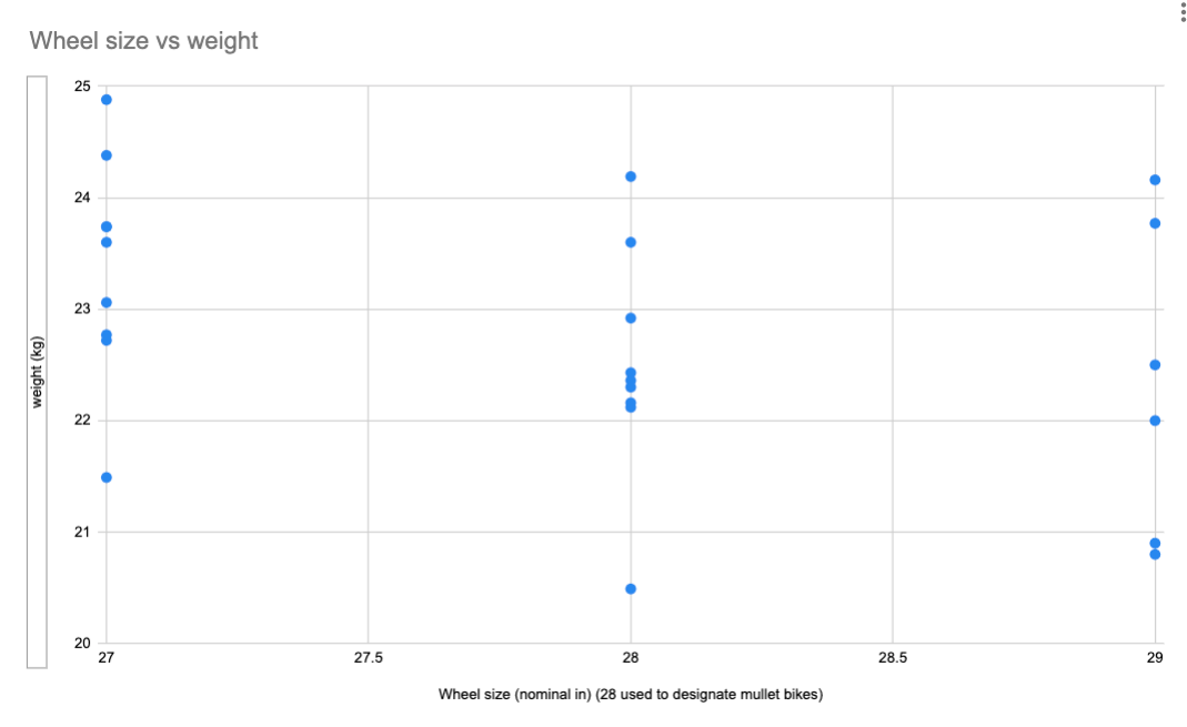

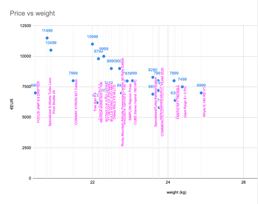

The weight difference between 29er components and 27.5 is in the realm of ~300g-500g. Getting a 3kg variance in bike weight is a lot more than picking a smaller wheel.
The difference between a 23kg bike and a 20kg bike is money; typically €3000. (NOTE: the Focus does it on battery capacity).
The same group of bikes vs wheel size shows the 29ers tend to be the lighter bikes...
But that may be because the selected group includes more expensive 29ers.
FWIW, I bought the cheapest 29er from this test.
