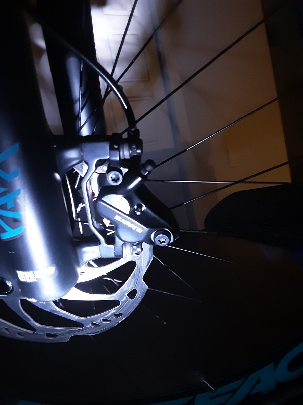

The only calliper fault i can think of that would make that sort of noise is one of the mounting bolts coming out. The calliper would then rattle on top of the mount when braking. So why not take a look at it and see if it is just a bolt missing. I suppose an alternative could be that the bolt is still there but the thread is stripped due to overtightening....the thread is in the calliper mount/post so not a calliper fault at all in that case...just needs a new mount/post. DIY seems the best solution to me....do you really want to take it back to a dealer that sold the bike to you with that sort of fault and risk them fixing it?!!
Hi...I can show you a picture of what broke. It isn’t fixable. It’s clear that the housing broke. That’s why I’m not sure if it was installed wrong (ie over tightened or something) or a manufacturing defect (idk-air in the composite?)
I’m trying to attach the picture so you can see where it’s simply snapped. It’s on the bottom and it wasn’t until really examining very closely where they told me to over the phone that I could find it.

ah ok...close but no cigar! I notice the post is not sitting on the frame..there is a gap. Check to see if the bolt will hold in that thread to see whether the thread in the frame has been stripped. If not I would suggest the calliper bolt was not tightened down, rattled loose and then as the calliper was pulled up by the pads it has snapped that part of the calliper. So it is a new calliper, provided the thread in the frame is OK. I would buy a new one and send the LBS the bill!

I gotta say, though- MAD PROPS to you for guessing based on the sound! You were spot on. Color me impressed!
That’s an impressive failure!! If the shop is hours away I would buy a replacement calliper and fit it myself or use an LBS if you’re not confident to do.

Just check the bolts holding the caliper Not sure on the rear if one is longer than the other but it would be quite obvious if they somehow were in wrong positions , just that it looks like that bolt isn’t tight or fully seated so could be too long for the thread

I think the reason it looks so long is because the part of the caliper housing that should be there on the bolt is broken off and missing. Just a guess but we’ll see once it’s fixed next week.

So I've actually seen something almost exactly like that on my buddies new specialized. Somehow the assembly d a 203 spacer instead of a 200 mm spacer. Look at the rotor and the spacer and make sure both are either 203 or 200 mm. That's my guess.
ill have to double check. Thanks for the heads up. Would hate to have it happen again after they replace the caliper
edit-where is the spacer? lol. I can measure the rotor easily enough. But I’m not sure where the other part you’re referring to is.

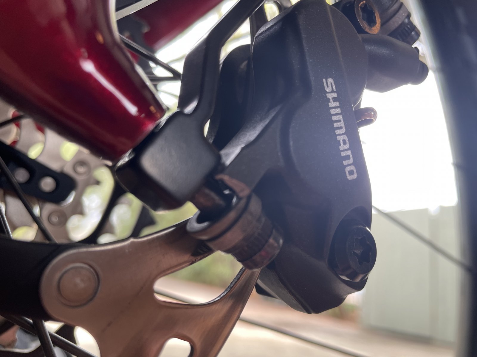

[/QUOTE")]
Look at my pic above, the spacer is the metal piece between the caliper and the shock. One side of where the bolts pass through is thicker than the other by almost double the width, which means one mounting bolt is longer than the other.
