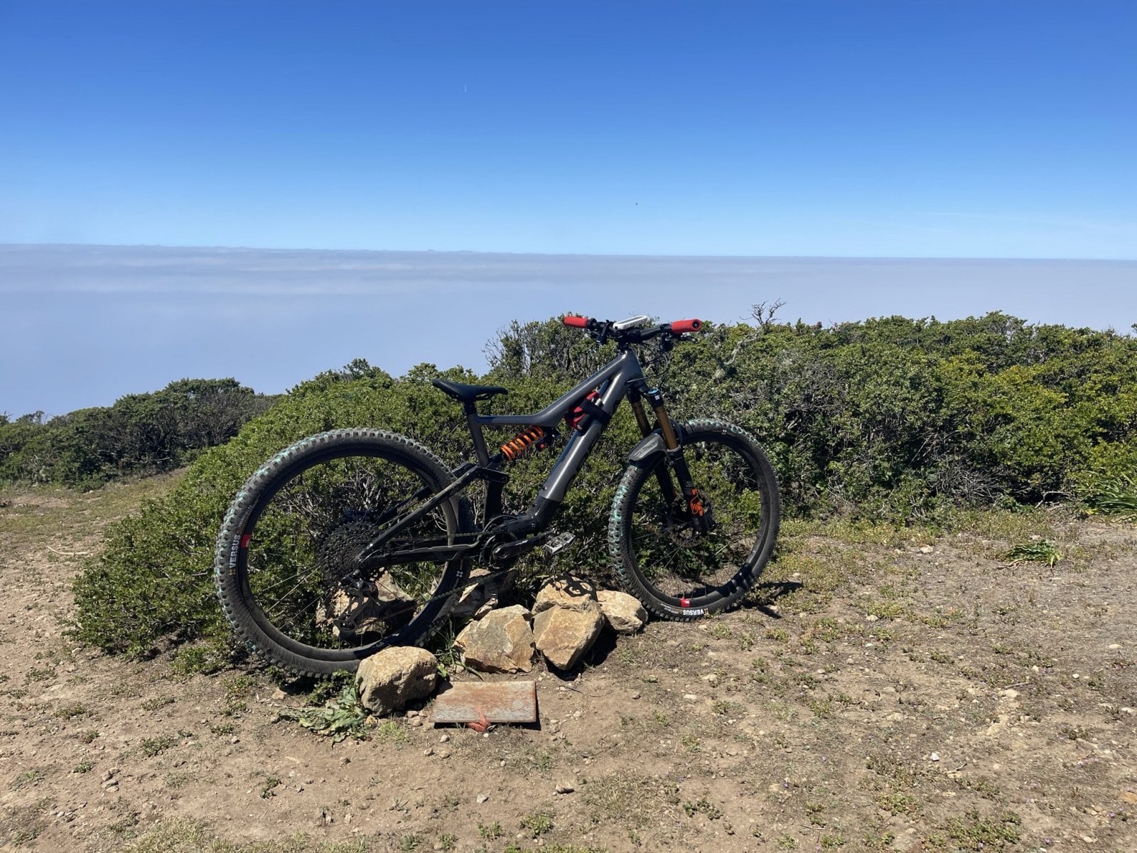

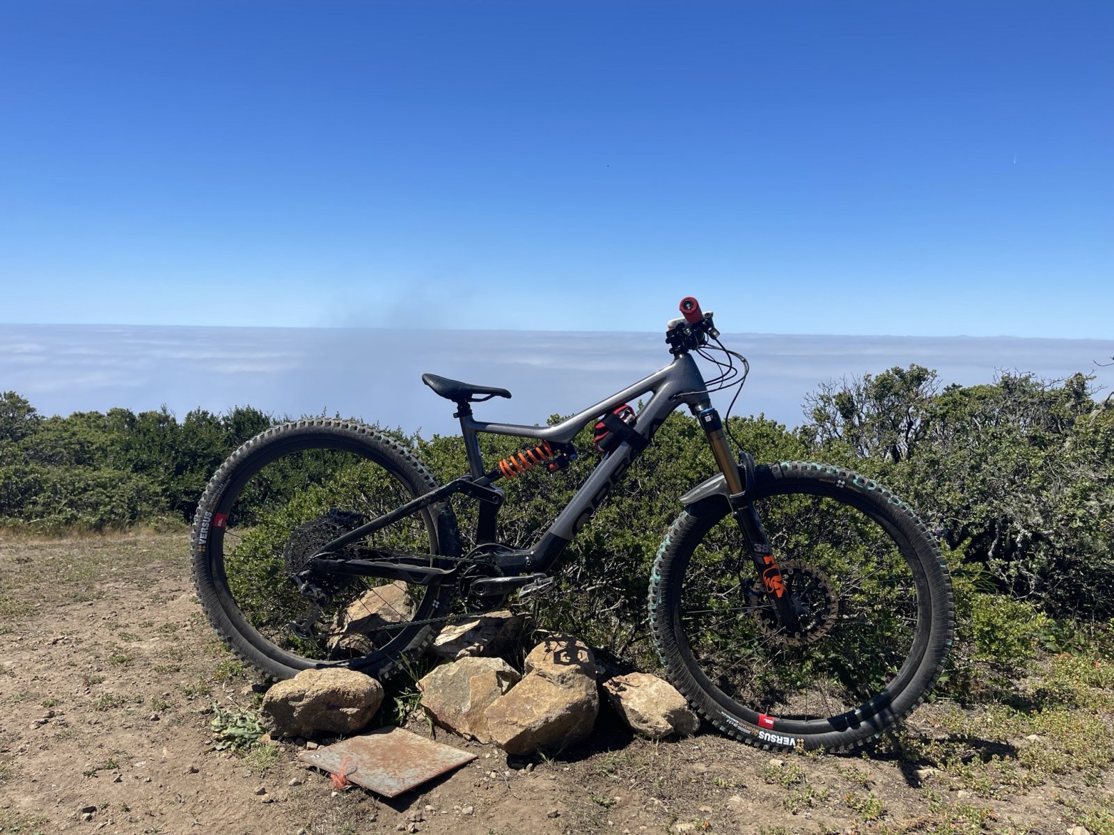

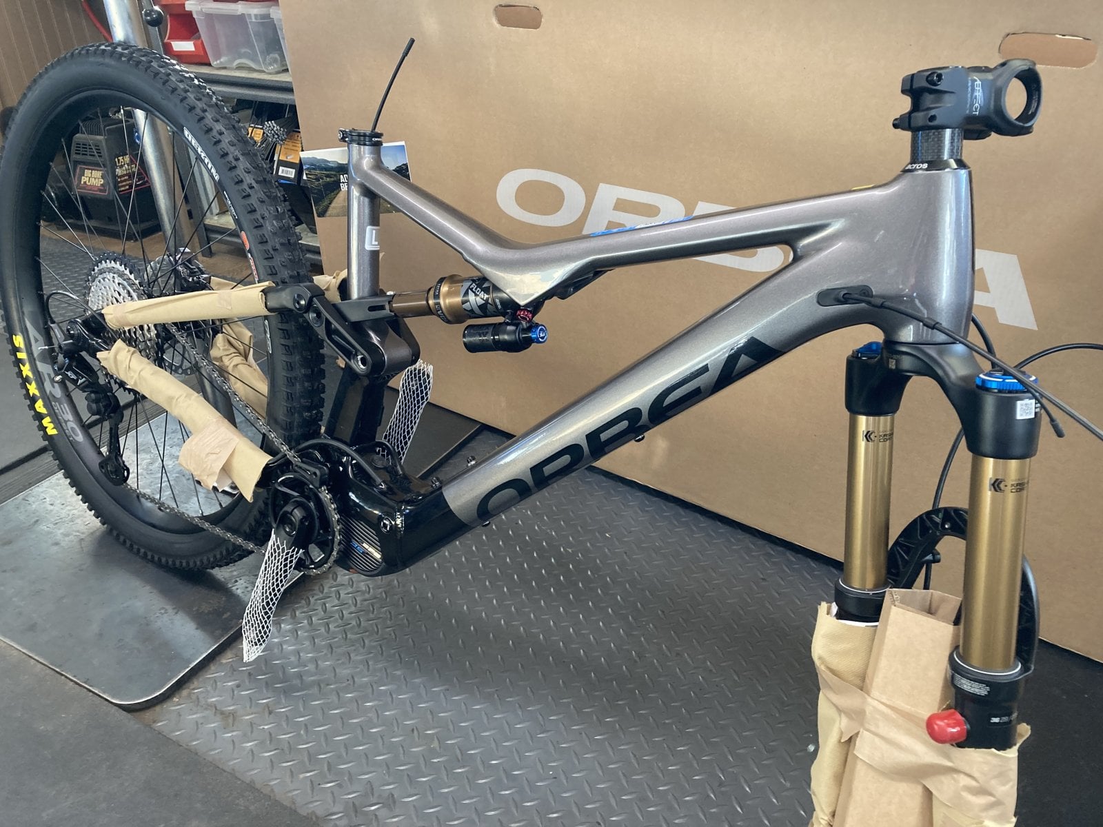

Bike arrived at the shop in Oregon today and should be in my hand in NorCal by Monday. I'll be adding some more upgrades shortly after. I'm gonna test a Fox DHX2 216x63 in the rear as well as upping the front travel to 160mm and wrap the frame in a full Ride Wrap kit. I picked up a SRAM X01 Drivetrain since my RF NextR wheelset was only available w/ an XD Driver. I'll use the Current Shimano drivetrain to refresh the XT drivetrain on my Trek Rail.
Finished build :
  • Frame Orbea Rise Hydro 2022 140mm travel 29" Boost 12x148
  • Shock Fox FLOAT X Factory 2-Position Evol LV custom tune 210x55mm
  • Fox DHX2 Factory 216x63mm (~161mm rear travel)
  • Fork Fox 36 Float Factory 160 Grip 3-Position
  • Chainring e*thirteen e*spec Direct Mount 32T Boost
  • Crank e*thirteen Plus Alu 165mm
  • Headset Acros Alloy 1-1/8 - 1-1/2" Integrated
  • Handlebar Race Face NextR Carbon 35 20mm Rise 800mm
  • Stem Race Face Turbine R 35mm 50mm
  • Shifters SRAM X01 Eagle 12sp Single Click Trigger
  • Brakes Shimano XT BR-M8120 4 Piston
  • Rotors Magura MDR-P 220mm Front/203mm Rear w/ speed sensor magnet
  • Cassette SRAM GX Eagle 10-52T 12sp
  • Rear Derailleur SRAM X01 Eagle 12sp
  • Chain SRAM XX1 12sp
  • Wheels Race Face NextR 31 Carbon 29"
  • Tyres Maxxis Dissector 2.60" front
  • Tyres Maxxis Dissector 2.40" Rear
  • Seatpost OC MC20 Mountain Control Dropper, 31,6mm 170mm (210mm Oneup V2 coming soon)
  • SEATPOST LEVER Shimano SL-MT500 I-Spec EV ( coming soon)
  • Saddle Specialized Power Pro Elaston 143
  • Chainguide Orbea Rise chainguide
  • Motor Shimano EP8-RS
  • Battery Orbea RS Internal 540Wh w/ Range Extender (Due in 6 weeks)
  • Pedals CrankBrothers Mallet E
  • Grips Wolftooth Fat Paw
