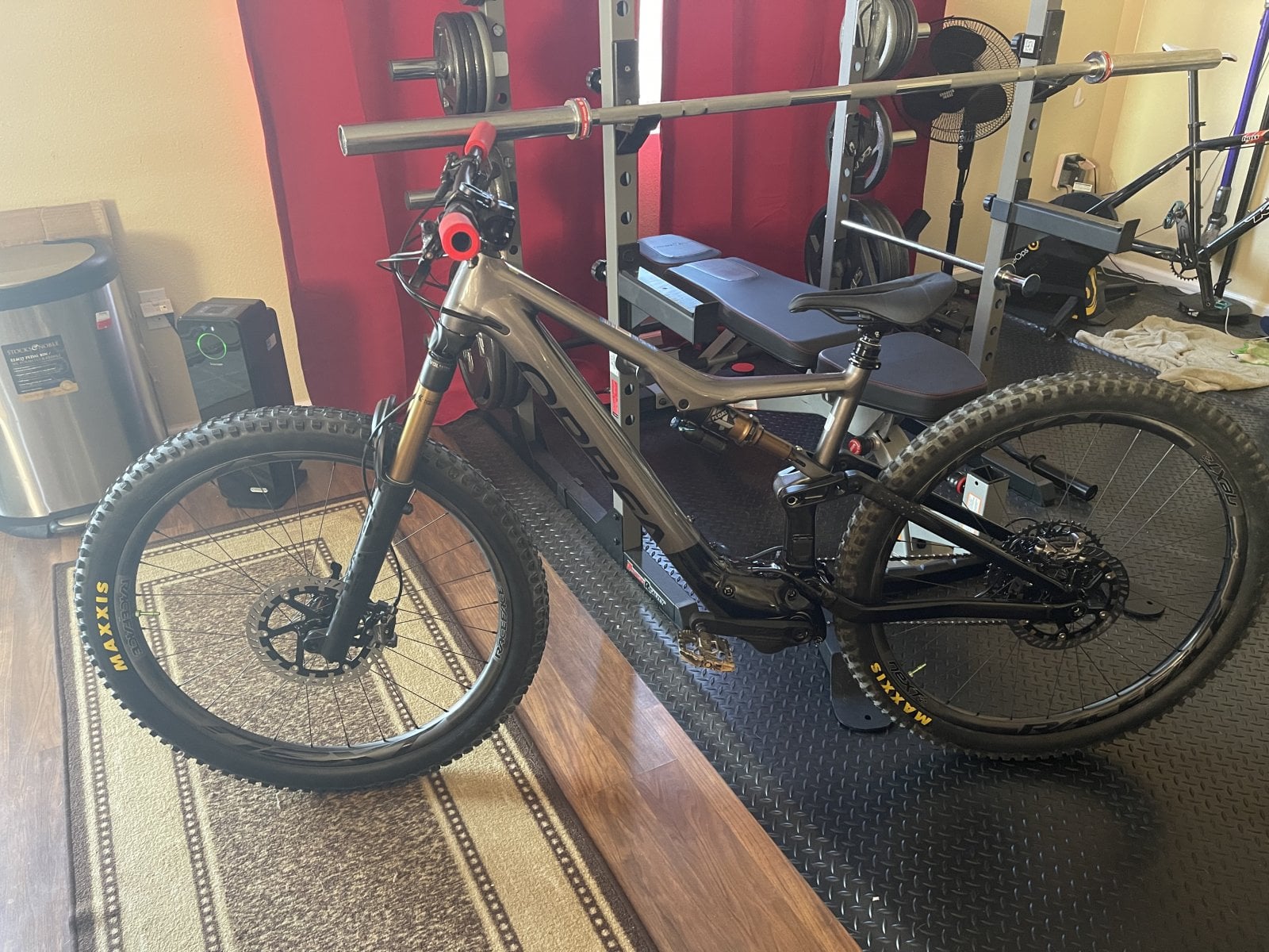

Bike arrived at the shop in Oregon today and should be in my hand in NorCal by Monday. I'll be adding some more upgrades shortly after. I'm gonna test a Fox DHX2 216x63 in the rear as well as upping the front travel to 160mm and wrap the frame in a full Ride Wrap kit. I picked up a SRAM X01 Drivetrain since my RF NextR wheelset was only available w/ an XD Driver. I'll use the Current Shimano drivetrain to refresh the XT drivetrain on my Trek Rail.
Finished build :
  • Frame Orbea Rise Hydro 2022 140mm travel 29" Boost 12x148
  • Shock Fox FLOAT X Factory 2-Position Evol LV custom tune 210x55mm
  • Fox DHX2 Factory 216x63mm (~161mm rear travel)
  • Fork Fox 36 Float Factory 160 Grip 3-Position
  • Chainring e*thirteen e*spec Direct Mount 32T Boost
  • Crank e*thirteen Plus Alu 165mm
  • Headset Acros Alloy 1-1/8 - 1-1/2" Integrated
  • Handlebar Race Face NextR Carbon 35 20mm Rise 800mm
  • Stem Race Face Turbine R 35mm 50mm
  • Shifters SRAM X01 Eagle 12sp Single Click Trigger
  • Brakes Shimano XT BR-M8120 4 Piston
  • Rotors Magura MDR-P 220mm Front/203mm Rear w/ speed sensor magnet
  • Cassette SRAM GX Eagle 10-52T 12sp
  • Rear Derailleur SRAM X01 Eagle 12sp
  • Chain SRAM XX1 12sp
  • Wheels Race Face NextR 31 Carbon 29"
  • Tyres Maxxis Dissector 2.60" front
  • Tyres Maxxis Dissector 2.40" Rear
  • Seatpost OC MC20 Mountain Control Dropper, 31,6mm 170mm (210mm Oneup V2 coming soon)
  • SEATPOST LEVER Shimano SL-MT500 I-Spec EV ( coming soon)
  • Saddle Specialized Power Pro Elaston 143
  • Chainguide Orbea Rise chainguide
  • Motor Shimano EP8-RS
  • Battery Orbea RS Internal 540Wh w/ Range Extender (Due in 6 weeks)
  • Pedals CrankBrothers Mallet E
  • Grips Wolftooth Fat Paw

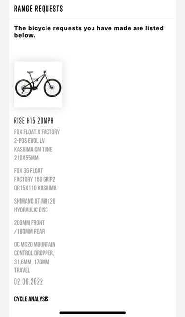

As a big guy, I can’t run the Performance damper on the fork….without adjustments it’s either too soft or too firm…so I run Grip2 if I run Fox, Ultimate w/ RS. Rear shock just matches tbh. I have a Float X on my Transition Spur. I don’t plan on Running It mullet so I’m not entirely sure how the longer dhx2 I picked up will work. If it doesn’t then I am already confident in how the float X performs. I really Haven’t had issues with basic dampers on rear shocks that I have on forks. The upgrades I changed through the Rider Connect reservation were Factory Grip2 150 fork, Factory Float X shock, Shimano M8120 4-pot brakes, 170 dropper, the rest I ordered..over $3k in parts from backcountry…I had a 20% off coupon for my bday lol. As for the changes, I made them on the Orbea website, Orbea sent the-request to the shop I chose. The shop then placed the order with Orbea for the bike I wanted with changes. I think the shop actually Ordered the bike with changes themselves because It still shows my request as a “request”. And not as confirmed even though the bikes already registered to me and arrives tomorrow

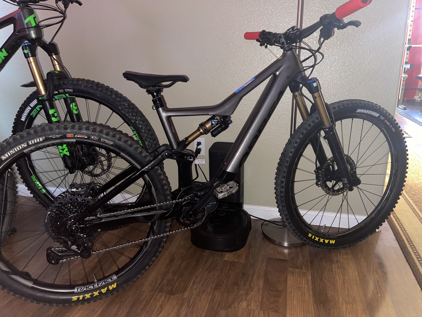

@BiGJZ74 I’m interested to see how you get on with the longer travel shock, I wasn’t sure there’s clearance without going mullet?
Just waiting on the offset bushing to arrive then I’ll let u know. I have seen a Carbon rise being run full 29” on YouTube….but not on an H as far as I know. I also run a 700lb spring so even with the bushings it may not work…definitely doesn’t without the bushing as a tried and there is a knock somewhere on the frame at top out. It was 3am so I didn’t search I just put the float x back on.

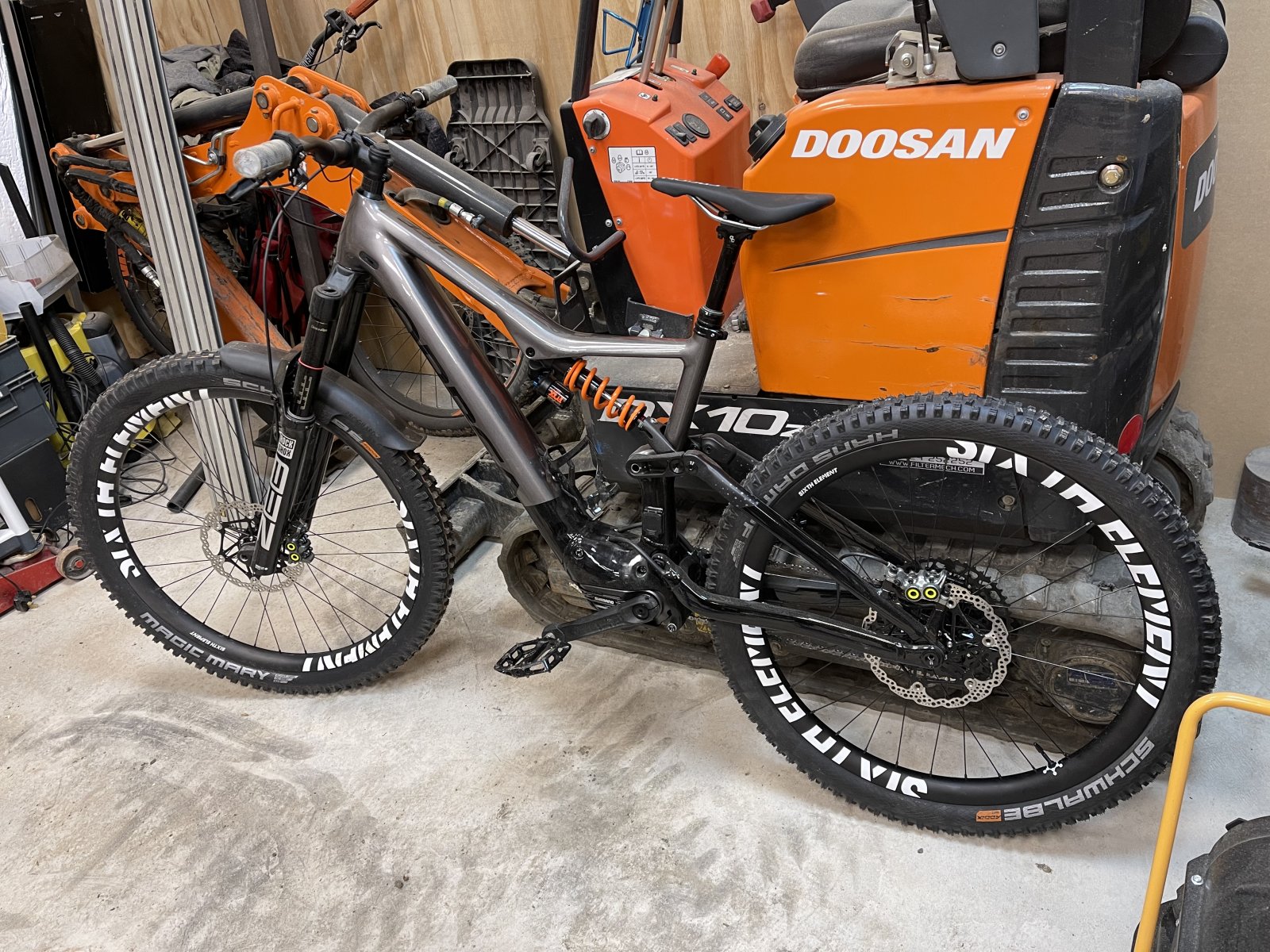

Some crappy pics but here it is! Still need to install SRAM X01 derailleur and shifter, then add the 160mm airshaft/Fox DHX2 when the offs
I had to go with mullet set with your doing to yours because it made the seat to high over jump but on a plus side it feel better round like that
I run 180 up front and one offset bush in the rear
