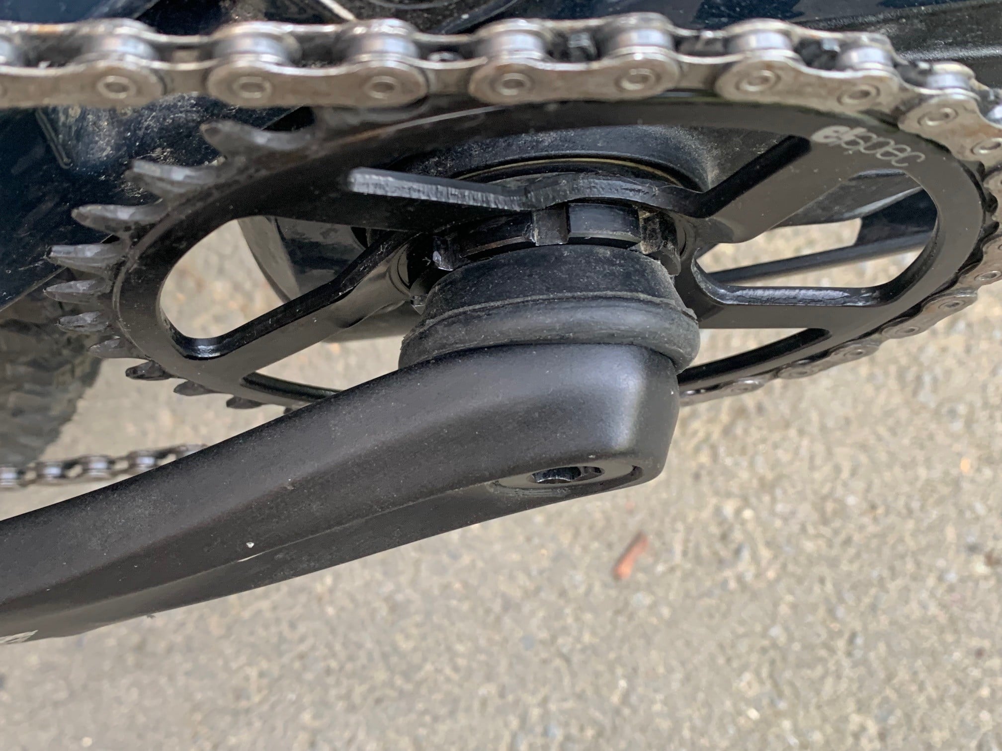

Seems like the guys fix rattling for Shimano by adding some rubber boot to a crank, wondering if we can do something similar?
Very interesting solution! I cant see any drawbacks except a bit more resistance when back-peddling which I'm sure wouldn't be a problem for the majority. If mine was annoying I would try sorting something similar out myself, maybe I will if I get bored
I like that idea; it's the best suggestion so far - I'm going to make a damper ring and test it.

Made a rubber damper in the same vein as the Shimano/Orbea one. Provides enough friction to allow back-pedal chain movement (but it still has some slip).
Initial testing shows the rattle is still present, but more testing is required to see if it's reduced to any significant degree...
I haven’t read the Shimano thread, what is the gromet supposed to do?

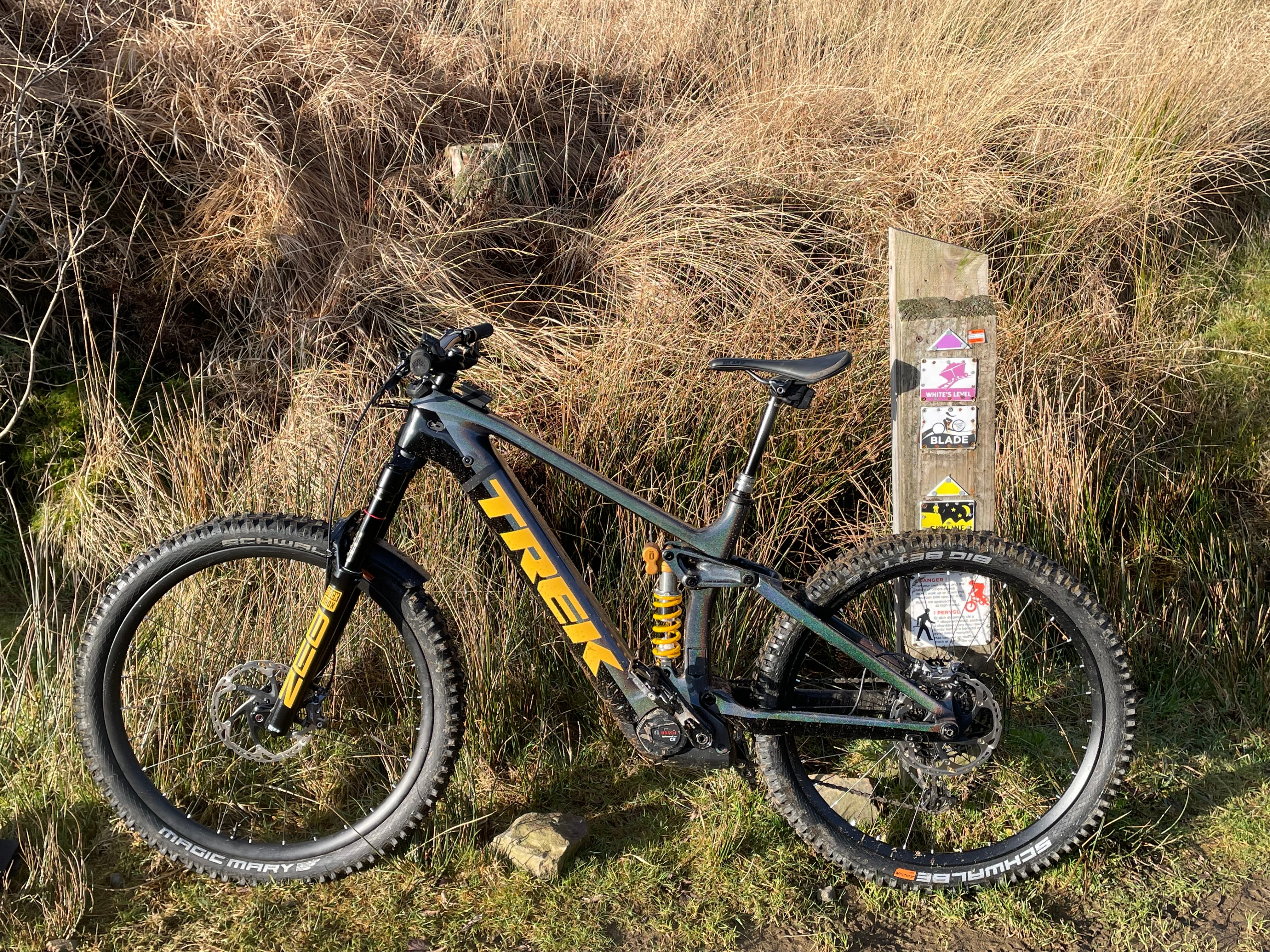

It’s fair to say I’ve had a few issues with my bike, all electrical related, but they do appear to be fixed now.
Since buying it I’ve added a coil shock, upgraded the Zeb with the new debonair+ spring, mulleted (high chip) and 155mm cranks.
I have also added the battery anti rattle bracket.
The bike is now a lot quieter than when I bought it.
Today was my first really long ride on rough rocky trails. I went to Afan and did about 29 miles, 3000ft of climbing, all in either eMTB or Tour+ and had 25% battery remaining.

The bad, and the thing that I don’t think I’ll ever get used to, the motor rattle. Sounds like a bag of bolts. The battery no longer rattles, but the bike still sounds cheap when riding over rough trails. I was aware of this trait in the motor when I bought the bike, but I just find it very off putting and it detracts from the ride.
Yep, just got back on my Rail after +8 weeks without and new drive unit and all new wiring and yes, the bike still clanks about at the motor/BB area, especially when comparing to my Fuel EXe. Is too bad, cause the Rail really is a fun bike to ride. Clank factor only thing detracting as you said.
