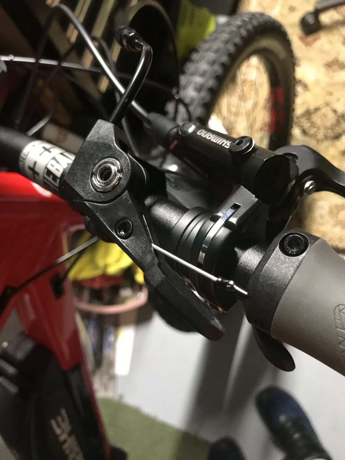

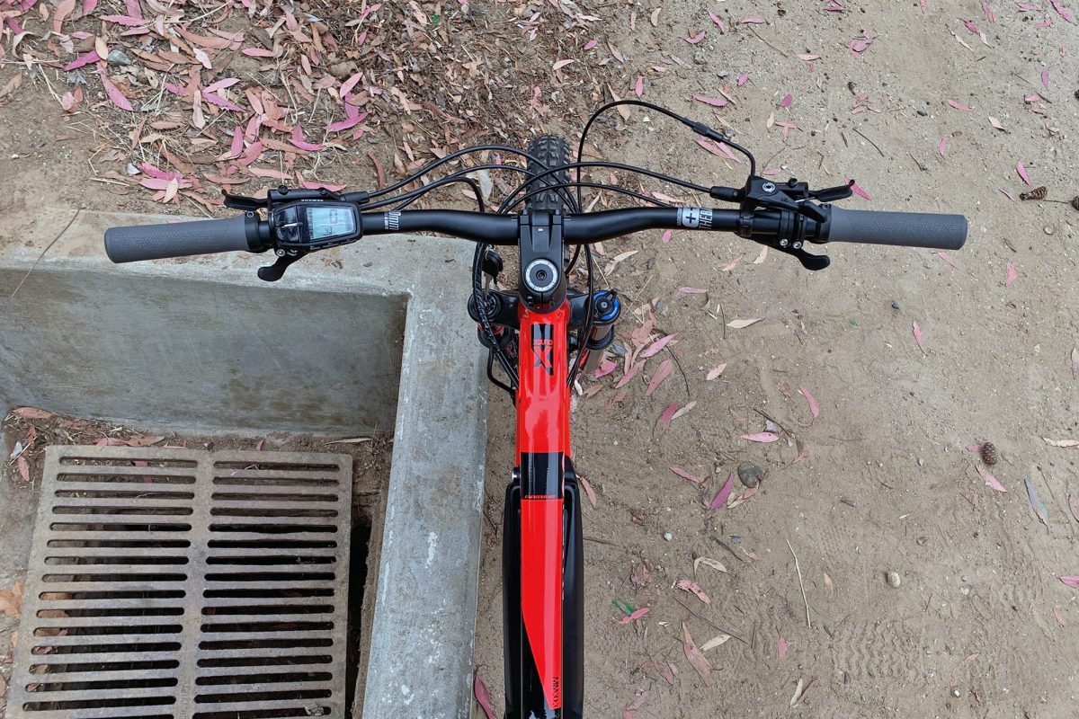

Should the cable stick out that far from the seat dropper lever? Seems long, no? How to fix? Haibike all man 2.0

It's fine, you could cut it shorter by a cm, but what is it doing on the right side of the bar? You wouldn't notice it if the lever was underneath on the left side of the bar where they are normally mounted.

I'd recommend it on the left too, I had one fitted above the bars like this once and I tried to lower my seatpost while going down a rocky section, hit a bump which bounced my hand clean off the bars.
If it was on the other side (and underneath the handlebars my thumb would have hooked the handlebar and prevented an off.

Seems to be normal on the Allmtn 2.0
I guess if you put it on the underside on the left it would interfere with the gear selectors for the front rings.
I had a similar problem on my e8000 with the e8000 shifters on the left, the dropper I bought wouldn't fit on the left with the large switch gear, so I had to mount it on top on the right - though I pointed the cable exit downwards more, so it didn't stick out as much. Until I switched to an e7000 controller and could swap it over onto the left.
